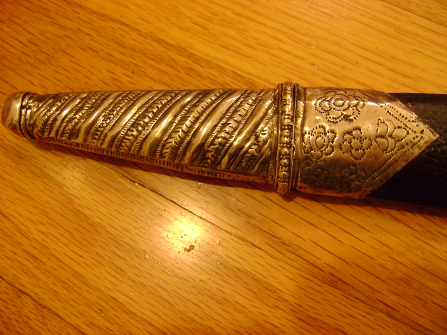

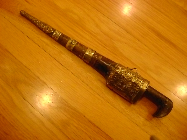

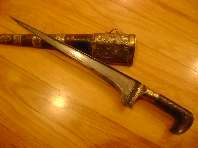

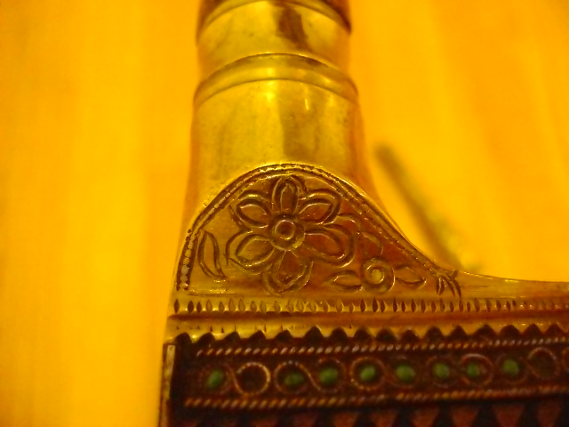

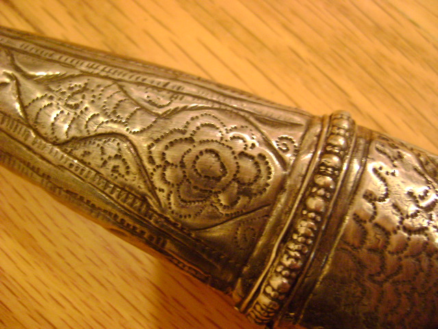

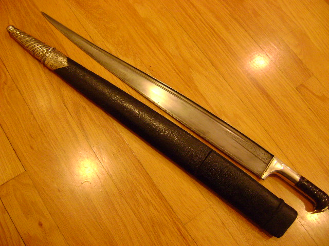

Default Khyber and Choora with Bukharan (?) twists
Both weapons are traditionally attributed to Afghanistan, mainly to the Khyber Pass area.
But here are 2 with decorative twists.
The Choora has a ribbon of turquoise stones in a typical Bukharan style. Never saw anything like that before. Looks 100% original.
Khyber has fittings made of very thick silver, the finial is short unlike the usual Afghani long and slender, but remenescent of Uzbeki style, and the chape is decorated with apple blossoms,- also favourite Bukharan motive.
Any thoughts?

An associate who collects these things says the long bladed version of the kard in the illustration is a choora. Or at least in America and other English speaking places. Mine has a blade length of 18" and a larger grip.

Which one did he refer to?

From a Russian Museum site;
The Central Asian name of turquoise derived from Iranian word firusa - victory; therefore its presence on the weapon endowed the latter with especially strong magic power, providing good luck at war. Turquoise became especially common in war paraphernalia of Turkic peoples.
This would explain the stones being seen across a vast area.

Salaams all I noted the decorative technique of studding Feruze onto small silver boxes and jewelery by master craftsmen in Kabul. Naturally and as stated above this was for talismanic effect and design...Like many techniques there is bound to be some overlap so that Turkomen Jewellery etc exhibits similar designs and methodology to Afghan, Tajic and a host of other ethnic groups in what we now call Afghanistan. (and neighboring countries) When I was in Kabul I tried all the well known collector names for the different knives and daggers but Kard was what they use for any dagger I saw.

He referred to the shorter knife in your illustration. The longer one is as we call it here, is a Khyber knife/sword. The short one does have a much longer version which is called a choora. I will try to get a pic of mine and send it to you directly. I also have a khyber "sword" which is rather older and which this party said would have been still longer had not the tip been presumably broken off and blended in the usual upsweep. This one has a metal bird's head grip and koftgari scratching visible. He also said it was likely gold koftgari for that time period and blade and handle type. This latter blade would have been over 30" long.

I said from the beginning that the "shorter one" was choora. It is of a reasonably normal size: 17" in the scabbard.
Wold love to see your example.
