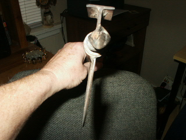

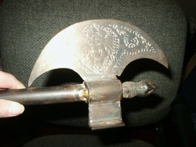

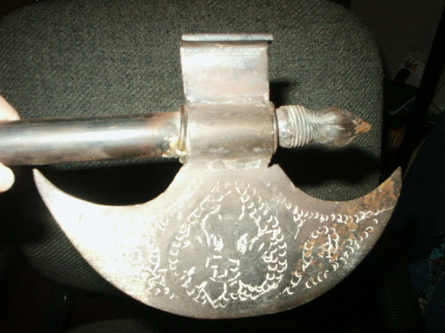

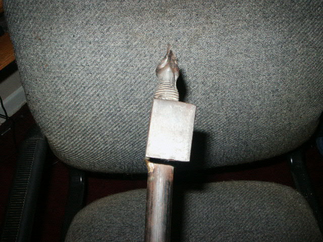

I am having a debate with a collector friend over this axe. He claims it to be a typical Qajar period Indo Persian. To me it looks like a not-so-modern repro. It is just too crude overall to be a real thing. Note the top spike - it is just a part of the hollow haft flattened to resemble a spike! I also think I am seeing some welding seams where axe head/blade meets the socket However, I sometimes see identical axes offered for sale and wonder if perhaps due to being stubborn I am cheating myself out of aquiring one for my collection. Am I wrong? Is this a genuine period item?
Sorry for the poor quality pics. The axe does not belong to me and I did not take these pictures

From the images it looks to have a piece from a late 19th/early 20th ceremonal axe but only just that at best....the rest, such as the spike if you can call it that and the T shaped hammer and the shaft all look to be modern pieces of "scrap" braized and welded on to create a "complete" axe...I use a lot of these words loosely as she ain't pretty.....

I agree with the foregoing comments . This is a poorly cobbled together effort I am afraid . The axe head decoration is terribly crude .. even in late 19th pieces it is fine ... no real weapons maker could have made this ... it would have fallen apart if used in action and been laughed at if worn for a parade.

There come in various grades and ages. In this case I would have to say that your instinct was right on the money. This is the bottom end of the cheap scale.
It looks like it has a mixture of brazing and welded construction, crude blade with the most basic stamped decoration. the hammer back is just a roughly cut section of angle iron welded on and shaft made from a crimped section of tubular steel.
I'd say it's post WW2. You haven't misssed out on this one.

It is as fake as they come, the maker did not even try to make it look real. to me it seems to be built out of modern construction materials.

Both of you are correct: it is a typical Qajar period repro:-) The two are synonymous.
Similar axes, bazu-bands, shields and swords were mass-produced in Iran during Qajar and Pahlavi dynasties. All were aimed at European naifs looking for the romantic/heroic past of a destitute country. Before oil, Iran was viciously poor and trinkets of that nature were one of the few means of putting bread on the table. Their quality is abysmal, but we still see them on e-bay, masquerading as real weapons.
