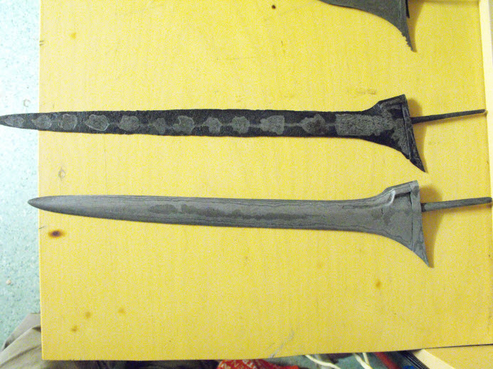

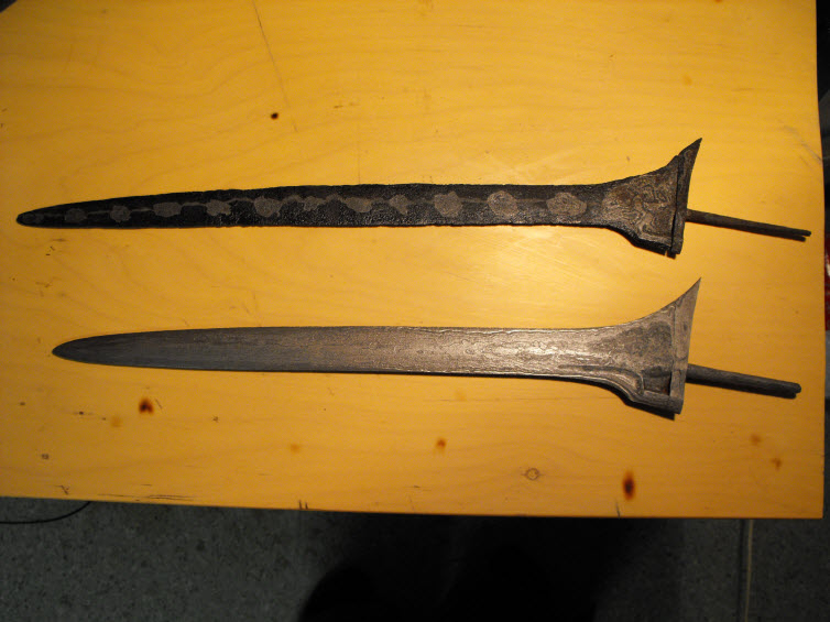

I hope you can help me out with 2 of my other wilah's, in total i have 8 wilah's without a sheath, but i shall post them by the two.
The one on the top is i think pamor rante, but thats all i know about it, the blade is very thin, the blade is without the pesi 40 cm.
The one below puzzles me the most, my first thought was that it's factory made, it is a heavy wilah with a thick pesi, the blade is without the pesi 37 cm.
The most importance for me is to know if the are worth it to make a new sheath, and what kind of sheath(area they come from).

Happy new year...
The heavy and sturdy # 2 keris could be tangguh Tuban. maybe a warangan treatment would suffice its true worthiness of a new sheath, or at least a secondhand keris sheath.

I'm not sure what you mean by "factory" made.
I suspect that with a warangan treatment you will discover that the second blade has a very nice pamor wengkon pattern. Looks like a nice keris to me.

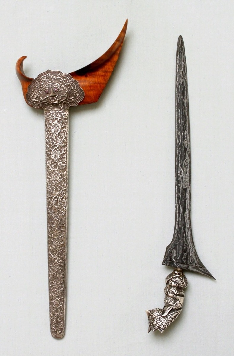

Harvey,
This is approximately how your thick blade should look like after warangan treatment. A sheath in East Java or Central Java style would be convenient.

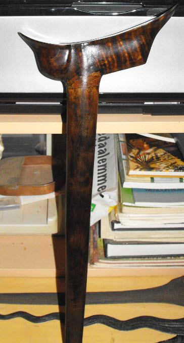

I also have this sheath, and i don't know where it's coming from.
Thanks for your answers!

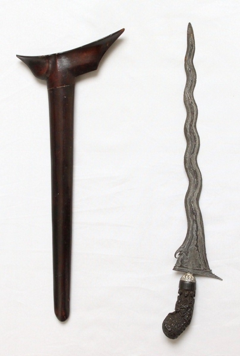

Originally Posted by Jean
Harvey,
Very very nice

Hello Ben,
AFAIK this style of sheath is from Cirebon/ Northern Java, see attached picture.

Originally Posted by Karttikeya
Hi Jean, very interesting hilt, congratz..I'm attracted to own such that hilt..But dunno where I can find it so far To my eye, your Tilam Upih looks like pretty average of keris, sorry to say but sheath, scabbard, and specially Nyamba hilt are so nice..
Hello Karttikeya,
The sheath & hilt of my kris were made quite recently (not later than 1995) but by a master craftsman indeed. Regarding the blade, the dapur is not Tilam Upih but Brojol (no tikel alis), it is not a fantastic piece but a strong one with some age.
Hello Ben,
Thank you Jean, that mystery is solved, for me it was, you guys are of the greatest help!

Old 3rd January 2012, 05:50 PM   #11
Hello Ben,
agree with Jean that your sheath is from Cirebon/North Java. BTW a very very nice one!

Posts: 7,232
Harley, I'm only going to endorse what has already been said:- both blades are old, both are well worth the effort of redressing.
However, in my opinion, neither are worth putting a lot of money into. If I had these blades they would be dressed in Solo gayaman.
