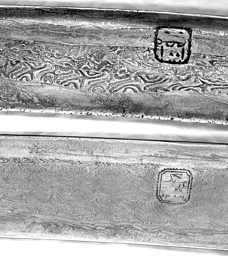

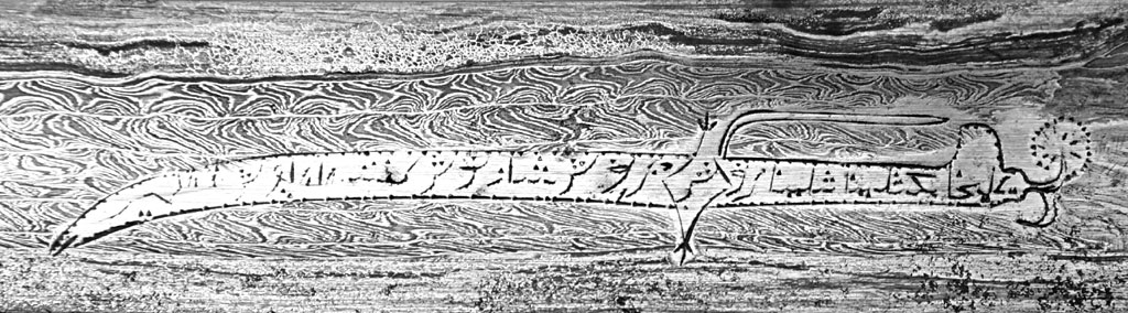

I had only viewed the mark on the older yataghan in abstraction previously, but if we accept the bottom line in the cartouche on the lower blade as the date 1204 (=1799, just barely 18th century) and interpret the similar region of the upper cartouche as being an honest date, then 1001 (=1592).

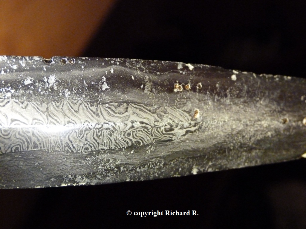

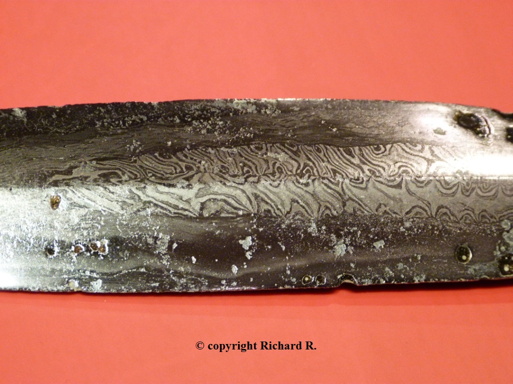

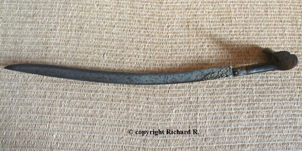

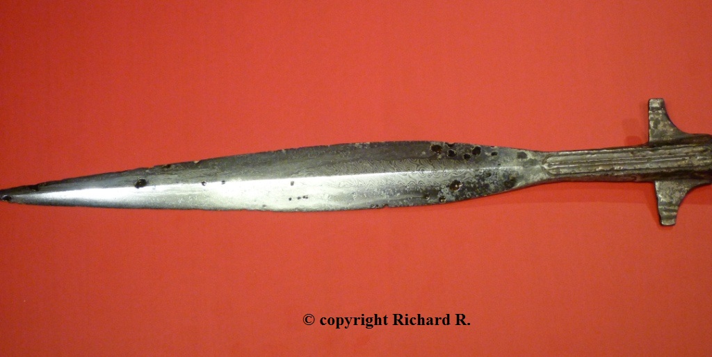

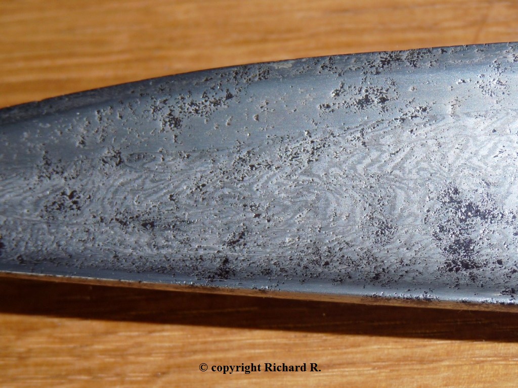

Thank you for the very good pictures. Could you send me pictures where I can see the whole Yataghans? I attache some pictures of a yataghan of my pattern-blade-collection. I need some help. Any ideas about the age and origin of this blade?
You also can find two pictures of a polished 9th Century twist core Western-European Spearhead to compare with your Eastern Spearhead.
Richard

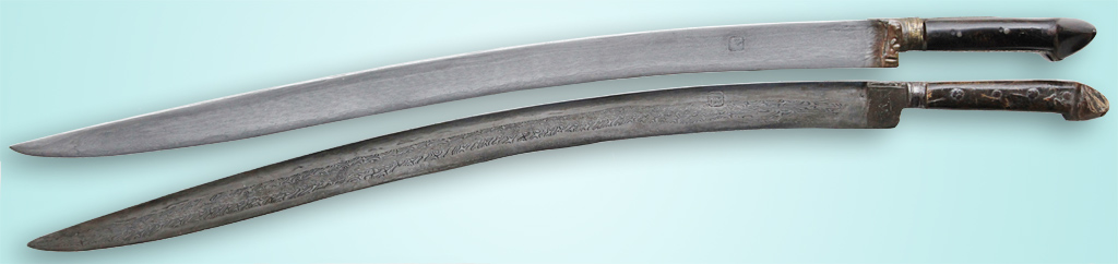

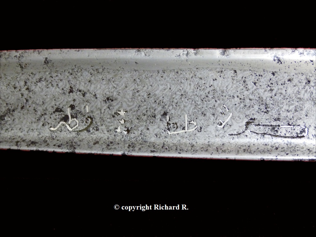

As requested, an overall picture of the yataghans (caution - the order is reversed from the close up of the cartouches above) and also of an inscription on the newer blade.
Unfortunately, I am no yataghan expert, having only collected a few with good examples of the twist-core work, so we will have to rely on other members to assist with the age and origin of your example.
Your winged spearhead is most attractive and it is nice to see the pattern-welding brought back to its former glory. Presented in polish, the nature of the bands of twist core is very reminiscent of what we are seeing on the yataghans.
I trust that you are familiar with Stefan Mäder's work in applying the Japanese style polish to reveal features in medieval steel.
