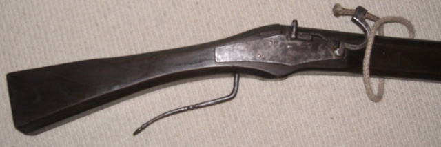

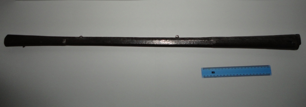

I'm looking for some information on a matchlock gun in my collection,The gun weighs about 14lb with a 3 stage swamped barrel of 34" the calibre is about .65/16mm. Whilst the gun has been restocked in oak in the recent past, it's just possible that the lock was associated,as a modernization,during it's service career. The breach shows signs of the removal
of the original integral pan and cover,but later damage/erosion to the filling insert suggest this was done long ago.
I think the barrel might be mid 1500s and possibly German in origin,but I would be happy to be corrected! Any thoughts on this gun will be gratefully received. Is the profile of the replacement stock correct for the period? I can't see a way to post the essential pictures to go with this thread,so I would be pleased to receive some guidance,on this subject as well.

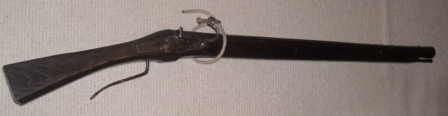

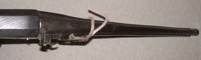

Here are the photographs as promised,sorry for the delay.I do have better quality images than the down load limit allows,which I could send direct if this is within Forum rules.

Your assumptions were almost exactly right:
Your composite arquebus consists of an early South German (almost certainly Nuremberg made) Landsknecht arquebus barrel; the way the barrel is staged - the first, rear stage seems to be round - assigns it to the 1520's-30's. The original long barrel tang and rear sight have been removed, and the pan is of Italian ca. 1570's type. The lock and stock are quite crude modern reconstructions and do not meet the correct style: while the lock is of incorrect 1630's style the stock vaguely recalls 1580's Italian stocks. As the stock is new the lock cannot be a replacement.

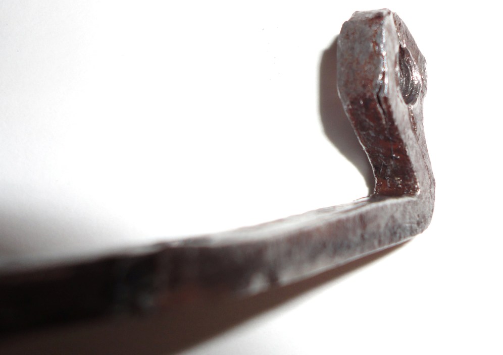

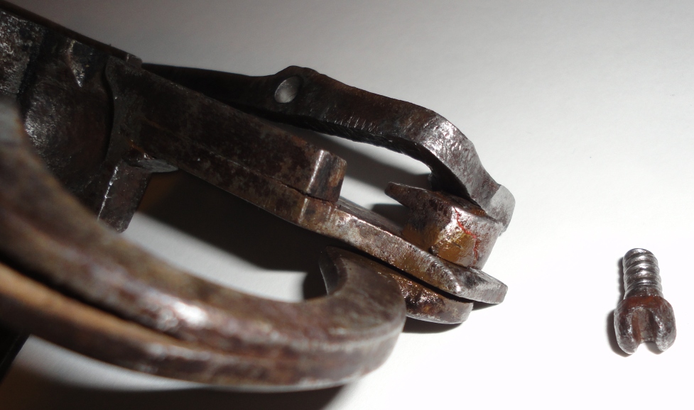

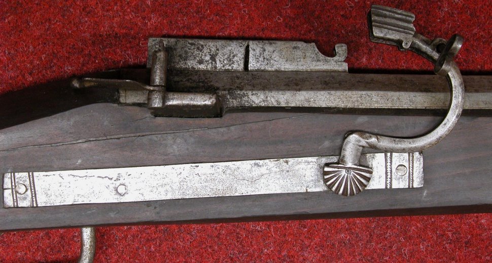

I was sold this gun as a 17th Century composite piece, however, I suspected the barrel was significantly earlier and it is gratifying to have this confirmed by Michael. It is interesting that Michael says that the pan and cover are 1570's Italian in style. The pan and cover are integral with the lock plate, which I realize is not remotely obvious from my poor photographs!
This lock is rather a conundrum. When I bought this piece I dismissed it as of relatively recent manufacture as is the stock, however on close examination it does have some considerable age to it and its action is as good as any I have examined, a good working lock. The sear bar and serpentine crank are of wrought iron construction and show signs of de-lamination which I have seen on English locks of the Civil War period. I have taken some close up pictures of the lock which I hope illustrate this and emailed them to Fernando. When I mentioned earlier that I thought that the lock could be associated with the barrel, it was only because of the considerable care taken to match it to the barrel profile and the work is old. This led me to wonder if the re-stocker found them together in some old wormed stock which we would have conserved! Fanciful maybe, but on reading Michael's threads on how these guns were kept serviceable and were modified for hundreds of years after their original manufacture, even to the fitting of percussion locks, who knows.

Simon,
Believe me: the lock and stock were made in the early 20th century at best, disregading the 'aged' patina and the fact that the lock parts are of wrought iron. Italian forgers 'workshops' did that at large (and still do). They result is often unbelievably good for the inexperienced eye. You must have dismantled and compared a great number of original matchlocks, studied their quality and compared them with forgeries in order to at once judge the differences.
As I said, the barrel was certainly taken from a Landsknecht (mercenary) arquebus, so its original destination was 'military'.

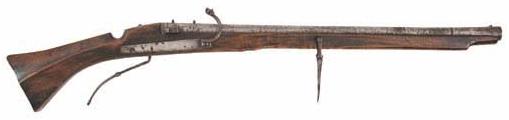

The sad fact is that your 'arquebus' is a crudely composite piece and, in its present shape and to the inexperienced eye, vaguely tries to convey the impression of an Italian 1570-80's matchlock musket but is of incorrect shape, weight and length. Italian (and German) original muskets of that period had fish-tail buttstocks, were at least 1.58 m long and weighed 8 kg and more (sample attached).

Pictures resized to uploadable parameters:

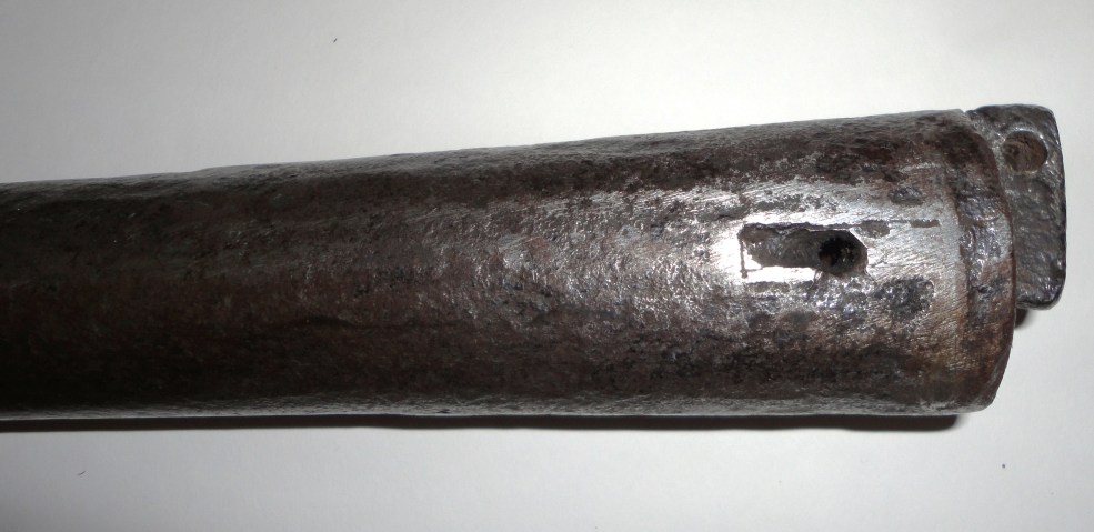

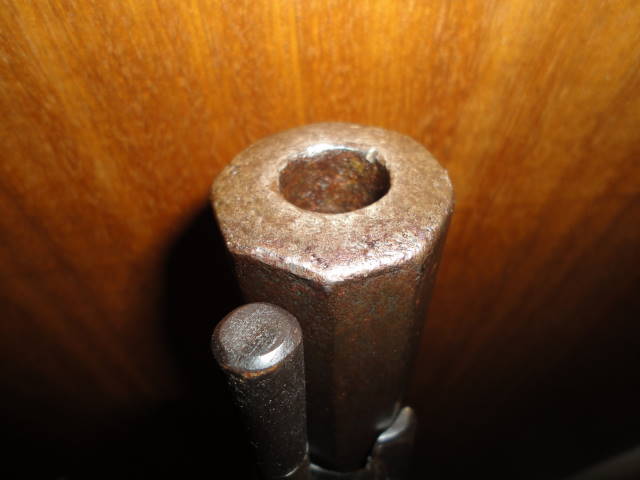

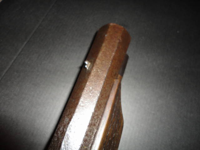

Before going into the required details, I would have to see the following close-ups:
- the muzzle slightly slanted, and the present caliber measured in mm
- the area where the original rear sight was fixed to the top base of the barrel
- Are there traces of a former foresight - I strongly expect them to be there!
Based on this information, I could tell you a lot more, especially as the originally dove-tailed pan and cover were obviously removed as well, so the barrel itself is just a fragment compared to what is was like almost 500 years ago, and I am afraid it will never look the same again. Anything you might probably add, in my opinion, would not by far come in the slightest near the original impression.

I hope these photographs provide the detail that you need. The bore
diameter is 16.5mm.

Alright then! The bore seems to be the original which is very good as most early barrels were drilled out in secondary use.
