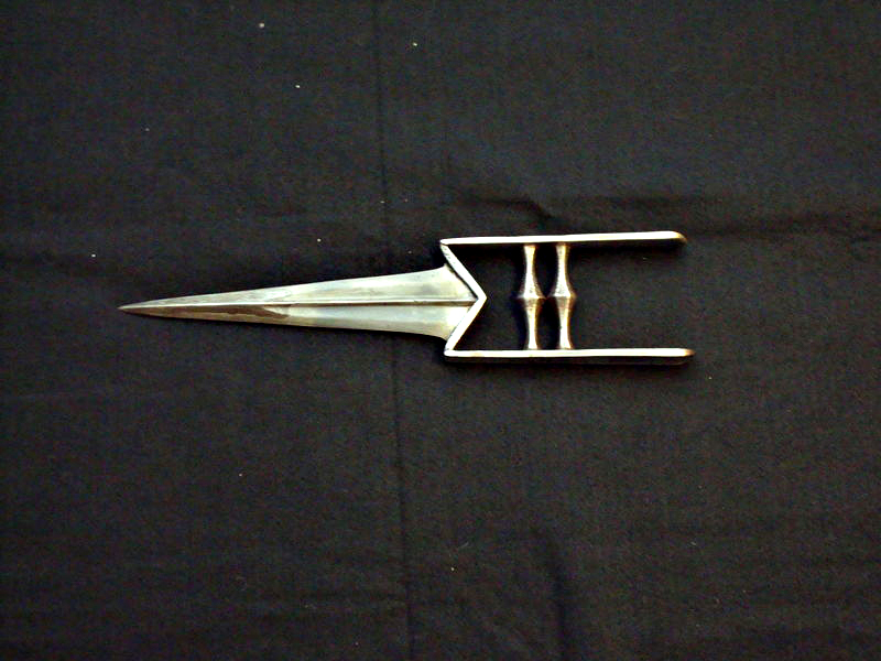

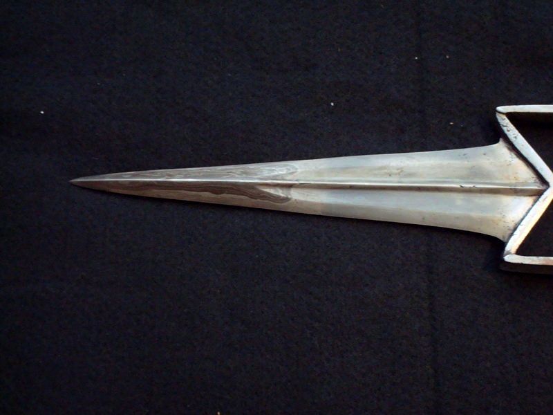

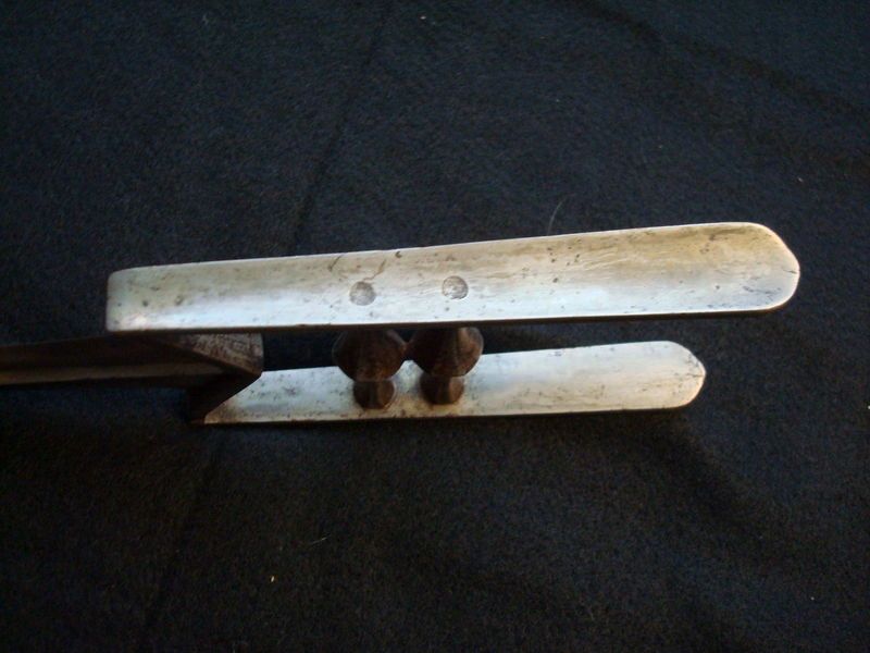

Here is a strange beast. I picked this up this week and it arrived the other day. Now all of the katars that I have seen are made from one type of wootz blade or another but this one is pattern welded. It is quite heavy and thick compared to my others. What I find interesting is the dark steel at the tip. I have seen a number of wootz katars with the tips broken off this makes me think that these wootz tips were a bit on the brittle side? Maybe this smith forged this one out of pattern welded steel to give it a more resilient tip.

Lew,
Your logic does make sense. Wootz is brittle. When it comes to sword blades, it has great strength against cutting-edge directed impact, but not against front or side impact. This katar may very well be an attempt to addres this weakness (perhaps similarly to scarf-welding effect and heat-treated/tempered edge). I cannot think of another examples/references, but you may be on to something. Good thinking!

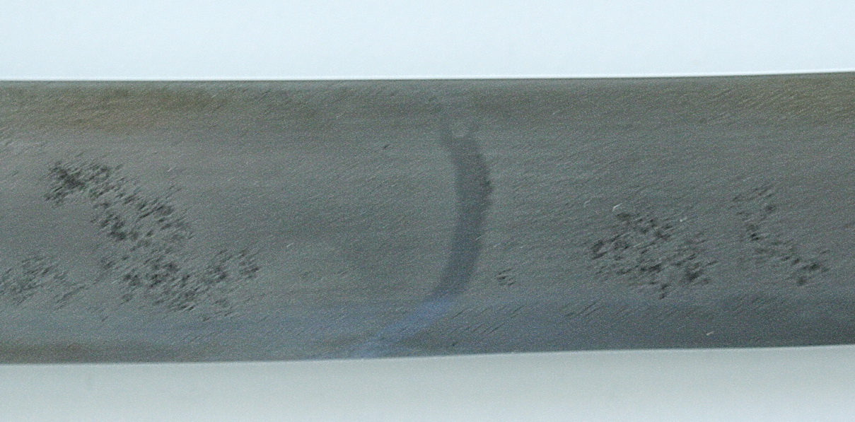

Hi Gentlemen,
I believe the sword you are referring to is owned by Jens, see attached photo.
Regards to all those in their 'dotage'.
Norman.
P.S. It was mentioned in a thread that I started so perhaps I have an unfair edge!!!!!!!

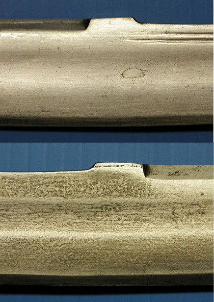

Old 16th October 2011, 04:01 PM   #15
Jens Nordlunde
Jens Nordlunde's Avatar
Location: Europe
Posts: 2,718
All right Alex,
Here it is before you start asking me for it .
Jens
P.S. sorry for the poor quality of the picture, but I am sore one can see what you mean.
Old 16th October 2011, 04:15 PM   #16
ALEX
ALEX's Avatar
Posts: 936
Now, this is scarf welding
