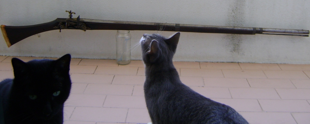

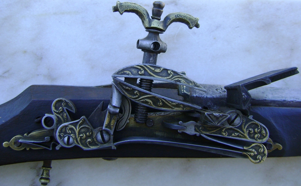

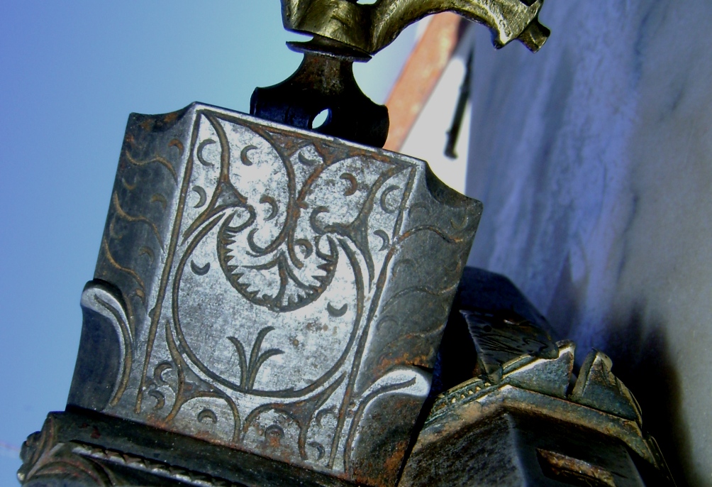

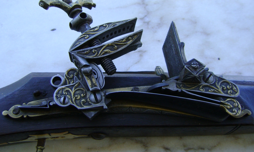

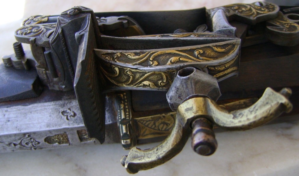

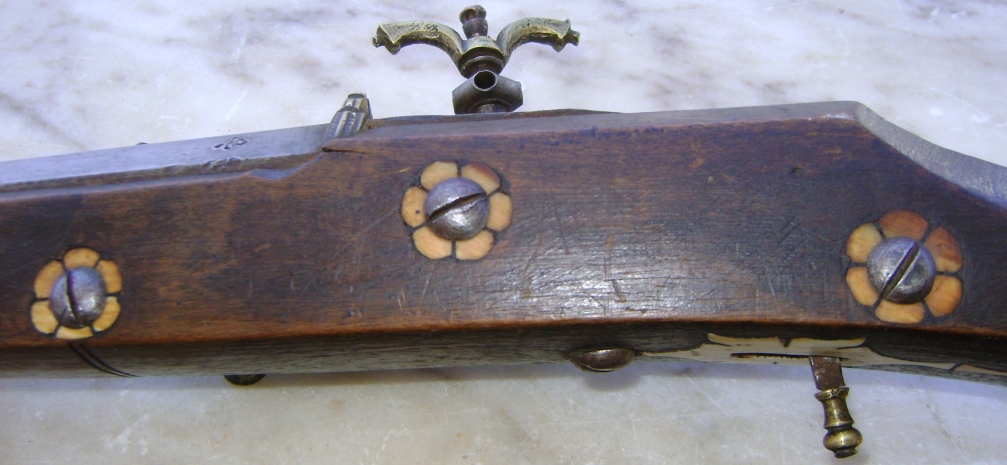

Although i have been more into European stuff, i have acquired this Kabyle type musket mainly because of its lock; a large patilla (miquelete) specimen with a dog catch (calço atrás). I thought the brass decoration was only superficial but i now notice it is plated. The frizen is huge, to ensure enough sparking from low quality flints ... i would say.

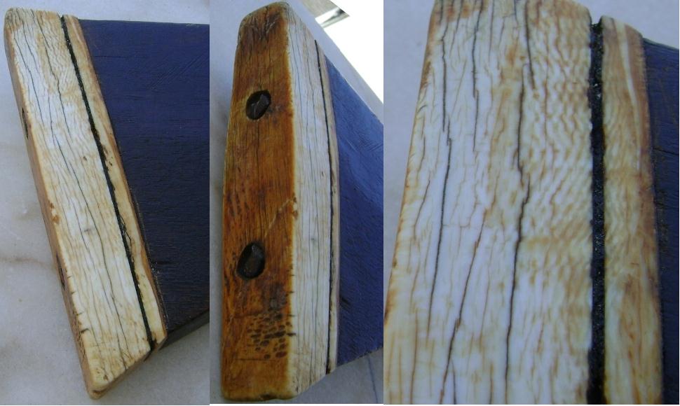

The butt plate and stock decorations would be camel bone, as i was told ... and so beleive; it would hardly be ivory.

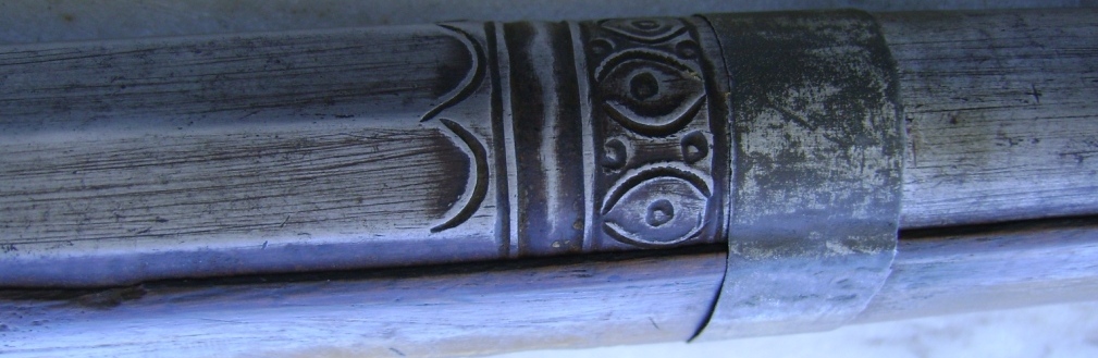

The punction marks on the barrel are certainly meaningless, with the 'commercial' intent to make it look Spanish.

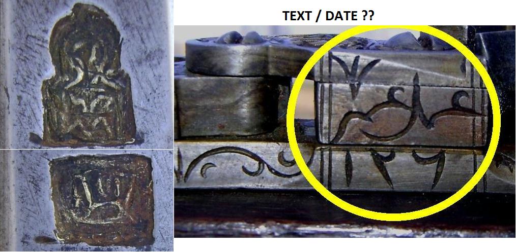

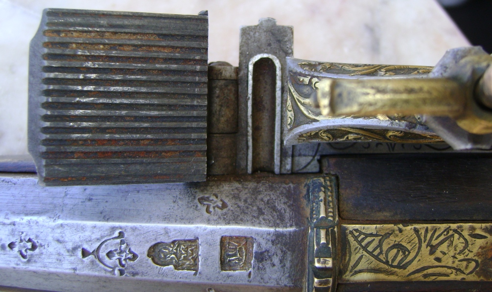

However the marks under the lock seem to be Arabic caligraphy; possibly a name and a date, in my imagination. Could i have some help to figure out whether these are indeed Arabic letters/numbers?

It reads 'Amal e Omar (work of Omar) the number underneath read 126, if it was 4 digits then it could be the year it was was made. I'm guessing a serial number. Nice musket by the way

Your's looks to be in good condition. The lock still retains most of it's brass over-lay. These guns have their large locks inleted into the stocks only about one-third. Every one I've seen is this way. The locks all look identical. An interesting aspect of your gun is the octagon-to-round barrel and metal ram rod. Most all I have seen have tapered all octagon barrels and wood ram rods. Interesting. How long is the barrel on your gun? Rick.

Nice gun I think, I may be wrong, that occasionally A.H. dates have the last digit missing if it ends in a 0. If that was the case ? then it would be 1260 A.H. 1844 A.D., would be nice if it was
My Regards,
Norman.
Unfortunetly, it does not happen that someone would just leave the zero out. We have to remember that it was the Arabs who invented the zero. However it might be hiding under that yellow line

... It reads 'Amal e Omar (work of Omar) the number underneath read 126, if it was 4 digits then it could be the year it was made. I'm guessing a serial number. Nice musket by the way ...
Thank you so much for the precious translation, AJ1356. A valuable contribution indeed.

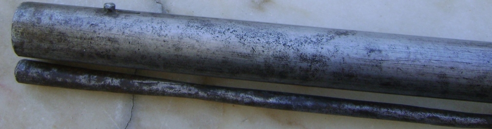

The barrel measures 1,13 mts. (approx. 44 1/2"). The musket total length is 1,53 mts.; with a caliber of approx. 17 mm and a weight of 4 Kgs, incl. the ramrod. I wouldn't know whether the ramrod is the original one, but it fits fine and has a rather crude aspect, consistent with the period.

… I may be wrong, that occasionally A.H. dates have the last digit missing if it ends in a 0. If that was the case ? then it would be 1260 A.H. 1844 A.D., would be nice if it was ...
Bingo Norman. I have been digesting that hypothesis for a while; it makes a lot of sense. Looking at the Kabyle examples at Tirri's book, which later occurred to me to consult, the kind of date/s you suggest are similar to those in the book examples (Islamic Weapons, page 38).
Originally Posted by AJ1356
… Unfortunately, it does not happen that someone would just leave the zero out. We have to remember that it was the Arabs who invented the zero. However it might be hiding under that yellow line ...
Not necessarily a question of failing or forgetting the zero, but maybe an option, like a habit practised by this or another smith, as Norman appears to know of.
I find it more plausible that the fourth digit is missing in a date, for whatever reason, than the three digits representing a serial number, specially in this type of weapons. The date 1260 A.H./1844 A.D. seems quite logical for this gun's age.
Anyway there is no fourth digit hiding under the yellow circle.

Fernando and Norman are right for the datation: 1260 A.H. 1844 A.D.

as often for this type of weapon, the decoration is later than the manufacture of the gun. Here barrel is XVIII° as flintlock and decoration is AH 1290/AD 1873

They could be obtained by the offshore grips, but so much blades were reused or transformed , so much barrels were abandoned. Maybe for a question of length or for calibre? The barrels used by the Algerian were long and the calibre was normally 16 mm.
They imported 2 models of barrels:
Barbarin model (coming from the word Barbaresque)):
octogonal on all its length
mouth of the barrel in form of tulipe
North of Italy import via Genoa
generally signed near the thunder (Cominazzo, ...)
Janissairy model
Octagonal (thunder), then rounded off up to the mouth
Ottoman or Balkan import
I add that usually the Janissairy model is shorter than the Barbarin.
It seems that your barrel is a Janissairy type and the very good marks and writings seems to confirm it.
