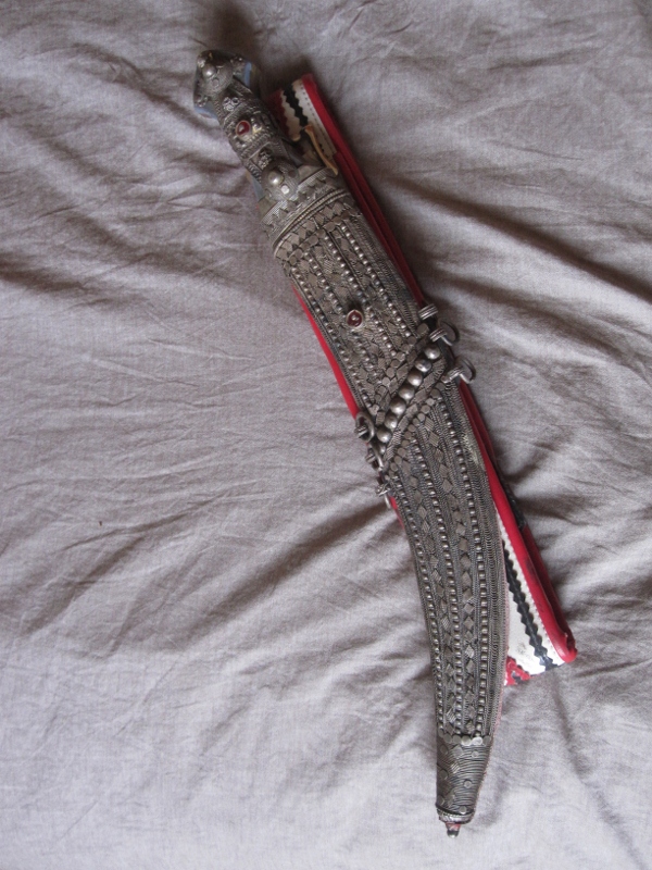

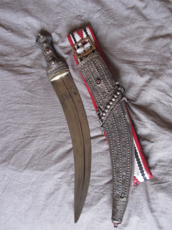

Hello All,
Through the time I have spent collecting (not much :P), I have came across various arab arms of different quality that employs plastic or bakerlite hilts. In total, I have atleast seen a couple of swords in Badawi style with plastic hilts, all of those had older blades, one with a very fine european one and one seems locally made but imitating persian style. This btw, are not to be mistaken with modern repros.
I also came across persian swords with plastic (one had a pink plastic hilt!) and a few with bakerlite (similar to the example owned by David, Aka Katana)
So how wide spread the usage of plastic in arabia? and any picture examples perhaps?

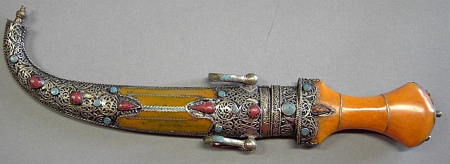

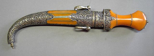

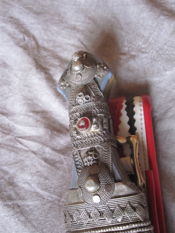

Sadly, I do not have any picture of those as they are sold before I could take pictures of them. but I have an example, A jambiya; it has heavy silver fitting, of good quality compared to the modern ones still being made. The blade is old, sharpened and of good quality, but the only let down to me which made me hesitate to buy it ( it was cheap as dirt) was that it had a plastic hilt. There are almost identical examples sold by oriental arms, so that added abit of confidence to me and I took it.
Here are some pictures:

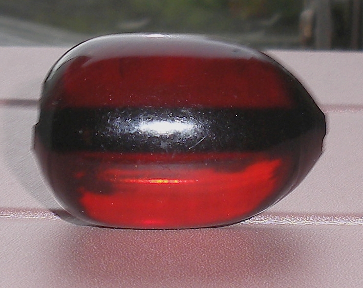

Smile Faturan
Interesting Gavin. I might have a bead of Faturan in my miscellaneous treasures drawer. It's large 2" long X 1" thick and has a clear cherry amber color and is at least 100 years old and shows signs that it was turned on some sort of lathe to achieve its tapered lozenge shape.

if you an find 32 others like this one in your drawer you will have a very expensive TASBIH (prayer beads) in your hands The 33 count tasbih goes for about $1000 in Turkey, if old and authentic..

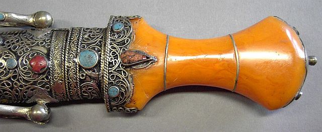

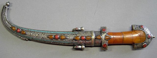

Very interesting the link with Faturan. I have in my collection two koummiyas with hilts that might be made of Faturan.,
Old 29th August 2020, 10:40 AM   #15
francantolin
Posts: 969

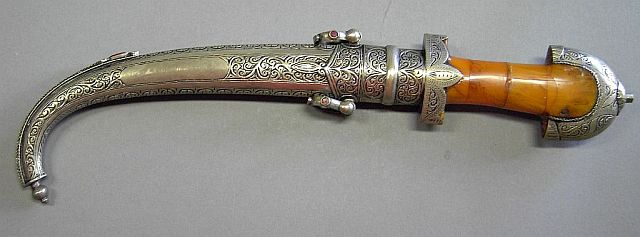

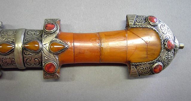

Sometimes strange hilt material are mixed on really nice quality items
I have a yemeni jambiya with an hilt made of plastic-amberoid
and a yatagan with broken horn grip with a large old bakelite repair
( around 1900 I think )
I'll post some pictures
