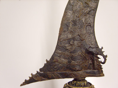

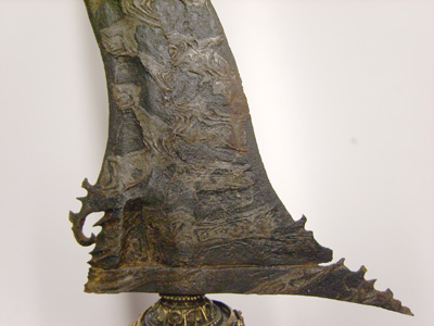

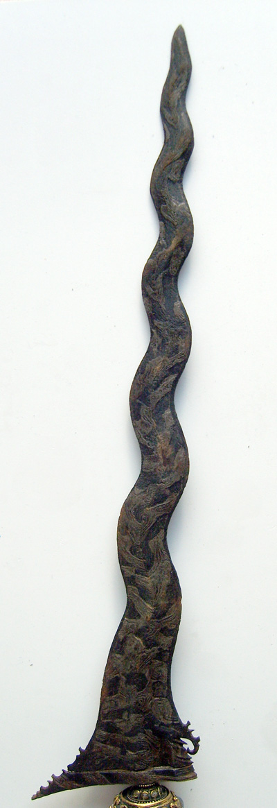

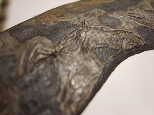

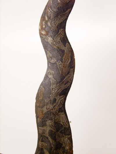

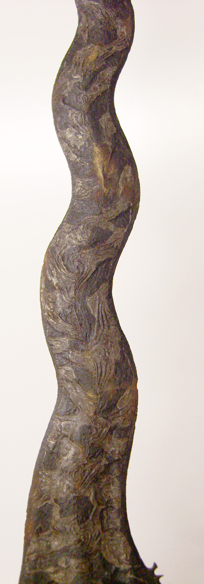

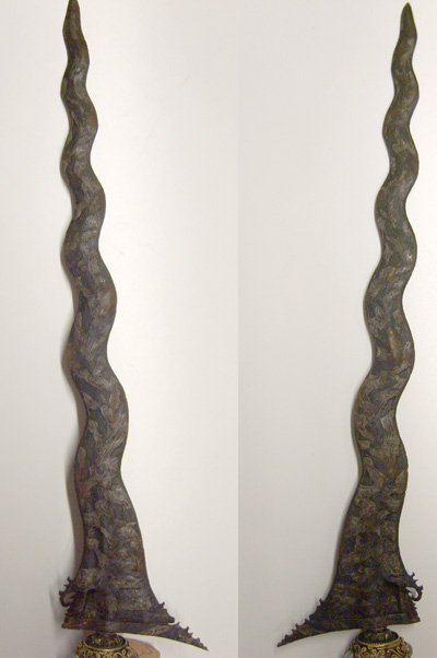

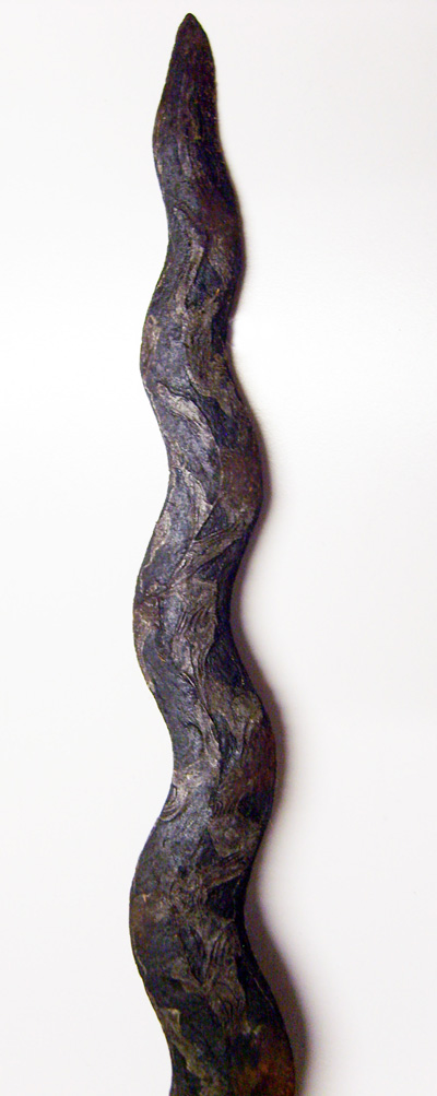

WHO CAN HELP ME TO IDENTIFY THIS PAMOR?
SOMEONE TOLD ME THAT THIS PAMOR COULD BE: WALANG-SINUNDUK? BUT I’M NOT SURE ABOUT IT. YOUR OPINION/ ANY COMMENTS WIL BE WELCOM, I WOULD APPRECIATE IT VERY MUCH THANKS IN ADVANCE

No idea about the pamor, nevertheless an exceptional blade. My compliments.
It should look even more beautiful after etching. |

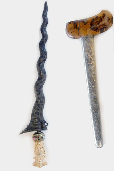

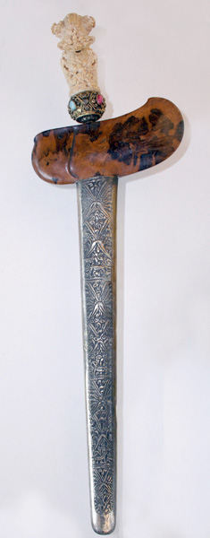

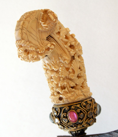

Here is a picture with his sarong. further nobody who can tel me anything about it?
#4 |
Join Date: Jun 2009
Posts: 1,328
Very fine ensemble, congratulations!

Would sort this pamor in maybe to the family of lar gangsir or ron kendhuru!? The pamor seems washed out at some places.![]() Regards, Detlef |

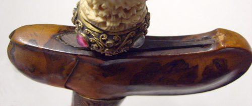

As to pamor I agree with Sajen: this could be a variation of ron genduru.
The hilt is obviously Maduran and the selut suggests me a Banjarmasin influence. In conclusion a great piece ! |

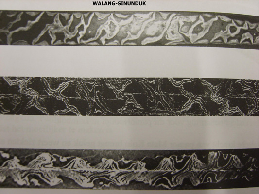

One of the guess that it that it could be: walang-sinunduk comes from a Dutch book: "Pamoratlas” by: Ing.ean.Veenendaal. Page 86 shows three drawings/pictures of: pamor walang –sinunduk the middle one shows some similarity in appearance, but I found so far nothing else to compare. So I am still open to any suggestions

IMO: a kind of lar gansir. Also walang sinuduk possibile |

This blade has a very strong Madurese flavor and Walang Sinuduk is a Javanese pamor so is it applicable? The name game would say Alan? Best regards Jean |

Alan would say:- dealer's montage, recent blade.
But a pleasant looking piece composed of nice individual components. |

Mr. Maisey it is possible to explain why this blade is not old? I know I ask you to do this through a photo, but I would appreciate your explanation. |

Based upon what I can see on the computer monitor in front of me, this blade looks recent.
My opinion is based purely upon my experience and what I can see. I am unable to provide a course in how to identify recent Madura blades, or blades from other origins, by way of the internet. It becomes a matter of :- "if it looks like a cow, its a cow" However, my opinion could change if I held it in my hand. |

Hello Sirek,
Where did you obtain this Keris ? Is the blade a proper fit with the wrangka ? Best regards, Willem |
#18 |
Join Date: Nov 2009
Posts: 172
The keris was owned by a Dutchman (I knew him not further)
But after he had passed away it came into my possession. Later I tried to get some information such as: - how and where the keris had come into his possession - since when it's in the Netherlands but unfortunately that information was no longer available The fit is acceptable, only slightly worn out (I do not think it’s adjusted to fit) |
