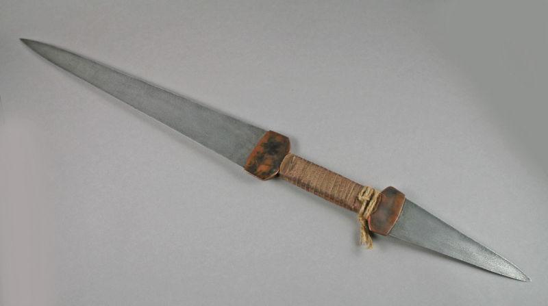

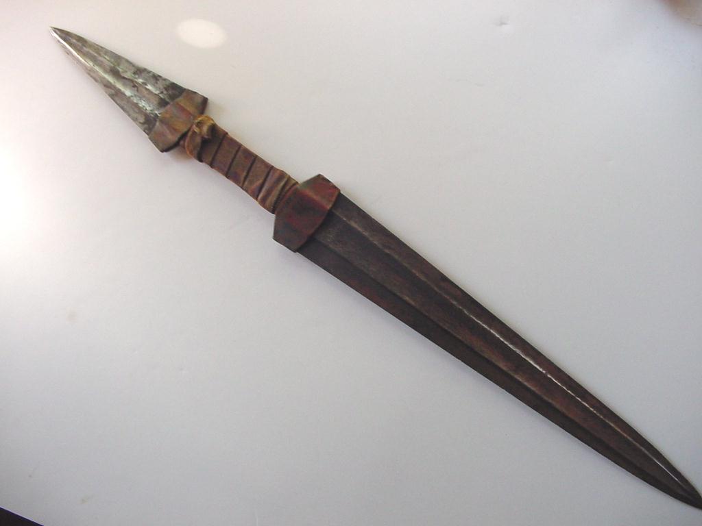

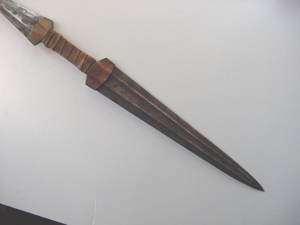

This came in the mail today. It appears to be the real deal. It was spendy as someone else wanted almost as bad. The mystery for the moment is it is fluted on both sides one other I have photos of is fluted opposite side concave. Does anyone know of examples that I could access online? Thank you, Steve

Looks good to me, but I am not an expert. Have you tried the American Museum of Natural History website ?
Old 19th June 2011, 09:21 PM   #4
Posts: 10,867
Looking at this beautiful dagger I was compelled to search for more information. One of the greatest things to me about these weapons is learning from them, and it is exciting when information accompanies them, so heres what I found.

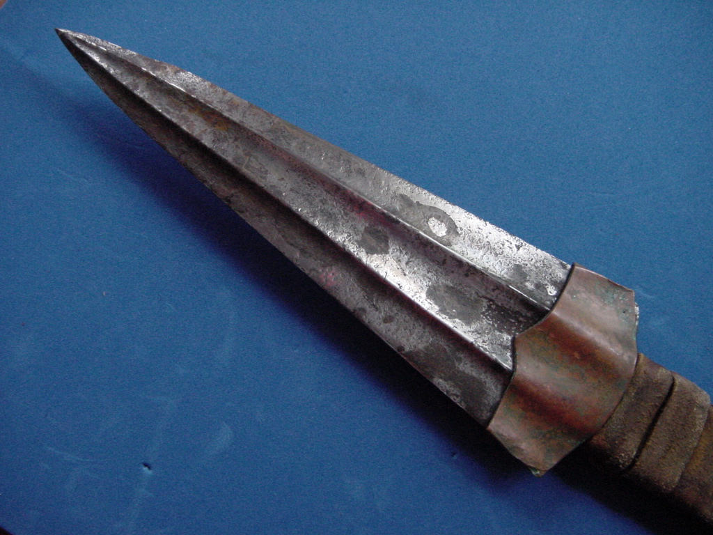

It seemed unusual from the examples I found, that this one had such perfectly symmetrical flutes rather than the usual midrib in the blade.
While some Tlingit daggers are dual blades like this (somewhat reminiscent of the Indian, Syrian, Sudanese haladie) others are with single blade and with two somewhat voluted arms extended up and outward from the opposite end of the grip.
The leather straps wrapped on the grip are part of a lanyard or tether which is usually wrapped about the body and wrist, these daggers are sheathed and worn at the chest.
This example is intriguing, not just by the superior quality metalwork and fluted blades, but the copper cuffs at the blade roots. These would suggest a weapon intended to reflect wealth or status, which this certainly appears to be. As I was amazed by the apparant skill of the maker, I wondered at what point the tribes began the use of iron over copper for blades.
I found this entry on the Tlingit daggers in "The American Indian" , A. Hyatt Verrill, N.Y. 1927, p.374,
"...the war knives or daggers were most remarkable. Originally these were made of native copper, hammered and ground into shape; but with the arrival of white men this metal was discarded in favor of steel. Securing old files by trade with the whites, these Indians softened, cut, ground and worked the steel into the most beautifully made and highly finished double edged knives. Often these are deeply fluted along the blade; not infrequently they are inlaid with silver or copper, and occasionally one is seen with the steel blade welded to a copper section near the handle".
It is worthy of note that this material was written in 1927, long before the considerable expansion in these Northwest regions and before widespread collecting of these rather esoteric items became popular, so it increases the likelihood of describing weapons actually still in use contemporarily. I would suggest this dagger corresponds more with these earlier known types and would fall into the 'real deal' category!
Excellent reading concerning the Tlingit, and to some extent the weapons can be found in:
"Crossroads of Continents" Ed. William Fitzhugh and A, Crowell, 1988 which has the paper, "Tlingit: People of the Wolf and the Raven" by Fredrick de Luna.
"The Evolution of Tlingit Daggers", Ashley Kristen Verplank, University of Washington thesis, 2009
"Keepers of the Totem" Time'Life books, 1993
"Metallurgy of the Tlingit, Dene, and Eskimo" John Witthoft & Frances Eyman, 'Expedition" Spring 1969
I'm glad this outstanding dagger was shared here, and I hope this information will be somewhat helpful in learning more about these daggers and the tribes who used them.

Jim, I should mentioned that it's 23 5/8 inches long, probably a war dagger, so i don't know how they were worn. You're right about the neck sheaths for the smaller ones. The hide sheaths incorporated copper on the ends to give the needed protection. You must have an enormous library. I need time to go thru all the very much appreciated information, Thanks

Thanks very much Archer! this really is a beauty and had no idea of the size.....sure sounds like a war dagger OK! Probably didnt wear this one on the chest...would look like one of those rapper medallions that weigh half a ton

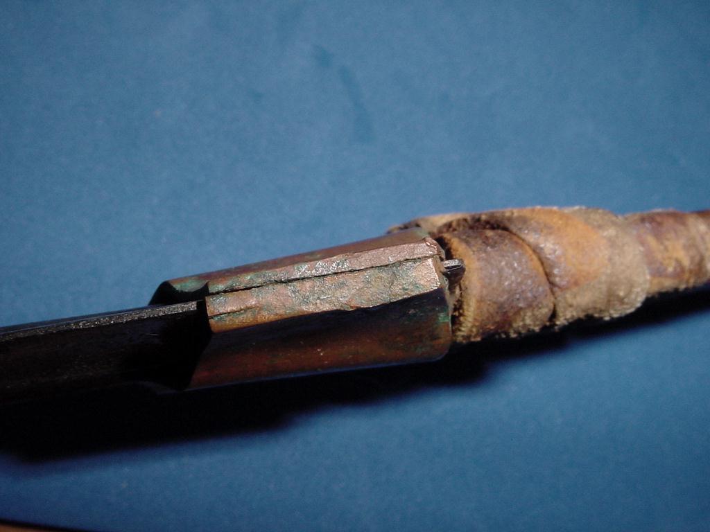

Jim i have ordered a DVD of the Evolution of Tlingit daggers. My Jun 19th post has a link well worth looking over regarding the Athabaskan version of forged copper daggers. Ward the swirls are volutes they appear in older European weapons and may be a link to Migration to Alaska. The copper bolsters are separate and swedged on.

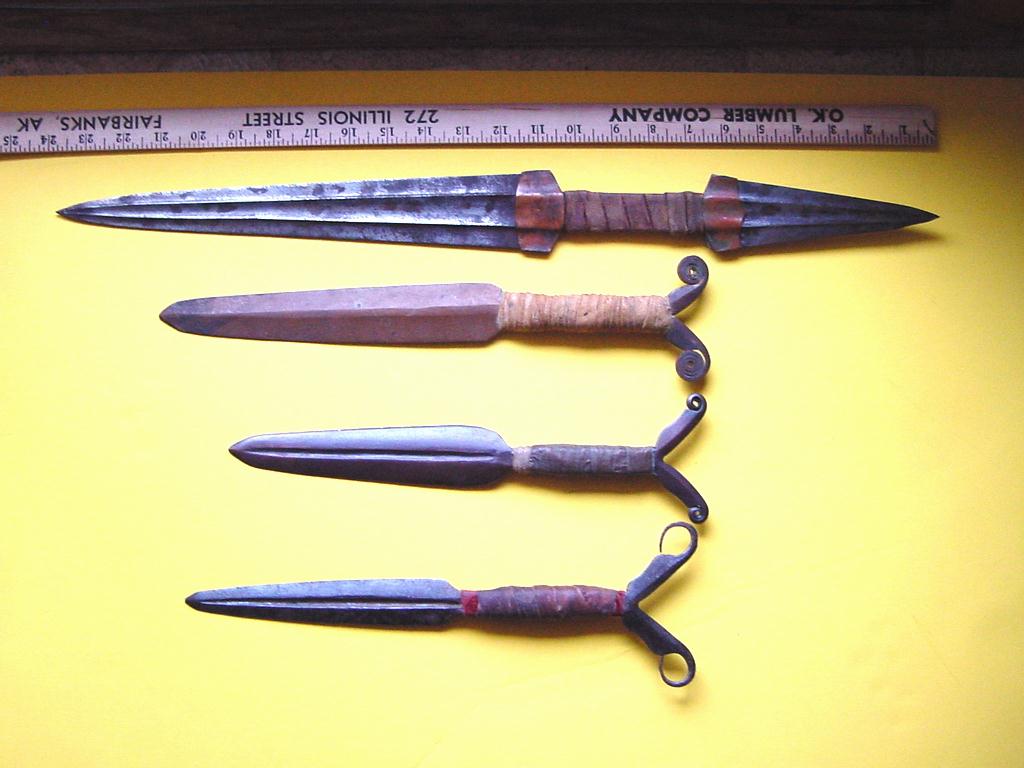

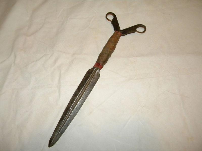

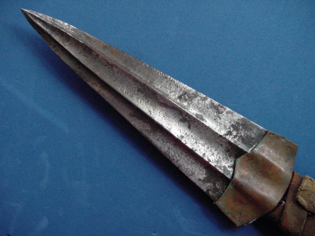

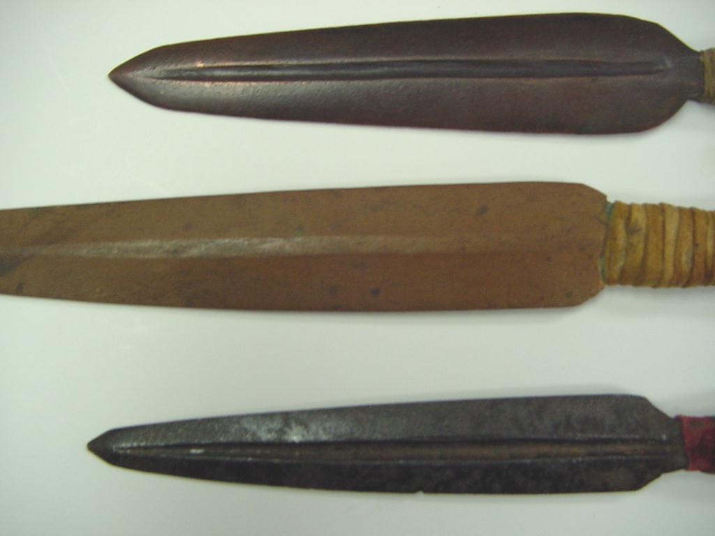

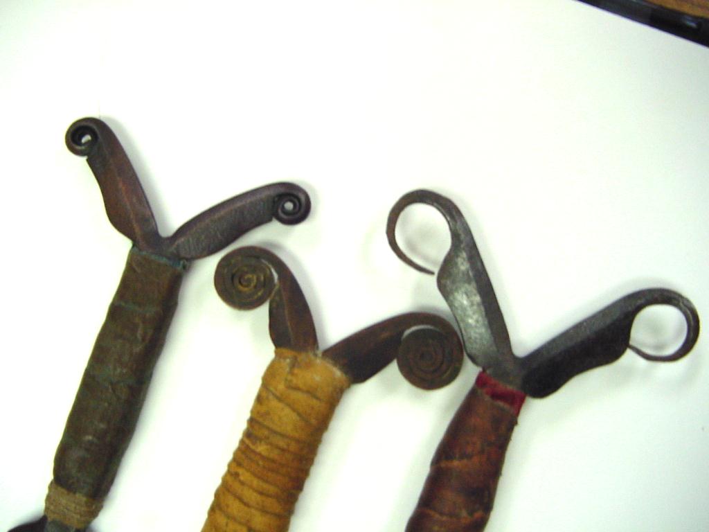

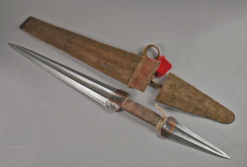

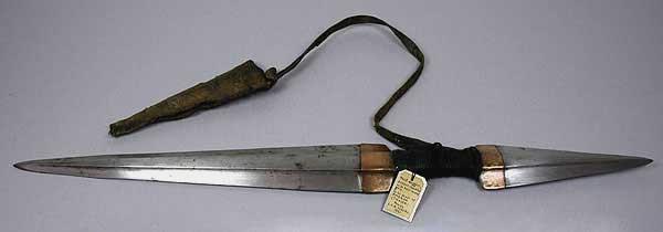

I put up some shots of the volute daggers. first from the top is all copper Athabaskan/ Dene in origins the third is all copper both of these are flat on one side but, not the rounded profile of the third and fourth daggers. Copper Tlingit daggers have a stepped central ridge due in part its thought to cold forming. I haven't figured out where these other dagger came from.
I found a forum thread that mentions, about the Slave killer never having actually killed, that being left up to a double bladed dagger called goox du een. if the slave wasn't released?? http://www.vikingsword.com/vb/showth...merican+graves

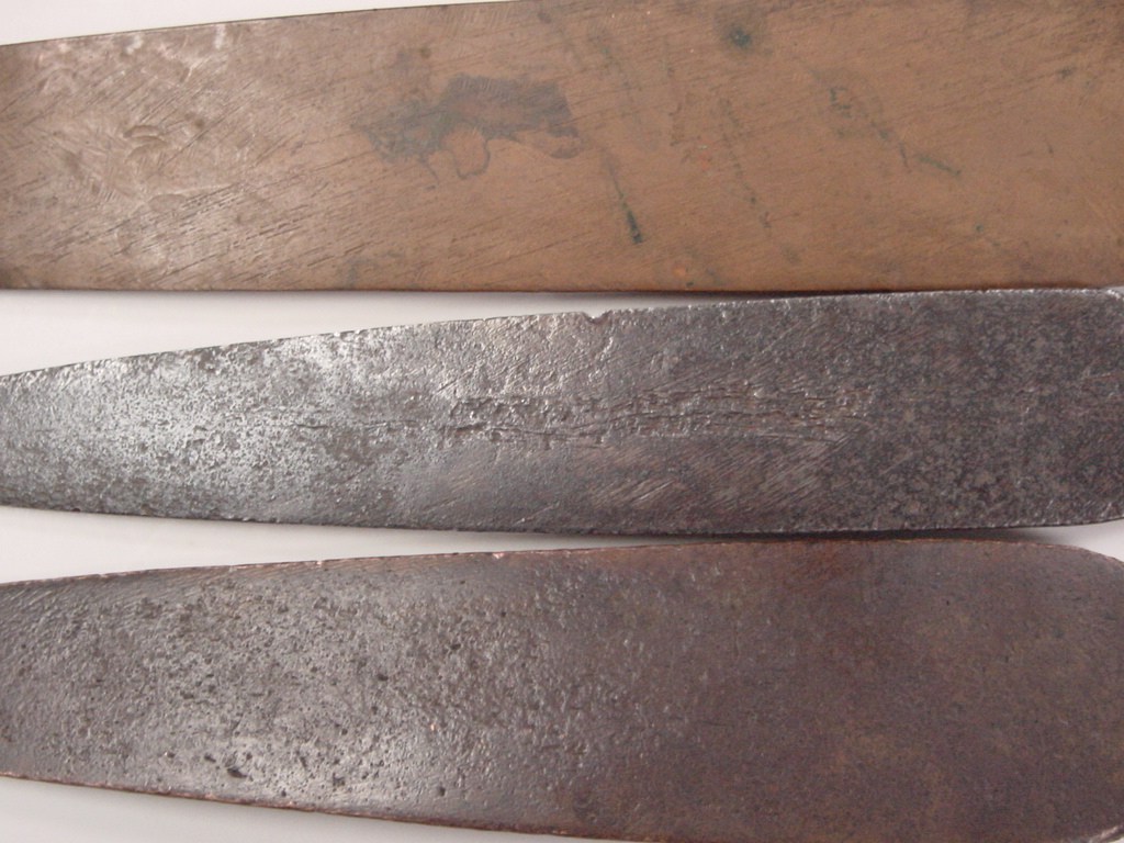

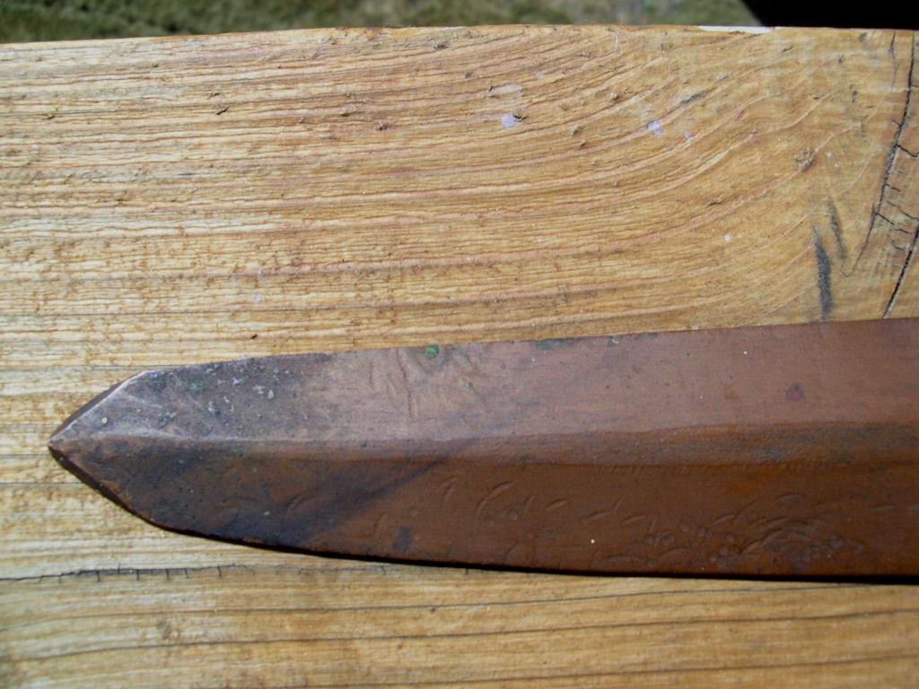

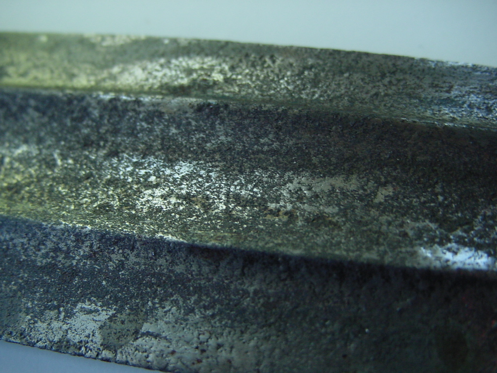

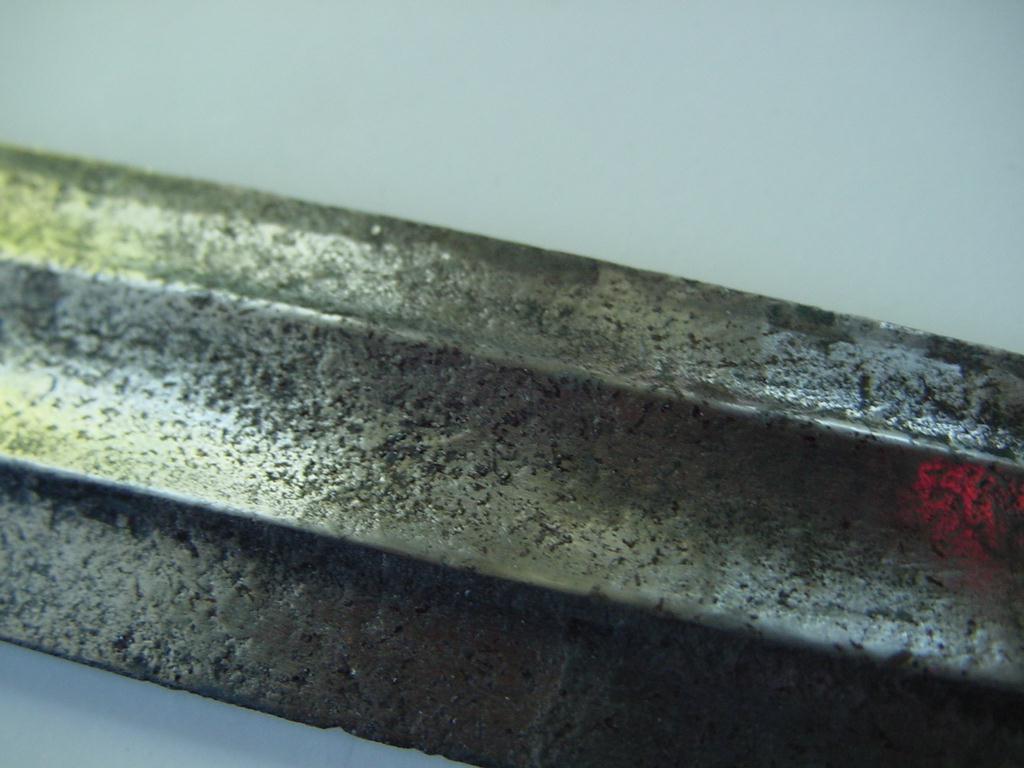

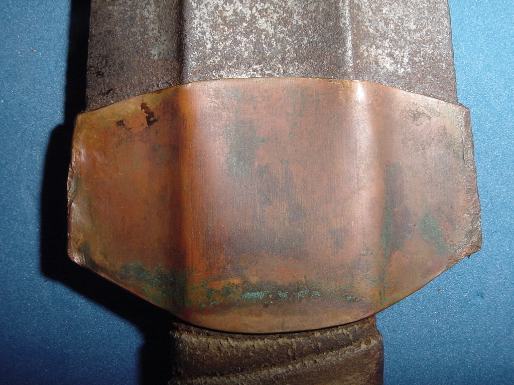

I included closeups of the blades textures in hopes some of our knowledgeable metal experts may see something of interest in them.
Oh, the eyes question Story goes they emulate rams horns.

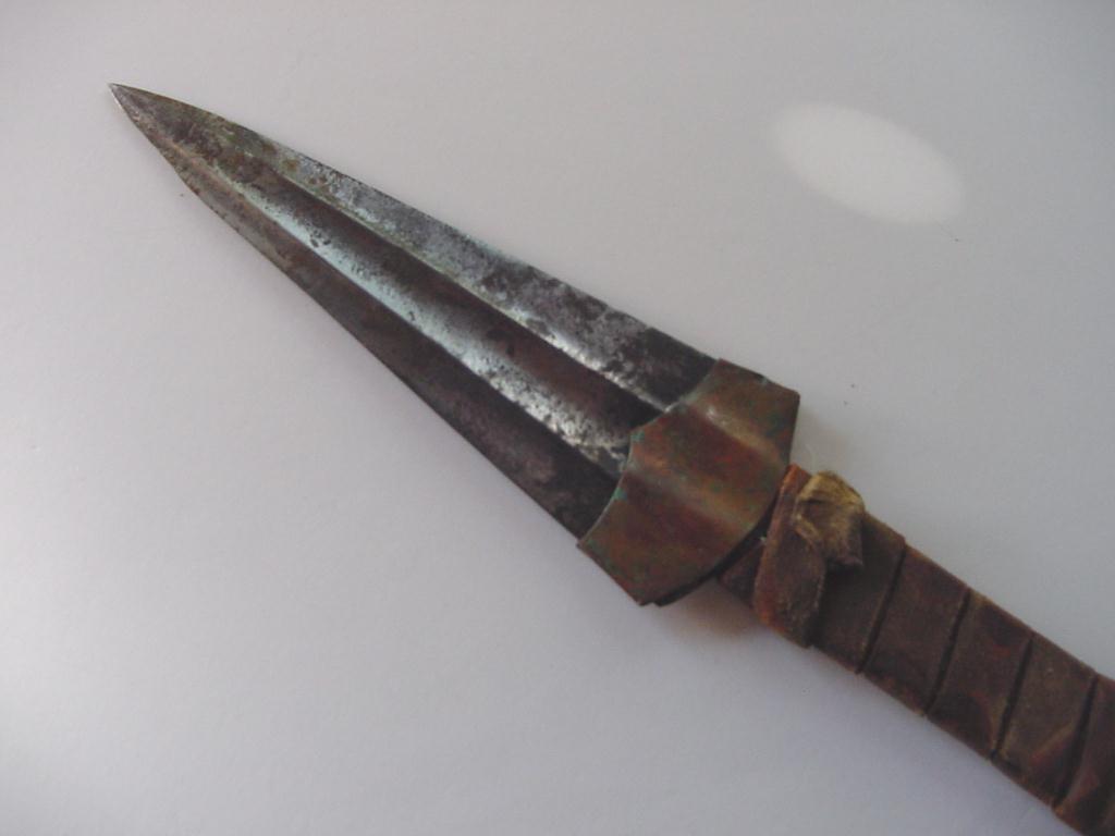

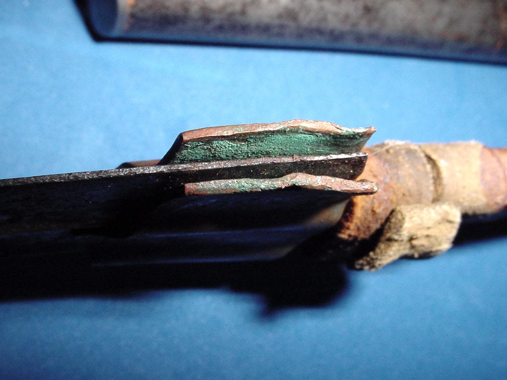

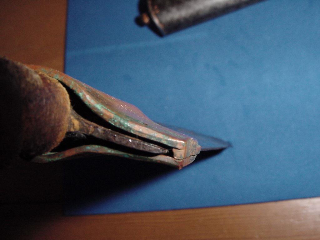

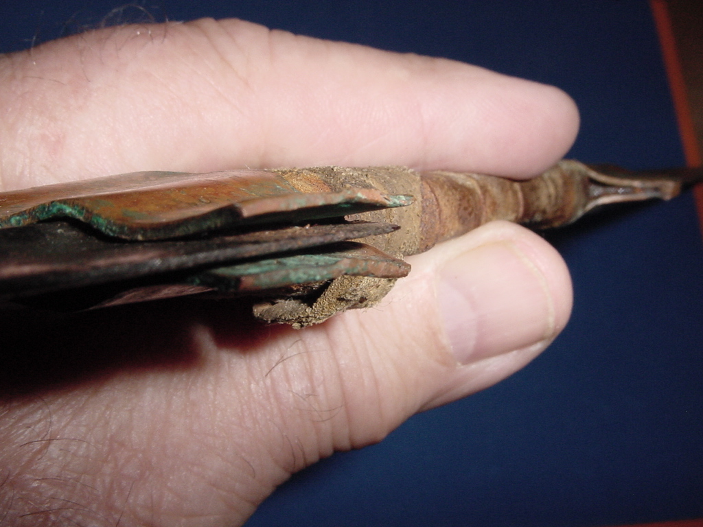

I'm puzzled as to just how the apparently Separate copper bolsters were fused together and pleased to see Solder wasn't a method. I've included several shots
of on side that shows old separation and some of those still firmly fused? or connected. Also a link to a bit on Haida warfare, etc.
