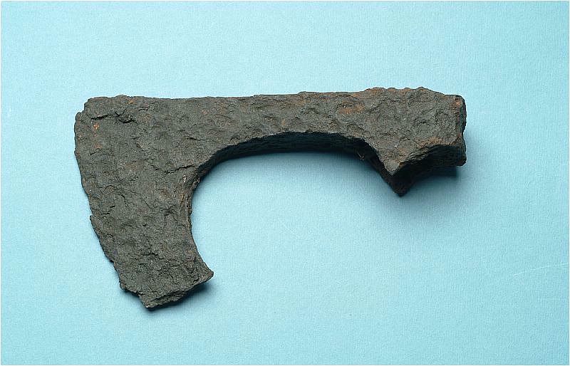

When talking about things related to Vikings and the Swedish iron age a bearded axe would look rather like this one. I don't know what the longobards used, but it seems plausible to me that their "long bearded" axes would be closer to this form than early halberds.
(This particular axehead was found on Gotland, and is dated to the Vendel period. For full details see http://mis.historiska.se/mis/sok/bild.asp?uid=224116 )

I tried to find some references that connect the longobards with long-bearded axes. I didn't find any (what actually doesn't mean much).
What i did find was the article "Langobarden" in "Reallexikon der germanischen Altertumskunde". Available online here:
http://www.archive.org/stream/realle...e/122/mode/2up
There it is noted that the origin of the longobards based on a long bearded axe is extremely unlikely. (I don't want to translate the lengthy reasoning behind this). This thesis is substantiated by archeological findings that at langobardian burial sites mostly swords, lances, arrowheads, and shields were found .

I don't believe that the weapon types for which these tribes were named were particular to them in any way. Certainly the spear people (Danes, Gots, Frises) did not seem to use spears more than anyone else. Angled tip saxes and fracisca axes were not particular to the tribes that bore their name, and those tribes seem to have used the same weapons as other German tribes. Maybe it's got to do with which tribe originated a particular weapon type; I don't know.
I am not wondering about the longobard people or the details of their association to the longobard axe; I'm just wondering if there's an established idea or anyone's ideas of what, specifically, this weapon was.
