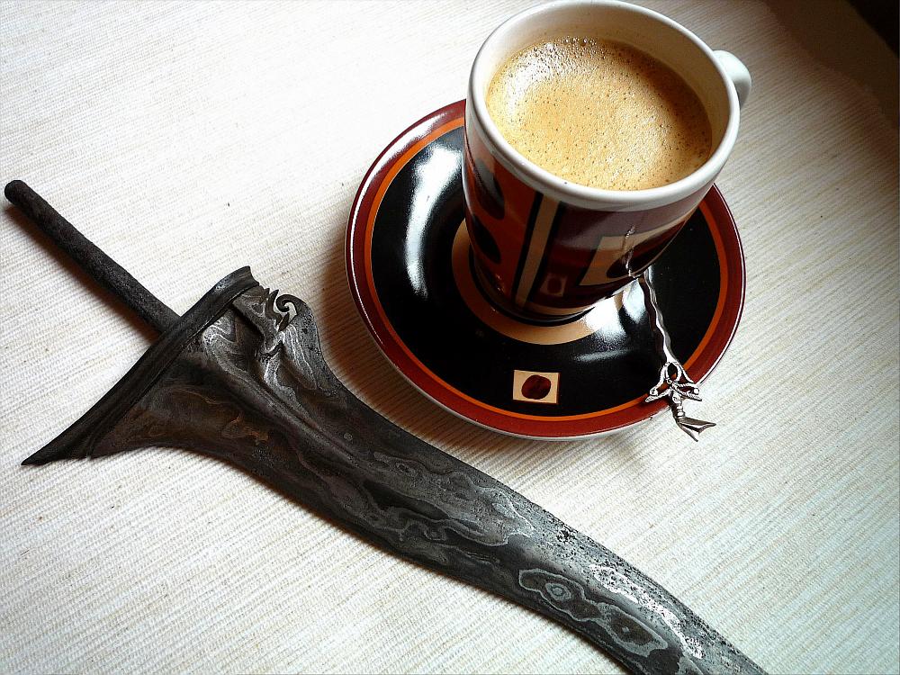

Since I'm notorious for leaving coffee stains everywhere, i felt challenged when i read on a knife-makers forum that coffee gives good contrast on damascus.
So, i selected a Bali tourist/soldier keris, i couldn't successfully stain with FeCl3, and made a lot of coffee....
First i followed the instruction given on the other forum and prepared the coffee with two spoons of instant-coffee per 200mL of hot water. Meanwhile the keris is degreased and etched for 2-5min in citric acid. The keris is then fully submerged in the still hot coffee. The pamor became visible after 2h and reached its maximum contrast after 6h. The result was rather disappointing. After drying the pamor was barely visible.
Next i repeated the procedure with "real" and strong coffee. That lead to the same result after 2-3h.
For the final experiment i added a teaspoon of citric acid to the coffee (about 4L). This gave a remarkably good result after about an hour (see photo). Leaving the keris longer in the coffee proved counterproductive as the contrast began to degrade after the coffee cooled down.
After the promising results i tried to stain the keris from this thread http://www.vikingsword.com/vb/showthread.php?t=13829
with the same mixture. However, this time the result was very poor.
Conclusion: Coffee may for some keris be a viable alternative to FeCl3 but may fail miserably on others.
For good results the coffee has to be hot and slightly acidic.

Since i LOVE coffee i also love this idea. Too bad results aren't consistent (though the results in the photo here look fairly decent) . I guess i'll stick to just drinking mine...
BTW, i like your "coffee stirrer"...

Hello Rasdan,
I cleaned this keris with citric acid, so i know what this looks like (a dull grey). Even without citric acid the coffee stained darker. That's the reason it is preferred by knifemakers (who can of course select the steels they are using).
However, I'm not sure what reaction causes the coffee to stain the iron. Main reagent is most likely caffeic acid.
The reaction needs more activation energy than citric acid as it works only when the coffee is hot. The citric acid seems to somehow speed up the reaction. I think when the solution cools down the citric acid becomes the dominant etchant again and slowly degrades the coffee-stain. At least the stain becomes dull grey again after a few hours.
The main reagent of cola is Phosphoric acid. It transforms red iron oxide into black iron phosphate. So it may indeed work. But i am concerned about the sugar. I don't want a sticky keris... ;-)
btw. i'm no chemist either and i guess "keris-professionals" would either use arsenic or have their keris stained professionally

Sweet.. So it's something in the coffee Higher acidity does not mean better staining obviously.

i was also surprised that coffee is frequently used for that purpose. I guess the reasons are is that it is readily available, requires no safety measures, and can be disposed off in your kitchen sink.
Of course results are more consistent using new blades with well defined steel combinations (e.g. 1.2848 and 75Ni8).
Nevertheless, i thought i would give it a try and share the results

when I got my first kris I tried the coffee method and results were actually quite good , later on I did have this kris etched with traditional warangan and the results were better but not spectacularly better.
Then I tried the same thing on two KNIL soldiers krises made in Madura , coffee did absolutely NOTHING there just literally a stain which could be washed off with water.

I have been sending some krises to be washed in warangan recently but I had one that I wanted to try to stain with coffee again.
I tried , after bringing the blade to a clean, after putting into coffee for 5 days the blade took a general , slightly, darker appearance with very very very faint staining here and there (although there probably was no “ pamor” to speak of).
Frankly speaking this is definitely my last attempt at staining a kris balde with coffee. It is simply not worth the effort and time.
