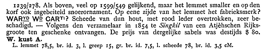

Hello friendcollectors,
I recently acquired an Aceh peudeueng with a stamp/mark on the blade.
There is another peudeueng in the Leiden museum with "almost" the same mark, which is written about in the Fischer catalogue.
There are only two different characters (the "Y and T" and the "R and the S"), but maybe they mixed up those two characters because it wasn't visible clearly?
(look at the questionmark after the mentioning of the stamp in the Fischer catalogue).
I hope anyone can help me with this.
I posted also the text of the Fischercatalogue.
Thank you in advance,
Maurice

When I read it I see what I would translate from the abbreviations into 'warranted' Wd 'cast .' .. the rest is a mystery .
So I'm thinking 'warranted cast steel' for part of its meaning .

I think Rick is pretty much spot on here, as these kinds of markings with this quality stamp referring to the steel are well established in many instances in many countries' blades. I recall spending some time finding someone to translate some characters in Manchu on a Chinese dao (not an easy task in itself and hoping for some mystical or key invocation, it simply read to the effect of 'tempered steel'. It is now fairly generally held that the 'Andrea Ferara' name on mostly Scottish blades was likely a term signifying good quality iron (steel) and appealed to the Scots.
This seems to be a fairly widely known style cavalry blade which developed concurrently with the British light cavalry sabre of 1796 and the German 'Blucher sabel' M1811 and had actually already been in use in Eastern Europe prior, with the favored 'hatchet' type point. Many of the British blades had been emphatically placing warranted phrases on thier blades in the late 18th into 19th c. and perhaps the practice might have been carried elsewhere.
Naturally this may be other than the warranted steel indicator, but is placed on the blade where that seems more likely than a maker or supplier, who usually marked on the forte of the blade or the spine near forte.
* of course I've seen something similar someplace, and I will probably not sleep til I find it !

Thank you all so much for replying. Indeed it seems that this stamp is used in more blades.
Especially the Aceh sword from Willem was most interesting, because it seems that this stamp was used more around this region. We now have Willem's sword, the one from the Leiden museum and mine with the same stamp and from the same region...
Fernando thank you very much for your links. I see it was discussed before, but I couldn't find it myself, so I think Jim can stop searching where he has seen it before and have a good well earned nightrest...
Thanks again,
Maurice

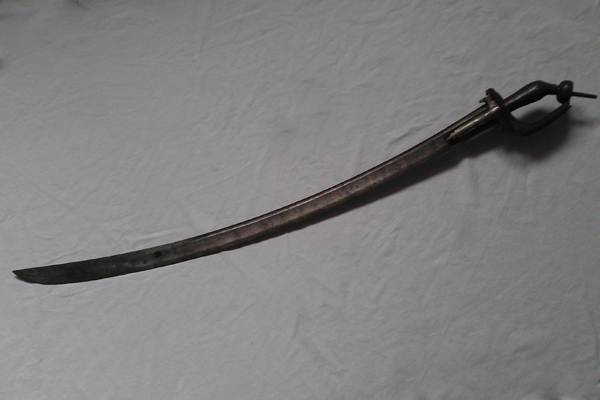

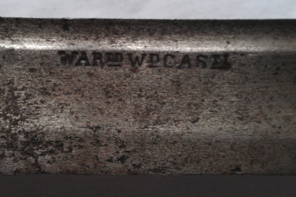

I am new here and I got attracted to this forum due to this post. I recently purchased a M1796 pattern light cavalry sabre with similar markings. I got it in my possession, however haven't been able to make my own pictures yet so I'll use the ones from the seller.
Then I saw another "Ethnographic" arm for sale at a local internet site. Here the markings are almost the same, however they are fully written, so not abbreviated.
The stamp reads "Warranted Ward Cast Steel". I think the font is even the same.
On of the possible "Ward"s is located in Sheffield. More info can be found here:
http://www.shef.ac.uk/hawley/project...and-payne.html
check out the marks in the 1880's here:
http://www.shef.ac.uk/hawley/project...rademarks.html
Anyone has another possible manufacturer Ward?
Still a few questions remain; is my M1796 an export blade? Where did it go? Germany? The East? America? It looks used (sword cuts in the blade) and it is sharp. Could this be a private weapon used on the continent (as it resembles the German M1811)?
Michel

Hi Michel,
Thank you for joining us here and posting this....welcome!!!
We have of course already discussed this stamped name with warranted and cast steel, which of course evolved into quite regular commercial use in various forms on tools, axes and edged weapons from about mid 19th c. it seems, perhaps even earlier.
The term cast steel had become seen on razors post 1772, and later on axes and knives exported to America. It is of course well known that the largest suppliers of Bowie knives in America were Sheffield sources.
The M1796 British light cavalry sabre was one of the largest in production it would seem and some of these were exported over a period of time, especially after they were superceded by the M1821 light cavalry sabres. However, they remained in favor, especially in colonial regions throughout the British Empire for the remainder of the century in many cases. Large numbers of these seem to have become surplus and entered many trade networks.
I admit I have not seen this kind of stamp on one of these before, but it seems to fall in place with the numbers of tools, axes, knives etc. which were exported to America in the 19th century carrying similar Sheffield oriented stamps. Despite there not being a great demand for swords in America, it is known that some were sent here probably among other materials if such case did exist.
This is of course a suggested possibility but with that information added to augment plausibility. The British M1796 did influence the Prussian M1811 Bluchersabel but only small numbers of these reached the Germans as far as I know. The numbers exported to other countries around 1814 of these were relatively small, actually only about 36 to America for example and in hundreds in most cases.
As I had discussed earlier in this thread, I had suspected this stamp might have been used in variation by the Bannerman 'surplus' complex in the early 20th century, where numbers of replicas were produced of certain type weapons, but I dont think these would have been among them. The stamping in mid center blade seems however strikingly similar, and perhaps may have served as a prototype for the Bannerman practice.

Michel, your query has continued to intrigue me, and I recall these discussions from last summer which it seems left more questions than real answers on these curious stamped words on blades.
I think the conundrum with your sabre is centered primarily on why a British M1796 light cavalry sabre would carry an abbreviated stamp for warranted cast steel in an unusual place on the blade more characteristic of a much later period. This pattern sword was produced in considerable quantity and was of course one of the first officially recognized British regulation pattern swords from 1796 until its replacement in 1821 with a new pattern.
These were produced by various makers whose blades were typically stamped on the blade spine near the hilt. The 'ears' on the grips identify this as a troopers sword. In the earlier years of producing these swords, the term 'warranted' did occur on a number of sword blades, particularly those by Thomas Gill, due to disputes concerning quality of British blades vs. German.
The term 'cast steel' however seem more aligned with 'Industrial' period of the second half of the 19th century, and with tools, implements, and knives and axes often exported from England. These indeed were mostly Sheffield situated.
The sword itself seems to have a rather 'galvanized' appearance by the patches of discoloration in the metal, this process of metal 'protection' also more in line with these later industrial periods in England. The darkened staining resembles the residue from heavy petroleum jelly type material often used to preserve weapons in armouries and storage in the 20th century.
The question then is why would a sword apparantly from obsolete stores of these bolder British sabres receive these later type metal treatments (if I am correct in assuming from pictures) as well as having these latter use terms cold stamped into the blade. We know that the M1796 type sabres were much favored by Indian cavalry units in the latter 19th century. The M1796 blades were actually produced by Mole, Wilkinson and contracts I have seen to J.Bourne & Sons in around the 1880s forward. These were typically name stamped in much the same manner as the M1796 stamps on the original types.
Why then would industrial form stamping etc. occur on an obsolete but still favored type sword destined for India if we know that regular stamping of traditional practice was used on known examples of this category? Further, why the cast steel term associated with tools and not as far as I know on edged weapon blades?

thanks for your reply. I will try to photograph the steel of the blade in daylight to better capture the galvanized appearance.
It remains an interesting sabre. It is sharpened, and it looks to have some old marks from combat.
Michel
