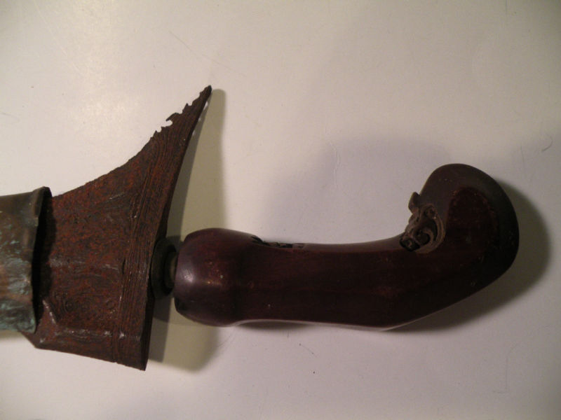

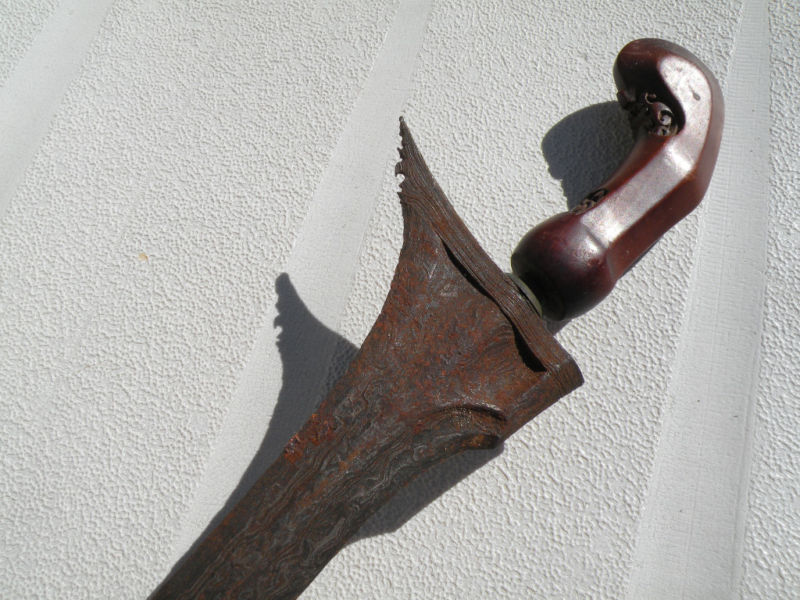

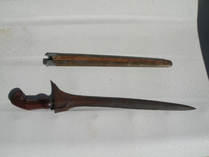

Default KERIS BLADE

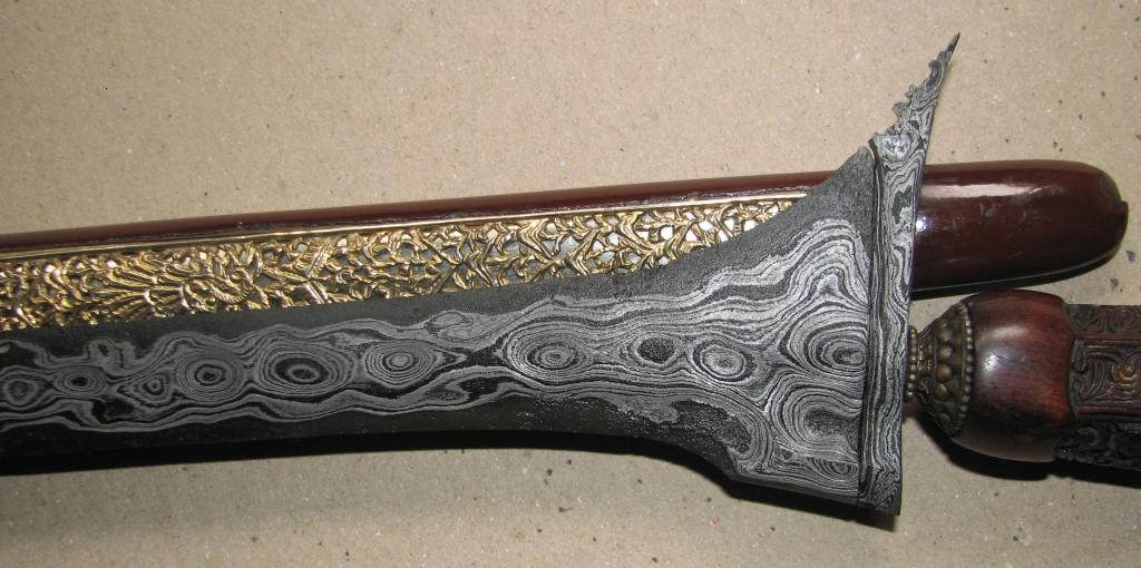

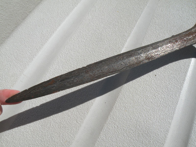

this keris blade appealed my eyes so I give a bid an win it (maybe I am the only one who like this blade?): http://cgi.ebay.com/ws/eBayISAPI.dll...AMESINDXX%3AIT
Dapur is jalak ruwuh (I think), pamor I can't name. Blade seems in fairly good condition and I think by time I will find a good sarung for it.
What do you think, did I good or was it a mistake to buy it?
Thank you,
Old 3rd February 2011, 11:13 PM   #2
Posts: 6,436
A handsome wilah and the pamor seems quite well controlled from what I can see .
Old 3rd February 2011, 11:23 PM   #3
Posts: 7,297
It looks like a handsome blade that will clean up and stain nicely i would image. Some people shy away from auctions where the sheaths are so beyond repair...unless you live in Jawa where one can more readily be made. But frankly if i had seen this auction i might have bid as well. Looks like you made a good deal to me...
Old 4th February 2011, 04:34 AM   #4
BluErf
BluErf's Avatar
Location: Singapore
Posts: 1,180
Oh, and it looks like it could be a proud blade after it is restored! Diamond in the rocks!
Old 4th February 2011, 05:50 AM   #5
Posts: 7,229
Good!
Old 4th February 2011, 03:54 PM   #6
Thank you very much gentlemen!
The game on e-bay is sometimes very confusing for me.
I was really surprised that nobody else bid on this one.
Someone in the position to determine the origin of this blade?

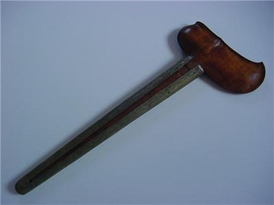

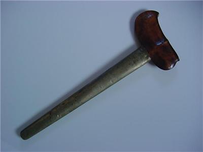

Old 5th February 2011, 11:28 AM   #8

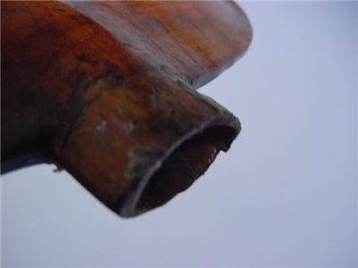

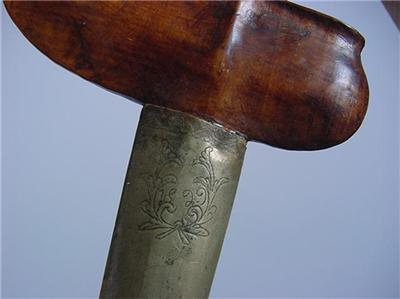

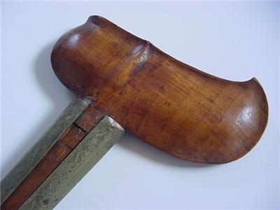

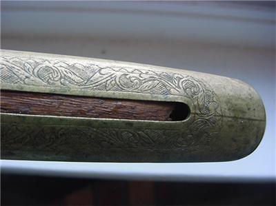

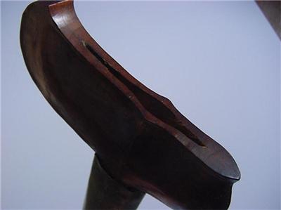

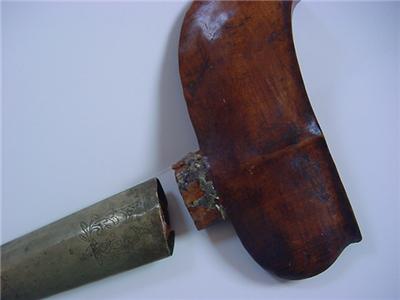

Yesterday I won a nice sheath by ebay: http://cgi.ebay.com/ws/eBayISAPI.dll...K%3AMEWNX%3AIT
I hope that I can use it for the keris. Here the pictures from the seller.
Old 5th February 2011, 09:31 PM   #9
Posts: 7,229
If I am getting a distortion free image on my screen, this is a Surakarta blade by a maker based outside the Karaton.
Like I said:- good!
Old 6th February 2011, 02:53 AM   #10
BluErf
BluErf's Avatar
Location: Singapore
Posts: 1,180
Maybe this blade deserves a dress commissioned for it, rather than a refitted sheath.
Old 12th February 2011, 03:31 PM   #11
Like I said:- good!
Thank you very much Alan!
Old 12th February 2011, 03:35 PM   #12
Surely you are correct by this but in the moment I don't have the chance to let work one for the blade. Let us see what I can do for the moment with a refitted sheath.

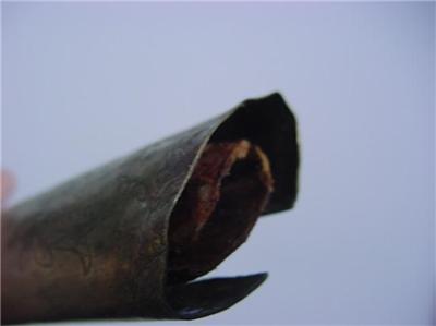

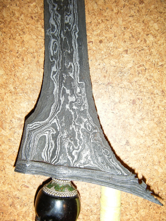

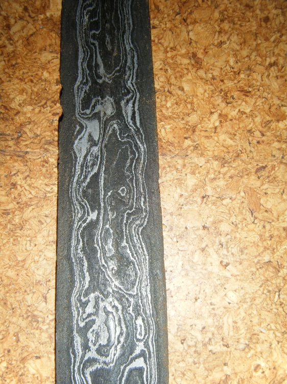

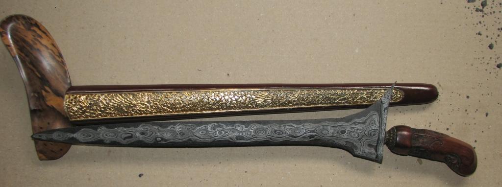

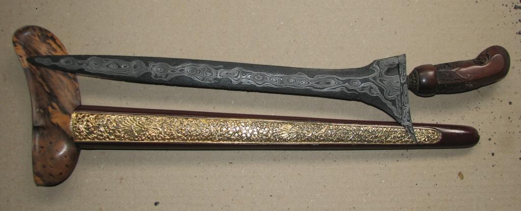

Old 29th October 2011, 08:24 PM   #13

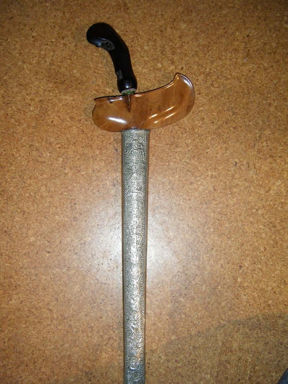

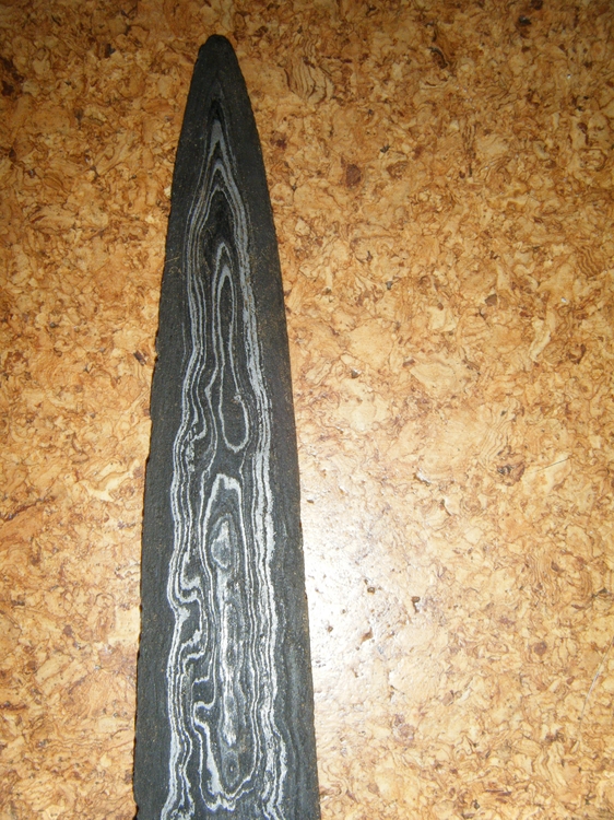

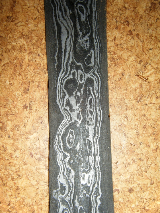

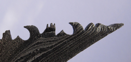

Here now the stained blade with a refitted old sarung, not a solution for aeons but for the moment the blade have a house.
Is someone able to name the pamor?
Old 30th October 2011, 04:31 PM   #14
GIO
GIO's Avatar
Join Date: Dec 2009
Posts: 335
[QUOTE=Sajen]Is someone able to name the pamor?
Ngulit Semangka ?
GIO is offline   Reply With Quote
Old 30th October 2011, 05:09 PM   #15
[QUOTE=GIO]
Ngulit Semangka ?
Thank you, my first impression as well but maybe it's more specific?
Old 30th October 2011, 10:50 PM   #16
Posts: 7,229
I'd call it wos wutah, and I believe most people I know in Solo would say the same.
All these random pamors can be classified and classified and classified again.
You can come up with any number of names for wos wutah, and I've noticed that in recent years we seem to have a lot more names to choose from.
I wouldn't give it as ngulit semangko because it is just not coarse enough --- that's the only difference between ngulit semangko and wos wutah:- the number of layers, they're both made in the same way.
Old 31st October 2011, 07:42 AM   #17
Thank you Alan,
for myself is wos wutah entirely ok. The pamor is nice and well controlled so it's equal which name it has.

Old 22nd November 2011, 03:06 AM   #24
ferrylaki
Posts: 285
I would say this keris has "kulit semongko" pamor.
you have a good taste in "sandangan".
I'm wondering if you also has jogja sandangan in your inventory.
here at my place, we would dress this keris in jogjakarta dress.
that's from my point of view though.
the style of the blade seem to be aroud jogjakarta.
but it all the matter of taste and personal judgement.

Thank you Ferry,
but I choose this sarung with the help of an indonesian friend after the advise from Alan (see post 9). The blade is big and heavy so it seems in my eyes very plausible that it is a Solo blade.
Thank you again and regards,

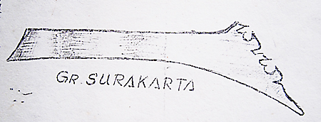

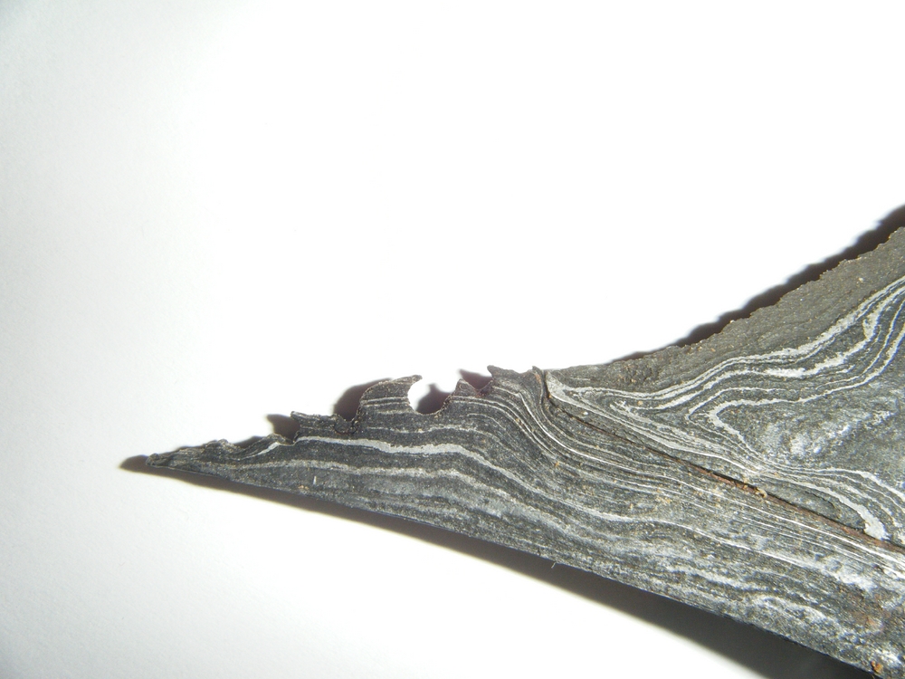

This keris possesses a number of features which permit the classification of Surakarta. The primary indicators in this case are the ron dha and the strong ada-ada.

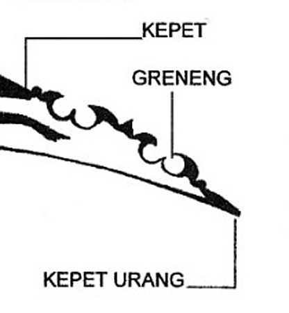

The posted images, from the top, show ron dha from a tombak that is attributed to Empu Jayasukadgo, a keris made by Pandai Keris Yantono, and a drawing, by Empu Suparman, of the classic Surakarta ron dha.
Also shown is a drawing by Djeno Harumbrojo of his interpretation of the Yogyakarta ron dha.
The classic HB (Yogya) keris style broadly follows the Mataram form, and the classic Yogyakarta ron dha also echoes this form.
That, at least, is what I have been taught. Others may hold different opinions, and when all is said and done, this identification of blade origin is based upon opinion.

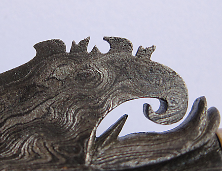

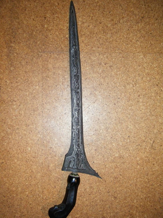

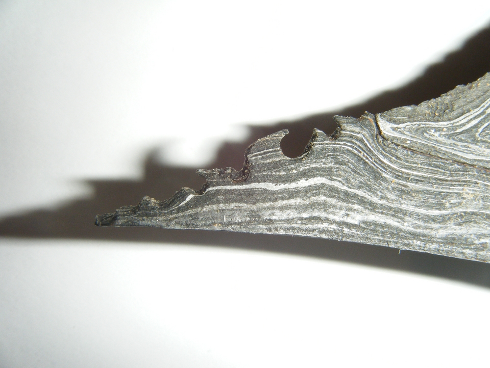

Old 27th November 2011, 12:35 PM   #27
Here a close up of the ron dha of my blade for comparison.
Old 27th November 2011, 06:25 PM   #28
Posts: 7,229
Thank you Detlef, but in fact your couple of shots in post one give a more clear impression of the critical area than do these close ups.The close ups are bigger, but the shots have been taken at an angle to the ron dha itself.
If you have a copy of "Keris Jawa", there are a number of examples of the ron dha interpretation of various makers shown in that.
Any ron dha can vary within its classification and even from time to time by the same maker, however, what is important from the perspective of establishing a supportable tangguh is that the overall form of the tangguh cannot be attributed to a classification other than the one proposed.
In my opinion, the overall form of the ron dha on your keris cannot be aligned to any of the other major classifications.
If the form of the HB keris is a latter day echo of the Mataram keris form, the blumbangan should be square; in the photos you have provided of your keris, the blumbangan appears to me to be elongated, like a brick standing on its end (boto adeg). It is possible that this effect could be caused by the angle at which the photo was taken, and very often, in blades that are less than premium, it is a little difficult to decide if the blumbangan is square or boto adeg.
The boto adeg blumbangan is a primary identifier of a Surakarta keris.
The overall visual impression (pawakan) of this keris is of a robust, forceful, strong keris, it does lack the defined chest and back of the classic Surakarta form, but as I have said, this is not a premium quality keris, it is a keris of the common man. But it is a strong, brave keris. The typical low to medium quality Yogya keris does not present this forceful, aggressive persona.
It is always possible that if I had this keris in my hand I could change my mind, but based upon what I believe I can see in these photos, it is simply not possible for me to support any classification other Surakarta, however, most definitely not Surakarta of premium quality.
