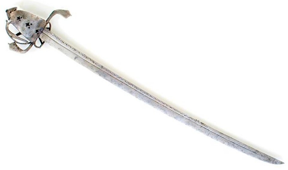

This is most probably one of the 8000 swords - tessak in Norwegian - bought for resale to Norwegian farmers by Danish king Christian IV between 1589 and 1608. But the blade decorations? The blade is as far as I can see and have read, a correct blade for the hilt and period.
Hoping for an answer...

The etched stars, sun, moon and arm with sword are a feature seen widely on 'trade blades' and so may show up in the New World on a Mexican espada ancha from the 17th - 18 century, in a Scottish basket hilt and on early Tuareg takoubas! The modern takouba in the masthead of this page has an early blade with sun, moon and stars in very similar style.
There seems to still be uncertainty about which blade making center(s) was (were) the origin of these blades. I trust Jim McDougall will be along shortly with some greater detail as he has studied these for some time.

In my opinion, the blade decoration is engraved, not etched.
I am also sure that this kind of tessak (German/Austrian Dusägge) is no longer of the 2nd half of the 16th century when most of those were made in Styria/Austria. The pommels then were larger, the blade of somewhat different shape, and as Lee has pointed out, the blade decoration comprising sun, moon and stars - though of late Gothic (15th c.) origin - usually shows up on Baroque blades of the 17th and 18th centuries. The style of engraving on this sample, especially the sword arm emerging from a cloud, are characeristic of German/Solingen blades of the late Thirty Years War, ca. 1640's.
It doubtlessly is a very nice and you sure deserve being congratulated on it!

I would also have believed that the decorations on the blade are from the mid to late 17. or even the early 18. century, but as far as I know, none of these swords were imported to Norway after about 1608.
I have not been able to track this sword down over the generations, but it seems that it is one of the "original" tessak imports.

Hi Trond,
Indeed a very nice example of the swords you note, and certainly of the type of these early heavy sabres of North Europe, and which are among the militia type swords that influenced the style colloquially known as 'Sinclair sabres'.
I very much agree with Michaels observations as his expertise in the weapons in this field is well established and respected. I also completely agree with Lees well placed notes on the widespread diffusion of these 'celestially embellished' blades into many countries in the trade networks.
Regarding the profusely applied motif on this blade, while these figures are characteristic of the elements of the cabbalistic motif of the 18th century on these 'talismanic' blades, they do seem unusually applied as a grouping. Though the use of these symbols did begin on hunting swords much earlier, they did not begin appearing on military swords until the 17th century as noted by Michael, and not greatly popularized on sabres until the influence of Eastern European hussars and thier sometimes thus embellished blades became well known in the 18th c. across Europe.
The blademakers of Solingen capitalized on this on thier trade blades, which became of course well known, and often copied in many cases by local craftsmen elsewhere. On this blade, the sword wielding arm from the cloud seems out of context as it seems to usually appear without the sun and moon. Also, typically the sun and moon seem to appear typically with a single large star, and only a few smaller stars in background, but not with the smaller solar figures.
It would seem possible that as with many heirloom items, this blade may have been engraved later with this motif. Naturally without close hands on examination it is hard to say for certain exactly when, but the style overall seems 18th century. The engraving is, nonetheless, beautifully done.

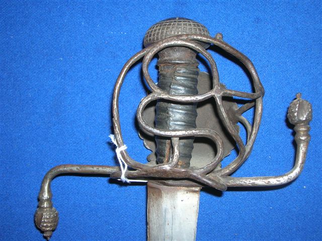

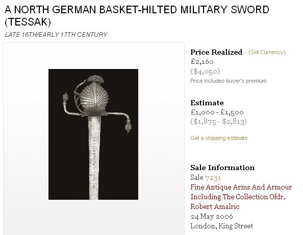

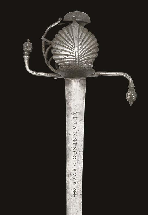

Default A Good Styrian Dusägge with Round Writhen Pommel, ca. 1580
In the collection of a friend of mine, purchased Christie's, 24 May 2006.
The grip covered with leather, the hilt ca. 1575, the rapier blade ca. 1630 and inscribed FRA?NSISCO RUYS in the Spanish manner, together with an orb and cross.

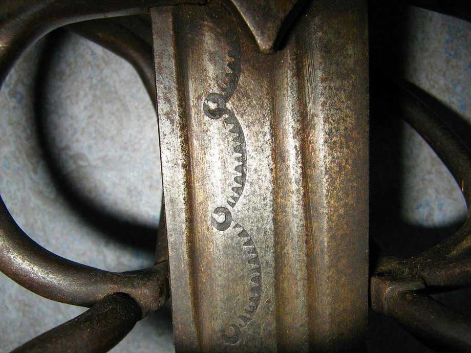

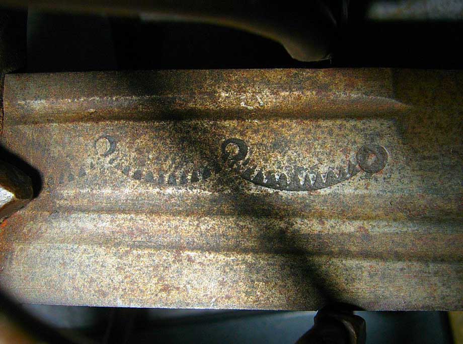

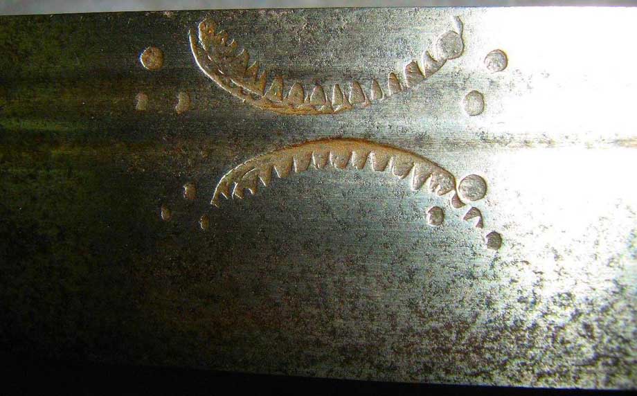

Default 'Eyelash' or 'Toothed Bow' Decorative Marks on a ca. 1575 Styrian Rapier
For deeper discussions of these marks, please confer
http://www.vikingsword.com/vb/showth...=eyelash+marks
BTW, we realize that the term eyelash is not anatominally correct as the lashes on these bows are on the wrong side.
'Sawtooth waveform' might be more fitting ...
Best wishes,

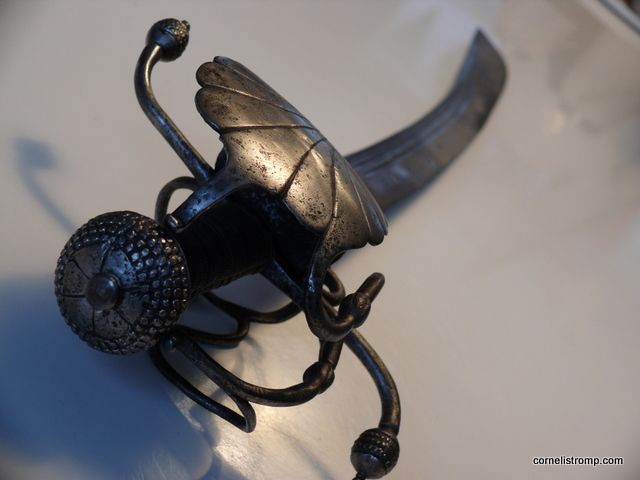

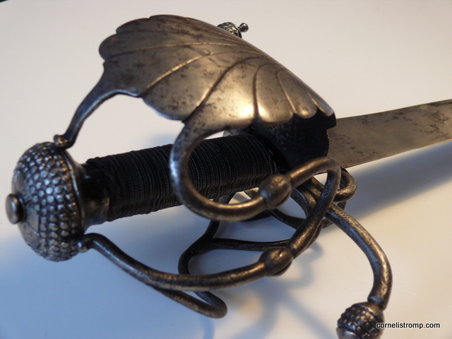

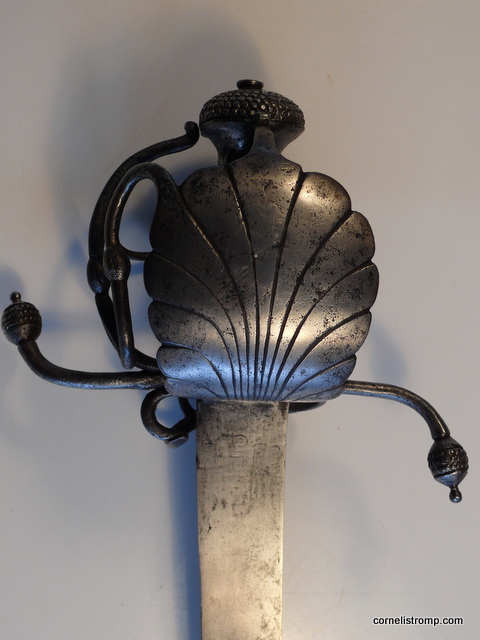

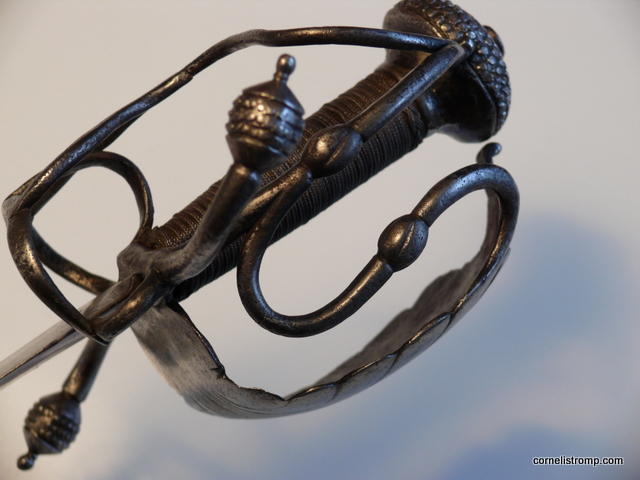

a styermark dussage ex my collection. (unfortunately not anymore).
Can be dated 1570-1580 (dated by JP Puype.)

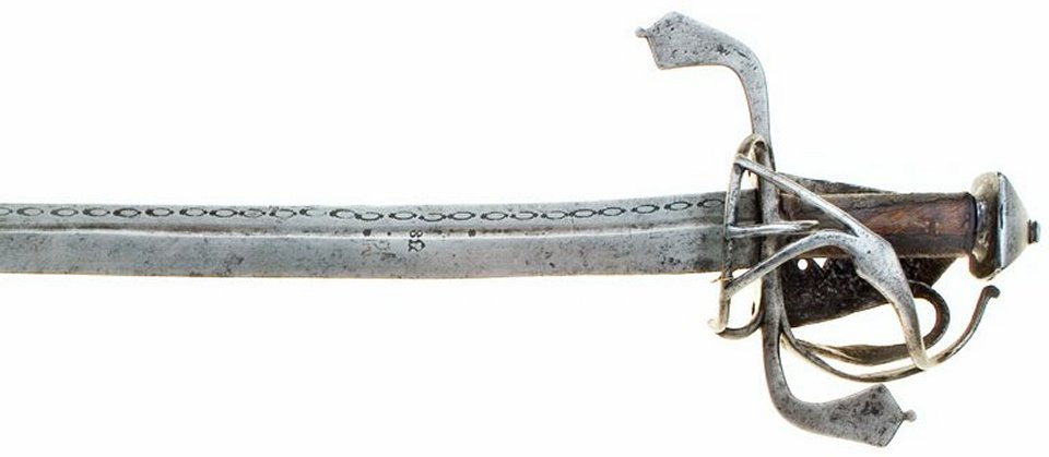

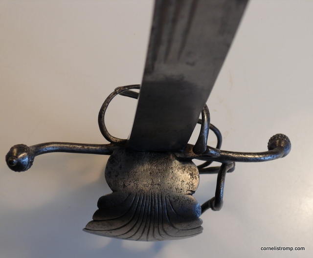

Very interesting! I have something that must be fairly closely related to your sword, but with a straight (secondary?) blade.
Trond
Trond is offline   Reply With Quote

I have a fairly good DkN long-gun collection, but a modest sword collection compared to other specialized collectors. Here is a picture of some of the tessaks belonging to a friend who mainly collects swords.
[Trond
Hi TRond,
do you mean with secondary that your Dussage started with a curved blade?
I also had some dussages with a straight however single edged blade, with the same type of etching at the 'ricasso' showing on which side the cutting edge is.
best,
