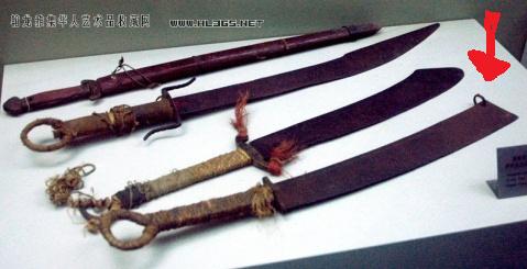

Default Hole in the blade of Chinese dao

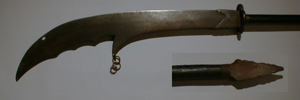

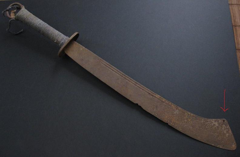

As pictured below I have seen a hole near the tip of the blade in many many 19th century Chinese dao. I have seen both colorful cloth attached there as well as metal rings like in the second photo. Not to mention metal rings with colorful cloth attached to them. Although predominantly it is just a naked hole. In the past I have read others say the hole was used as a place to attach one end of a sling or back strap to carry the sword when on the move. All of the above sound logical to me. What I am wondering is if any one owns, or has seen examples of the slings or sling pieces, or photographs of people actually using them. Any additional thoughts on the blade holes are welcome as well. Thanks

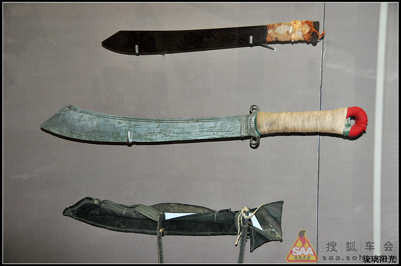

Nice picture. Here are a few more related to military dadao scabbard use. Relatively speaking many pictures can be seen with organized forces using similar leather scabbards. This is an area that has useful photographic evidence available. Although it does not really clear up the original question of the hole in the blade. It does speak to the fact that a highly mobile group needs a means to transport their weapons. Its not a great stretch to consider the less a person moves around, and or needs to carry other gear too, then there could be less of a need for a scabbard. Just a thought, and also relative to what Tom mentioned about the use of no scabbard at all.
What would be great though is an old article or excerpt of one describing an armed non governmental group, or a photograph of possibly a civilian defense group carrying weapons similar to what we call "village" type swords that often have the holes in question. A foreigners snapshot of say a "Red Spear" group coming through town would be very interesting. No doubt this information is few and far between, but it does surface in little bits at a time. With the help of like minded friends of course

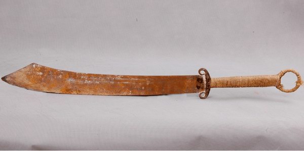

I thought I would post this old illustration I pulled from a Chinese web site. I am not sure how old the drawing is exactly, but the site was about the Boxer Uprising. I thought it was interesting because it has a ring in the blade hole, and there is a non-ring pommel on the sword.

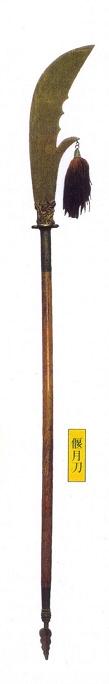

I am still interested in others thoughts and or evidence related to the use of the blade holes in various forms of Chinese dao. I have also posted some pictures of a couple guan dao head (偃月刀 yan yue dao) that have the feature in question. Although I have yet to see a period guan dao example with a tassel adornment attached to the hole/ring, it is standard on modern Chinese martial art practice pieces. This combined with the other evidence I have available at this point suggests to me that these various dao blade holes are more ornamentation related than utility. Any thoughts?

Gavin Nugent
Gavin Nugent's Avatar
Niel,
My thoughts are ornamental on the polearms, though in motion and martial use the tassle which sits in this hole may have a martial application like the tassle on the Jian, but you'd have to ask practicioners of the Yan Yue Dao to confirm this.

Old 19th May 2011, 04:02 AM   #17
Neil
Neil's Avatar
Join Date: Mar 2010
Location: Wisconsin
Posts: 117
Thanks for your input Gavin, and the links too. Here is a picture of a tasseled guan dao head from the Thomas Chen site linked above (Thank you Mr. Chen).
