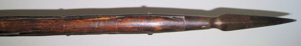

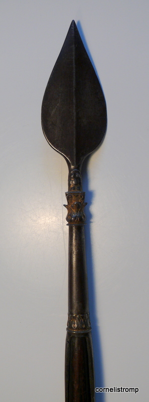

Default LANDSKNECHT PIKE

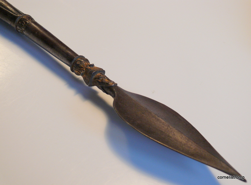

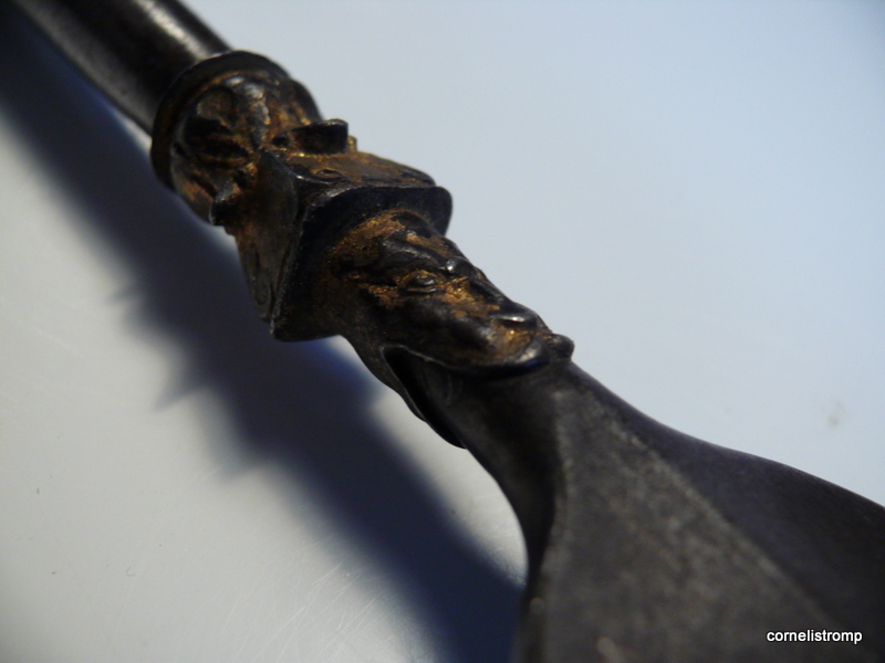

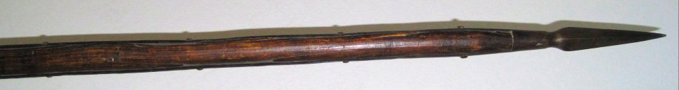

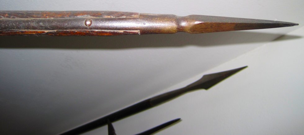

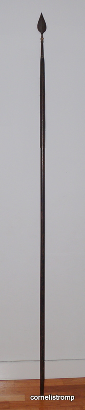

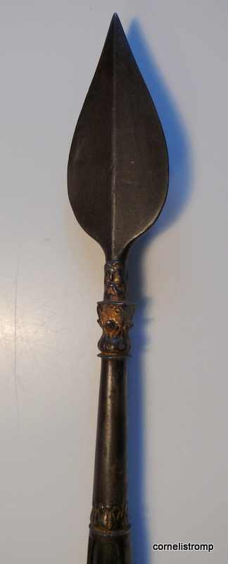

16th century landsknecht pike (spiess)
allover length 212cm
spurs 47cm
sock till gryphonhead 12cm
leaf/blade 12cmx5cm

profos?
Old 15th January 2011, 04:01 PM   #3
Hi Jasper,
Beautyful piece !
Why is this a pike and not a lance (spear) ?
Old 15th January 2011, 05:38 PM   #4
cornelistromp
cornelistromp's Avatar
Join Date: Mar 2009
Posts: 1,071
hi Fernando,
you may call it a pike a lance or a spear.
Lance is a catchall term for a variety of different pole weapons based on the spear. The name is derived from lancea, Roman auxiliaries' javelin, the word may be of Iberian origin. Also compare longche, a Greek term for lance.
A lance in the original sense is a light throwing spear, or javelin. The English verb to launch "fling, hurl, throw" is derived from the term (via Old French lancier), as well as the rarer or poetic to lance. The term from the 17th century came to refer specifically to spears not thrown, used for thrusting by heavy cavalry, and especially in jousting. A thrusting spear which is used by infantry is usually referred to as a pike.
Old 15th January 2011, 06:11 PM   #5
Matchlock
Matchlock's Avatar
Join Date: Sep 2008
Posts: 4,310
Hi Jasper,
I have to agree with Fernando: this is a beautiful piece indeed. I, too, like Fernando, prefer calling it a lance (Spiess), length ca. 2,20-3,0 m.
'Pike', on the contrary, usually means a long lance (Langspieß), ca. 4,60 to 6.0 m overall in length.
Congratulations on your perfect historic documentation as well. Your Landsknecht Spiess is clearly of North Italian type, early 16th century and in perfect patina. The both zoomorphic and apotropaic monster's head first appears on the muzzles of cannon and then on Landsknecht arquebuses. As they clearly represent fire spitting dragons or sea monsters, I would not call them gryphons.

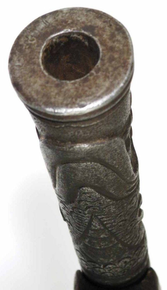

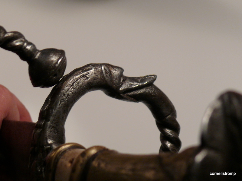

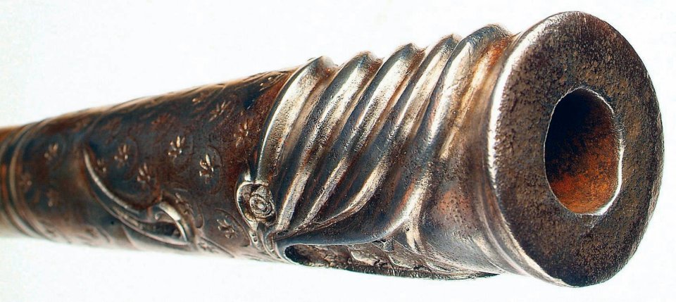

Hi Michael and Fernando,
beautiful barrels, thanks a lot for this extremely nice contribution
yes, I see, it is indeed a sea monster.
we can call it a spear however Jp Puype calls this type a small officers pike in his book "Maurits to Munster"

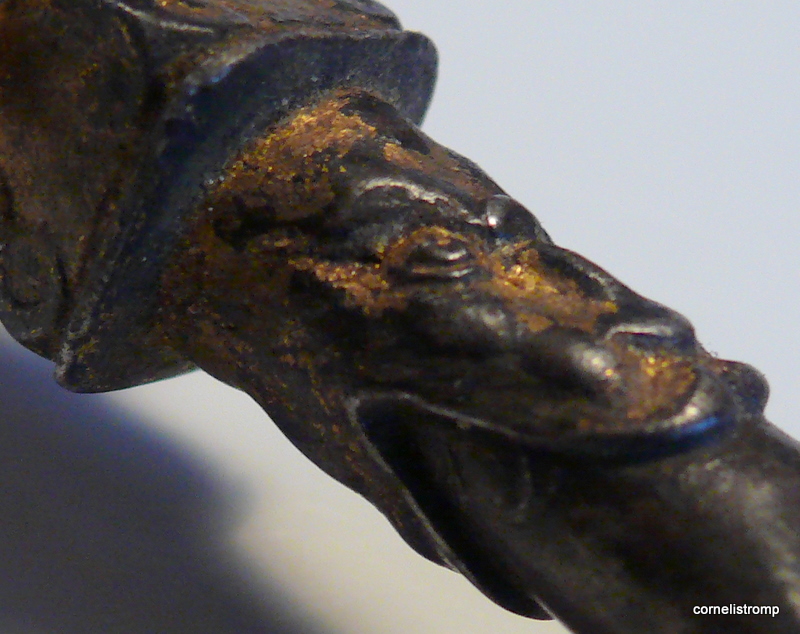

the condition of this spiess is excellent it still has the original pole and the yellow colour at the pictures are remains of the original fire gold plating.
do you know a similar example some-were

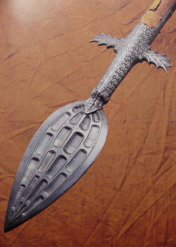

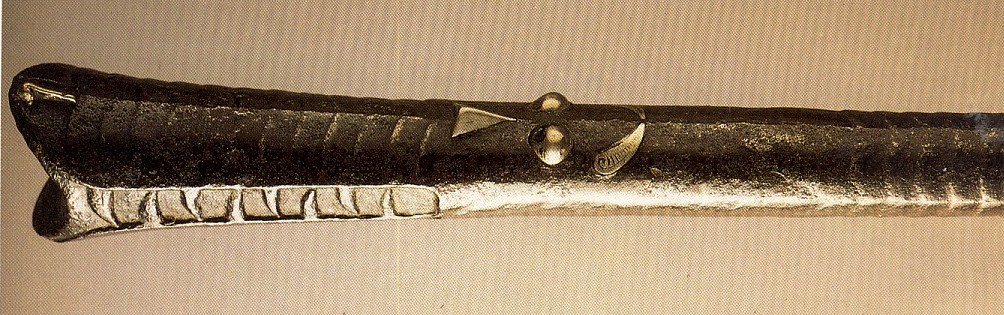

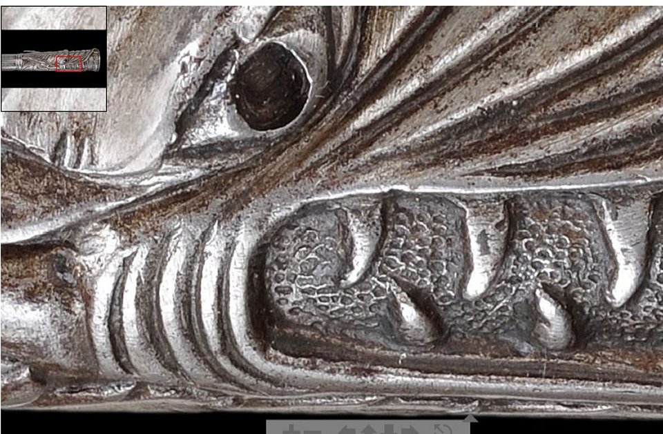

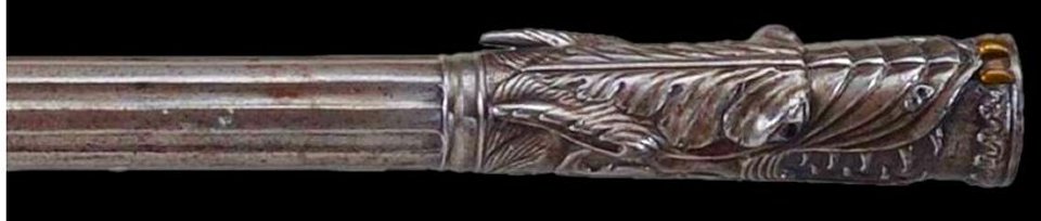

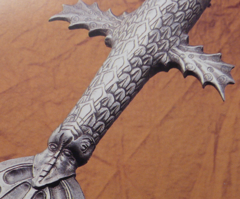

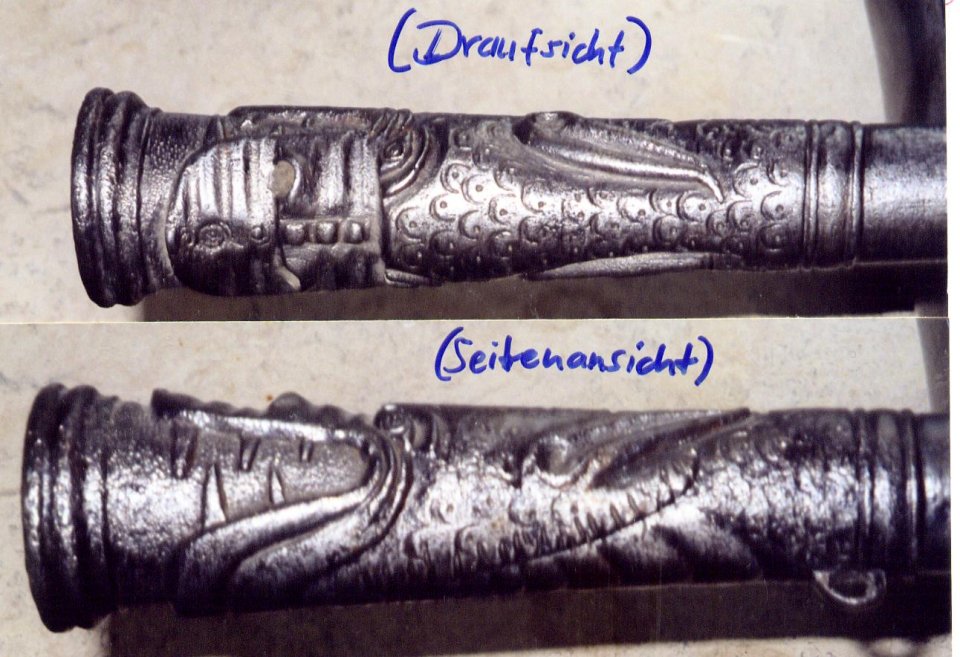

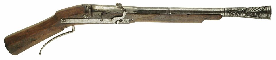

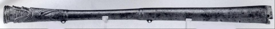

Speaking of spiting dragons, here is a fascinating 1,45 mts. barrel from the 1500's, made in Goa, that i scanned from an old auction catalogue
The dragon eyes and nose are in silver; the nose works as a sight.

this is the closest I could find.
1540 italian "jagd spiess".
best,

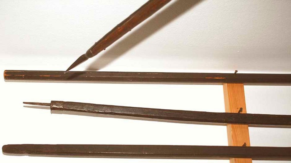

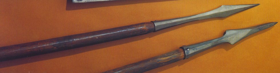

Default Two Mid-16th Century Hapsburg/Austrian Pikes in my Collection
In virtually untouched condition, the original hafts of stained ash wood, the iron tips and straps retaining their original blueing.
Overall lengths 4.6 and 4.56 cm.
Please see also
http://www.vikingsword.com/vb/showthread.php?t=7123

Default Maximilian Landsknecht Long Pikes, Albrecht Altdorfer, 1513-15
From Albrecht Altdorfer's Der Greulich Sweyzer krieg (the gory Swiss War), from his illustrations of the Triumphal Procession for the Emperor Maximilian I.

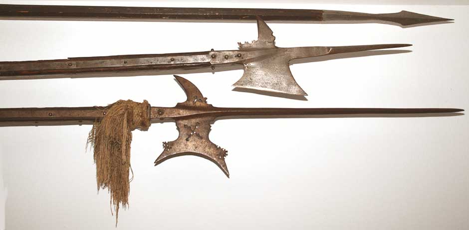

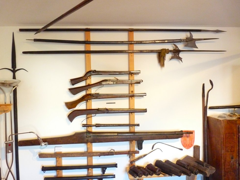

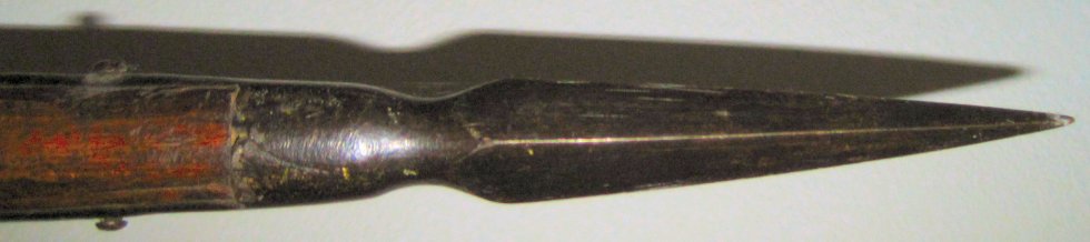

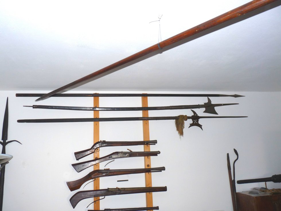

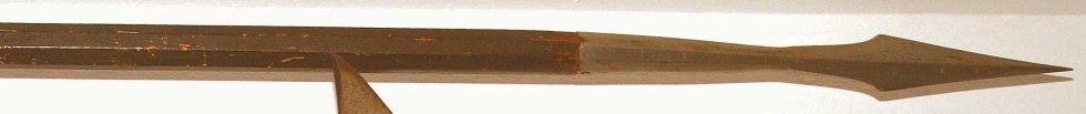

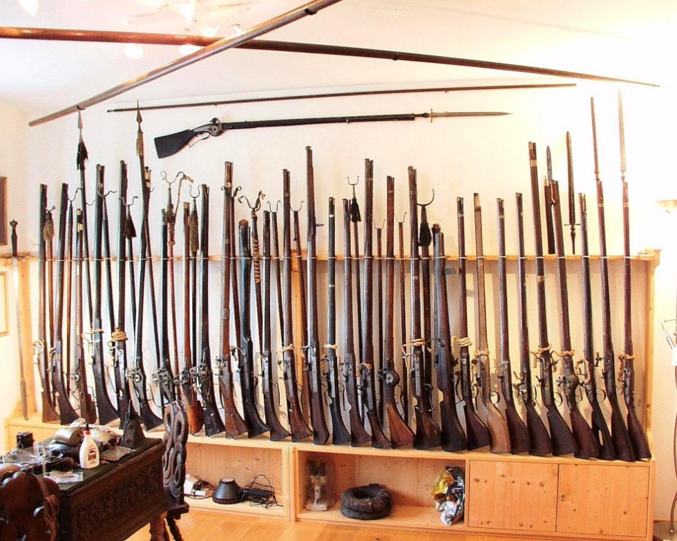

Default An Early-16th C. Maximilian Frog's Mouth Landsknecht Pike in my Collection
The one on top of the wall rack.
Ca. 1500, the leaf shaped or so called frog's mouth blade of characteristic section, with pronounced central rib.
On its original octagonal ash haft, shortened to 2.78 m from originally probably 4.5-5.0 m.
From the Landeszeughaus Graz, Austria, the upper section of the haft bearing the inventory stamp of the Metropolitan Museum of Art, N.Y., from an inventory of ca. 1900.
Not one single of hundreds of pikes of this type still preserved in Graz retains its original octagonal haft; they were all restocked with round hafts around the middle or during the second half of the 16th c. Attached below is a scan of two pieces in Graz.

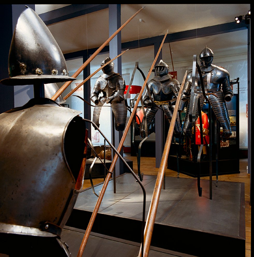

Default Pikes Against Cavalry - a Thirty Years War Impression
In the Tojhusmuseet Copenhagen.
