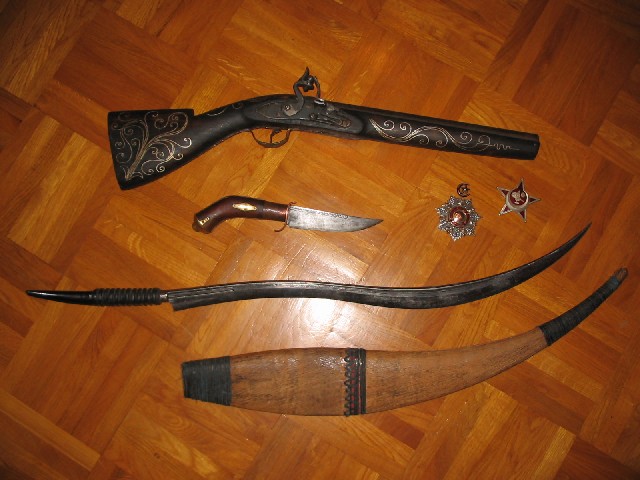

Hi to everyone!
I've found that forum just today and I'm impressed.
I'm from Slovenia (central Europe) and I'm a collector of mostly japanese blades, but I like also all other quality blades... Unfortuantelly I'm not (yet) an expert on the other that field of collecting.
Personally I think that the Black sea style blade is the most sugestible and why not, the most beautiful shape of blade ever created (well exept nihonto blades, naturally)
Do you agree?
Have any in your collection?
If so, I'd really appreciate to see the fotos!

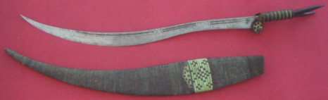

I have just that one. What do you think about it?
I'd like to buy another of thoose, so I like to have a pair to cross them over the wall. What are approximately the value for such pieces nowadays?

I mean, how thin is "too thin"? 1-2mm at the foible is absolutely enough (in my experience, at least) for cleaving through meat and thinner bones without bending... and if you do a little calculation, you'll see that most european cutting blades (sorry for always using them as examples) have a thickness at about that at the foible, even as they were needed to face rigid plate defense. After all, why would it be called "foible"?
Balance: I didn't have a chance to wield one so far, but I don't think that it'd have a worse balance than my training swords... 50cm from the quillon for a 110cm "blade", overall weight being 12 kg... It strenghtens the wrist quite well... after that, anything lighter or better balanced will feel like feathers. And I think that a more forward balance point will do better for slashes, just as in the case of machetes.
When I was practising in a gladiator school as a dimacheris (two-sworder), I used almost exactly the same blade shape, with forward balance... They were good for me.
Pommel: A question has arised in me. Isn't it possible that they used the same "thumb grip" as the europeans? I mean, there are a few cuts (zwerchau and krumphau) where you "turn" the hilt with 90° in your hands, so the long edge is to the left, while the short is to the right.
In the case of yataghans, it would place the point to the "outside" and the edge to the "inside".
The question came from the posted picture. It looks like that the hilt is wider in the "wrong" direction... so it would be comfortable if you grip it in the thumb grip... so with extended arms the blade would be paralell to the ground. This way, you could use it either for cutting or thursting... try doing a few zwerchauen with it... it would make descending cuts more difficult, but not impossible, while making ascending cuts easier and faster, and making it possible to use the zwerch, which can instantly stop a descending cut while killing the opponent...
And you could use it for bashing thrusts aside. Imagine a low or central straight thrust coming towards you for sake of simplicity. If you make a wipe with the blade, you'll have the point at about the groin of the attacker. A little upward wrist move... Btw, this is almost the krumphau. And you can take out most strikes with it.
Sorry for the long post, I could tell you the same in about 2-3 sentences in my native language... If you can't understand, I can shot a few videos showing my idea. Or if I'm talking absolute idiotisms, or something that is well-known already, tell me, and shoot me down.

Old 12th October 2005, 05:39 PM   #10
Posts: 6,023
Default who is correct?
I am surprised this has not been brought to attention earlier. This picture is from. "Islamic Weapons, Maghrib to Moghul" by Anthony C Tirri, in this book the weapon is attributed to Algeria/Egypt. I think he is correct as the leatherwork is so clearly North African. Some way from the Black Sea I think? Tim

This peculiar sword had been variously attributed to N. Africa and even Indonesia (By Hermann Historica, no less!).
However, the Askeri Muze in Istanbul has several of them and the curator there told me that it was a well known Ottoman sword called Laz Bicagi.
Second, look at the picture:
http://www.vikingsword.com/vb/showth...ighlight=black
No doubt what it is!
I agree that the forte looks just like Algerian Flyssa and the leatherwork like a Sudanese Gile, but.... This is a classic example of a mistaken identity; it teaches us that superficial similarities do not establish provenance.
Ahriman:
I handled quite a lot of them. The point is very, very thin, almost needle-like and I saw several with bent points.
The forked pommels break easily (see the original picture in this thread). Also, the horns protrude so much that wrist bending is almost impossible: worse than tulwars with oversized dish pommels. As a former fencer (foil and saber), I could not wield it with ease no matter what kind of grip I used. On the other hand, since these swords were primarily "pirate" type weapons (that's what Lazes did on top of smuggling) they were sure scary! As a psychological warfare these swords were great but technologically they were less than adequate.
Old 12th October 2005, 06:27 PM   #12
Posts: 6,023
How right you are. What a shame Mr Tirri should get something like this so wrong. Those pictures show wonderfull plain working weapons, thanks Tim.
Tony supports his N. African provenance theory with a number of features from a number of pieces, so its not really unsupported in terms or argument (he gave a very interesting talk on it at the EEWRS dinner a couple years back). His position is, as Ariel points out, the subject of debate, and certainly based on empirical observation and deduction rather than historical or local information.
There are some ways to reconcile the two, for example taking into account that Ottoman troops may have brought it with them to places like Egypt during the Ottoman Empire period, or influence going the other way via trade or population movement. I think one unanswered question is how far back the style goes, which is always an interesting question to me, as it can open up possiblities of cross-cultural influence, or exclude others that would have post-dated the earliest appearance of the style (for example in this case, if it predates Ottoman presence in N. Africa).

A colleague at the EEWRS meeting kindly lent me the printed material which Mr. Tirri passed out in support of his proposed North African attribution to this type of sword shortly after it took place. It has been a while but as I recall, Tirri's arguments were based upon 2 points: a formal relationship between the Black Sea yatagan and the flyssa (he argued that one was derived from the other, I think it was that the yatagan came from the flyssa), failing to note that both are just provincial developments off the yataghan which likely occurred coevally, one in North Africa and the other in the Transcaucasus. Secondly, he compared the decorative characteristics which generally appear on flyssas with those on a particular Black Sea yatagan in his possession-- the only one I've ever seen with such designs-- it almost certainly was decorated in North Africa. This was a more defensible point that his first, however his conclusion was marred by the fact that he could produce but a single example in support of it. As Mark says however, the range of the Ottoman military was considerable; this type of sword could easily have found its way from Eastern Anatolia to the African Provinces. In any case, Tirri deserves credit for his research as well as for putting forth an original thesis.
Ariel, regarding your observations above:
"I handled quite a lot of them. The point is very, very thin, almost needle-like and I saw several with bent points.
The forked pommels break easily (see the original picture in this thread). Also, the horns protrude so much that wrist bending is almost impossible: worse than tulwars with oversized dish pommels. As a former fencer (foil and saber), I could not wield it with ease no matter what kind of grip I used. On the other hand, since these swords were primarily "pirate" type weapons (that's what Lazes did on top of smuggling) they were sure scary! As a psychological warfare these swords were great but technologically they were less than adequate."
In the simplest terms, you are comparing apples and oranges. If, as you say, your practical experience with edged weapons is limited to fencing-- a sport so highly conventionalized that any beginner knows it is remote even from the use of rapier and smallsword whence it derives, and one designed for use with very specific equipment NOT intended for cutting-- then any pronouncement you make on the use of weapons other than the foil or saber, i.e. the Black Sea yatagan, the tulwar, or for that matter anything designed for use with the drawcut is, regretably, invalid.
Relative rigidity in the wrist was key to the effective use of these weapons, which is why their pommels were prominent in one way or another. The stroke was accomplished primarily with the shoulder and elbow in a quick drawing motion across the body-- Stone mentions this under his entry on shamshirs, pg. 550. Having done much of his research in situ over a century ago, Stone was fortunate enough to witness many of these weapons in actual use-- and while those days have passed, we can benefit from his observations as well as those of others who were able to do so. I often wonder why students and collectors so rarely do.
As far as broken ears and bent tips, who can say whether these come from use or misuse over time? Concrete, little boys, adults after one too many beers, and power tools are the recognized nemeses of old swords, you know.

I brought up this old thread because I might have some new data. I recently bought this lovely Black Sea yataghan from a fellow forumite. It has a Gregorian date of 1888 on it as well as a Islamic date. 1888 converts to the Hijri date of 1305 or 1306. As can be seen the 1 and the 0 are typical Arabic numbers but the 3 and the 5/6 appear unusual. Is this a local variation that might help place its origin?
All the Best
Jeff
