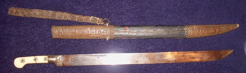

Just found this sword.
What do you think?
I'm thinking Bosnia.

The hilt does not strike me as particularly Bosnian but more Afghanistan or there abouts...........

This item was labled Russian in the little shop I found it at. I kinda had a Ottoman gut feeling from it. The little cirlces on the handle reminded me of the handles of Bosnian Bichaq. The lobed pommel also reminds of pieces from the Balkan area. The seller might have seen a similarity to the Russian Shashqa. I've seen the circles on Afgan pieces as well.
At 26" over all with 19" blade, its much larger than the typical Bichaq though. Look forward to futher comment.

I think I know where the feeling comes from: the integral bolster. These were widespread on Bulgarian ( and, likely, nearby) examples.
Russian masters in Zlatoust made gorgeous yataghans, but, like many things Russians, those were grossly overdone and very decorative.

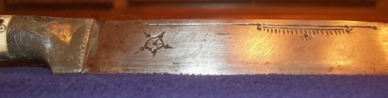

Recently, I got involved in the discussion of Crimean Tatar weapons: those were very similar to the Balkan Bulgarian karakulaks.
Would be very interesting to look at the close-ups: decorations might be revealing. I seem to be able to see some kind of circle with rays near the ricasso: Tatar tamga?
If that's the case, since the Crimea became a part of the Russian Empire, the "Russian" attribution might be somewhat correct.

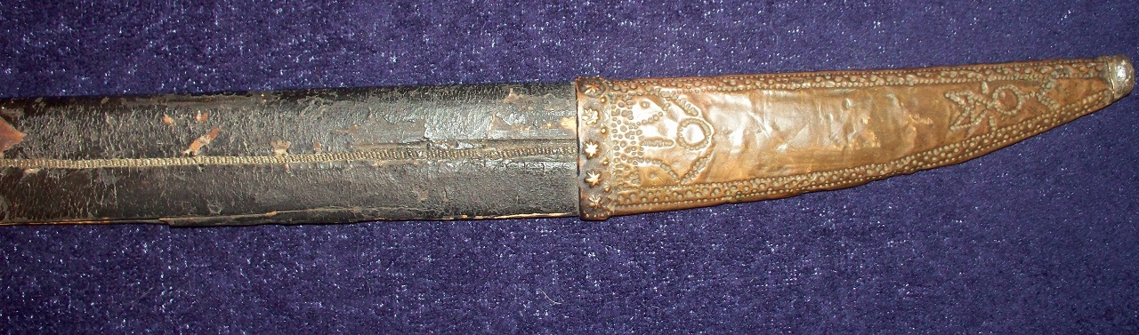

It does look Balkan to me. Can we see the decoration on the scabbard and the stitching on the leather part close-up?

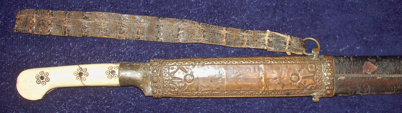

Here are some more pictures. I hope they help. Thank you for your input. Very much appreciated.

That curly wire connector where the leather is joined is a style I see on Greek/Balkan/Turkish pieces.
As Battara says, the circles are familiar from Afghan items, but now that we can see the other details, I'd say its more to the west.
It doesn't look Greek to me, possibly Turkish, but Balkan seems favourite (IMHO).
The decoration on the scabbard with the chevron and orb is very distinctive. Must be a giveaway clue for someone to ID it?

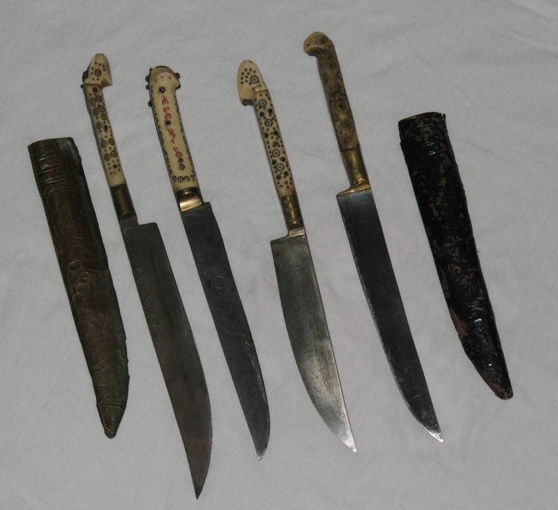

The dot in circle decoration from what I have read is supposed to signify heaven, with the little dot in the center symbolizing Allah's central position in the universe. As a result, it is not surprisingly very wide spread and typical of many areas, making attribution based solely on this symbol hard.
I am attaching a picture of some Bosnian knives, where you can clearly see similar decoration on the hilt of the second knife from the left. My guess therefore would be Western Balkans.

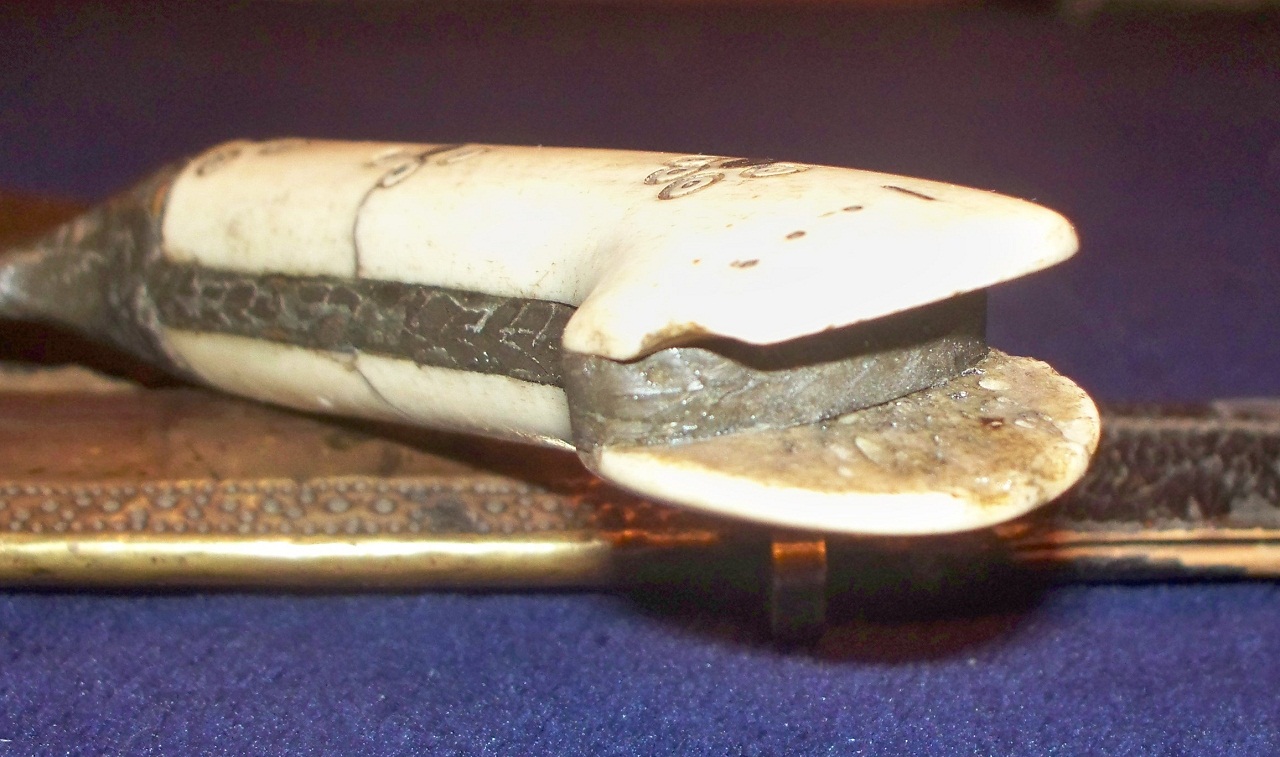

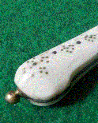

Was looking at this piece today and just noticed a date on the pommel. You can see it in the pommel close-up there.
looks like 1... I believe thats 1000, So would convert to 1591. What ya all think?
Thanks,
Stephen*

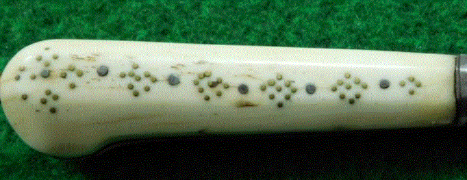

I think Balkan and looking at the scabbard and hilt might even be narrowed down to southern parts of the former Yugoslavia
I have got a knife / small bichaq with the same grip / hilt : white bone and same circular decoration.
The decoration on the blade looks most interesting: I only have seen similar on small hunting pen or clasp knives

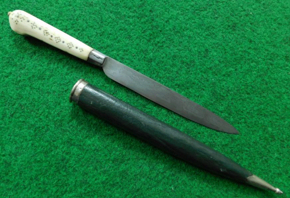

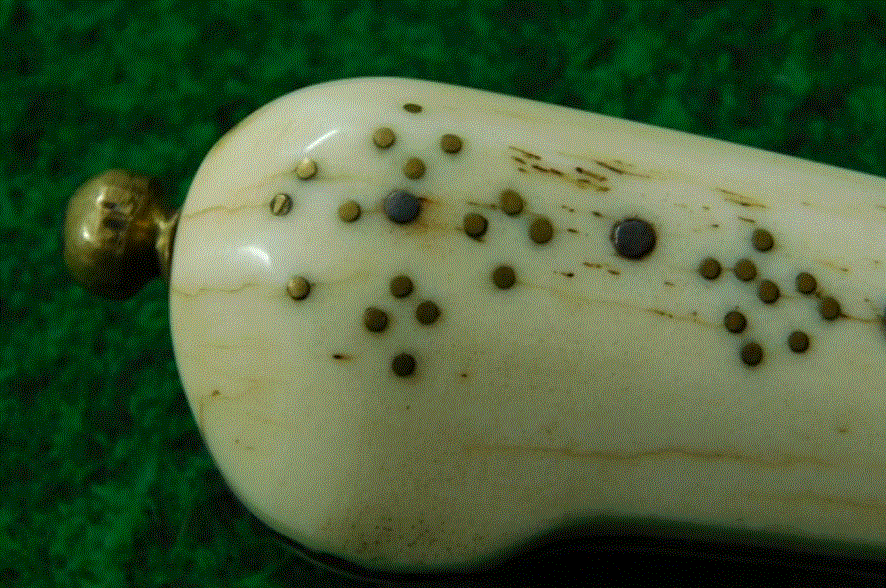

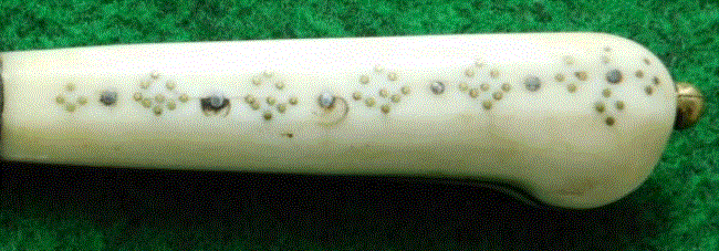

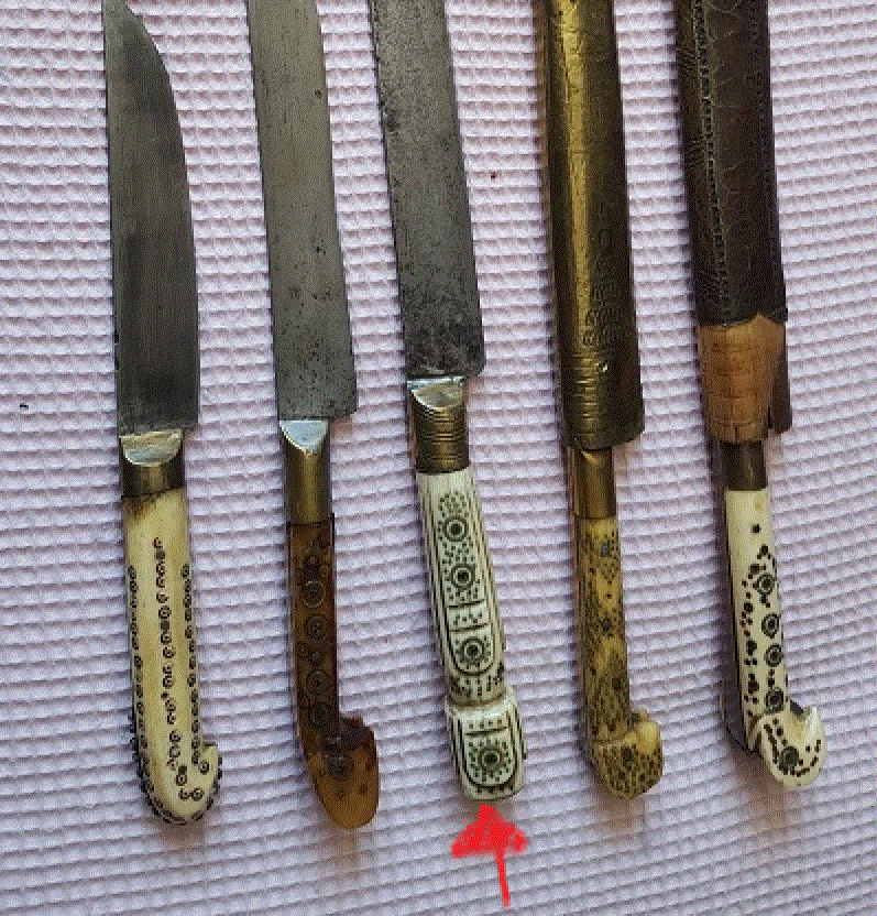

enclosed the pictures of the bichaq from Croatia and 2 from Bosnia with similar decoration, so you can compare.
when I look at the grip / hilt of what the owner calls "sword", I would not call it a yataghan, but looks more like the long bichaqs of 40 cm

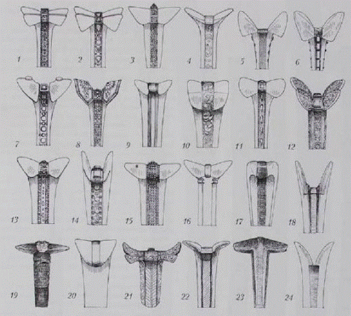

as for the grip/handle / hilt: the types for the bichaqs were derived from the several types yataghans in the Ottoman empire and found on the Balkans; from Makedonia, Bulgaria, parts of what is now known as Greece ( as the Greek world was way bigger than the present state!) through Albania, Serbia, Bosnia, Dalmatia and parts of Croatia...numbers 14 and 18 come close to the above "sword"

GP, I really like that diagram of handle patterns! I am sure you have given this source material before, but which book did it come from? In what language is it written? Does it have profile views of the handles also?
Thanks,
IP
Old 8th August 2022, 07:43 PM   #21
gp
gp's Avatar
Join Date: May 2020
Posts: 1,041
Thanks,
IP
yes I did, sadly no profile views. It comes from an Austrian Habsburg K.u.K. book in German "Wissenschaftliche Mittheilungen aus Bosnien und der Hercegovina"
