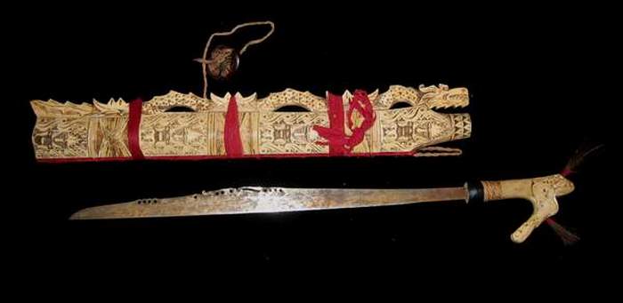

Hallo guys!
Had the opportunity to see the private collection of an Indonesian whom I met this summer in the province of Kalimantan Barat. Among the edged weapons was one Dayak parang, and I just wanted to ask if someone maybe wants to comment. Real? Old? What Dayak-subgroup? Unfortunately, these two are the only photos as I was kinda rushed through that room in true Indonesian style Thus I don't know what the blade looks like.
Comments on the other visible swords are also welcome, of course.

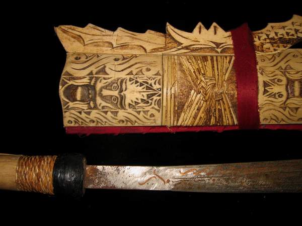

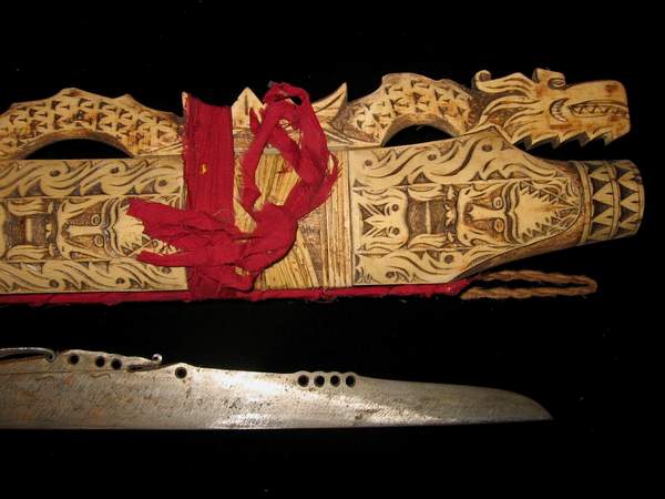

THE DAYAK SWORD IS NOT AN OLD ONE BUT WAS MADE IN BORNEO. I SAW SOME LIKE IT IN SHOPS IN KUCHING AS WELL AS FOR SALE ON EBAY 2001 THRU PRESENT. THE MORE ATTRACTIVE ONES HAD NICELY CARVED BONE SECTIONS ATTACHED TO THE SCABBARD NOT JUST CARVED WOOD. WHERE IN BORNEO THEY WERE CARVED I DON'T KNOW.
THE TOP SWORD LOOKS TO BE FROM ONE OF THE INDONESIAN ISLANDS PERHAPS TORAJA OR TIMOR. THE NEXT ONE IS AN ACTUAL MILITARY SWORD. THE LAST ONE I CAN'T TELL MUCH ABOUT BUT DOSEN'T LOOK OLD.
HERE ARE SOME PICTURES OF AN EXAMPLE CLOSE TO WHAT YOU SHOW. THIS ONE WAS DESCRIBED AS MADE OF CARVED BONE HARD TO TELL FROM PICTURES BUT I HAVE SEEN THEM IN WOOD AND BONE. THE BONE EXAMPLES COULD LIKELY BE THE MOST EXPENSIVE SWORD IN THE SMALL SHOP UNLESS THEY DEAL IN REAL ANTIQUES. MOST SHOPS I SAW IN BORNEO HAD FEW OR NO GOOD OLD TOP QUALITY MANDAU FOR SALE. THERE WERE LOTS OF SWORDS FROM NEW TO PERHAPS 50 T0 80 YEARS OLD BUT FEW 100 YEAR OLD ONES AVAILABLE. THERE IS QUITE A VARIETY OF ITEMS TO BE SEEN AND A TRIP TO BORNEO IS FUN AND VERY INTERESTING.
THOSE WITH MONEY BUT LITTLE KNOWLEGE WILL OFTEN BUY THE MOST EXPENSIVE AND ATTRACTIVE/ EYE CATCHING ITEM. THERE IS NOTHING WRONG WITH THAT AND HIS FRIENDS WILL BE IMPRESSED. I AM FAR FROM AN EXPERT OR CONNISOUR OF DAYAK WEAPONS AND HAVE BOUGHT THINGS THAT THOSE WITH TRUE KNOWLEGE WOULD TURN THEIR NOSE UP AT, BUT THATS WHAT KEEPS IT INTERESTING AND FUN. IT ALSO MAKES A MARKET FOR OBSOLETE ITEMS SO SMALL SHOPS WILL CONTINUE TO MAKE AND MARKET THEM.

VANDOO, thanks for the answer. It surprises me a bit that this is not an original piece, as the owner was a little wealthier than the average Indonesian and seemed quite proud of his collection. But I trust your expertise no doubt. Maybe he was tricked by the seller himself.

The second sword from the top looks like what the Soenda call: Gobang Kalewang. It looks locally-made. If the blade is hand-forged, then it could be an original from circa 1902, probably made in Soerabaja or Soemedang(which, around 1850-1930 was the local "Solingen").
The last sword looks like a Middle-eastern type popular in Indonesia and referred to by the Soenda as: Saif (Arabic for sword). It may have been made locally (I'd have to see the blade).

The top sword is from the Timor Islands ( Alor, Pantar, Roti, Savu, Timor and Wetar) and named in the book from Zonneveld type a.

Can the parang, despite not being an antique one, be attributed to a certain Dayak subgroup? And what shape do you think the blade has or might have? Same as the one VANDOO posted?
Sajen, thank you. I'll look up that Timorese sword in the Zonneveld book. Fortunately the library where I work has it in their inventory, and I often browse through it when I have nothing to do Luckily enough, no one ever borrowed it...
Hello Amuk,
The second from the top is a copy of the 1911 model "Sabel Marechaussee"
So 1902 would be a little premature as a date of manufacture.
Hela Dinngat,
As for the mandau and Timor sword. tourist examples. Can't make it any better. At least I get the impression that they where not offered to you for sale. That is a plus.
Check the search function on "mandau" and check some of the old threads.
Good luck !

Yes, thank you. Mandau is the way to go.
They weren't offered to me for sale, they were in his possession as his private collection, and he just showed them to me for fun.
Sabel Marechaussee was a good keyword. Found lots of pages via Google, among them several threads on Vikingsword Klewang being the Indonesian name for it. Can we be sure it is a copy, judging solely from the two photos?
Edit/ Hehe, just noted somebody has written "DATU" (Malay honorific title) on the Mandau's hilt with a marker pen for whatever reason...
