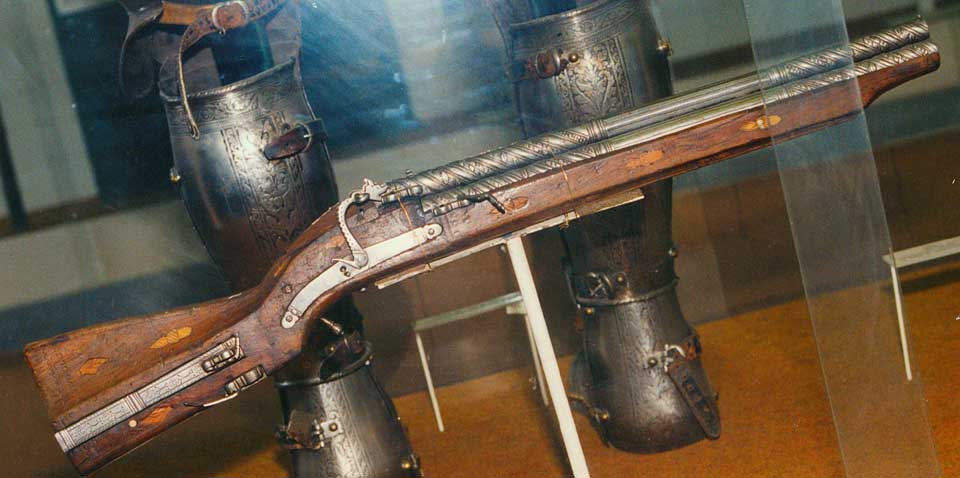

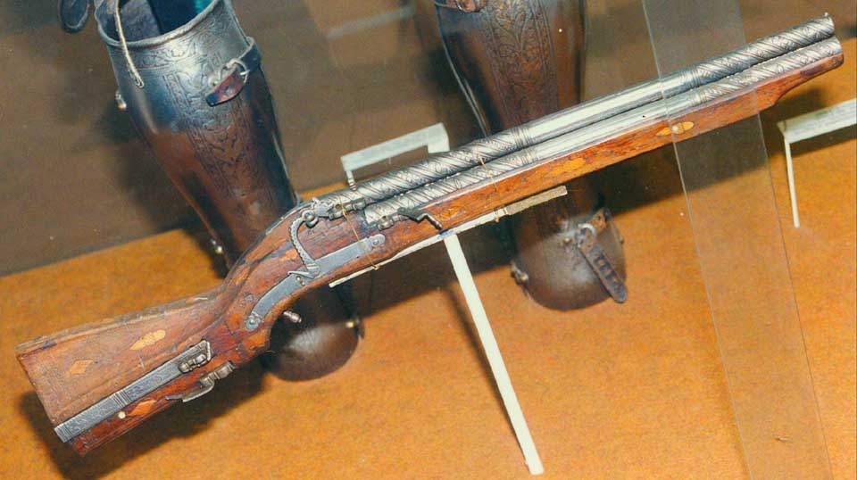

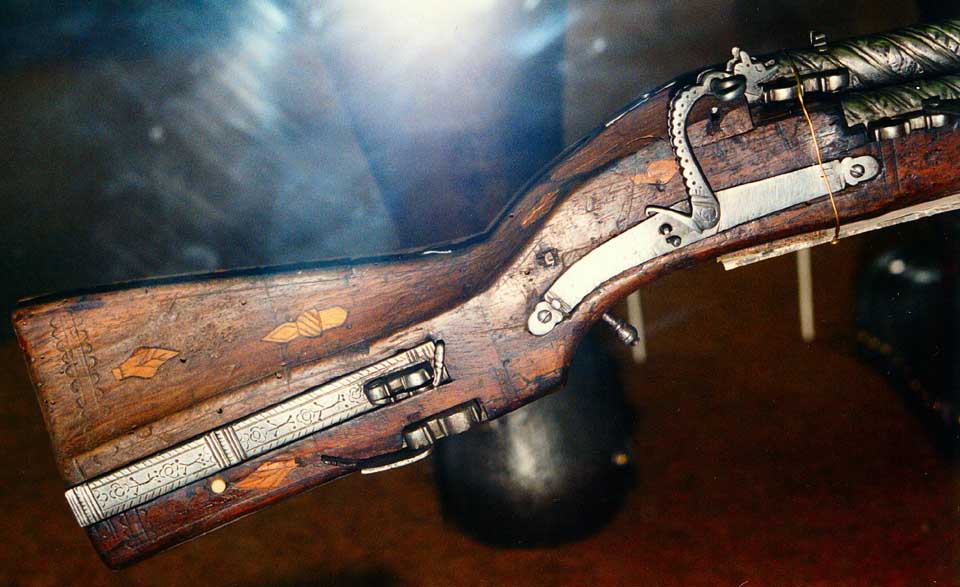

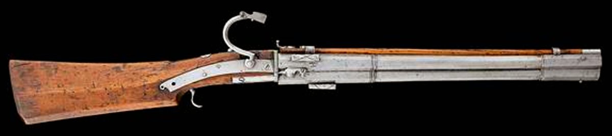

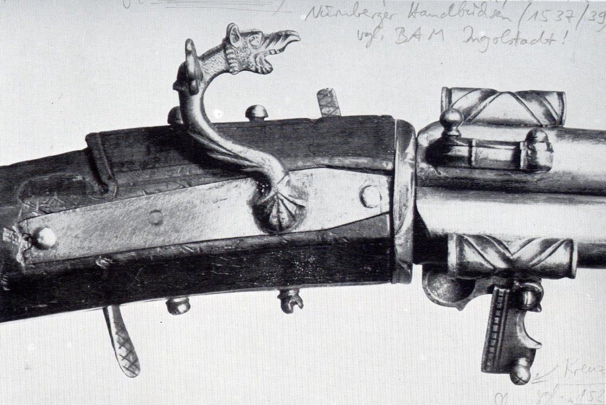

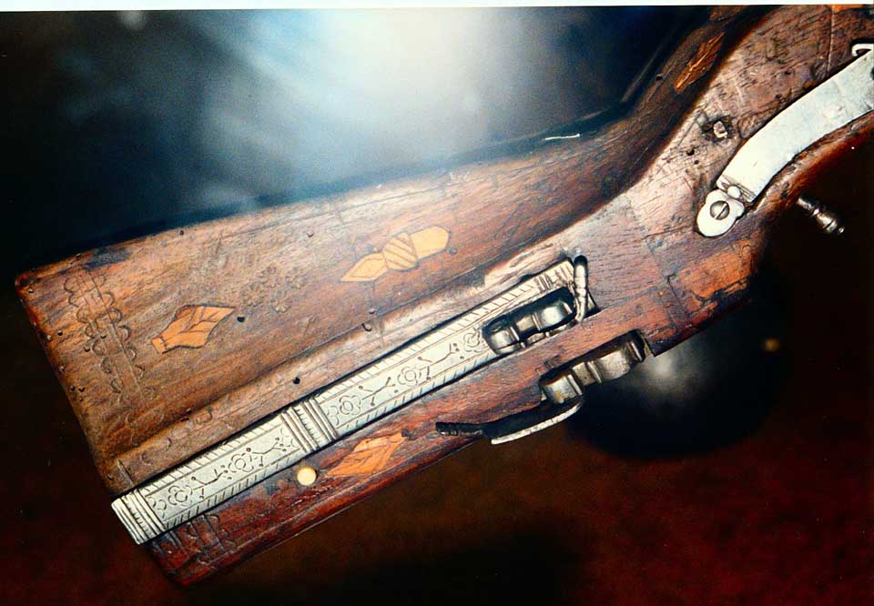

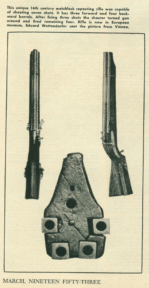

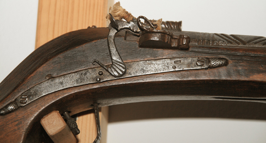

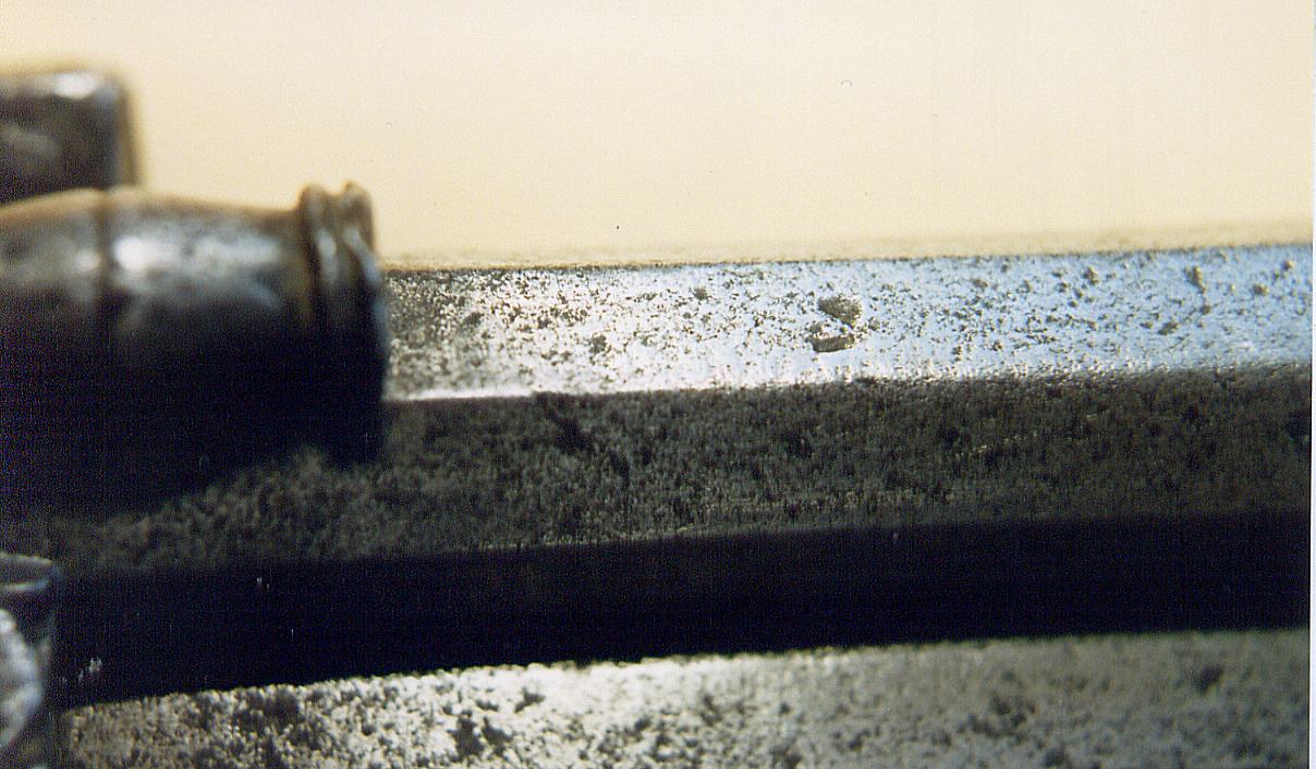

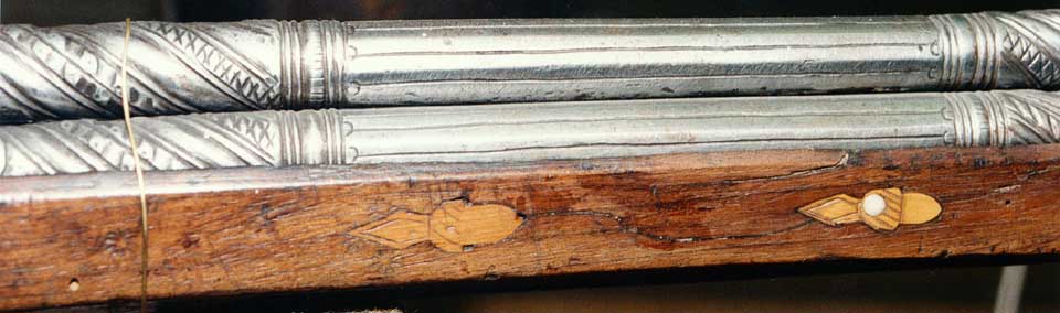

Default A Truly Sensational Seven Barrel Matchlock Arquebus, Brescia, ca. 1530, in Prague!

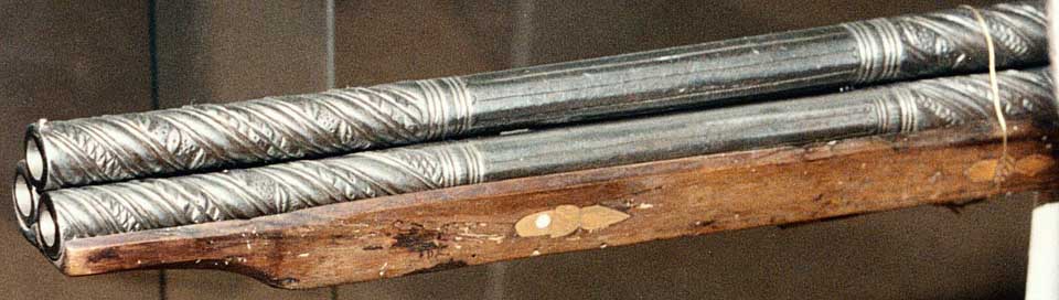

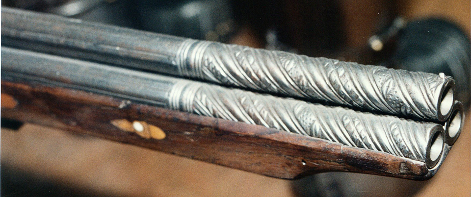

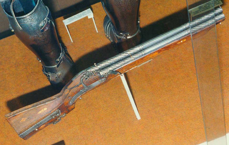

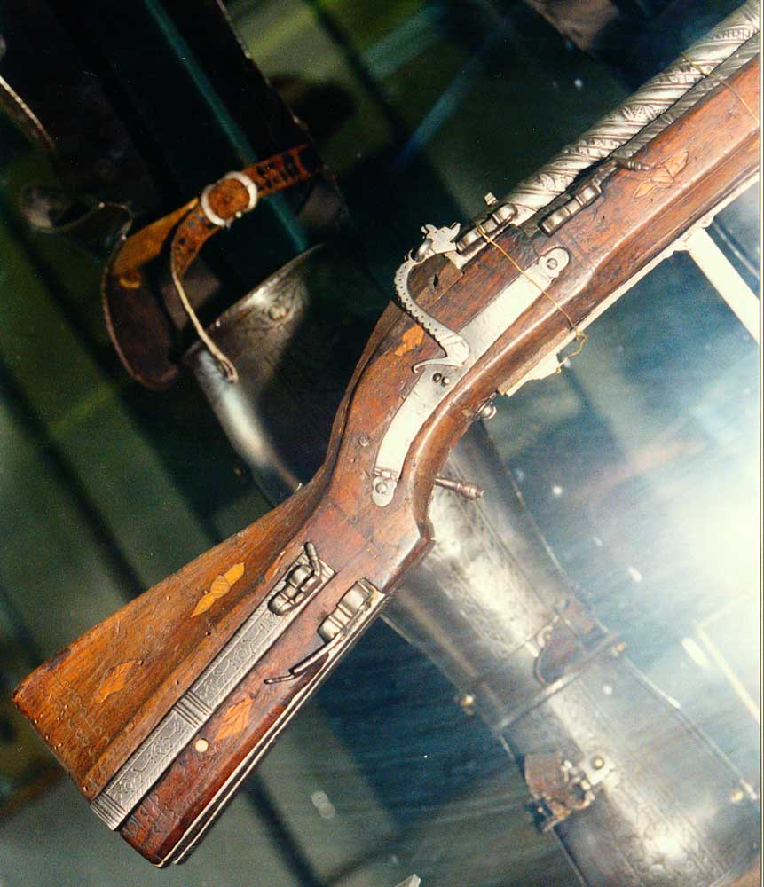

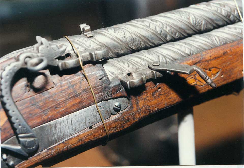

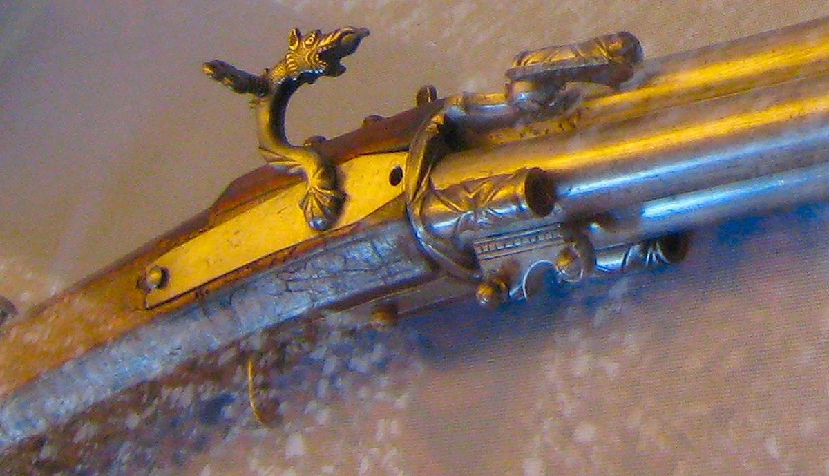

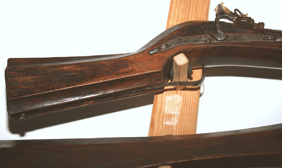

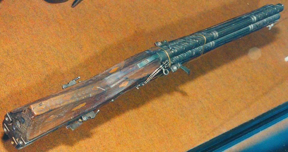

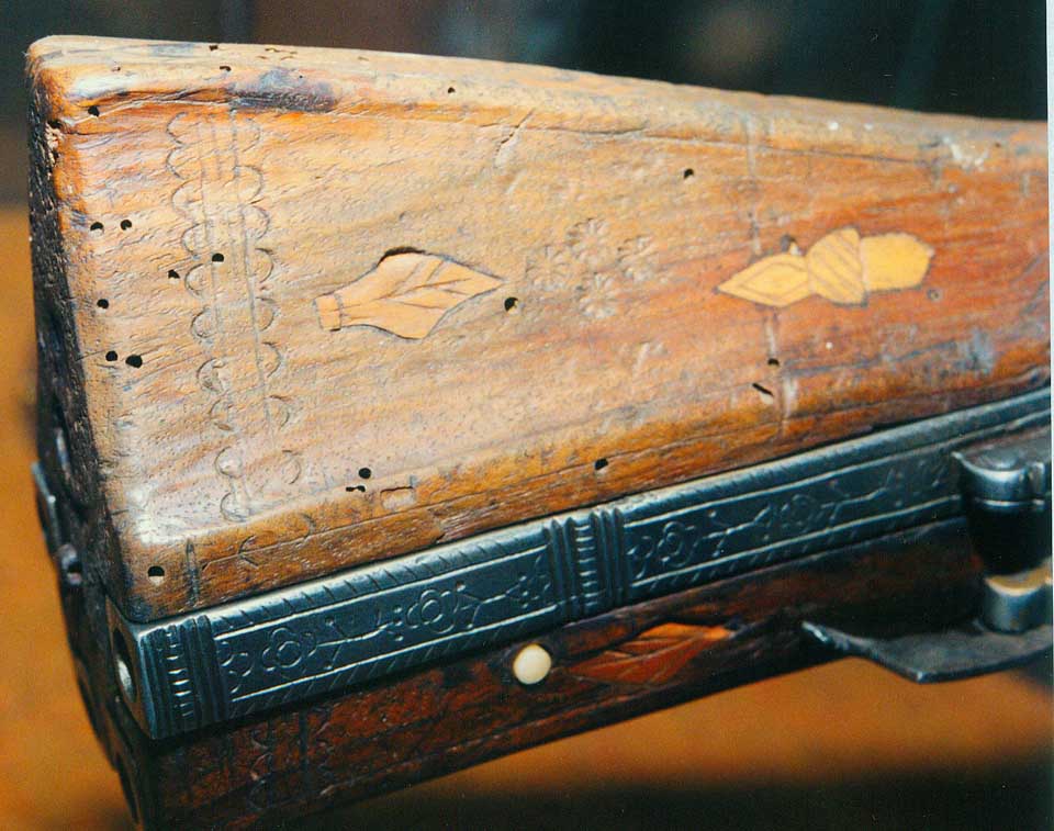

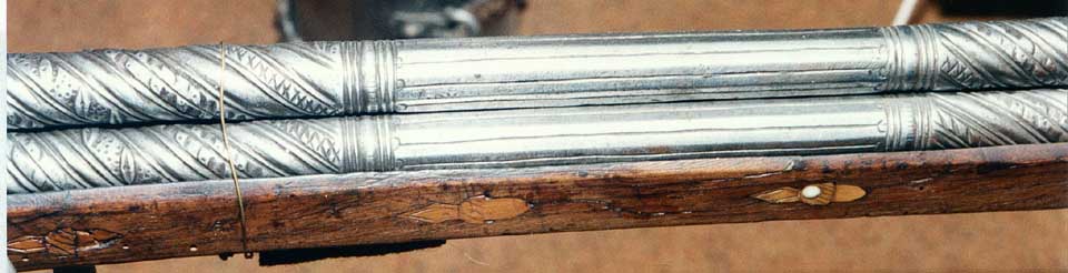

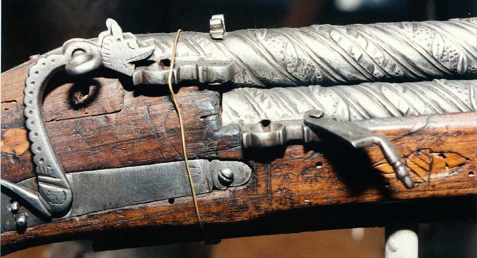

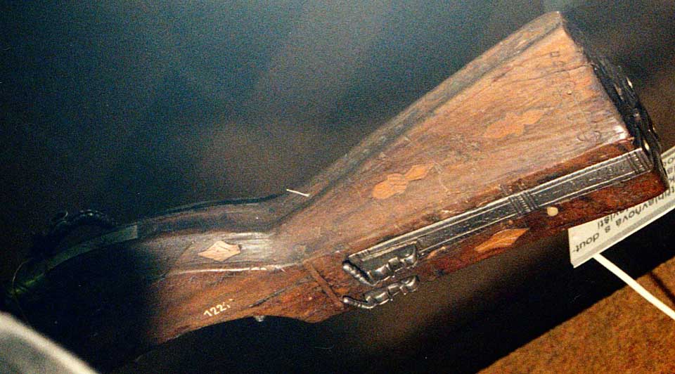

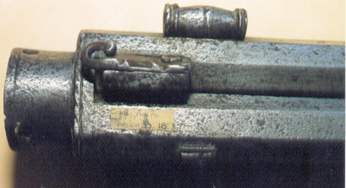

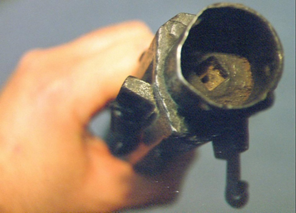

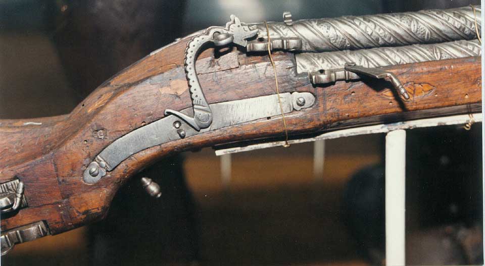

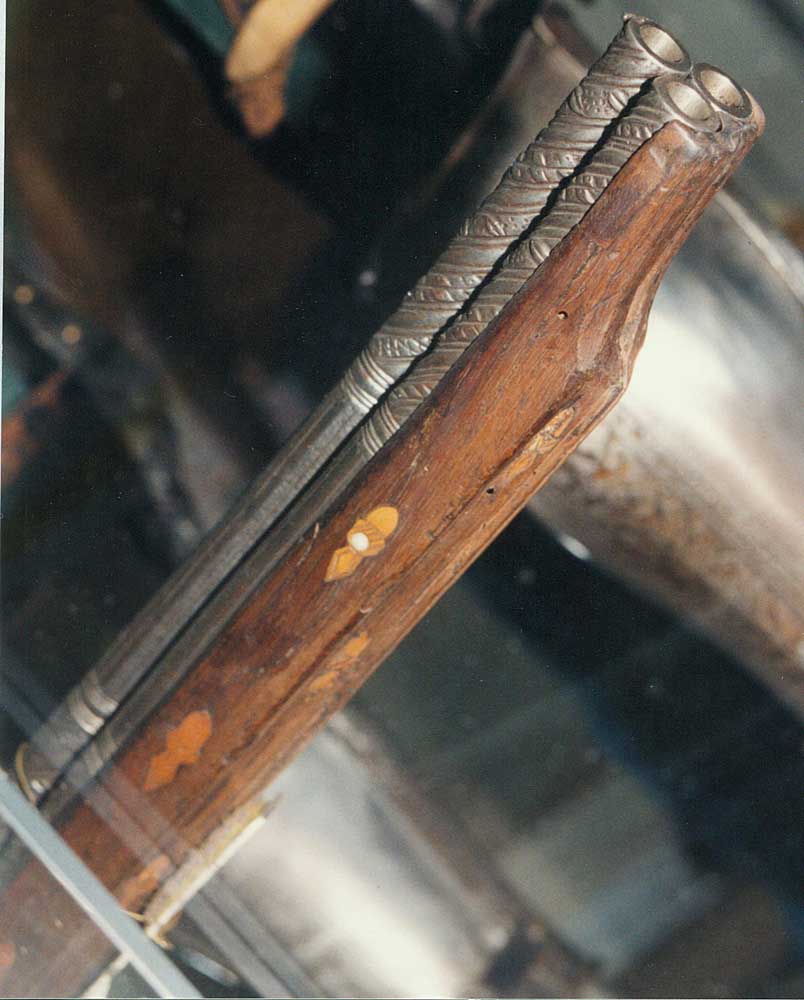

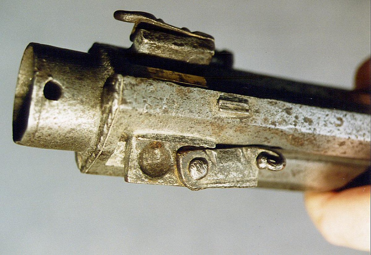

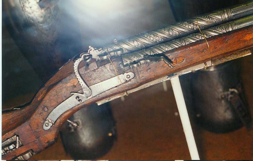

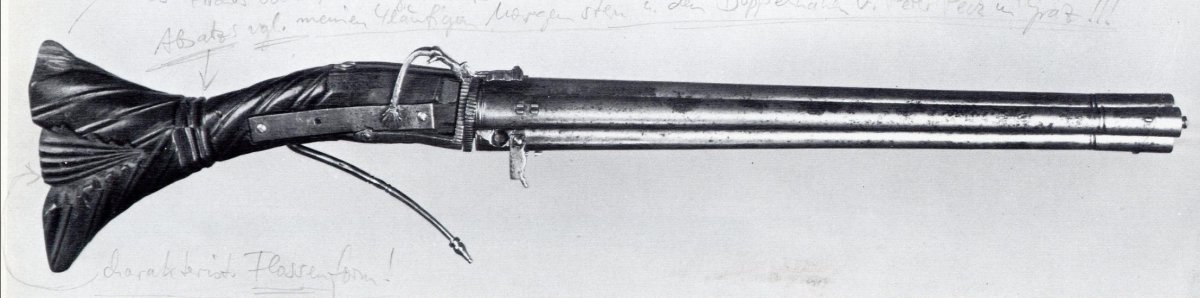

This unique specimen is preserved in the Prague Army Museum on the Hradschin.
Overall length only 64 cm (!), caliber of the three longer barrels ca. 10 mm, of the four short barrels in the rear buttstock ca. 8 mm.

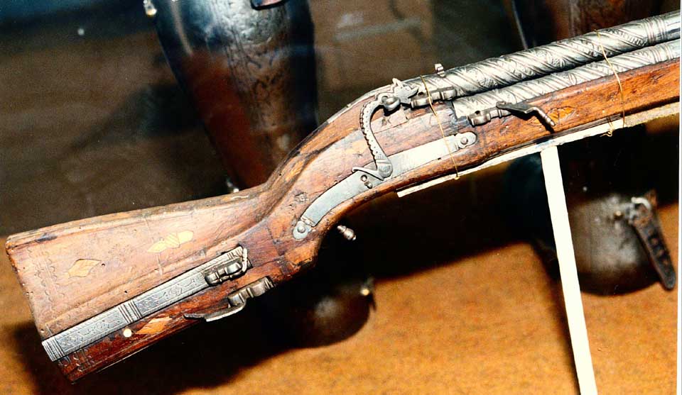

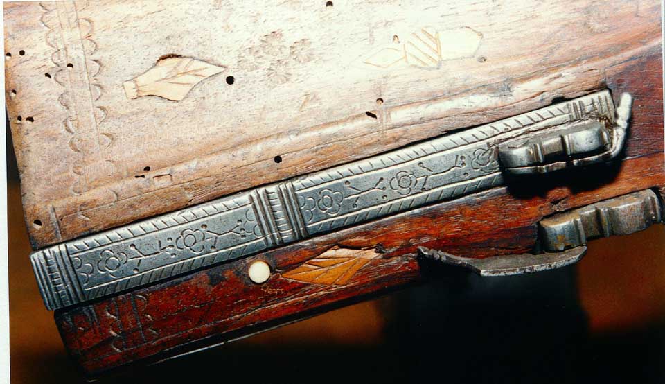

This is a North Italian, almost certainly Brescian, short snap matchlock arquebus. The full stock is of walnut which is characteristic of Italy, the inlays are of lighter wood, not of staghorn as one might expect. The front barrels are round, three staged and profusely ornamentally chiseled whereas the rear barrels are of square outer shape.

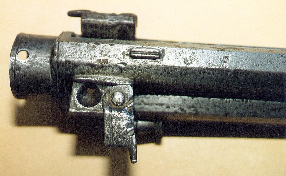

The central barrel is sighted, the back sight was originally equipped with a tubular sight, now missing as well as the ramrod.

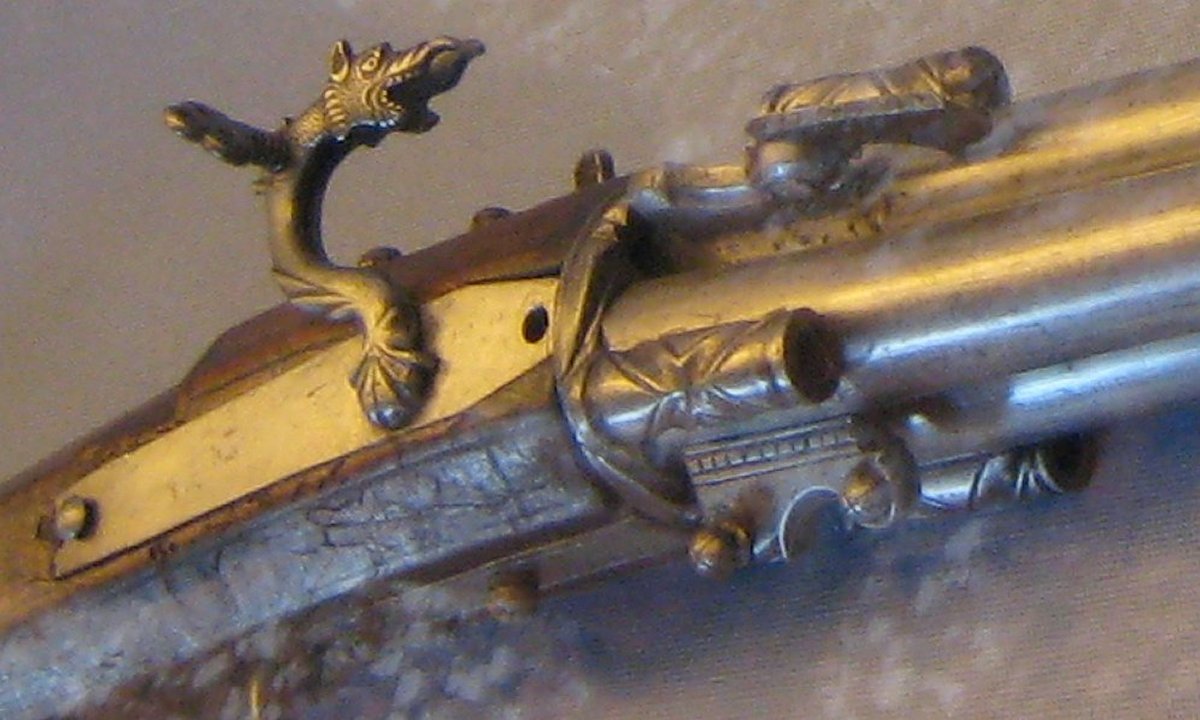

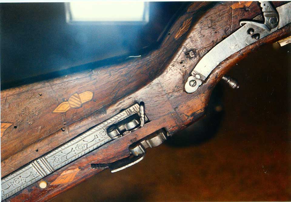

The seahorse zoomorphic serpentine of the spap matchlock only ignited the upper barrel while the two others and those in the buttstock had to be manually fired.

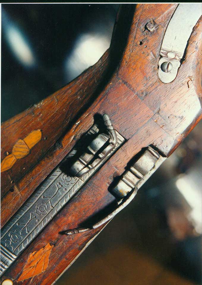

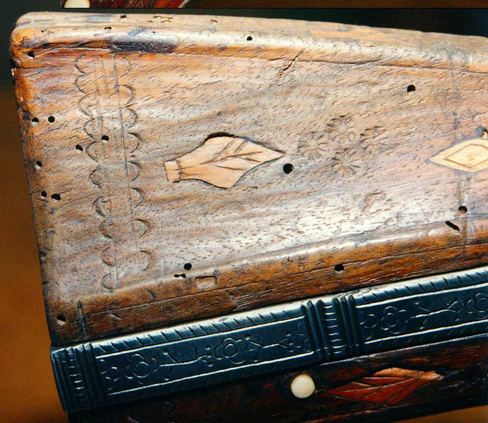

The holes in the bottom of the buttstock originally contained the ramrod (the larger drilling) for the rear barrels and secured by a swiveling lid cover hinged with a hook to the ring seen below; an oval impression of that lid can still be seen in the wood.

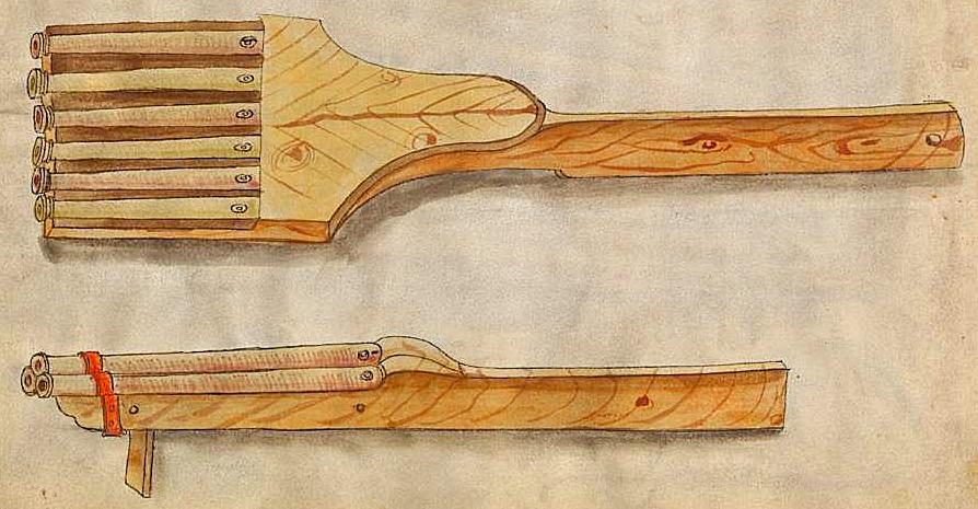

A similar three barrel arquebus for completely manual ignition is illustrated in the Maximilian Armory Inventory, ca. 1507 (cod.icon. 222), see attachments.
Author's photos, August 1995. The b/w scan is from American Rifleman, March 1953.

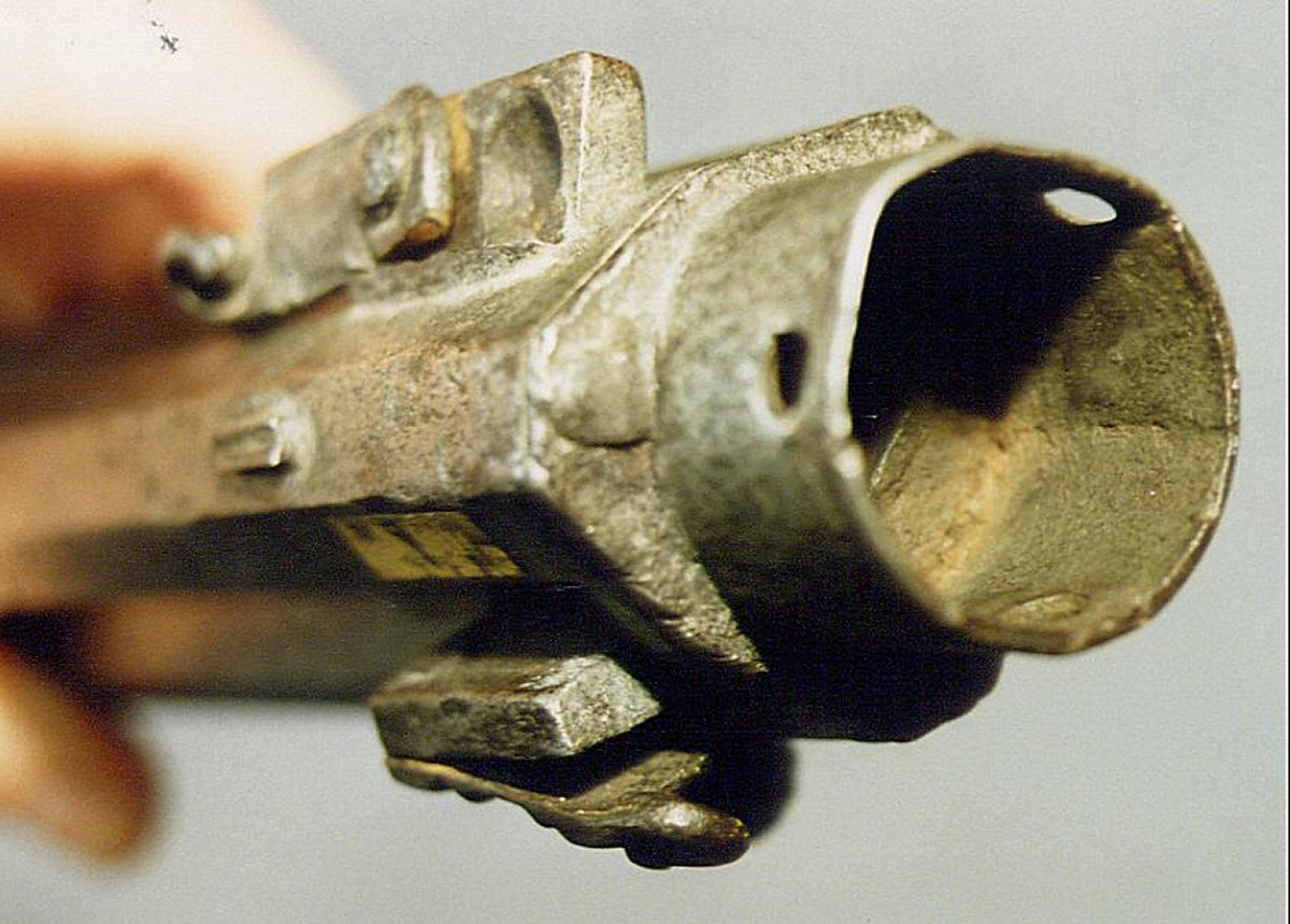

Posts: 4,310

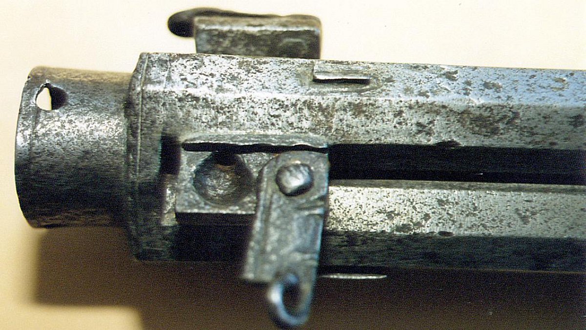

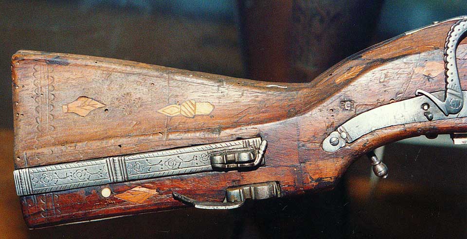

More.
Old 14th October 2010, 05:13 PM   #3
Matchlock
Matchlock's Avatar
Join Date: Sep 2008
Posts: 4,310
The rest.

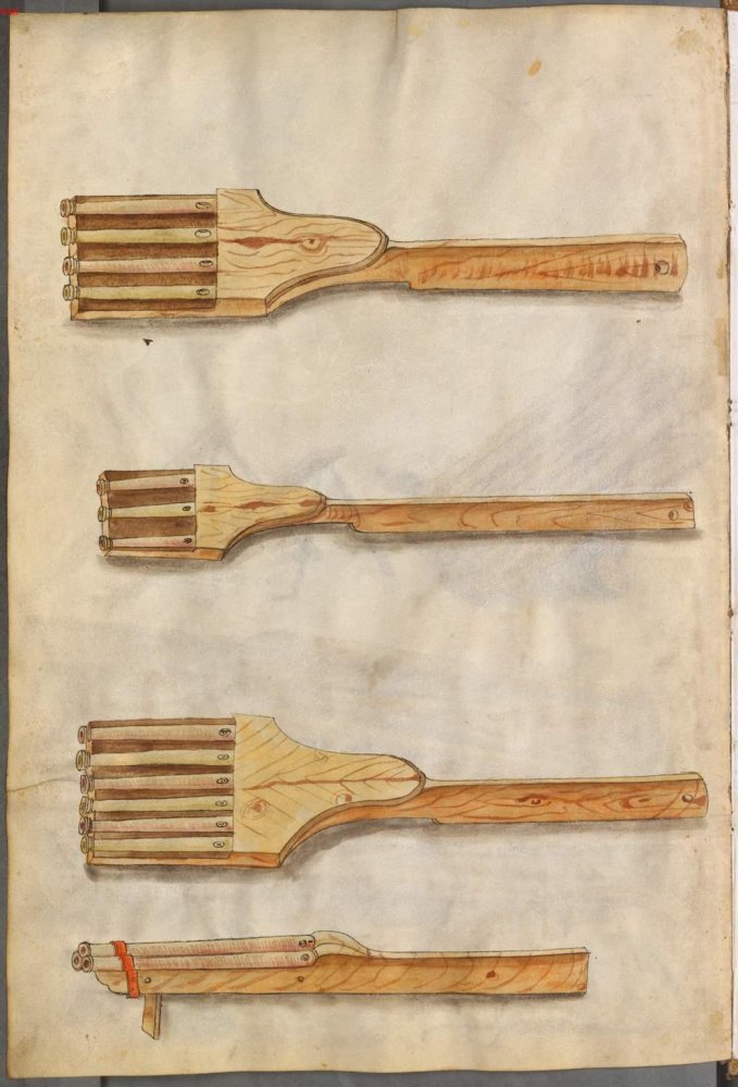

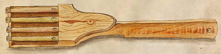

Default Mulitbarrel Arquebuses, ca. 1500, From the Maximilian Armories
Cod.icon. 222, ca. 1502.

Default Seven Barrel Matchlock Arquebus, Brescia, ca. 1530
Oh, oh, Michl,
Thanks for showing this .
I remember having posted a picture of this specimen in a determined thread (don't remember which) and you had "promised" to bring up some further data on it ... which now you deed.
This is quite a "crazy" gun, isn't it?
Old 15th October 2010, 05:36 PM   #6
Matchlock
Matchlock's Avatar
Join Date: Sep 2008
Posts: 4,310
Exactly, 'Nando,
This sort of Early Renaissance combination arms can indeed be called crazy as their practical use was almost nil - apart from play and psychology.
Michl

Amazing! Thanks for showing it to us!

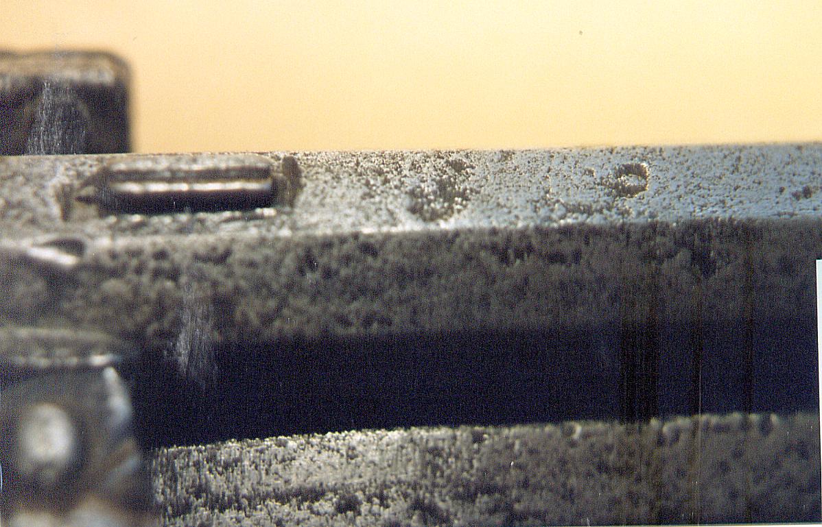

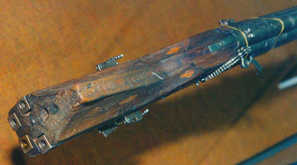

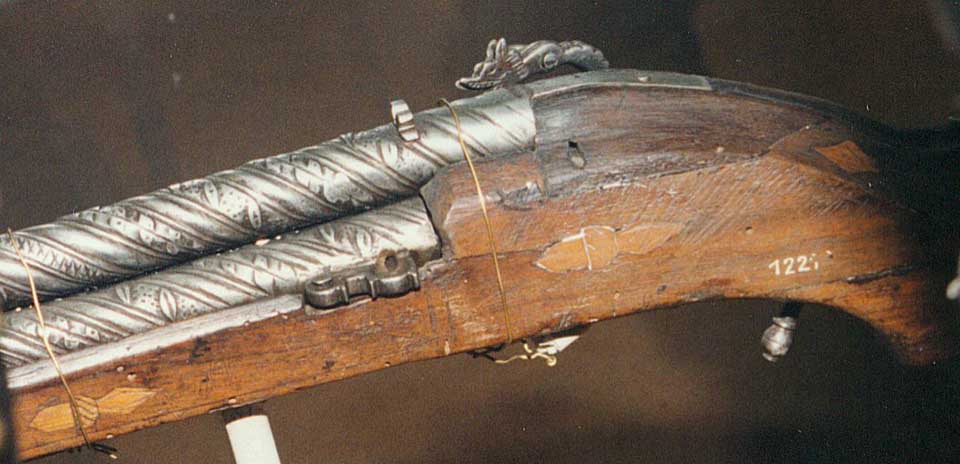

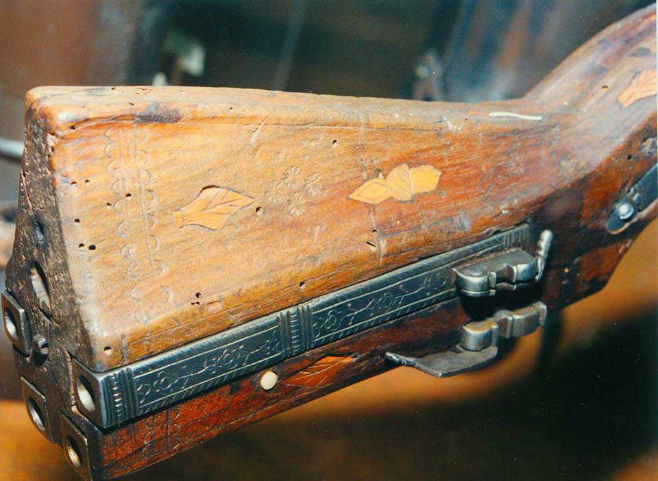

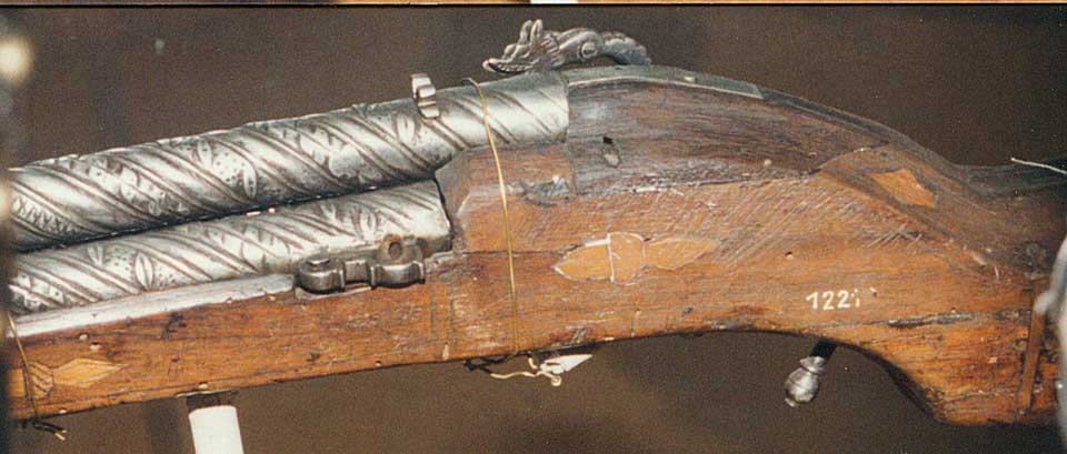

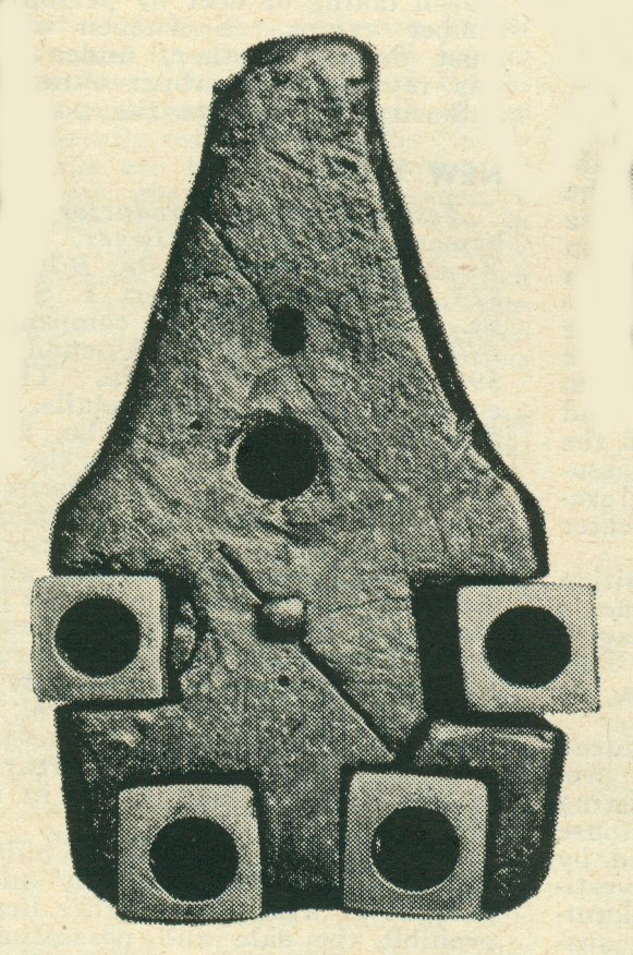

If I'm not mistaken, the rear barrels have been fired, perhaps excessively, as the stock shows what appear to be period[?] repairs. I'm sure everybody wanted to fire the 'butt-gun'.
Old 16th October 2010, 10:02 AM   #8
Matchlock
Matchlock's Avatar
Join Date: Sep 2008
Posts: 4,310

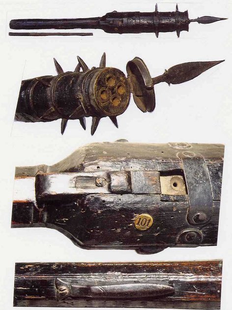

The seeming stock 'repairs' are not repairs!

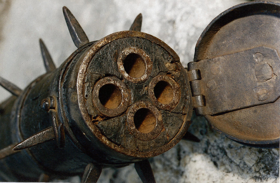

In order to make this construction possible, each single one of the four rear barrels had to be inserted in a square block of wood, which then was glued to a cutout recess in the buttstock. It is not possible to do this any other way.

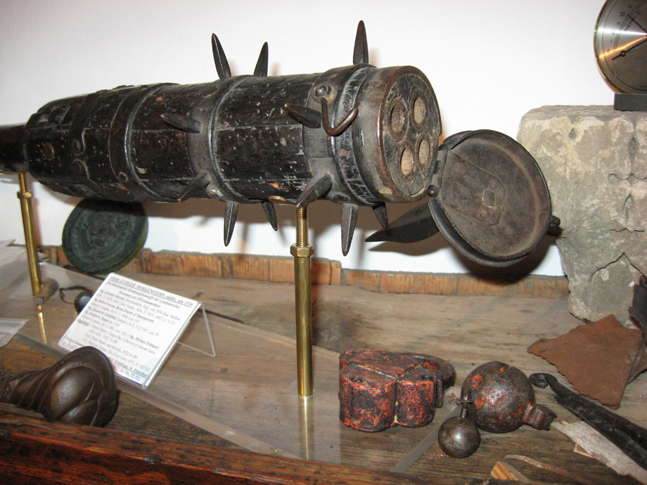

The very same procedure was used on my four barrel mace of ca. 1540: all barrels are individually inset and surrounded by pieces of wood:
http://www.vikingsword.com/vb/showth...hlight=meyrick

Default My four barrel Landsknecht Mace, ca. 1540, Revisited
The barrels are inset in separate oak blocks.
m

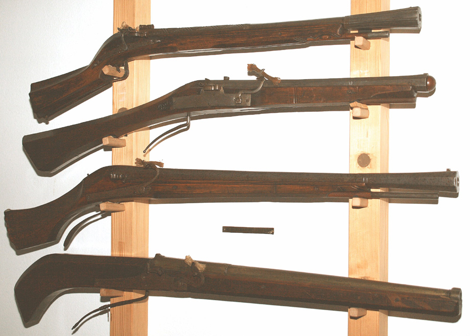

For comparison, I repost some photos of the Tusco-Emilian guns in my collection and in the Royal Armouries Leeds.
m

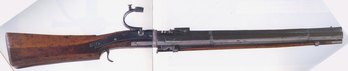

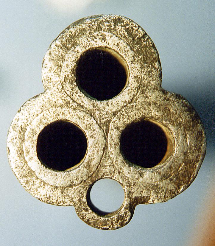

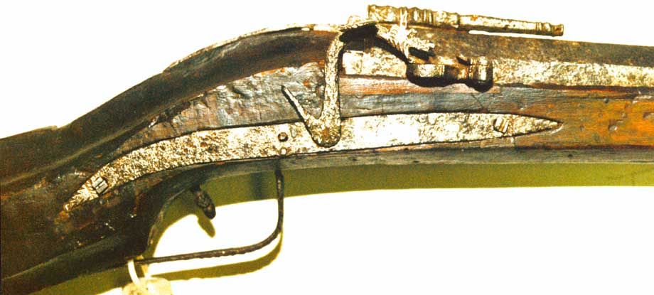

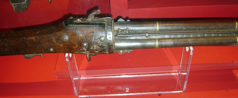

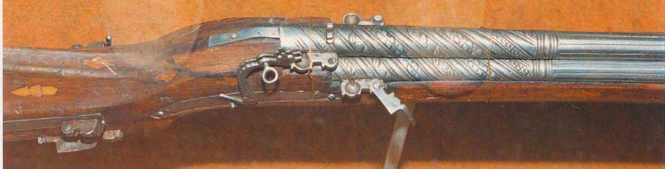

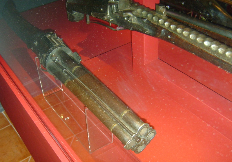

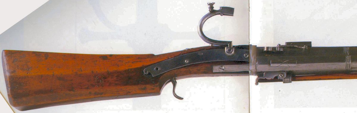

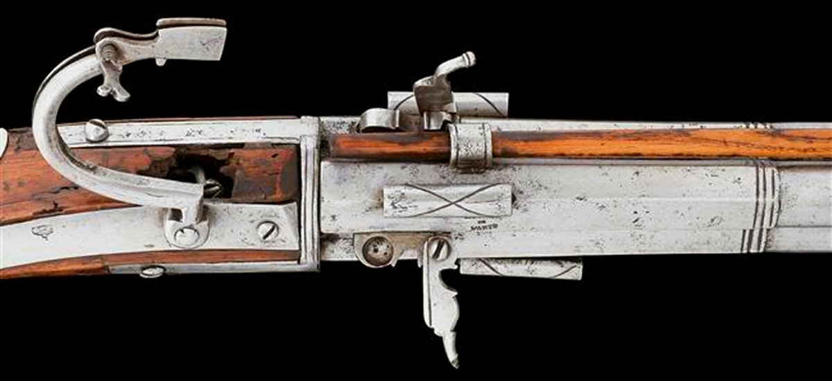

Default Three-barreled Revolving Matchlock Arquebuses, ca. 1530-40
1. Northern Italy (Brescia?), ca. 1530-40; Museo Luigi Marzoli, Brescia; the long tiller trigger inadequately pointing in the direction of the muzzle instead of to the rear, the original sighting tubes missing from the small double rear sights.

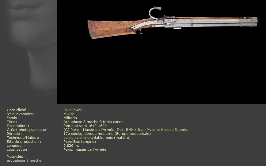

2. Northern Italy, ca. 1530-40; Musée de l'Armée, Paris; no provision for a trigger guard.

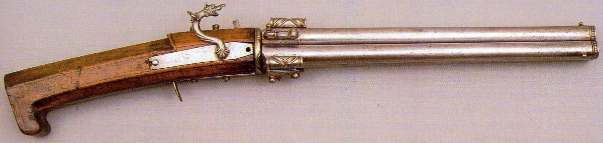

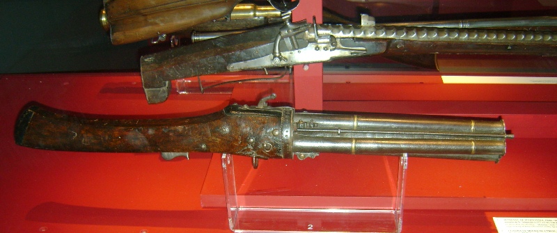

3. A short revolving matchlock arquebus or pistol, Northern Italy (Brescia?), 1530's-40; Doges Palace, Venice; no provision for a trigger guard.

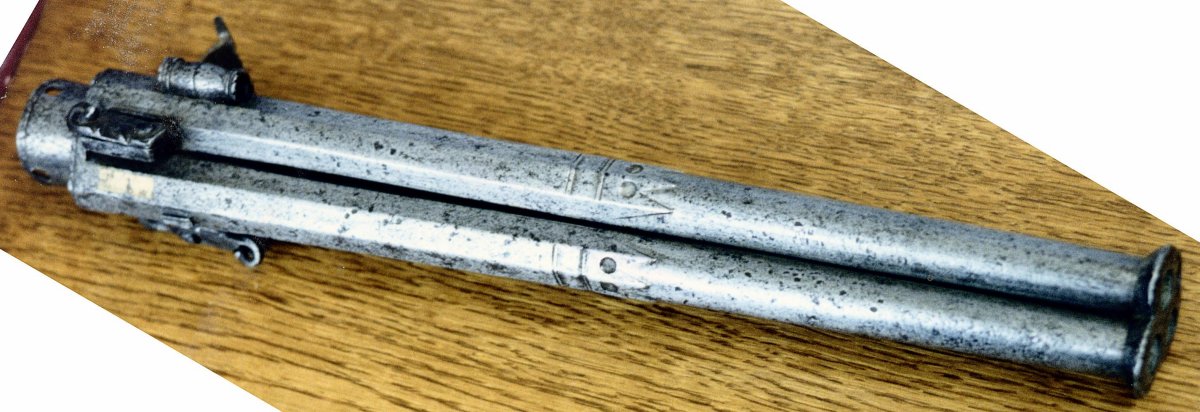

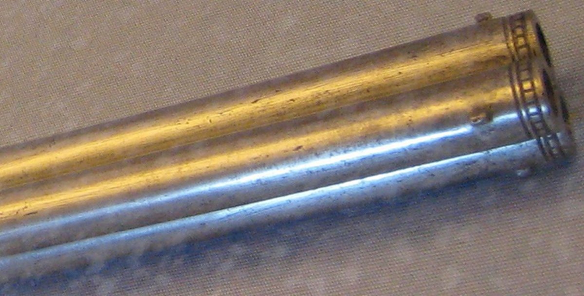

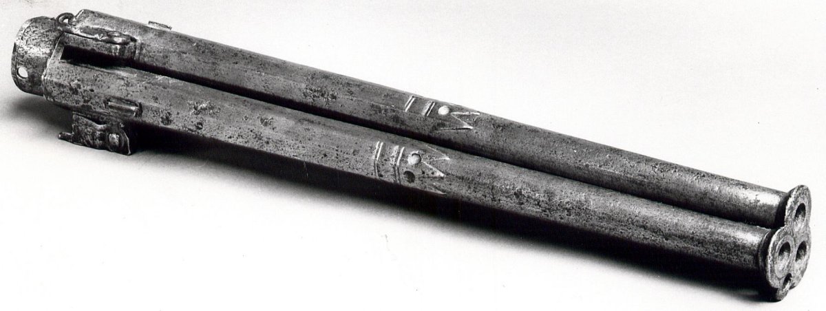

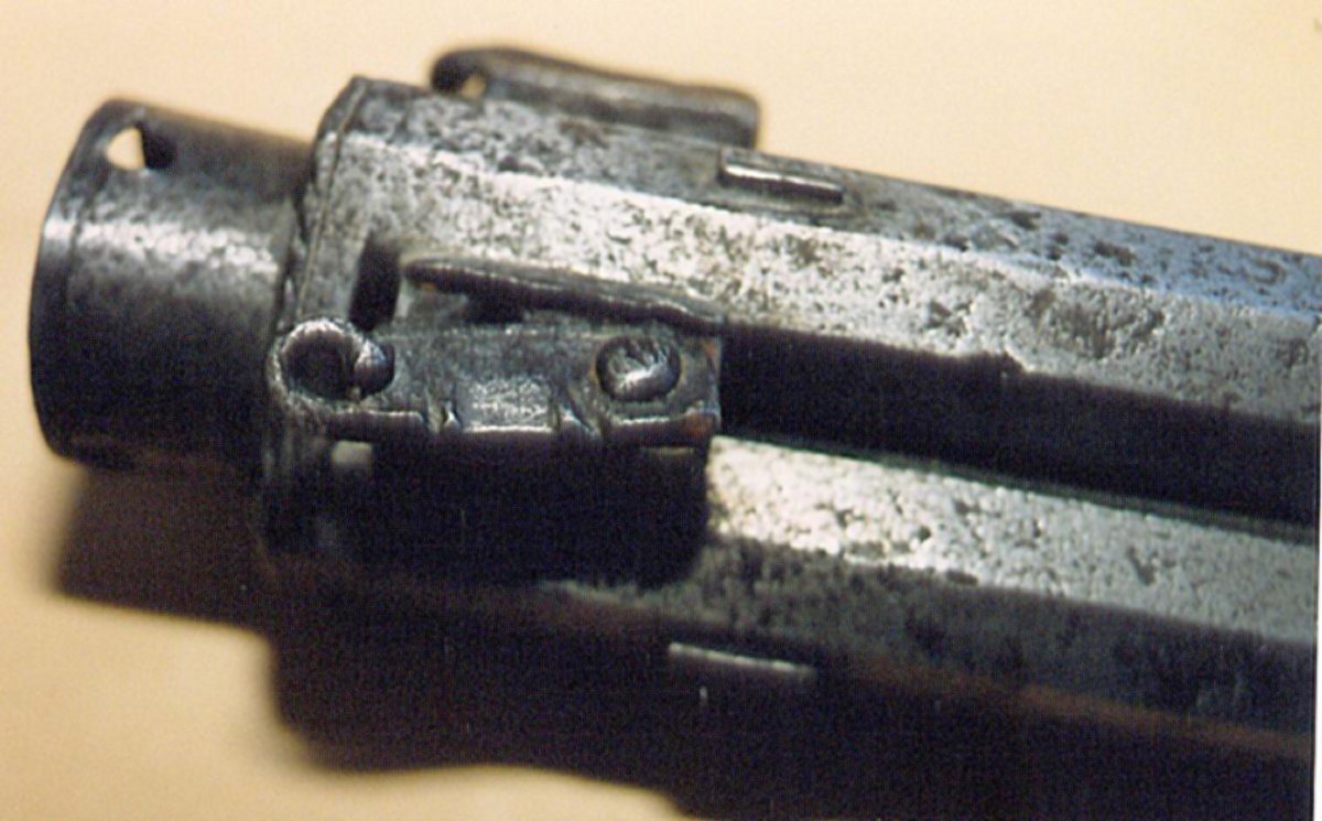

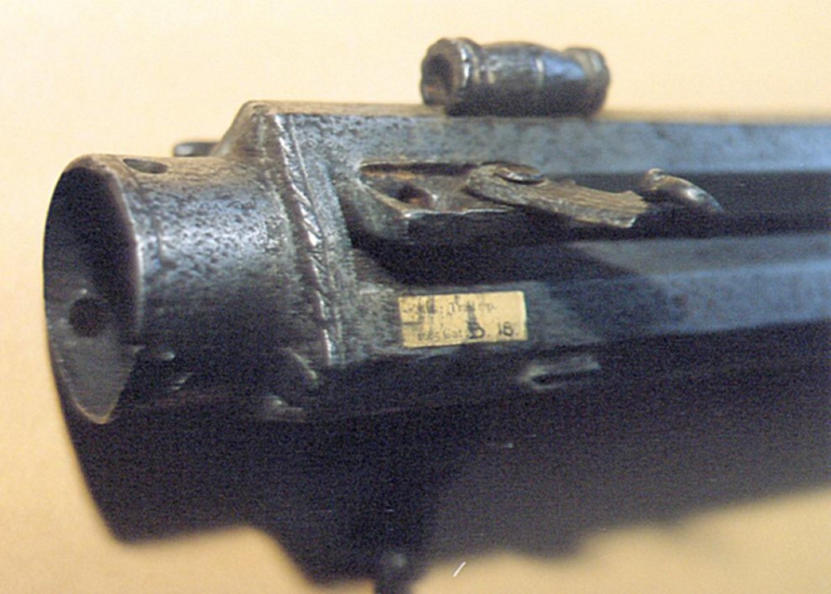

4. A detached barrel bundle of three, comprising a provision for a ramrod, of the same type of arquebus/pistol as before, Northern Italy, 1530's-40; Ashmolean Museum, Oxford, reserve collection; author's photos.

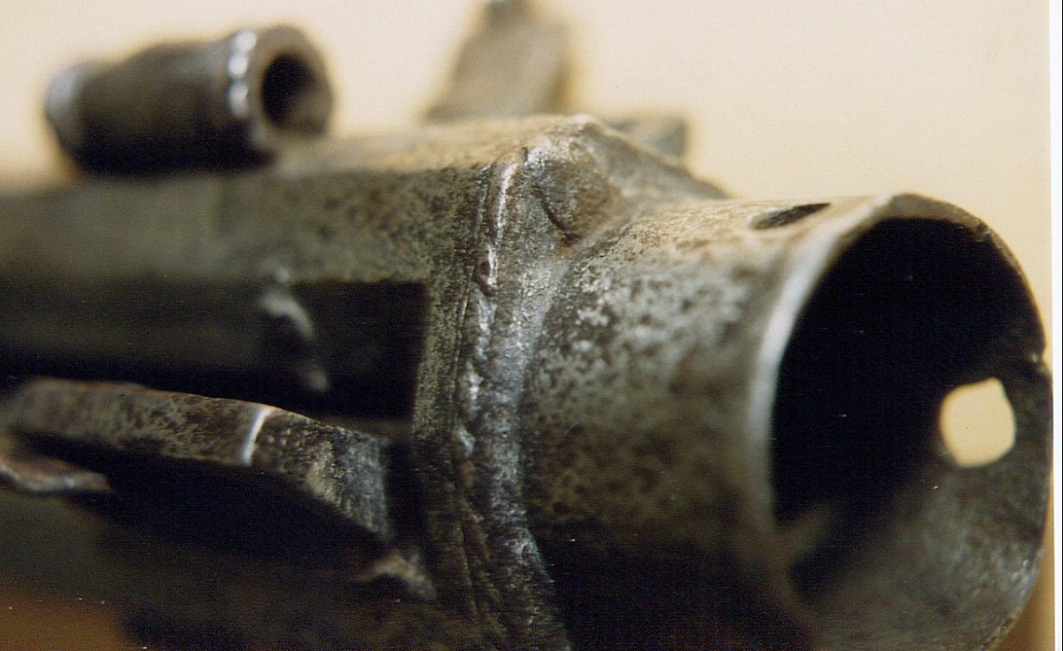

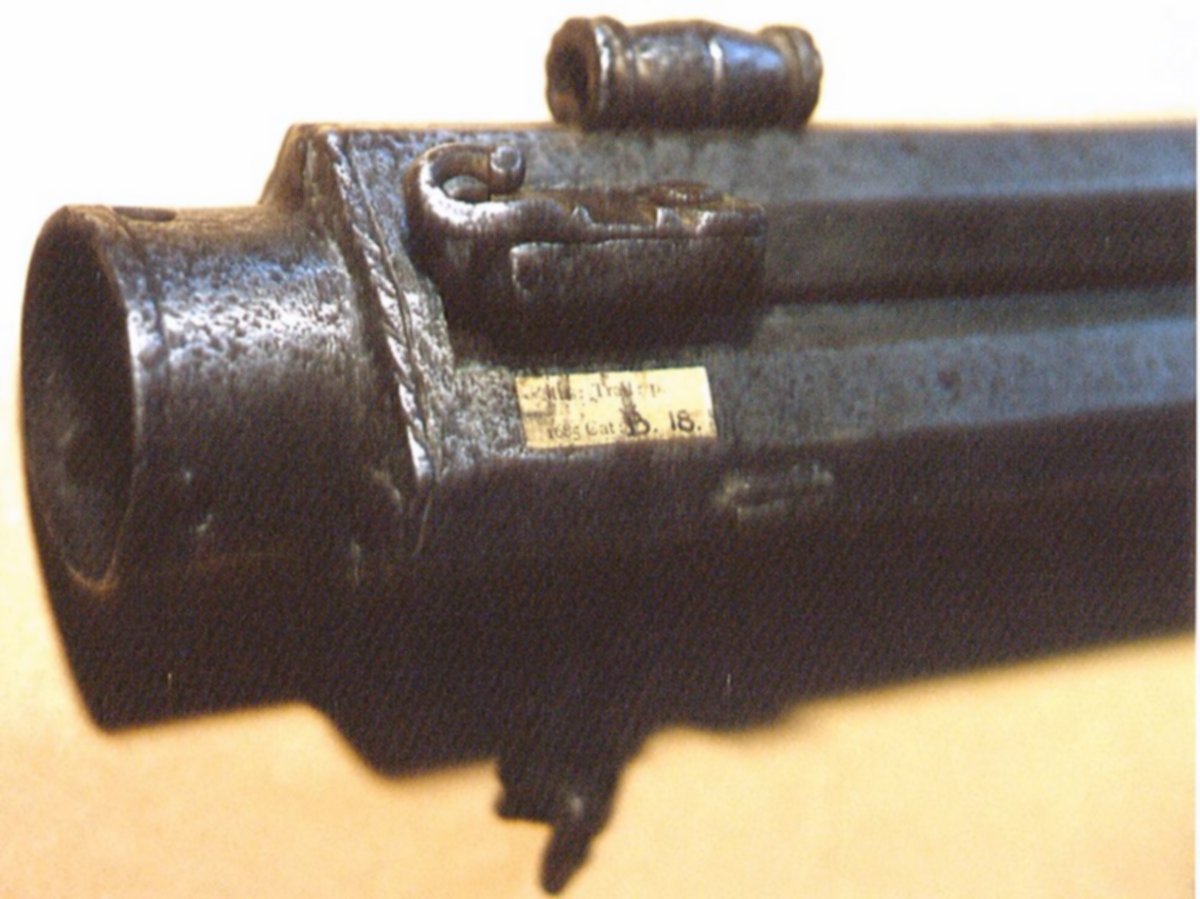

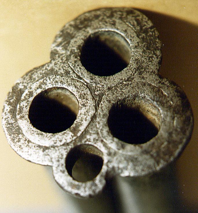

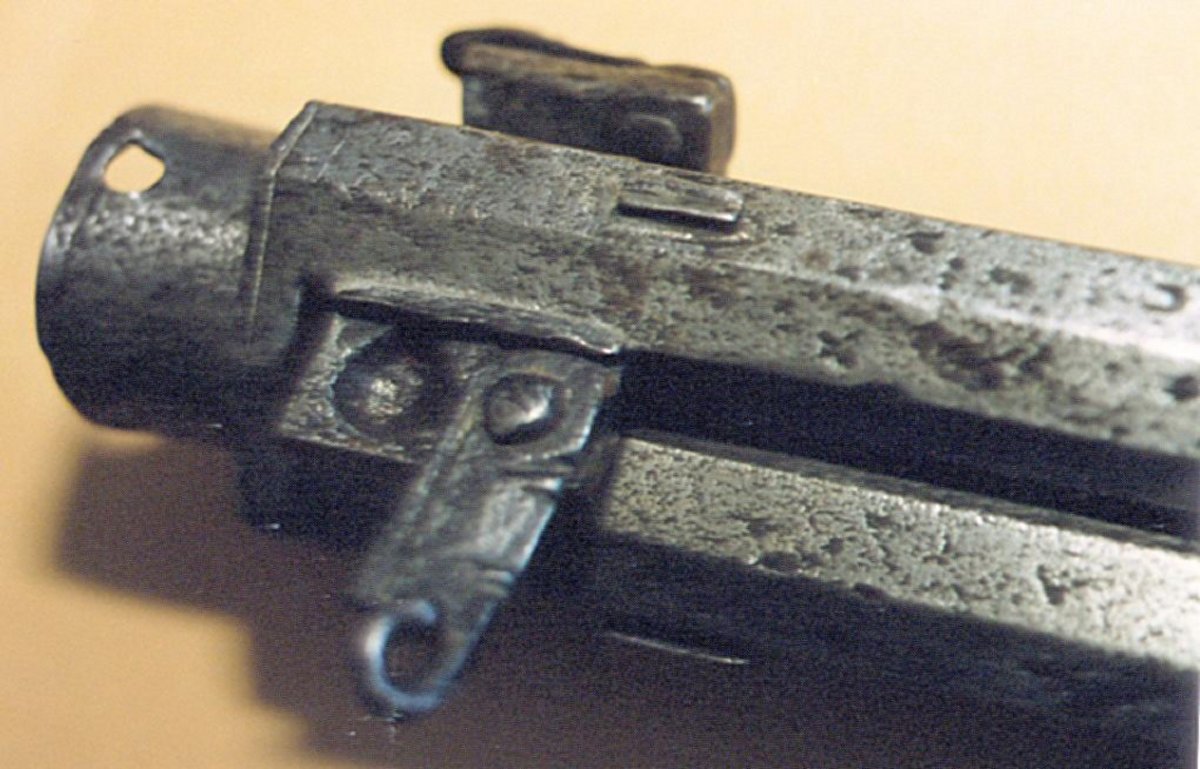

More of the Venice pistol and the barrels in Oxford.
m
Old 21st June 2012, 05:16 PM   #21
Matchlock
Matchlock's Avatar
Join Date: Sep 2008

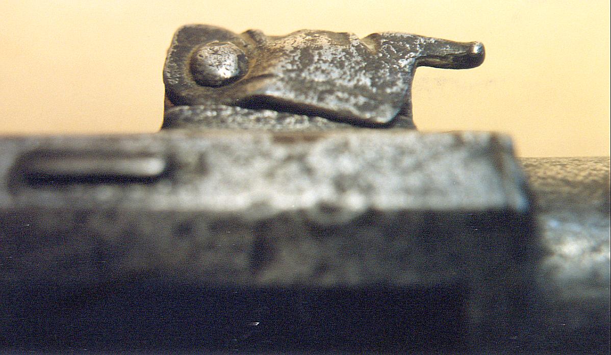

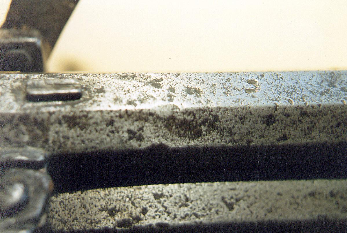

Posts: 4,310
The remaining photos.

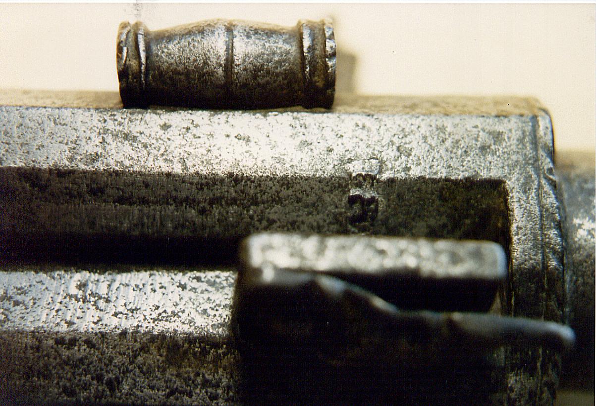

On two of the barrels the faint remains of an unidentified maker's mark can be seen; one barrel retaining its original sighting tube, the others missing from the small rear sights.
m

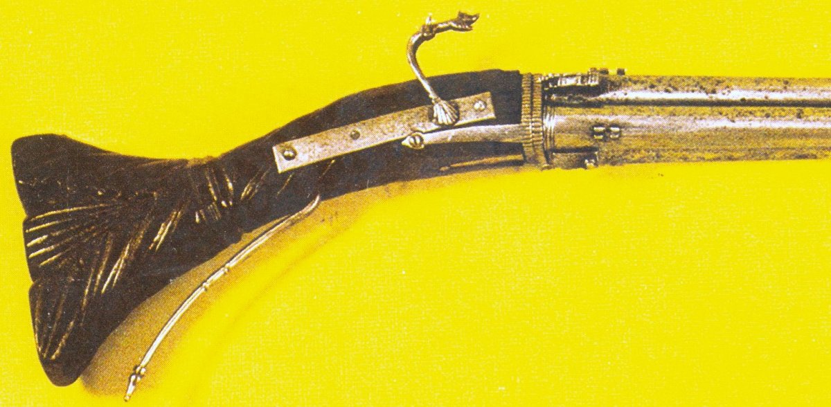

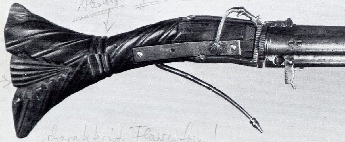

Old 22nd June 2012, 06:00 PM   #22
Matchlock
Matchlock's Avatar
Join Date: Sep 2008
Posts: 4,310

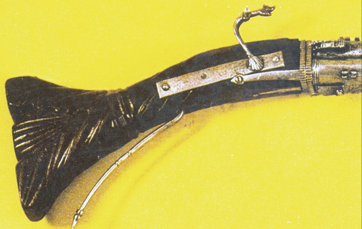

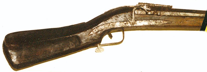

Some more details of the three-barreled revolving arquebus introduced in post # 19.

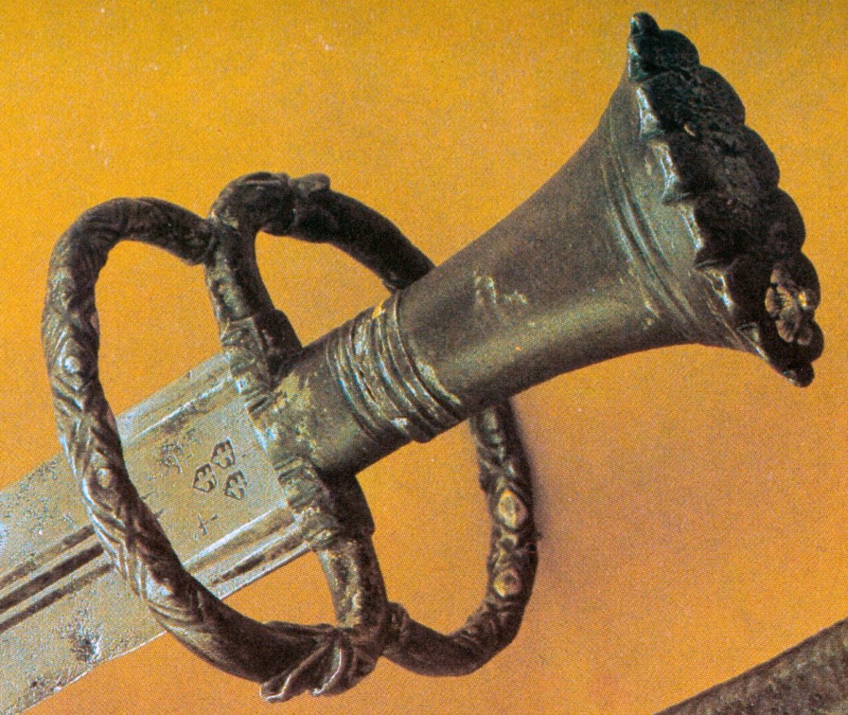

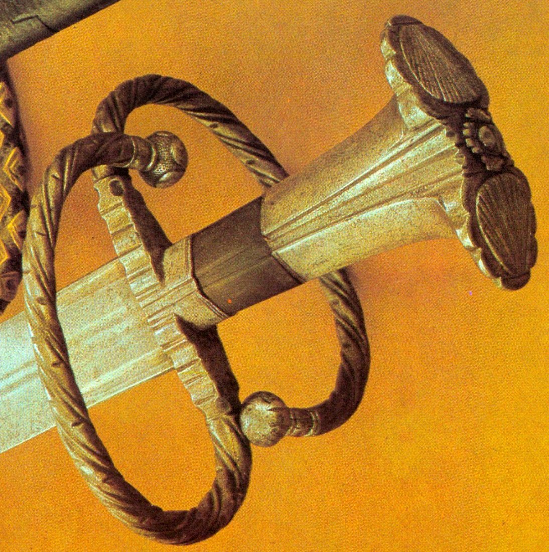

Please note the finely carved and wide-flared buttstock shaped like the tail fin of a fish; this is one of the earliest instances of a fishtail butt on a gun which was to become very common as the 'Spanish-Netherlandish musket butt' in around 1560 and remained popular with Central European military matchlock and wheellock muskets until the later years of the Thirty Years War.
A well-known contemporary stylistic Early Renaissance equivalent is the flared shape of the pommel of the characteristic Katzbalger Landsknecht's sword.
m

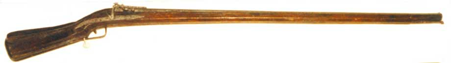

Default Speaking of multi barrels
May i show this one in here?
An Indian four shot rotary barrel matchlock "clavina" from the XVII century, based on Portuguese technology.
(Collection Rainer Daehnhardt)

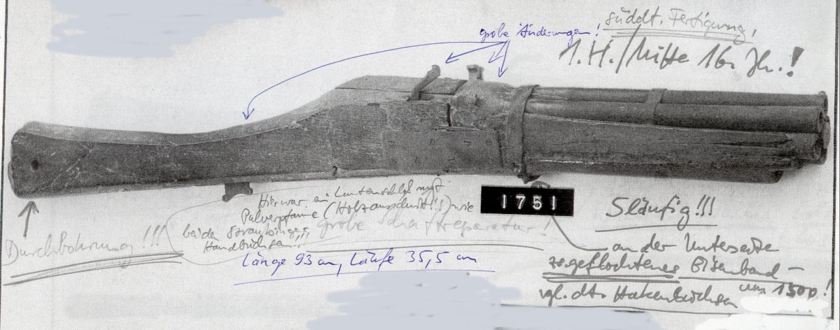

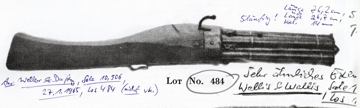

Two similar five-barreled pieces are recorded:
the first 93 cm long, barrel length 35.5 cm; sold Wallis&Wallis, June 16, 1967.
Its general design was clearly based on that of German haqbuts and arquebuses of ca. 1500:
the buttstock pierced in the same manner (for suspension from the wooden rack in an armory), and the iron barrel retaining ring entwisted on the underside of the stock; the barrels are non-revolving and the back sight closely resembles that on German arquebuses of ca. 1530-40;
the second 76.2 cm long, barrel length 26.7 cm, bore 14 mm; Weller&Dufty, January 27, 1967 (not sold).
