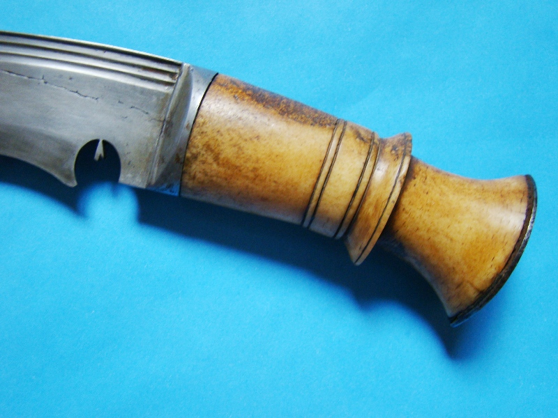

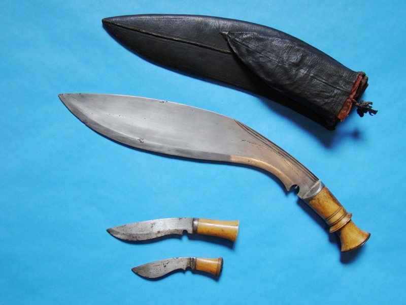

I picked this up from Gav a couple of weeks ago. Looks to be a WW1 era piece. The hilt is either bone or maybe polished antler with a steel plate on the butt. The blade is well forged with a triple fuller. Let me know what you think.

This is obviously Spirals domain but in my limited experience a good pointer to overall quality is how well the chakma and karda are executed. In this case they look very well made and nicely finished. I know the steel bolster is sometimes a pointer to an earlier piece and I would think you're not far wrong in your assessment of age. A good looking Kukri.

Well not much to add except that so far the hilts do look like polished horn.

Nice set. The karda almost looks more like a patch knife. What is the size of the kukri?

the posted khukuri seems to have a linear feature just under the aunlo bal, which appears to possibly be a lamination indicator. could this be of laminated construction (possibly pre-ww1 then)? any markings on the right side? nice khuk.

Glad you liked it, I was quite taken by it too. I think you are correct in the antler attribution, it certainly has the colour more so than bone and there is a slight rough surface present in one spot too, this could well be where it was ground back but not too far to keep a proper shape.
My money is on older than WWI, the item came from a collection with all older swords and Afghan knives that were circa 1790s-1850s. I do not know if this piece is as old as 1850 but it is as kronckew notes, the indicator of laminated steel is present and I know from giving this piece a little attention it is laminated and I think from memory with a etch, differential steels will show but with no clear pattern. It is a good and very sharp fighter with a good forward heavy weight and in great condition overall. One plus would have to be that it was once a tool kit example that are quite sought after and I think if you talk with Himalayan Imports, you might be able to source a full antler handled set of tools.

A straight-on photo of the butt plate could show whether it is more likely an original feature or a later addition. That information might be helpful in dating this lovely old kukri. One rule of thumb holds that butt plates began to be used around 1900.

Its a lovely piece Lew! Id say your probably right in your date estimate, But at the very least certanly from the c.1900 to .c1930 era to my understsanding.
I like the shape & style of it.
The scabbard is also well made, so are {as Norman noted} the small knives. Id guess the handle is Sambar antler thats ground & polished, but could only be 100% certain in hand.
Berk I agree to date that most buttplates seem to appear on Wood or horn handles around c.1900 I know of 2 earlier than that, one in a Nepali collection & one a very unusual Indiam made presentation piece sold in auction in England about a decade ago, But I think they are both exceptional forerunners or possibly in the case of the Nepalese example carrying a later repair or even some accidental confusion in its identified history.
