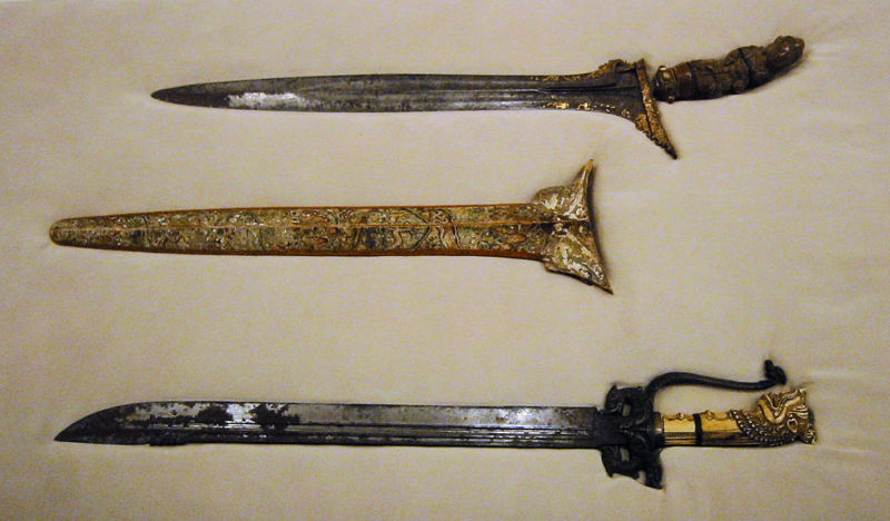

Hasekura Tsunenaga was a Japanese samurai and diplomat who was born in 1571 and died in 1622.
He undertook diplomatic missions to the Americas, Europe, and the Philippine Islands. He returned from his mission the the Philippines in 1620, and amongst the things he brought with him was a keris from the Indies, that is, Indonesia. That keris can now be found in the Sendai City Museum in Japan. Here is a picture of the keris brought to Japan in 1620 by Hasekura Tsunenaga. |

That's interesting. Too bad we don't have some better images.

Maybe this photo will help.
ADDED: Actually, nw that i look more closely, this is the same photo which Alan cropped just to show the keris....but at least it is a bit larger.

It is interesting to note that this same mission apparantly acquired one of the earliest provenanced examples of the kastane (in the familiar sinha hilt with makaras) of which I am aware. This early example kastane is also on display in the Sendai Museum, perhaps part of the same exhibit, with this material in "The Unique Kastane Sword in Japan" by Dr. P.H.D.H. DeSilva in an article from Nov. 15,1998 listed as in the "Sunday Observer". It notes that Tsunenaga was a vassal of the Daimyo of Sendai and left on the Keicho Mission in 1613, returning in 1620, noting visits to Mexico, Madrid and Rome.
As noted, details of provenance of this, as with the keris, seem a bit vague, and acquiring these suggest visits to these places but apparantly remain unclear. |

Very interesting thing is, the blade of this most early Kastane seems to be an imported one, there should be an european monogram on it.

Please accept my apologies for posting such inadequate images.

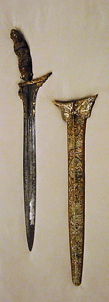

I find that I am unable to understand almost anything about a keris unless it is in a vertical orientation, rather than a horizontal orientation, in fact when I want to really look at a keris I download the image and change the orientation to that shown in this post. Hopefully these images will be a little more useful. |

The hilt looks most interesting! I've seen something similar of recent manufacture, and I dismissed it as a newish design. According to the dealer, the hilt came from north coast of Java.

The hilt is much more finer as it seems on the pictures.

Time to bump a worthy thread. Can anyone say anything about the sheath?

Well, this really deserves more attention, yet there is a problem with adequate online pictures, with available material a discussion here seems to be impossible. Slightly better pictures of sheath and blade, good pictures of hilt and description are to be find in Jensen's Krisdisk, chapter 7 (Bali), pages 31-33.

Would love to have had even bigger pictures to tell if the scabbard has gold on it for sure and what quality of work. Same for the rest of the piece, especially since it is rare to have such an old piece like this with documented provenance going back that far.
Still thanks for posting this Alan. Also I wonder if this was indicative of the size of blade back then, getting smaller in Indonesia as time progressed and larger in the Philippines..... |

The sheath is painted. There exist three or four such old sheaths with painted alas-alasan motifs. Painting is done very spontaneously, the depicted animals are well characterized.
#16 |
Posts: 7,342
Thank you - I now see it as gloss and not metal shine. Helpful.

Jose, these white stains are places, where ground coat is visible.
The sheath is made from one piece of wood, gandar iras, like all sheaths, which can be traced back to the first half of 17. cent. Gambar is unfortunately broken (the wright side). |

Regarding hilt and selut, there probably are some mysterious things. For such high quality keris and sheath the match of hilt and selut is very bad. Selut is clearly to small for the hilt (which must be very huge, even compared to keris), this selut is the only one of this type I have seen with such an early provenance, and looks, how can I say it, modern designed compared to the rest.

I am a little hesitant to enter this conversation when so little about the origin of this keris is know and the photos are so bad. Where do people believe this keris is originally from. From what i can see, to my eyes it looks a little Balinese. Certainly the hilt form, though a bit different from later styles, looks that way due to the type of selut and figurative hilt. Also what appeas to be two fullers reaching down most of the blade is a common feature on Bali blades. If indeed we are looking at a keris that has been unchanged since it's collection in the early 1600s i'm not sure that we can really say without a full understanding of the origins of this keris whether of not this is a proper ensemble or not.
And Barry, if it was collected in the Philippines it may well be something pick up in travel, not a formal royal presentation, because this clearly is not of the Philipinnes. Given that scenerio it would be unlikely that the hilt was made specially for the Japanese ruler. It may well have had some age at the time. If the diplomat had made his way to Bali or Jawa to receive this then the story might be different. But i doubt that they would create a hilt depicting a Japanese deity for this. Certainly figurative hilts like this were being created in Bali at that time.

In Tropenmuseum there is (much younger) Balinese keris of somewhat similar appearance (picture borrowed from Maurice). I suppose, such feature as this selut is not known in Java.
I think, we can accept hilt and selut as a bad fit, becouse selut is not covering bungkul. It is clear, that gambar is being repainted with a symbol, which could be regarded as a christian one. With some certainity the repainting is done in the same style as alas-alasan on gandar, some colours are the same, some differ. I am not sure if we can call this keris a pick up, becouse it is a really high quality keris and Hasekura Tsunenaga was a diplomat on official mission. After beeing in Spain and Rome he stayed for two years in Manila before returning to Japan. It is a speculation, nothing about this part of his voyage is known, yet I don't think he was staying in this town all the time, and his staying there before the fulfilment of his mission should have some reason. |
