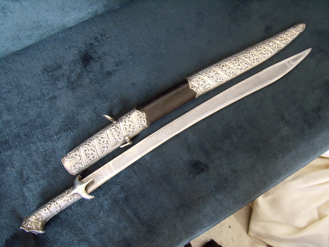

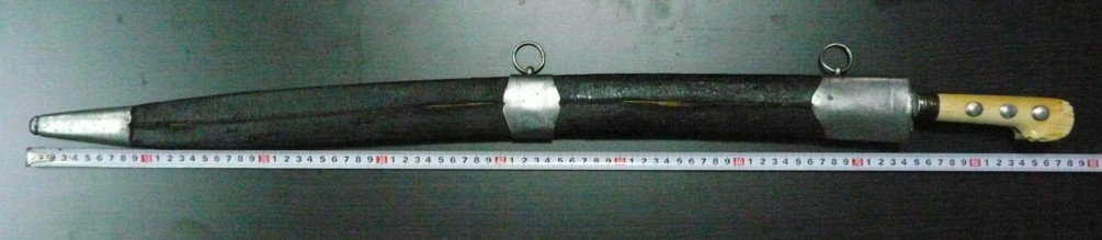

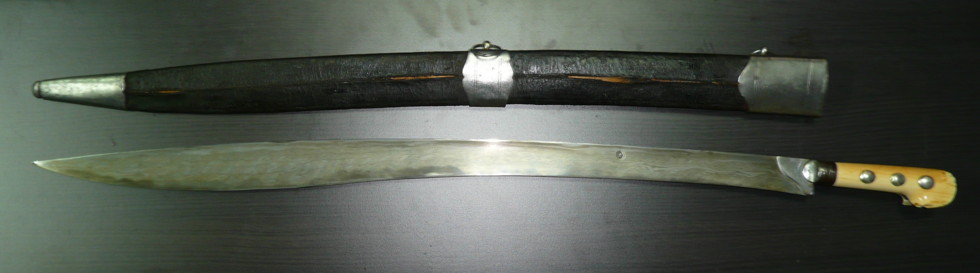

Hi everyone!
I bought recently this large yatagan,the blade is turkish ribbon,the grips are from ivory with silver.
The scabbard is from leather and the belt rings from iron.
The length is 87cm with the scabbard and 85cm without.
I want your opinion about the origin of it?
Can be European?Balkan?
I need your help!!
Thanks in advance for the help!
Aristeidis

Gorgeous yataghan, thanks for posting. Those large bellied blades seem to be generally earlier, based on examples in Vienna and Venice museums, all described as trophies from the wars with the Ottomans.
This might be the case here - an Ottoman blade, captured and later given an new scabbard with European fittings.
Teodor

Pay attention to the rings: it was hanging, not stuck under the belt.

I saw that, and thought about Jim claiming that large yataghans like this were used as a cavalryw eapon, though I am not sure of the reference for this.
Again, it looks to me like someone fitted this yataghan with a scabbard to wear it like a hanger.

Elgood's book on Balkan weapons ( pp.150-151) shows yataghans with karabela or kilij handles, crossguards and suspension rings: they all belonged to personalities in the Greek Navy.

Thanks Teodor for remembering my comments These kinds of heavy deep bellied blades I believe were quite possibly used indeed as horsemans sabres in some of the Illyrian units . These were if I remember correctly French units of irregular troops from Balkan regions and often commanded by French officers around the turn of the century into early 19th. . I cannot recall details further but much of this was based on research on one of these swords which had a vestigial crossguard, cleft staghorn grip with large brass grip rivets like this...the blade was of this shape with a crowned cypher and ligature suggesting European noble family heraldry.
The blade seemed European made if I recall, and of this heavy deep bellied yataghan shape.

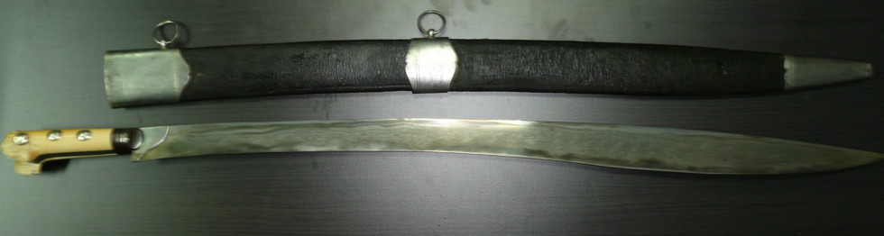

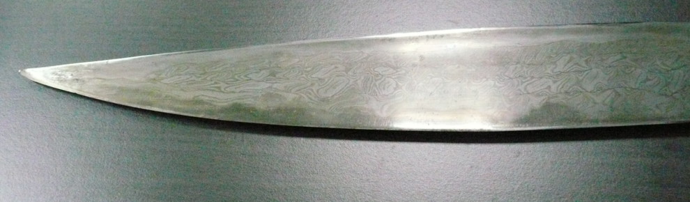

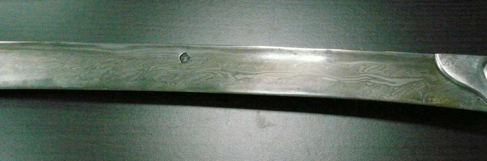

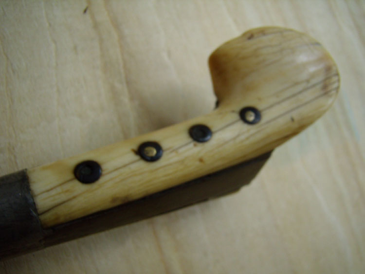

Thank you all for your comments!

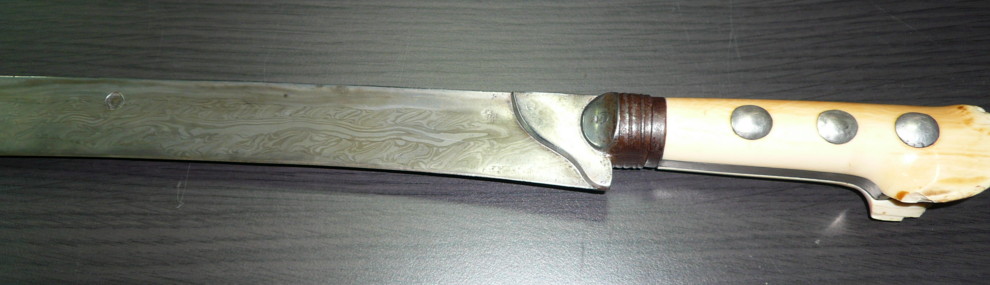

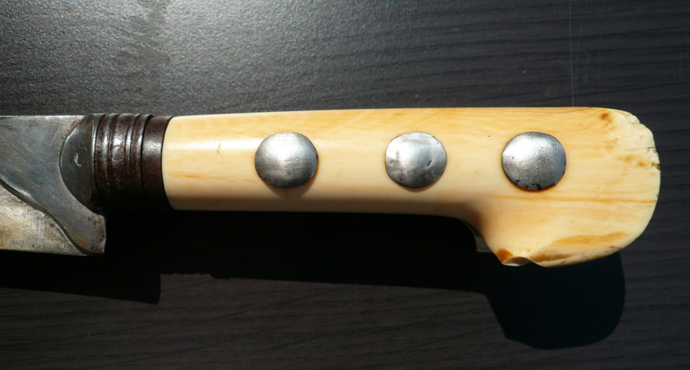

Here some photos from near distance of the blade and the handle!
I believe that the handle is Balkan in opposition with the scabbard whoever it shows European!

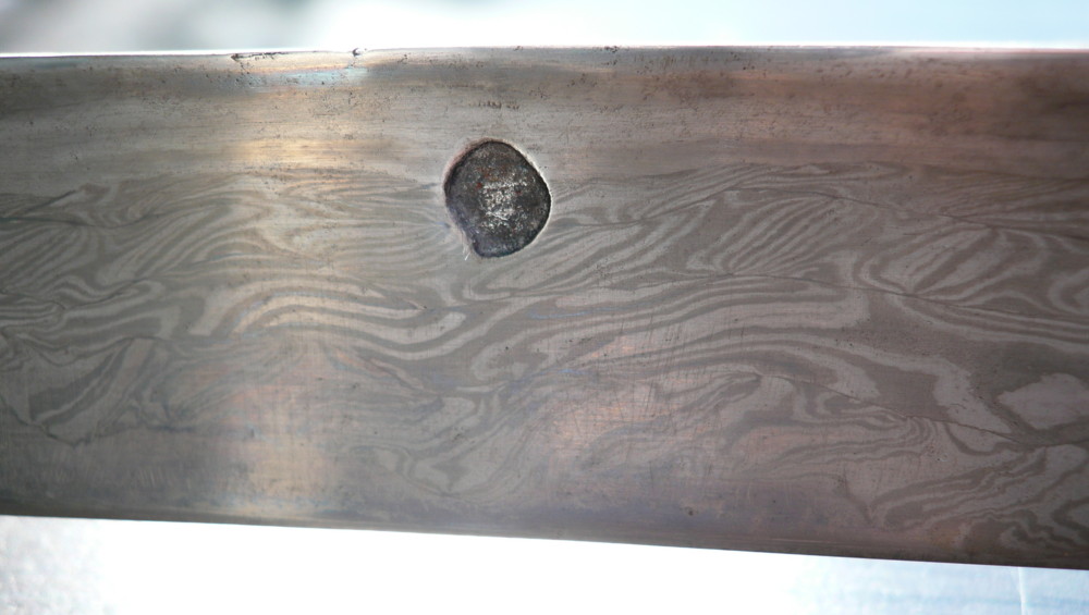

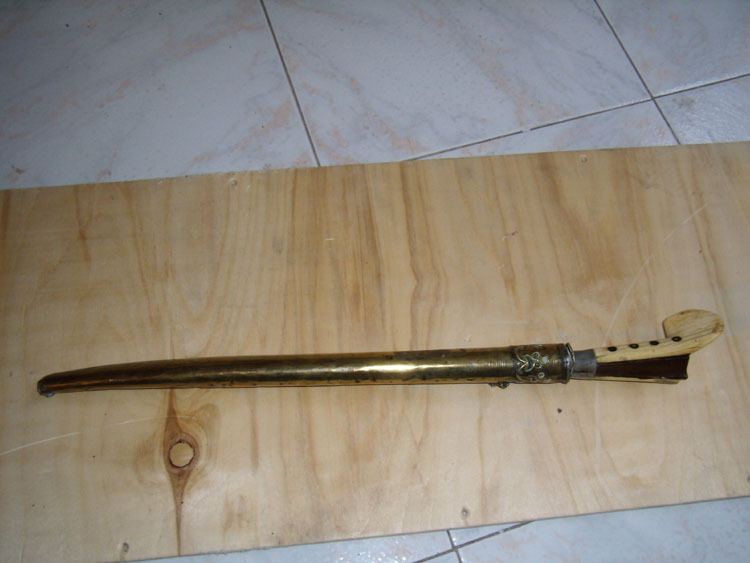

Hi Aristeidi,
I believe this kind of "kopis like" blades are earlier than 19th century, i would say that i have seen some examples that are from the mid 18th century.

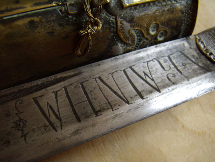

The type of hilt reminds me some balkan yataghans, for example resemples the one bellow that has a latin inscription on the blade witch propably associates with the place of origin. I posted in the past this dagger but we didnt find any clues.
Old 25th July 2010, 11:56 PM   #10
eftihis
eftihis's Avatar
Location: Chania Crete Greece
Posts: 517
Default Regarding the blade

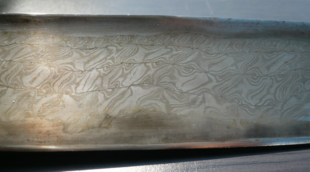

Regarding this blade's shape, i want to show an example, which i date arrount the mid 18th century.
I think it deserves a thread of their own, buy anyway, its blade resempleas a lot the one of yours and actuall the second has the same damascus steel sandwitch technique.
The grip though are of "karabela" type.
Therefore my opinion for your's is an 18th c blade with a hilt from the balkans and with a latter replacement scabbard
Old 26th July 2010, 12:06 AM   #11
Dmitry
Dmitry's Avatar
Join Date: Jul 2009
Posts: 612
Eftihis, the writing on your blade reads RAINHA, which means a QUEEN in Portuguese. By the look of it, the blade appears to be a cut-down European sword blade. Judging by the montmorency shape of the blade, this would date it to ca.1770s-early decades of the 1800s. Just my $.02.

But there is also an "A" and a dot, just before the "Rainha".
can it be the initial of the first name and "Rainha" the surname? ( I do not think it belonged in the Queen herself!!!)

We don't know what was written before RAINHA, it probably was the full name of the Queen. If this was my sword, I would do an easy search on the Portuguese royalty, to see whether there was a period in the 1700s-early 1800s when a Queen alone ruled Portugal, sans the King.

My pesos would be on the first Maria since blade might be inscribed [MARI]A*RAINHA, and not MARIA II*RAINHA.

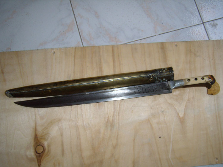

Hi Eftihis,
Can you tell the thread in which you posted the sword you show in post #9
... or post here a picture of the other side of the blade ?
The inscription is indeed Portuguese and within the traditional legend VIVA A RAINHA DE PORTUGAL, referring to Queen DONA MARIA I (1777-1799).
Sometimes you find half of the phrase in each side of the blade but, in this case, you might have DE PORTUGAL on the other side.
