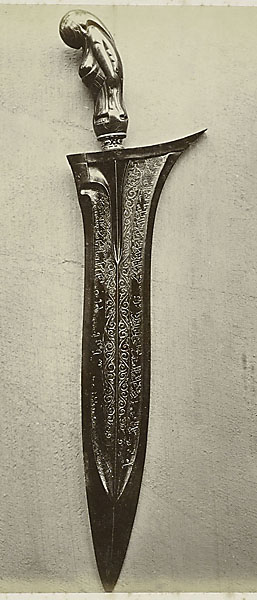

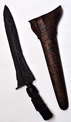

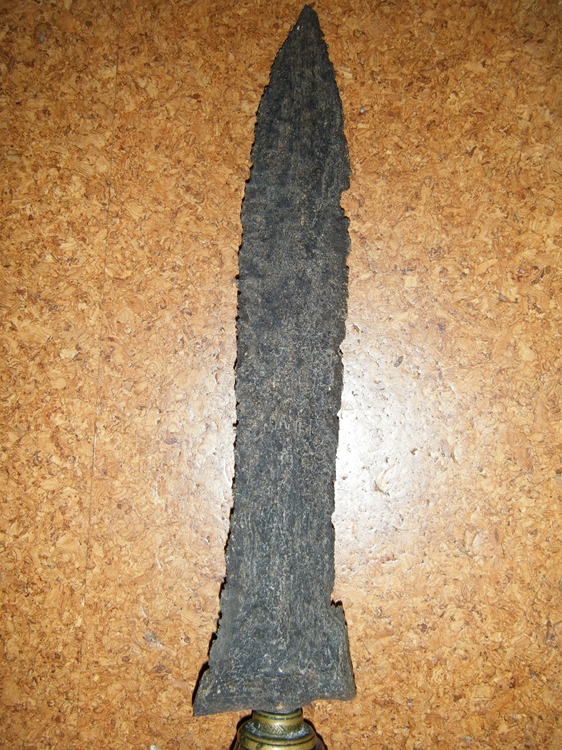

Dear friends,
In the very interesting book "Keris untuk Dunia" published on the occasion of the "Keris for the World 2010" exhibition in Jakarta, there are a number of pictures of krisses Jalak Buda. They are all are classified from tangguh Singasari and most of them are called Keris Jalak Sangu Tumpeng. Some of them look very old but others have visible pamor so they don't seem to date from the same period. What do you think about the assigned tangguh and the correct name of these krisses? Sorry, I can't copy any pictures from the book because of the copyright, but I attach the pictures of the 2 Krisses Jalak Buda from my collection for your reference. Best regards Jean |

Dear Jean,
I first thought that I cannot contribute to your thread, but now I notice one detail with the first keris you post that makes me wonder: Do I see a turned over mendak or is it a metuk, permanently fixed to the pesi (as seen on tombak)? Best regards, Heinz |

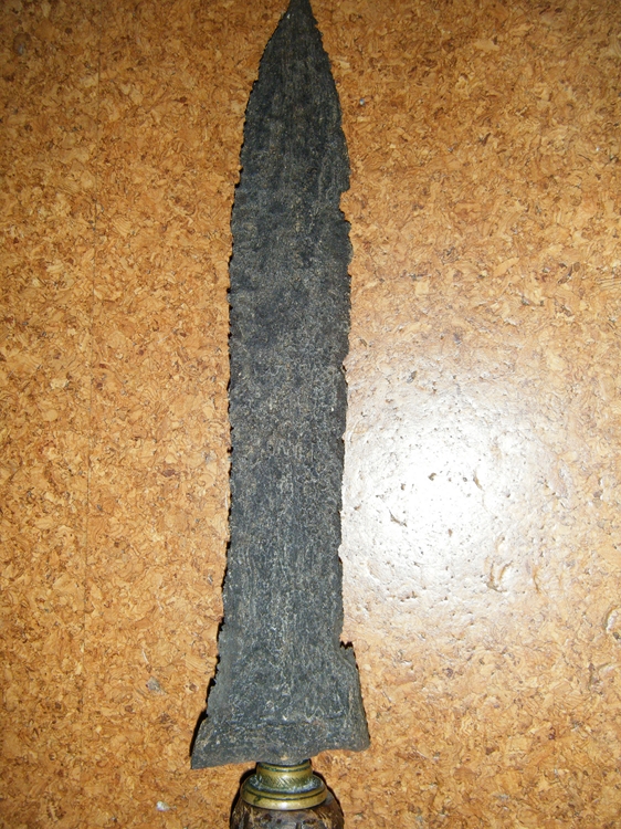

Dear friends,
My question seems to raise some interest from the number of viewers but no response so I will try to stimulate you a bit: AFAIK these krisses Budha are supposed to be the oldest type of kris and some sources say that they may have originated in Central Java around the 9th or 10th century AD. So why are they classified from a 13th century short-lived period in East Java? If they originated in East Java and not Centre Java, why during the Singosari period and not the earlier kingdoms of Kahuripan (11th century), or Kediri and Jenggala (11th and 12th century)? According to the legend of Ken Arok and Empu Gandring, the krisses made during the Singosari period were much more elaborate than the krisses Budha? Also the features of the blades from tangguh Singosari described in the EK for instance do not match at all with the krisses Budha? Pak Ganja, your kris shown in page174 of the book is the only one of this kind called keris Budho but the tangguh is specified as Budho - Singosari, what does it mean? Regarding the book "Keris untuk Dunia", it was for sale on Ebay by Bakoelkeris (Suryono) few days ago but no longer, you may contact him to investigate if he still has or cand get some copies. Best regards Jean |
#6 | |
Join Date: Jun 2009
Posts: 1,740
![]() Quote:
Dear Heinz, Both krisses are fitted with an integrated methuk (as it should be). The top one has some rust embedded in it but of course I did not do anything to it except applying anti-rust oil for future conservation. Best regards Jean |

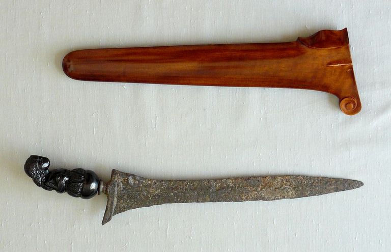

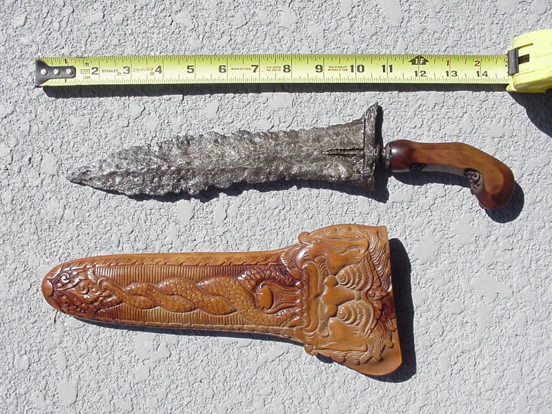

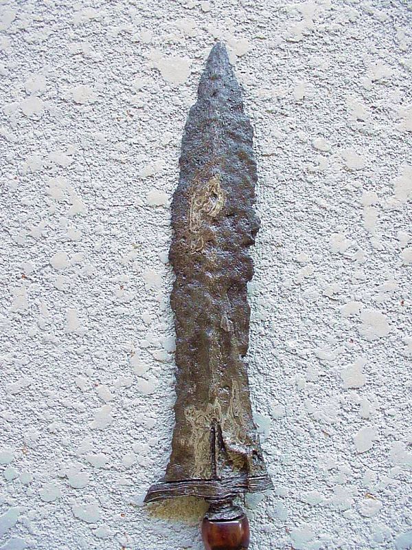

Jean
Here is basicly what they look like. There has been a market for reproductions of this pieces for a long time. Based on the sheath that was provided for this piece I imagine that this was assembled in the 1930's. Normally there was no pamor on the real pieces. This is a giveaway on this one. |

![]() Quote:
Thanks, your piece is shorter and sturdier than mine, but it looks "processed" indeed. Some of the pieces included in the book "Keris untuk Dunia" also have pamor, but are still classified as from tangguh Singosari.... Best regards Jean |

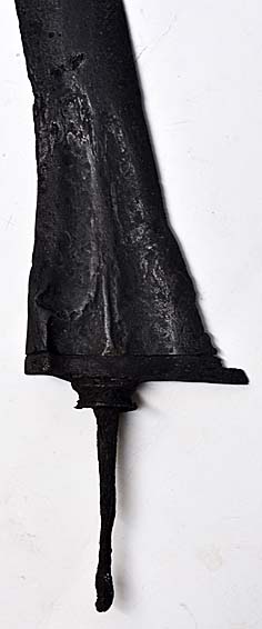

Posts: 7,014

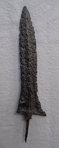

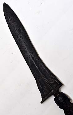

Here is an image of a genuine keris budho.
Mick's image also gives a good impression of what they look like. This example is just under 12" long from blade tip to pesi tip. However, it is necessary to allow a reasonable degree of latitude in assessing whether a blade is genuinely a KB or not. Erosion can alter the outline of the blade. Some blades display quite refined features, others are basic. Based upon my personal observations, I am not yet prepared to dismiss all apparently archaic blades that show some evidence of pamor, as forgeries, false, or creations designed to decieve. Yes, such creations do exist, but the pamor effect can be found in other forms of archaic blade that are not keris blades. Additionally, I am of the opinion that production of blades in the budho form continued well past the Early Classical Period, and probably they were still being produced into the 16th-17th centuries, a period far too early for production to occur for reason of the deception of "tourists" and collectors. Genuinely archaic keris budho also occur in bronze. |

![]() Quote:
Thank you for the picture of the genuine KB, a precious reference for us! Any personal opinion about when and where these krisses were first produced? I share your opinion that these krisses may have continued to be made into the 16-17th centuries, and this could explain why some pieces have pamor or are in better condition than the original ones but without being recent fake pieces? Best regards Jean |

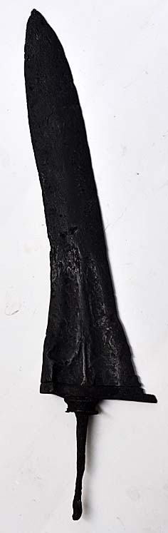

G'day Alan,
Based on my very limited contact with keris budho (which may all well be replicas), I noticed that they all have this seriously eroded look, as if they were buried underground for a long time. Are keris budhos generally excavated? None passed down as family heirlooms? |
#18 |
Posts: 7,014
Yes, this is my understanding, Kai Wee.
I have been present on two occasions when farmers brought badly corroded keris budho to a dealer for sale. I have also seen, handled, and bought from a trove of archaic tools and weapons (?) that had been found during farming activity. Many of the pieces I bought from this trove were far too damaged by corrosion to be of any possible use, so they were welded and forged into a single piece that will be made into a keris budho. In my experience, archaic and talismanic keris can be passed on as an inheritance (warisan), but not as a family keris (pusaka). In Bahasa Indonesia "pusaka" can be understood as "heirloom" , but in Javanese the meaning goes much further than this, and depending upon the context it can be understood as "revered object", "inheritance", "ricefield", and it has powers atached to it that make it a symbol of authority and validation, for example, in Javanese history a number of instances can be found where possession of the royal pusakas was interpreted as God's endorsement of the holder of those pusakas as the rightful heir to the throne :- if God did not agree with him being in possession, God would not permit him to retain the pusakas. The keris budho form originates too far back in time to be relevant within the context of family pusaka. |

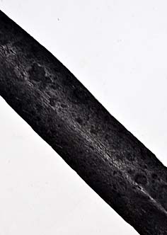

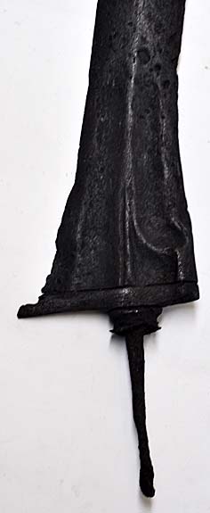

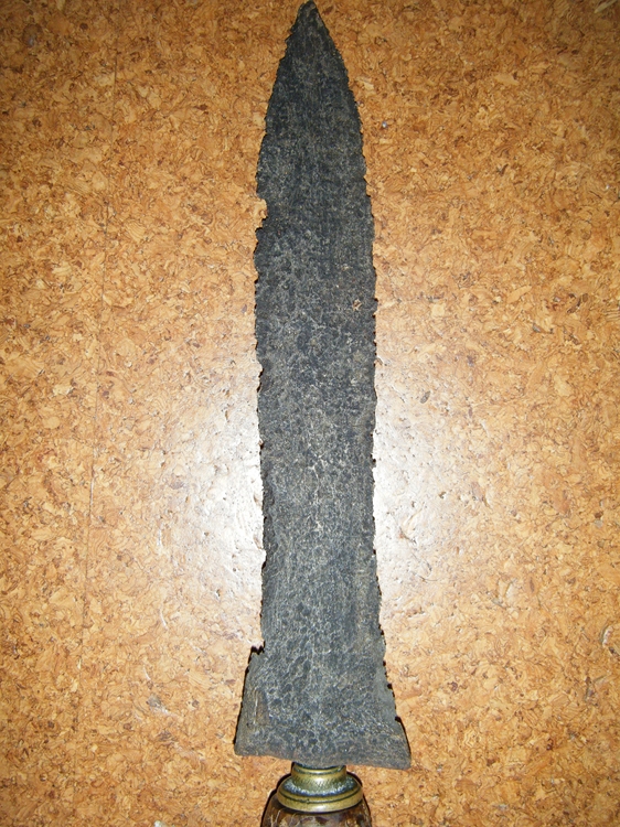

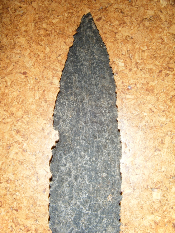

The classification 'Singasari" is not from me, but from book curator's opinion. And these images below, are from the same jalak buda blade as published in the KFTW book. I have seen quite a lot of "buda" tipe of jalak dhapur. But the condition of this blade is not as corrosive as usually I've seen.. GANJAWULUNG |

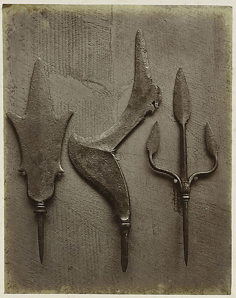

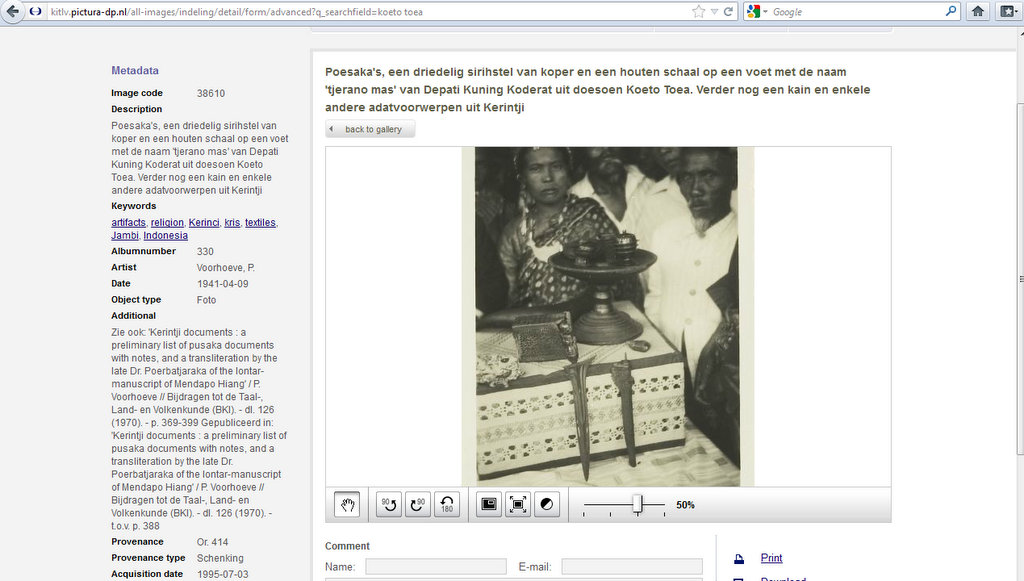

![]() Quote:

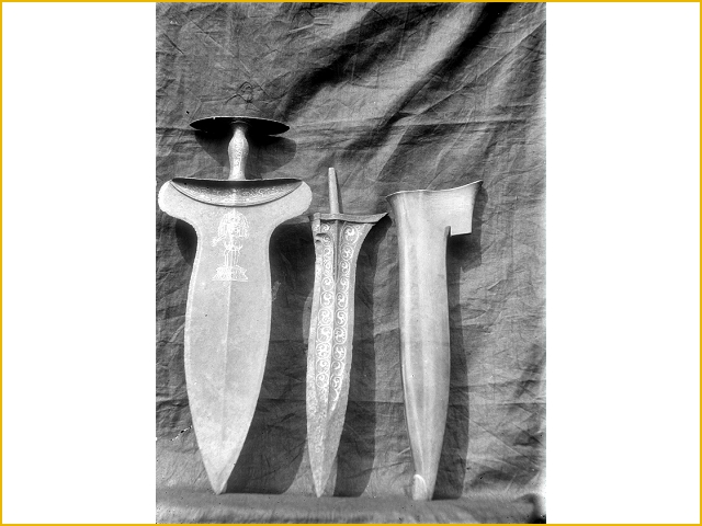

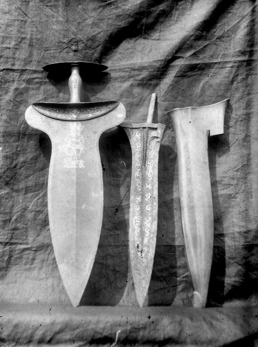

High resolution pictures are to be find here: http://www.geheugenvannederland.nl/?...:1403-3790-37B http://www.geheugenvannederland.nl/?...unt=1&wst=kris http://www.geheugenvannederland.nl/?...wst=lanspunten You really can go into the details blowing them up. |

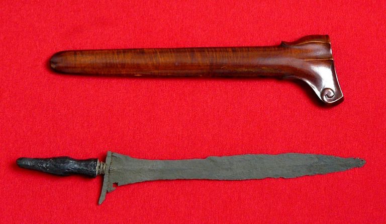

What do you think about this one?
#25 |
Join Date: Jun 2009

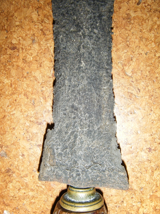

Posts: 1,280
Tunggulametung, thank you very much for the interesting picture. I have darkened it a little bit to see better the details. It comes from Pagerrujung, half way between Semarang and Pekalongan, Central Java.

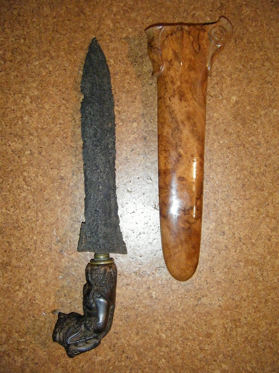

I attach another similar example below |

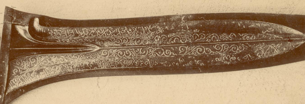

![]() Quote:
![]() Gustav, just a passing comment: I seem to immediately recognise the first picture as part of my family's heirloom collection,which are still looked after in our Ciburuy, Garut compound. As for the keris, it very much reminds me of another heirloom looked after at our Cinunuk, Garut compund. If the inscription in Arabic reads (Latinized): "Laa Iqroha Fiddien", then I am sure of it. Best, Last edited by Amuk Murugul; 23rd June 2012 at 05:07 AM. |

Hi Amuk,

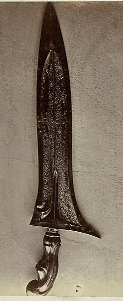

Here's the close-up of that particular blade. I'm not sure if it says La Iqraha Fiddin on the blade.. |

![]() Quote:
http://collectie.tropenmuseum.nl/Def...px?ccid=322401 There is also a picture of the other side of the blade: |
