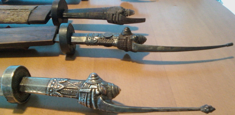

sapot taribong : this is the top of the line for the taribong. The best ones are made by a subgroup called the Aklan Bukidnon. Sapot means "covered all over" and it usually kamagong (makasar ebony) wood covered in silver. It is a dress sword to show wealth and worn to events and ceremonies like fiestas, feasts, cock fights, etc. It is the most valuable and expensive of the 3 types. A complete one has 3 small "balls" or "beads" that are called moro-monggo which look like monggo beans (over time many of these have been broken off and lost). Eyes, "ears" and a "hat" on top are made of silver coins, usually Spanish or American, and sometimes even Mexican.
tinitilaan taribong : this is second in value. It is like the sapot in form but is made of carved wood and bottom half is covered in silver sheet, sometimes the eyes and the nose. Sometimes these also have moro-monggo "balls" on the tip of the nose if the nose is silvered.

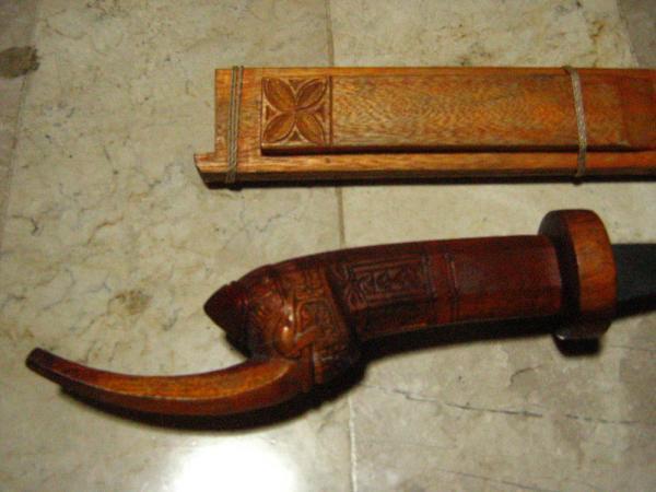

wala-pilak : this is third in line. It is made of carved wood and no silver is used. This type is the least in value of the 3.

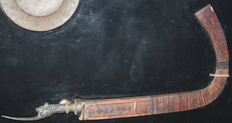

Below are some examples of these types from the Iloilo Museum:
1. sapot taribong
2. tinitilaan taribong
3. wala-pilak taribong
Note: taribong scabbards, especially sapot ones, have upturned ends. The straight and blunt ended scabbards tend to be lowlander made scabbards and are usually seen on tenegres.
