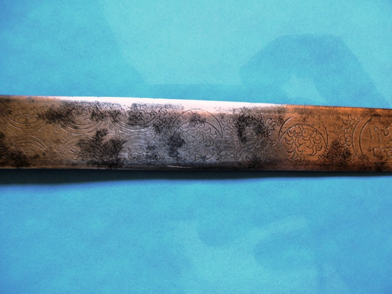

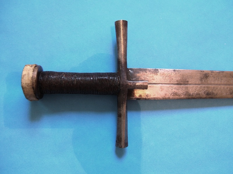

I picked this up from Gav this week. Seems to be a nice early to mid 20th century example.

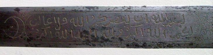

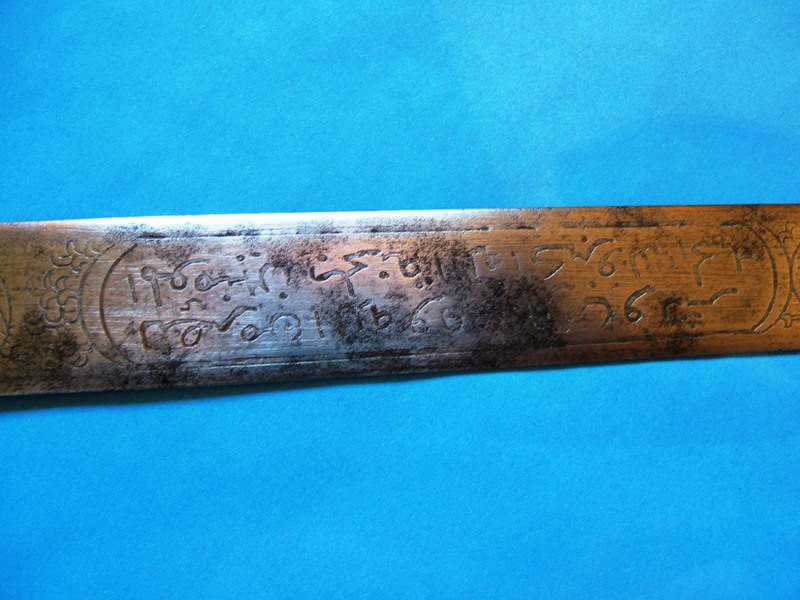

Very very nice Lew!!!! These markings on the blade are excellent, and I'd like to get some input on the crescent motif.....any takers out there!!!???
The kaskara remains an extremely traditional weapon culturally throughout the Sudan, and the modern date of many of these in no way diminishes thier intrinsic ethnographic standing.
I look forward to discussing the motif, and its great to get some focus on these kaskara going....it seems we've gotten a few threads almost off the ground with the interesting examples Stephen has posted, but they seem to have fallen short of drawing sufficient interest. Surprising considering the interesting nature of the examples.

Nice photos Lew, the extra effort you put in to cleaning and waxing it certainly shows. It has gone from a nice complete original example to a very nice example.
As Jim has noted there is a lot of Symbolism present on these swords and particuarly on this example. This one is worthy of further discussion and I am sure I have seen a similar one within these pages but I think the script in the cartouche was perhaps different...maybe a translator can help...this may offer more direction to times of manufacture.

Found some of my notes, and apparantly this motif has to do with astronomical events, which seems to correspond with other markings that are focused on a comet event, as yet more details are unclear. The use of these crescents in motif is described by Graham Reed in his article on Darfur kaskaras.
The discoid pommel on this would have been leather covered, and the 20th century period is confirmed by blades with this type motif seen by the author in travels to Darfur sometime before 1987. These blades are typically heirlooms and refurbished from generation to generation, so just how far back they go of course may vary, but certainly into the earliest years of the 20th century onward.
The inscribed panel with crescents is a representation of the wooden board carrying such religious inscriptions that is termed a 'lohr'. Charles S. has posted one of these which also has a snake (assala=python) inscribed along with the lohr (November, 2008). I believe the inscription on that blade included the date 1796 (AH?) .

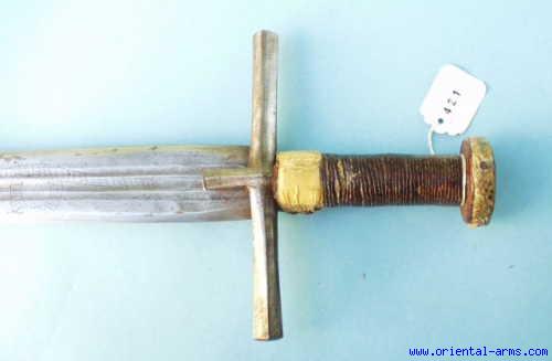

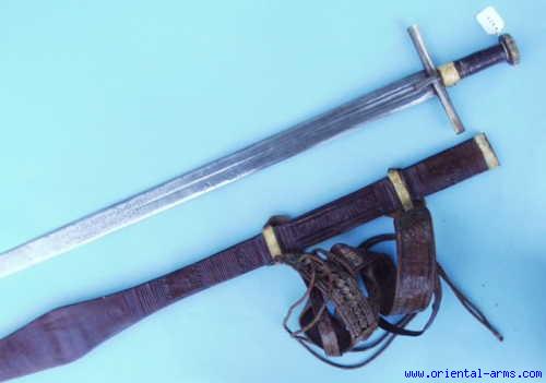

...a very nice one, thanks for posting it.
Here are some similar ones - notice the particular shape and finish of the scabbard - quite angular.
