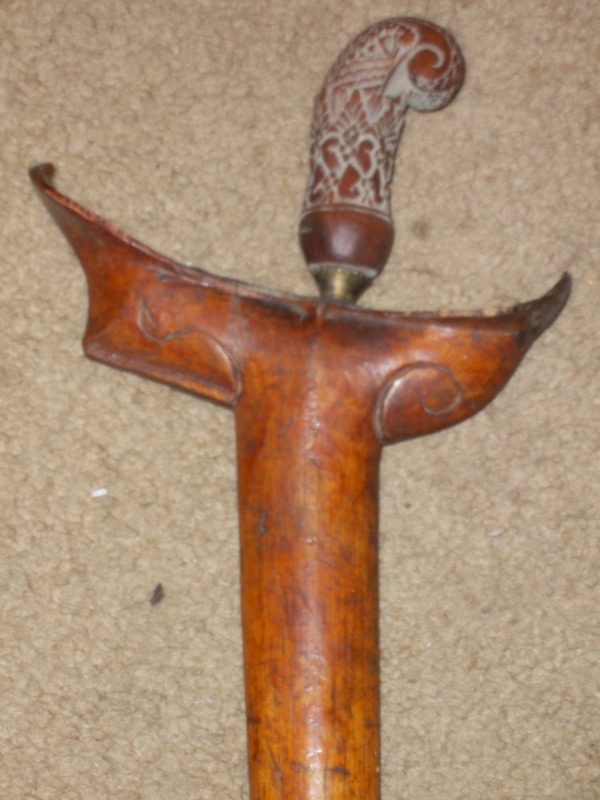

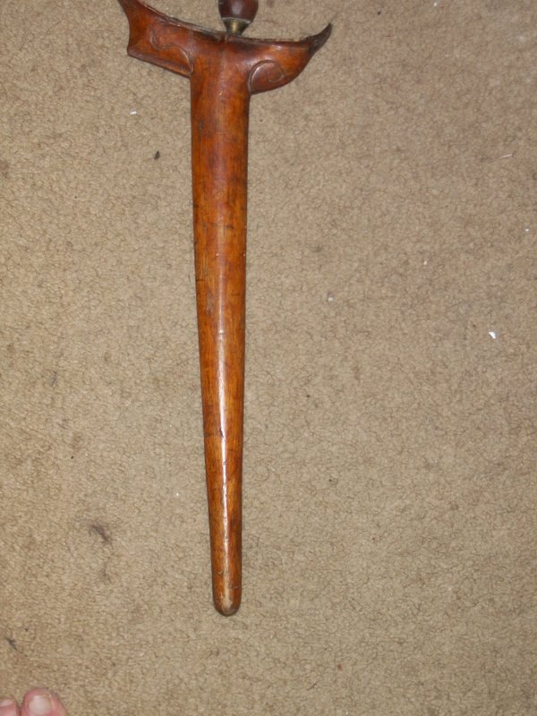

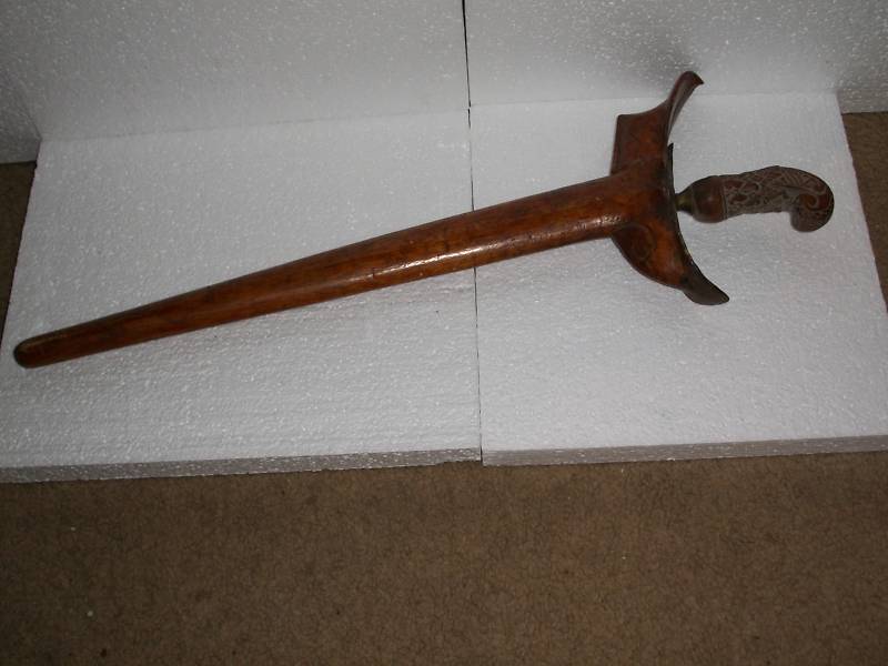

Can someone tell me from where this sheat originate? Sorry for the poor quality, the pictures are from the seller. And the toe is also not from me!

Sajen, could you flip the first picture so the scabbard faces the other way ?
Old 14th May 2010, 02:33 AM   #3
Originally Posted by Rick
It is too your toe !
Here the mirrored picture.

I wonder if this is not a composite keris ; I'm betting most likely it is .
The Madura jejeran; the handle does not line up with the 'thorn' on the wrongko .
I cannot place the scabbard .
A picture of the keris; perhaps ?

Yes, of course a composite keris and I am also sure that the blade not original to the sheat since the middle of the jejeran not line up with the "Ri cangkring" of the wrongko.
I've bought it because the sheat. Is it maybe a coteng form? This is my hope!
The blade is a very poor one, this suggest the picture and seems to be from Java or Madura.

Not all keris have always been dressed according to the high standards of late 19th century, through to 21st century connoisseurs.
I have seen a great many keris from various areas that do not follow what current collectors consider to be correct, in that blades are a poor fit in wrongkos, alignment of hilt to wrongko is poor, and in general, the keris have simply been not very neat. However, these keris I have in mind have not been what we think of when we talk of composites, rather, they have been keris that were collected in SE Asia pre-WWII and in some cases, have been genuine old keris held by families in Jawa.
In times past - and for that matter, today also, not every blade is going to have its own individually bespoke wrongko crafted for it. If a near enough fit can be achieved by use of a used wrongko, that is often good enough. Not all people in Jawa now, or in the past, could afford to pay a maker to produce the perfect wrongko for a keris, they would use wrongkos in various stages of completion bought ready made from the market, and finish the fitting themselves.
We're used to see perfection as the benchmark, but in reality, this is a pretty recent phenomenon. People in the past living in rural villages far removed from centers of power did the best they could with what they could get, and this was often very far from perfect.
We should not label a keris as "composite", just because it falls short of perfection in fit and finish.
In respect of this wrongko, I'm inclined to think it might be an old North Coast Jawa one. I have a similar one that has a probably reliable provenance of 19th century Cirebon area.

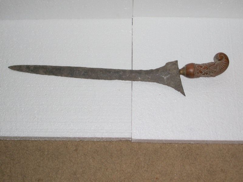

I am curios how this keris fits the sheath and to see the blade itself. It could be probably not that poor at all when cleaned.

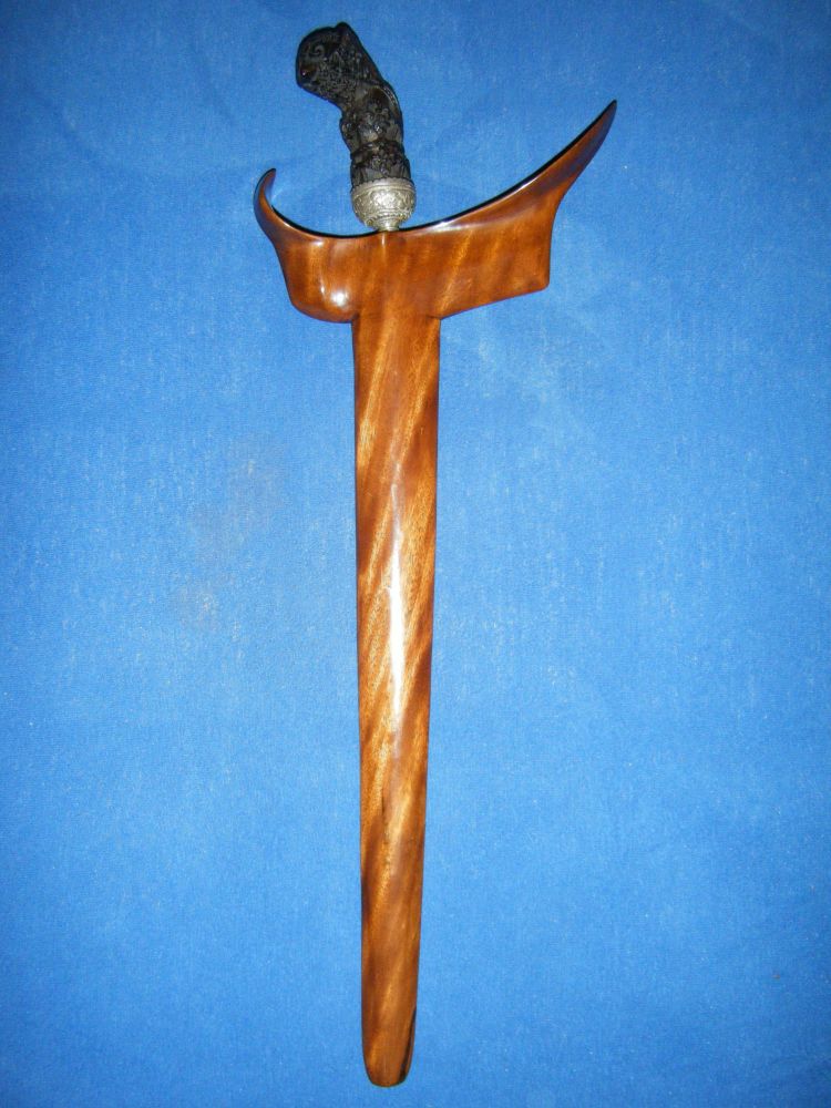

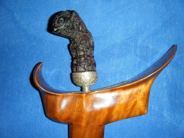

Thank you for comment! Agree that you can find iras sheats from Cirebon (see picture). And agree also that it is sometimes very hard to decree the origin of a sheat because the "cross-pollination" in the archipelago special by early forms.

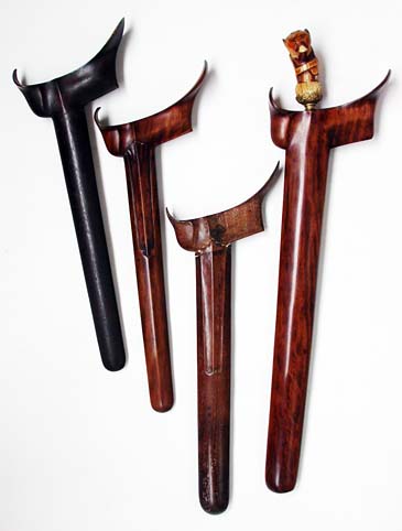

Have you noted the middle rib in up from the sheat in the third picture in #1?
Maybe this will be helpful.

That middle rib you called, is the "caping" or point, as explained in Spirit of Wood. And you also can see how identical this "caping" as to the coteng's.
It also appears in some aged keris tajong sheath.
The build shape is identical to the cirebonese sample that Sajen had shown, no doubt about it. However the "caping", "shoulder" and the "third eye of Shiva" is all the characteristic of a pattani's origin.
Cross pollination is obviously the reason why it is so identical to both region's design. Let's not forget the empus from pattani also originated from Java / south sumatra.

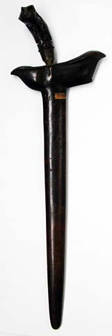

Sampir comparison.

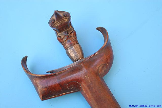

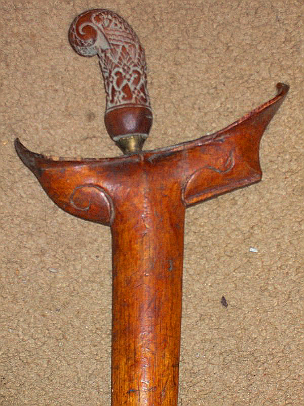

Also I attach this picture taken from Artzi's sold item page, a coteng, which bear some similarities to Sajen's new sheath. Not 100% identical, right? I would say that the overall shape of Sajen's new sheath looks like it have Cirebonese influences while the features are of Coteng's.
I would also love to learn more about Cirebonese sheath, as much as I would love to own one!

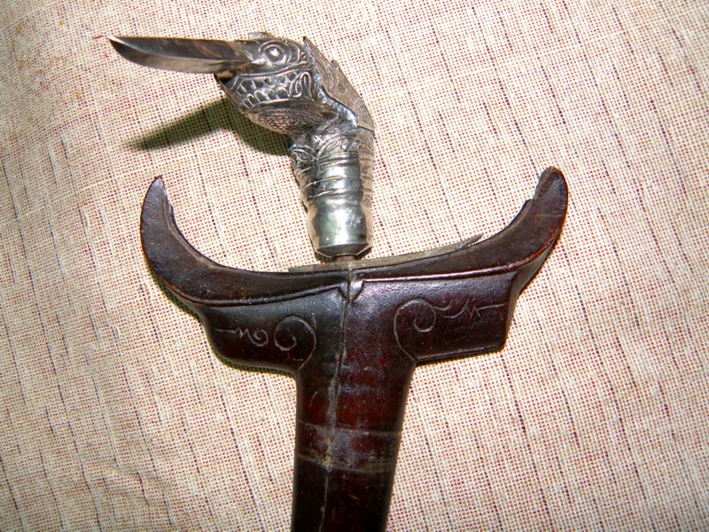

Do you call "cheek line" feature visible also here? : http://keris.fotopic.net/p56874076.html

Yes it was in that picture.
Sorry "cheek line" is not a proper term for it. I dunno what u called it, but what i meant is the line from upper crosspiece to lower, where the line is in between a "/" and a "k" in the watermark "http://keris.fotopic.net"

What I meant is that this feature appears on cirebonese wronko, even it is on the cirebonese sample pix that Sajen had posted.
But both the coteng keris pix samples that I have uploaded, plus Sajen's new sheath, do not possess this feature.
