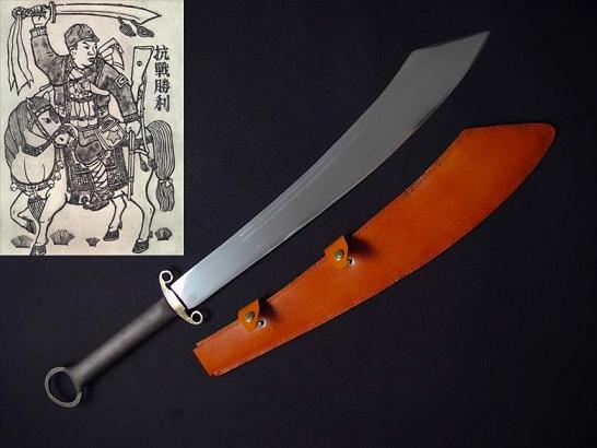

I am curious about others thoughts on the use/function/reason for the ring on the end of some antique Chinese swords. Was it just a convenient pommel to create during the forging process, or were there specific functions it provided in use or symbolism etc. I realize examples of this can be seen very far back in Chinese history all the way up to WWII soldiers swords. Feel free to comment about any that you may have thoughts on. Thank you for your insights.

Also, as we can see in Neil's picture, the Chinese do love to have tassels and trailing silks/ribbons on weapons. The big ring means that you would have much more 'scope' for this, as you could literally improvise by tying scarves or just strips of fabric. No need for anything specialist. Not that I'm an officianado of Chinese warfare or anything, but didn't separate groups/factions/regiments have colours that identified them? Would this also have a purpose for the trailing silk ribbons?
Or distraction etc?

Ribbon's/ a scarf tied to the pommel I think are decorative as used in Wushu...as in the picture Niel posted....you could use the ribbon/cord perhaps to lash the weapon to your hand so it knocked out of your hand you could easily retrieve it. I remember one old drawing in Alex Huang's book Iron & Steel: Swords of China there is a demon depicted with a sword with ring pommel that is chained to his wrist (Page 80) Ring Pommels are seen in Tang Dynasty swords.

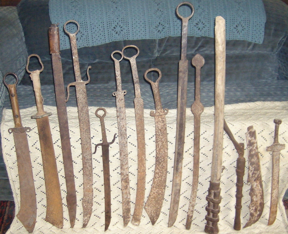

Picture of some more ring pommels

A few ring pommel swords from my collection. The one on the far left is inscribed in Chinese "FEB 1943 Made". The tallest one in the image towards the right has been ID as being 2nd to 5th century AD by a very knowledgeable collector.
Jerry

Thanks for sharing the picture. There are definitely some interesting pieces. I am curious about others thoughts on the dates of the swords 4 through 8 from the left. This is relative to my previous question of who would use these swords. Would they be classified as civilian, village militia, military, or rebellion arms. Maybe they could be any of the above. As far as I can tell there is very little scholarship available in English on this subject. So for now the collective knowledge of this type of group on the forum seems very important.
