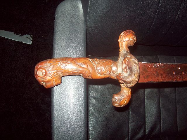

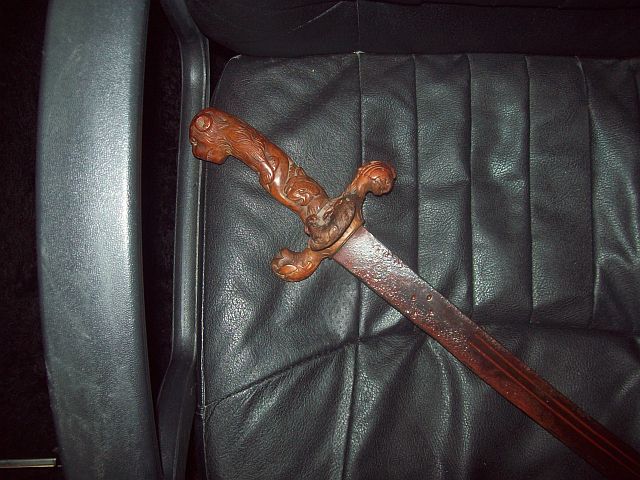

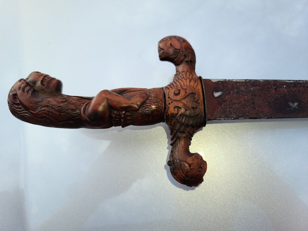

Yes, I've resurrected this old sword again. Years ago, I posted some poor pics of it, but now that we have the European forum, I'm hoping perhaps to get some more info on it. Some background research-
This sword has an exact representation of it that appears in 'Swords and Hilt Weapons' B&N Books, pg 68 and also in Leslie Southwick's 'Price Guide to Antique Edged Weapons', pg 155. That example a fine museum-quality item with better detail and carved ivory hilt. That being said, I still believe that this hanger came from the same source...Singhalese, ca 1660-1700, Second Anglo-Dutch War period, probably made for the Dutch market. The book example believed to have been made for the Dutch EIC. As you can see from my example, the hilt is a seated lion with claw uplifted, guard is a hunting dog curled up, quillons are monster heads like appear on kastane. The wood appears tropical. The broad old blade with shallow double fullers and ancient brownish primer (to retard salt water rust? As found on some naval pieces?). Note the 4-dot (or is it diamond? Egg-shape?) forge mark. Also please note the wing(?) carved shapes facing each other on the hilt.
Does anyone recognise this stamp? Does anyone know what the wing carving might represent? Is there a Shri Lanken or Dutch symbol of a sitting lion I am unaware of? Perhaps a Dutch standard, flag or symbol? How about the wing pattern associated with the Dutch? EIC? Has anyone else seen a hanger like this one? Any association with the East India Company?

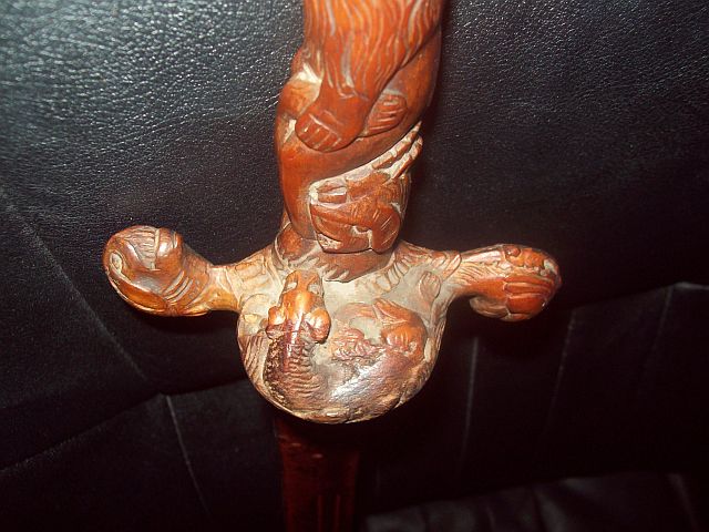

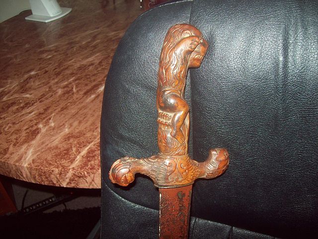

Default More pictures...

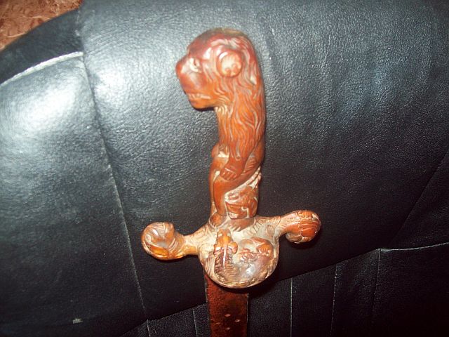

More pics...

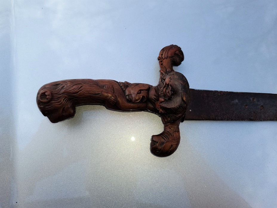

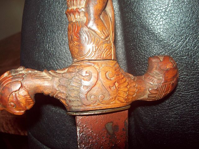

And still more with details...
Note that in my searches, I came across an ancient Singhalese coin called a maneless lion coin. On it's back is a similar 4 point pattern in a cross pattern(or am I just imagining things?).
http://coins.lakdiva.org/ancient/maneless_lion.html
This coin goes back way too early for the time period of this sword, but perhaps the marking remained? Likewise, I couldn't find any evidence of one, but I've heard there is a Dutch coin called a dump that might have a similar marking dating to the 17th-18th century. Does anyone know of this coin?

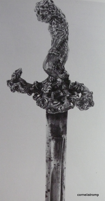

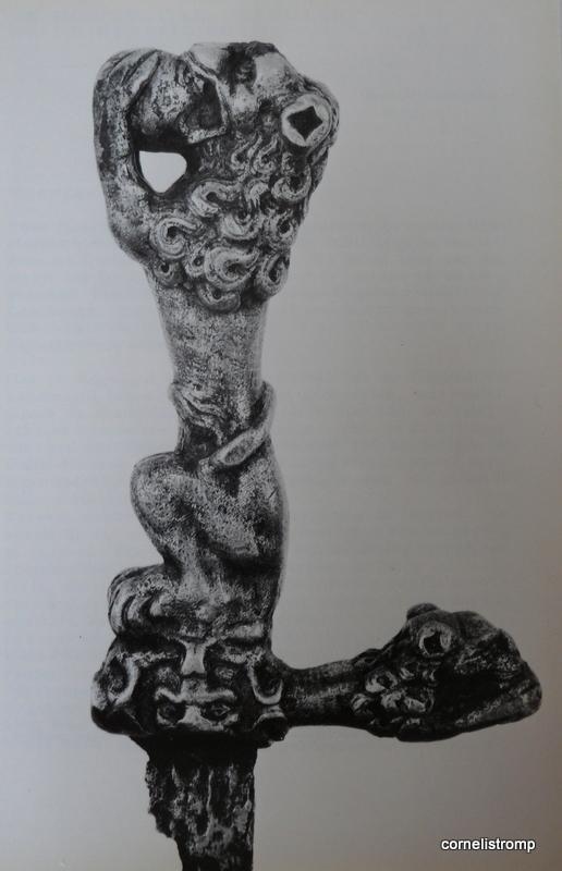

there was a development in Holland of a very interesting type of cross hilts in the middle of the 17thC the so called "leeuwengevesten"or lionhilt.
on those Hilts the Lion takes most of the space of the hilt.
such a hilt can be seen on the town guard of Hoorn painting of Jan Albertsz. Rotius made in 1655.
In the same time Golden Lion hilts were given to fleet owners for their duties by the VOC of Amsterdam. unfortunately we only know them now from paintings and no existing sample is known.
later the German sculper Goottfried Leygebe made also a lionhilt however the development on Holland was before his work.
now the sword of mark is a wooden? carving probably Dutch and made in one of its colonies or on the way to one of them.
the original of this wooden hilt, where a lion is attacked by four dogs is the same as on the painting of Rotius, in casted silver is laying in the tower of London.IX-849.
Mark, your sword is an interesting piece of Dutch history, I would love to have one like this.

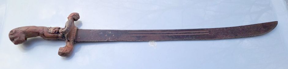

Mark - could you post a photograph of the entire sword? I am curious to know what the curvature and the point look like. Also what is the arm wrapped round the lion's waist? I am not getting a full picture of what is on the hilt and the guard.

I'll have to take a shot of the whole blade as soon as I get a chance. The blade is just like a falchion's, swelling toward the point and then coming to the typical edge. I still feel Cornelis has nailed this one on the head, being of Singhalese origin where it possesses just enough of the kastane's features to show its origins while pointing to a weapon for export to the Dutch market. The sword mentioned in the previous volumes is a hanger with fine ivory hilt in this exact pattern, only much more detailed. It was listed as Singhalese and made probably for the Dutch EIC, although the pic doesn't show any marking to stake this theory of company use down concretely.

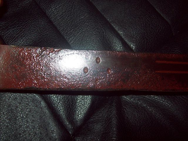

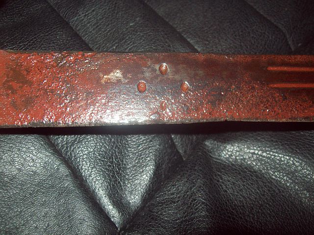

Dredging up this one again concerning the primer on the blade. Opinions as to whether you think this was applied to the blade during time of use to retard rusting (especially if it was a merchant/sea sword where priming the hilts/blades not uncommon) or done later as preservative.
Secondly, if done later, should I attempt to remove it and if so, how?

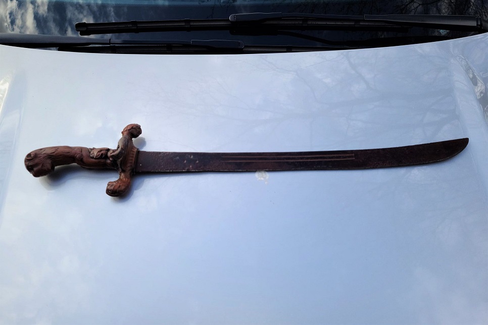

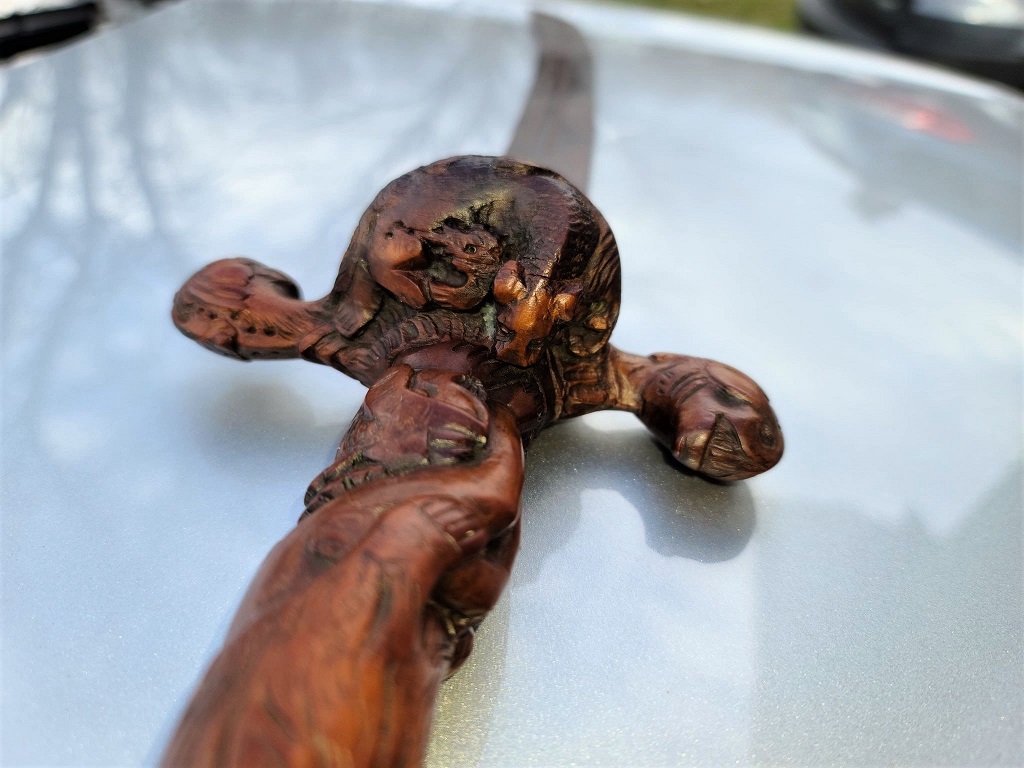

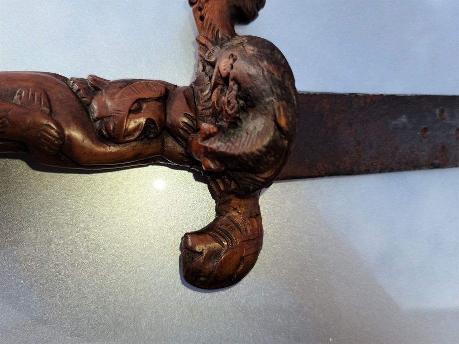

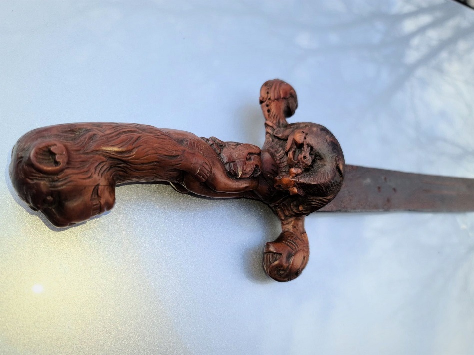

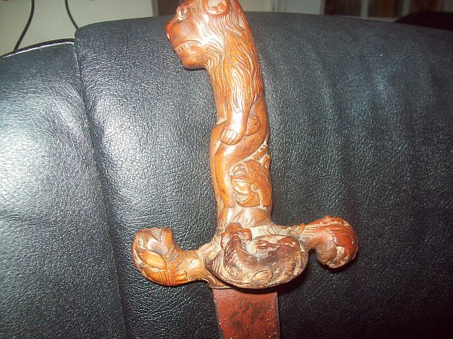

Default Added pics
Just some better pics updated for posterity-
Old 28th January 2021, 09:09 AM   #19
Interim tweaked for clarity on the blade details: should clean up well when you stabilize the rust.
Old 28th January 2021, 09:50 AM   #20
M ELEY
Location: NC, U.S.A.
Posts: 2,229
Thanks for the clarified image, Wayne. Unfortunately, the blade was 'primed' long ago with rust-colored brown paint. I have always been too afraid to try and remove it. I think it was done long ago during the hanger's working life like some other sea swords I've come across to decrease salt water corrosion-
Old 28th January 2021, 11:12 AM   #21
Many old primers were based on red lead, be careful. back when I was at sea, we almost bathed in it, and asbestos too.

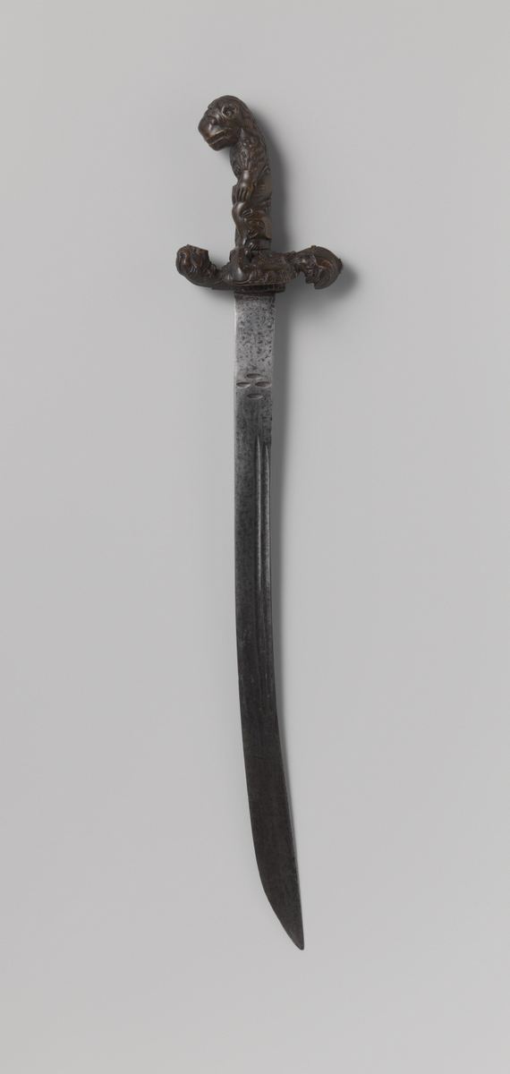

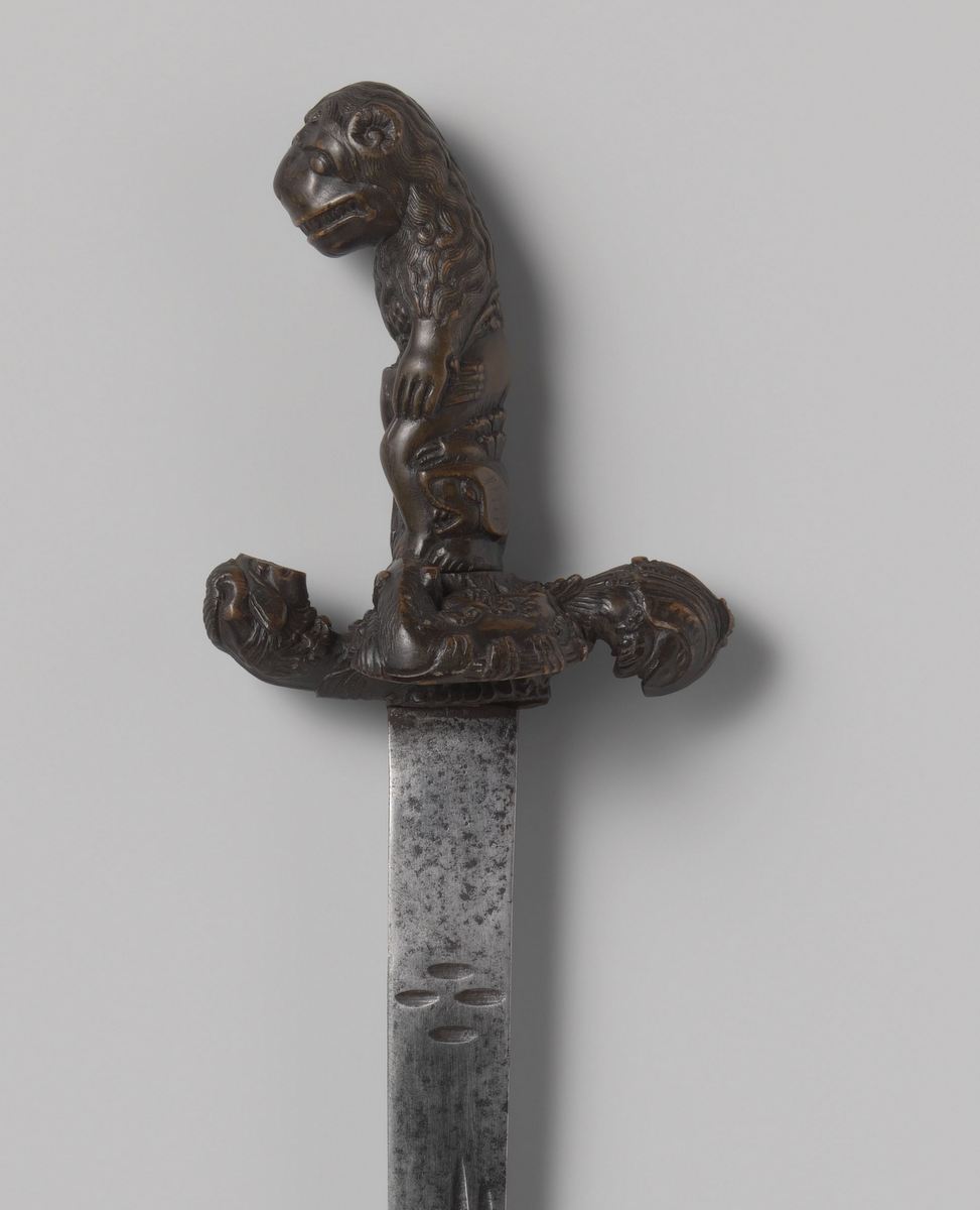

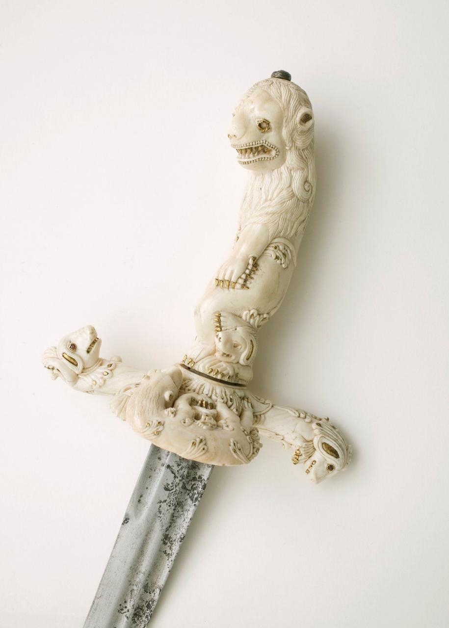

it took a while, but finally found it in the Rijksmuseum in Holland
this has been incorrectly dated by the Rijksmuseum between 1500 and 1625, I am almost certain that the date must be around 1650 and that a silver cast example as depicted in the Rotius paintings served as an example.
best, Jasper
Old 13th May 2023, 02:41 AM   #23
M ELEY
Posts: 2,229
Cool
Wow, Jasper! That's an awesome cousin to mine (better quality than mine, too!). Interestingly, it has the same cruciform stamped pattern on the blade as mine. I found this marking on ancient Ceylon coins from the 400-500 AD period, which I know seems to have no connection until you remember these swords popped up during the Anglo Dutch Wars of the 1650-80 period directly in that region, the lion of the hilt, although Dutch resembles the 'standing lion' of Ceylon and many of these sword types made with tropical wood hilts from the region. Also, the 4-dot pattern also found on Dutch 'dump' coins of the mid-1700's. I've asked before, but can't remember if there was an opinion of if this stamping has any connection to the VOC?
There is another Forum member who has an example as nice as the Rijksmuseum piece above! I'm not sure if they want to post it here or not, though, so we'll see!

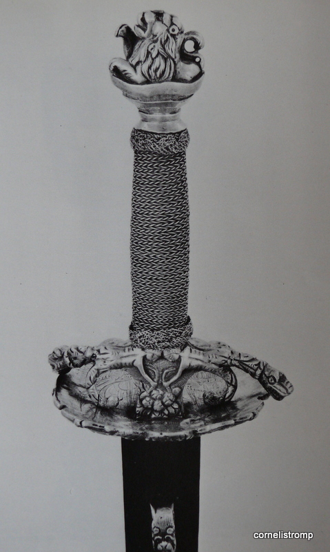

this sword was carried by William III at the Battle of the Boyne in 1690.
The silver-hilted swords likely served as models for the versions in wood and ivory; these are less detailed and, in my opinion, made in overseas colonial territories, like the example carved from wood in the Rijksmuseum.
attached pic from National museum of Ireland.
best
Jasper

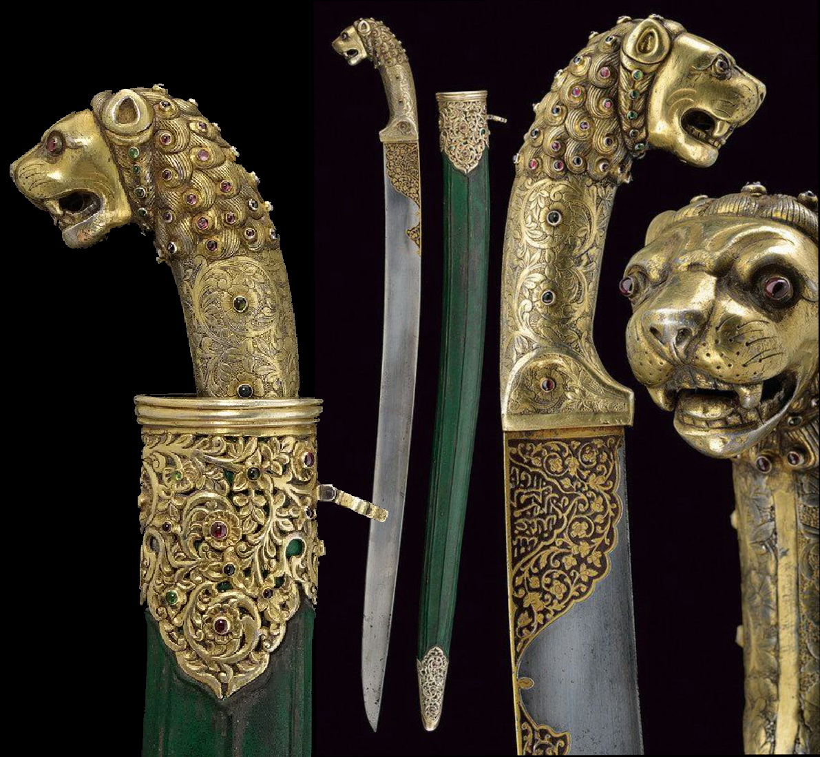

Posts: 1,028
Interesting yet different lion sword as well from Sri Lanka, English at the second half of the page:
https://www.eerstekamer.nl/overig/20...stane/document
although completely different, another lion-head grip one which only has this limited description "lion head "yatagan". Indopersia, circa 1800."
would any one on the forum know much about the latter?
