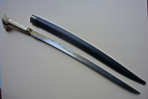

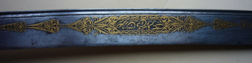

I found this Yatagan.
Can someone translate this inscription?

Default Here are the pictures.
Good morning ,l
Kurt

I'm no help with translation, but's a supremely attractive piece!
Congrats!!

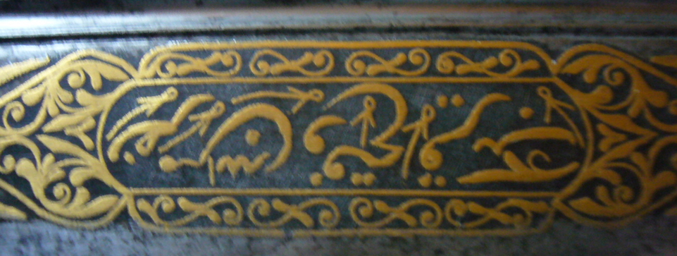

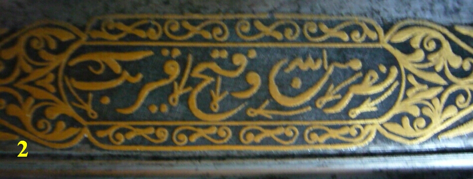

Hey toss some bigger pics out there first of all.
The top image says Help from Allah and victory near

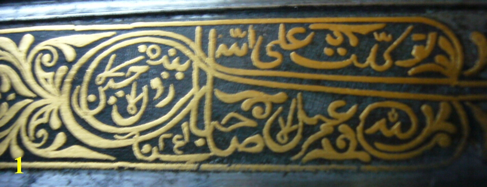

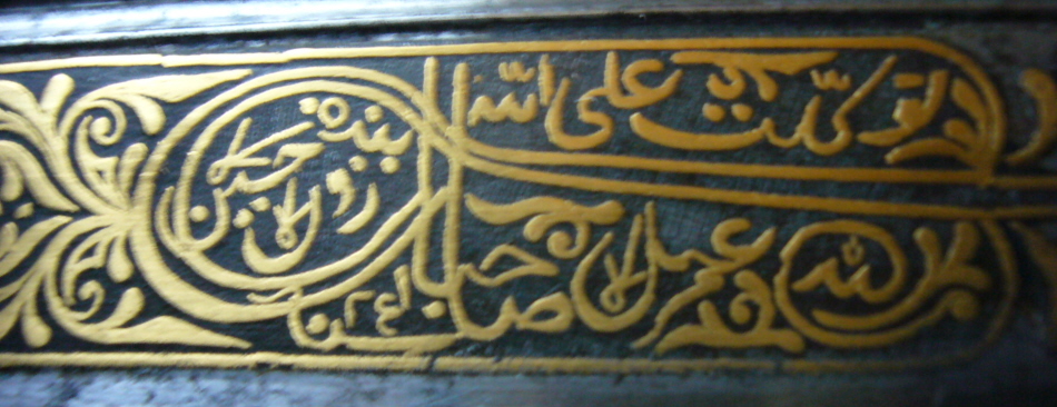

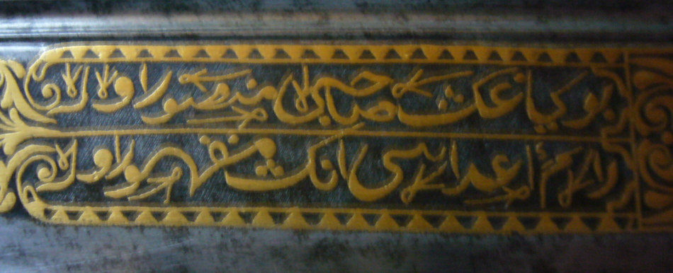

Default Better photos of the inscription.
Hi Ward ,
I hope they are good enough!
Kurt
Kurt is offline   Reply With Quote

Hi Kurt,
Here is your translation/transcription, except one word which I was not able to read.
1) Tevekkeltu ala'llah - Maşae Allah - Amel-i 'Ömer - Sahib Bende-i ....... Hüseyin Sene 1240
I put my trust on Allah - May God preserve him from evil - Made by Ömer - Owner Hüseyin, servant of ......... Year 1824-1825
2) Nasrun min Allahi ve Fethun karib - (As Ward pointed out) Help from Allah and victory is near: In fact this is a part of an ayet (Give the believers the good news of the help from Allah and the victory is near)

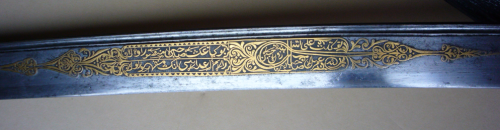

3) Bu bıçağın sahibi mansur ola - Rahm-ı 'adası onun makhur ola
Let the owner of this knife be victorious - Let the family of his enemy be in deep sorrow
There is one reservation about my transcription though. Since the calligraphy is very stylish, the date is very confusing. It stands like 2410 - first I tended to read it as 1024 (which makes it 1615-1616) but then I decided to read it as 1240 (1824-25), which is more correct I think

Good evening Zifir,
Thanks for the detailed translation.

Hi Kurt, gorgeous yataghan!
I'm sorry to high-jack the discussion, but a quick question to Zifir regarding the use of "bıçağ". The word translates as knife and I find it interesting that such relatively large weapons may still be considered knives.
In Romanian, we borrowed the word and changed it to "briceag", which usually refers to utility knife, pocket knife or folder. It's also invariably small.
Does "bıçağ" differentiate between food cutlery and weapons/tool blades or is it context sensitive, used with a qualifier?
Thanks!
Emanuel
Old 11th March 2010, 09:40 AM   #13
Zifir
Zifir's Avatar
Location: Istanbul
Posts: 228
Hi Emanuel,
"Bıçak" is a generic name used for knives and cutlery in modern Turkish. Most of the time, it is used with a qualifier, such as ekmek bıçağı (bread knife), meyve bıçağı (fruit knife). In many Ottoman Turkish texts, the term used for yatağan is "yatağan bıçağı." I am not sure about the origins, but my guess is that since yatağan was originally a secondary weapon, the term "bıçak" was used to describe it.

I think the second half of the couplet is:
daim 'adası onun makhur ola
“May his enemy always be vanquished.”
