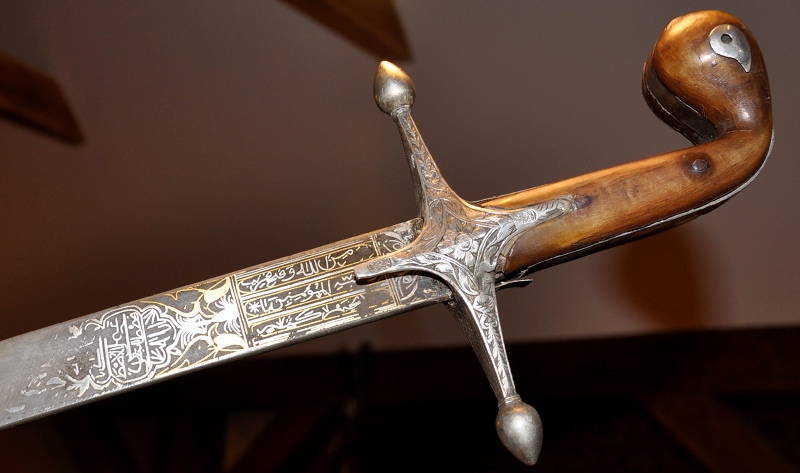

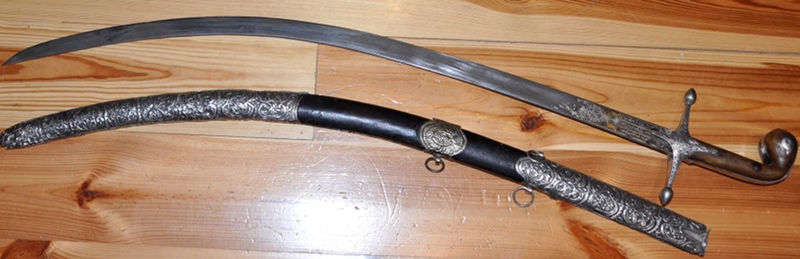

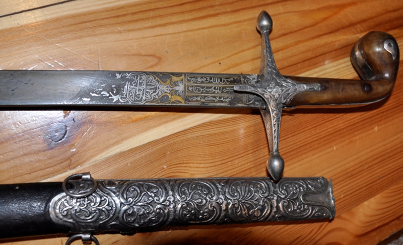

hello I have been away from forum and collecting for some time but trying to come back here is a sword which i have seen recently, any opinions? maybe somebody can translate the meaning of the inscriptions? the blade is mid/low pattern wootz, shame probably all fittings low grade silver.

Nice piece, Damian.
Is the grip made of horn?
Wonder why the experts don't have a say in the translation .

Hi Fernando Yes grip is made of horn

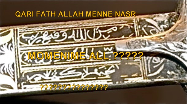

The top line in the cartouche under the guard reads, Assistance from Allah and vicrtory is near. Put some closeups, can't make anything out of the rest.

the rectangular cartouche;
1st lign;
qari Fath Allah menne Nasr either Victory from God and an Imminent Conquest
2nd lign;
momenime all ????? (under the guard) either ????? the Beleivers
3rd lign;
sorry, but didn't found the sens of the sentence, no translation
à +

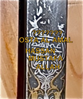

now, the explanation about the affirmation of the sword provenance; Egypt
the second cartouche is the mark of the swordsmith
1st lign;
too much damages with the inlay, no translation ... sorry
2nd lign;
Osta al Amal either made by the "Master" (Osta, is an Egyptian title, title not used by other countries)
3rd lign;
Hassan (not easy to read it ... )
4th lign;
Mustafa
5th lign;
Allah
à +
Dom

It's probably Take the glad news to the belivers.
Maybe in Egyptian they say Osta, everywhere else it's Usta for master
