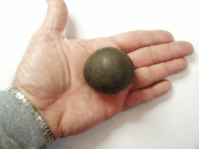

Default What do the ingots look like?
Jens
What are the ingots that you are asking about look like?
I bought one and sent it on to Dr. Ann for her to test and to keep.
I do not know the results of any testing she may have done on it but it just may be a mill ball and not crucible steel 'Wootz" at all.
As your link to the above thread states, I did by one other ingot but it did not look at all like a mill ball type ingot but rather a large flat disk. I did have it tested and it was deemed cast iron and not crucible steel (wootz).
I sent it back to the dealer.

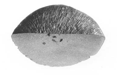

Attached is a picture of the ingot (mill ball?) I sent to Dr Ann ( taken from your great thread "Magnetic Weapons")
Is this the type you are asking about?
Gene

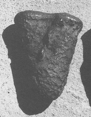

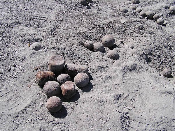

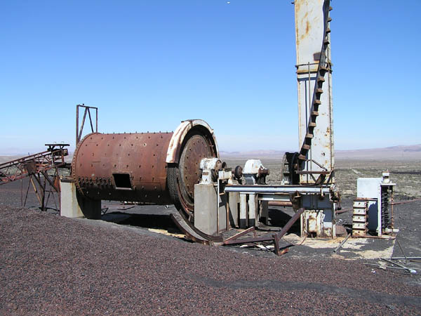

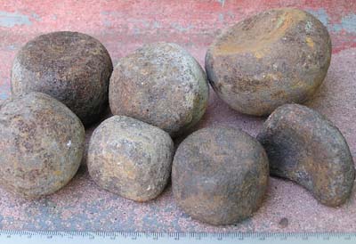

Jeff Pringle
Jeff Pringle's Avatar
Join Date: Nov 2005
Posts: 189
Since the last time this topic cropped up I found another photo of an original ingot, and a good illustration or two of the crucibles used to make them (which, of course, define the shape of the ingot ). The easy diagnostic feature on ingots is going to be some evidence of a former meniscus (that curve of the surface that contained liquids have near the edge) where the liquid steel met the crucible wall...here are two real ingots, three crucible shapes and some steel shot from a ball mill, you can see the complete lack of similarity!
Jeff Pringle is offline   Reply With Quote
Old 17th February 2010, 05:08 PM   #13
Jens Nordlunde
Jens Nordlunde's Avatar
Location: Europe
Posts: 2,718
Jeff, Thank you very much for your post and the pictures.
Form this, there is no doubt what mill balls look like, so you have cleared that problem very well - once an for all .
Jens

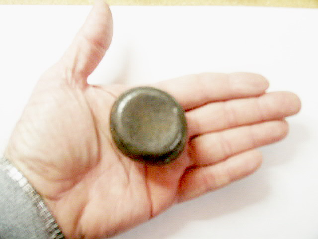

Default Wootz or Mill balls, open questions.
This is not an attempt to prove that these are wootz ingot or mill balls. It was discussed many times in several forums so I will leave it to the expert to decide. But since I was offering for sale few of these wootz/mill balls I feel I should share with you some facts and findings
I sacrificed one of this balls and submitted it to the good hands of Giora Biran, a blacksmith and a friend and this is what we have done:
The ball was cut into two halves with a disk and one of the faces flattened.
(Please note the crack in the center, also known as “pipe”. I will refer to it later.)
One half was heated to about 800 degrees and hammered down (in several heating cycles) to a flat bar shape:
One face was polished and etched to reveal a very clear pattern:
A small part of the bar was further forged to a small kitchen style blade (more and bigger blades are being worked out now), polished and etched:
Oriental-Arms is offline   Reply With Quote
