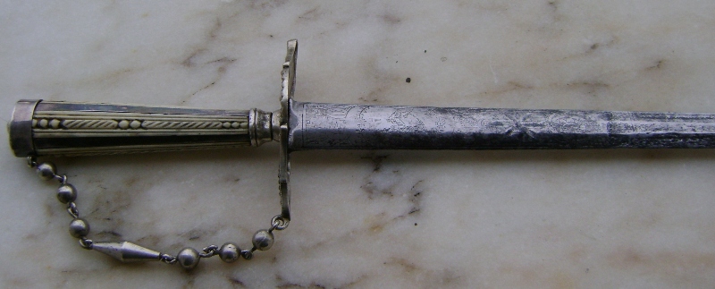

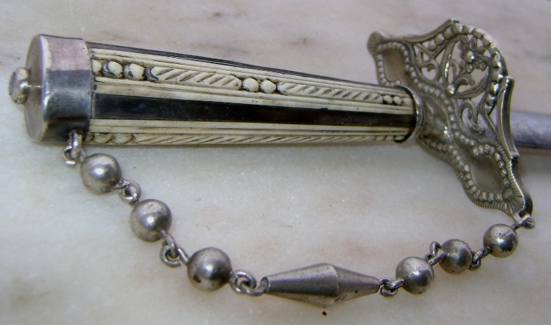

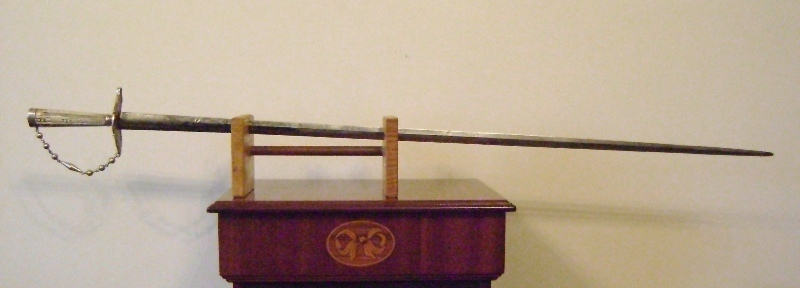

The silver+ivory mountings are those of what we call here "Quitó", an ostentation sword version adopted by fashionable Gentlemen towards the end of XVIII century.
I am not (yet) certain if such type of hilt is typicaly Portuguese, but i presume so.
However this is an atypical setup, as the traditional Quitó blade is rather short, around 65 cms (some 26"), whereas this blade is that used in efective small swords, with its 82 cms (over 32").
Probably the owner wished to follow ongoing fashion, but without giving away his defence possibilities.

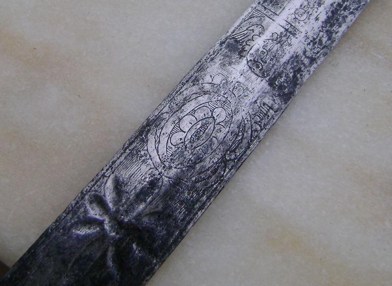

My question goes for the blade origin. Judging by the decorations, will someone be able to tell its provenance?
Would it be German ... Solingen?
I take it that it is from the XVIII century ... correct?

Very intriguing to see a sword with such a blade, and this courtly style hilt, which is indeed of end of 18th century. The styling seems to correspond somewhat to the cut steel type smallsword fashion of Matthew Boulton and some others in England about that time, and of course there was considerable contact at the time with the Netherlands.
The fragile beaded chain decoration is also very much in line with the beaded fashions of the period.
If I recall correctly, the type blade, especially with that petaled floral device stylized in sunbust fashion is characteristic of Dutch blades, as I believe was pointed out by Cornelis in a discussion some time ago. This may be a much earlier blade, which may account for such a long blade on a courtly weapon for dress occasions, perhaps it may be heirloom?

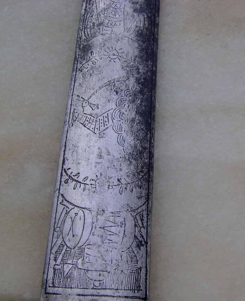

Agreed, seems Dutch, sunflower motif et al. Straight blade suggests infantry officer. Now, what about the sword-wielding-arm emerging from a cloud on the right? The sword of God's/ Gideon?
The french city of Brumath in the Alsace once had this shield. And it often appears in mid 17th C English and French Arms.
Is it a masonic symbol? Is there a difference in its meaning whether it appears from the right, vs from the left?
OTOH, it might suggest some sort of unholy alliance with the military might of Flying Saucers, which we all know often appear camouflaged within clouds.

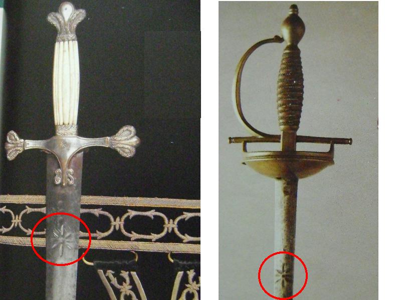

I certainly remember Cornelis assumption that the star is a Dutch mark. Amazingly and since then, i have seen a few swords, both in books as also in real, that bear such motif. Despite all such swords are aledgely Portuguese, this doesn't avoid that the blades were imported, namely from the Nederlands ... although eventualy none of them had such data in the support texts or labels.
But my questioning was more directed to all those engraved decorations, most specially the arm with the sword emerging from the cloud. Once more it appears that we are facing decoration patterns that were popularized in more that one country, therefore making it hard to figure out the actual origin of the piece.
My first visual contact with this cloud sword was in the discussion we had here, through post #10, introduced from Michael Blalock;
http://www.vikingsword.com/vb/showthread.php?t=5453
No precise provenance was pointed out, though.

Concerning the situation of a smallsword blade mounted in court sword, i was originaly more inclined towards the practical purpose than to the simple heirloom hipothesis. This because i usualy see the heirloom or economic procedure in military officer swords, where sometimes they even have to lightly cut the old blade to follow the regulation, whereas in a civilian ambiance i observe that fashionable dundees, while wishing to follow the fashion standards, do not forget that they can be aproached by vilains while walking at night in dangerous streets and want to assure they have a good strong blade at hand.

While this is clearly an elegant courtly dress sword, it seems clear that it has military orientation, and not only from the earlier blade carrying a degree of motif with military theme. The drum is of course obvious, and as has been pointed out, the armored sword wielding arm extending from a cloud.
While this ethereal allegory alludes presumably to the mighty Sword of God, it was a device that seems to have evolved quite early as a heraldic symbol in either the late 16th, into the 17th, taken up with certain talismanic applications on sword blades of Europe. It seems to typically appear as the armoured arm with sword out of a cloud, but it seems the example used by Peter Munich in the late 16th century has what appears to be an ermined element very much in heraldic style. This would seem to follow the 'mighty' sword theme, but with a regal rather than religious emphasis.
By the 18th century, along with the ethereal cabbalistic symbols that became prevalent on sword blades of Europe, especially the trade blades of Solingen, these armored arm swords out of clouds lent well to the talismanic theme. While again, it is noted that the symbol quite present in a number of heraldic arms, on sword blades it is used much more temporally than as a distinct representation of individual or nationality.

Fernando, excellent postulation there on the idea of the clear intent on the long blade, and I think the thought of an elegant dress sword, deadly but fashionable corresponds well with the deadly swordstick of the gentry.

I have been focusing on all the symbols, trying to figure out differences and their possible interpretations.
No doubt the martial items are there: the drum is clear, some poles that could be spears or flag staffs? ... even a cannon, if i am not fanthasizing; this overlaped by the cloud armed sword. Certainly i agree with the Islamic manner of it, both because the scimitar look of the sword, as for the solution of avoiding Alah to be depicted, assuming the attributed symbolism is correct.

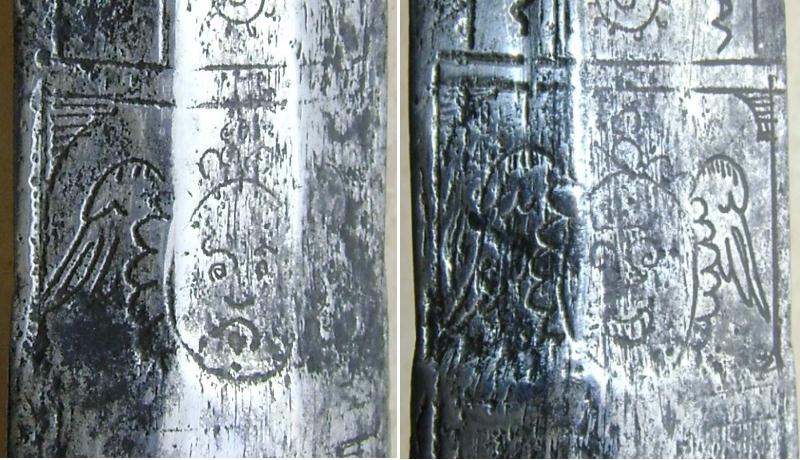

Worthy of note is the counterposition provided by the guys situated in top whom, judging by the wings, leave no doubt that they are angels; and for the first time i discern differences between depiction on either blade side. One angel has his mouth turned down, as if he was in a bad mood, while the other is clearly showing his teeth in a naughty smile.
Symbolic meanning or the the engraver having some fun?

I think your idea about the use of the longer blade for potentially threatening situations makes sense, and as I noted, the 'fancy' hilt would not detract from the deadly viability of this blade as circumstances arose. This would have been very much the case if an officer had assumed a certain reputation as a 'duellist'. These much romaticized figures were of course very much present, so it seems feasible idea.
