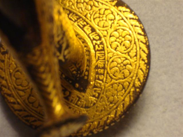

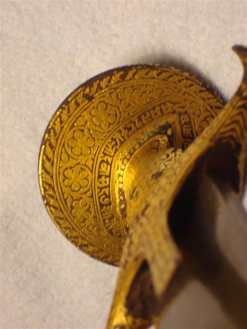

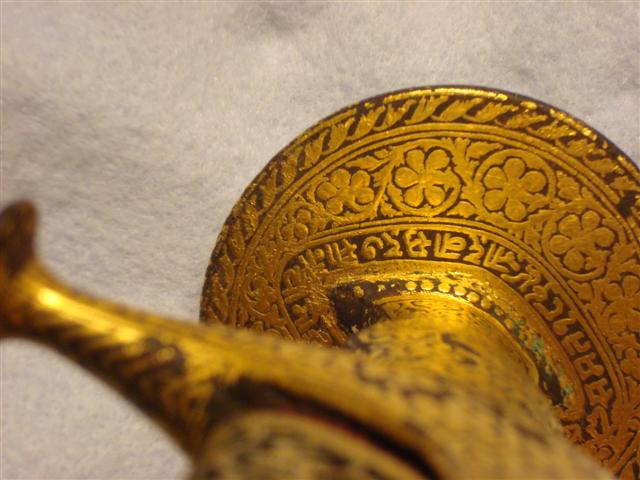

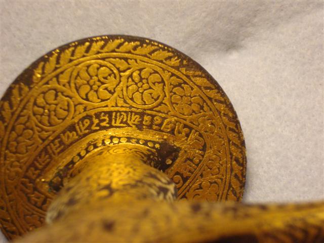

Indian sword with gold koftgari hilt. Has a nice inscription on the underside of the pommel and I believe there may be a date but haven't been able to get a full and complete translation. Can anyone make out sanskrit?

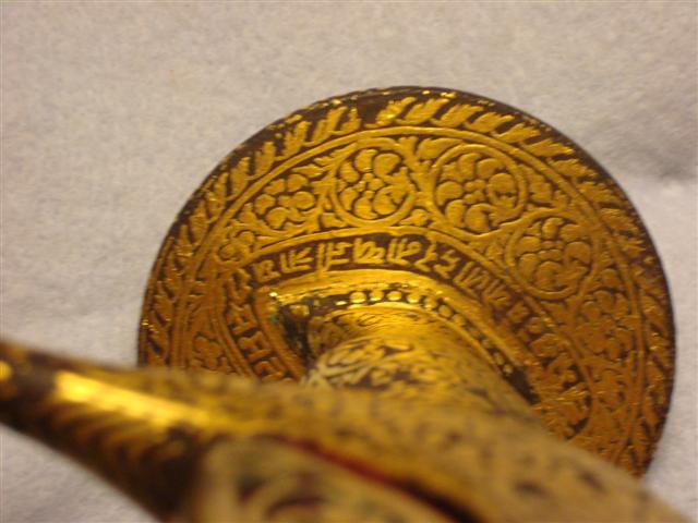

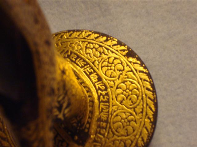

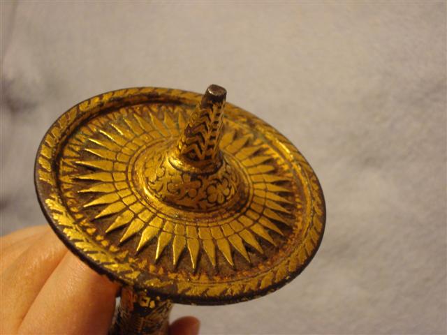

Posts: 1,097
Here are some additional pics including better close up shots of the inscription and a shot of the top of the pommel which is rather attractive.

Hey,
the first couple of snaps of the hilt show the wordings upside down.
Could you please post them again.
The last couple of snaps enabled me to read "Sanvat 1854" meaning the year 1854 according to the Hindu Calendar...
Hope this helps.
Awaiting better snaps ...!!
regards,
Bhushan

Bhusan,
Thank you for the date translation! I have rotated the view of the inscription from the first two pictures. Hopefully this will help in the reading of the rest of the inscription.

Hi,
Was able to get a part of the incription on the other side.
it reads "Cho La Dar Na Tha Ji Tra Kha Ri(??)"
Which is more like someones name.
Could we have better snaps of the part just under the quillions???? as the koftgari there looks lil blurred.
Also, it was pretty common in India to have religious incriptions or names of makers/owners inscribed on weapons and the language used was Sanskrit/Hindi/Urdu etc.
The script used for Sanskrit/Hindi/Marathi languages is the same - Devanagari..
This does not necessarily mean anything towards sanskrit was in vogue or not.
Also for a faily long time the Vikram Samvat and Shalivahan Shaka are the calendars used in India. Even to date the Hindu religious/culturals festivities are based and celebrated on these calendars.
Hope this helps.
Bhushan

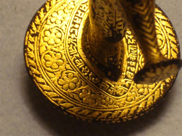

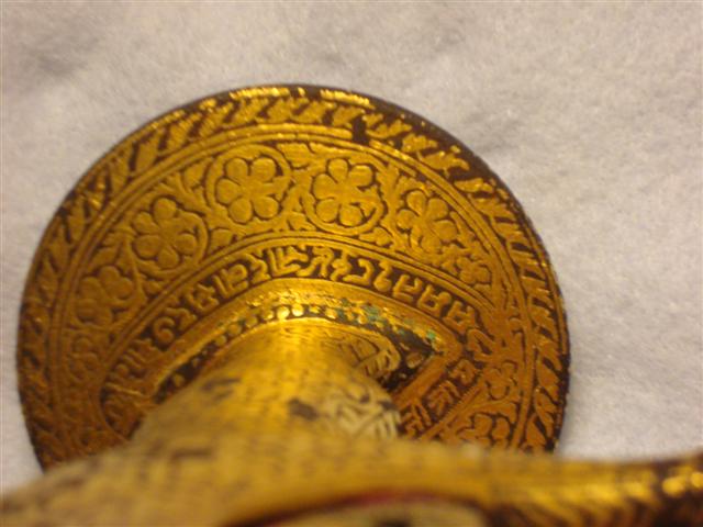

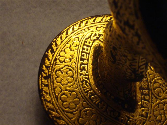

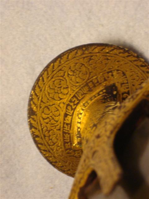

Posts: 1,097
Ok. I think I got the best pictures I possibly can to clearly show all the words. Sorry it is not at an ideal angle but hopefully the full inscription can be made out and we can learn more about this. Thanks again Bhusan for your translation assistance!

Hi,
Have been working on this however yet to decipher it completely.
This is what I have as of now. (Could be a few letters need to be interpreted differently)
As the script has undergone series of changes in the way characters were represented. Need to dig into references. Will do that over the weekend.
Sam va ta 1 8 5 4(??) Tra(??) Da Va Su D 7 So No(??/Vo) Da(??/Cho) Ma Nu -- -- Cho La D Ra Na Tha Ji Tra Kha Ri(??)
Which cane be read as:
Samvat 1854 Trada ----------------------- Choladra Nathji Tra Khari
In all probabilities this signifies an important date and the name of the owner/deity.
Thanks,
Bhushan Lawate
