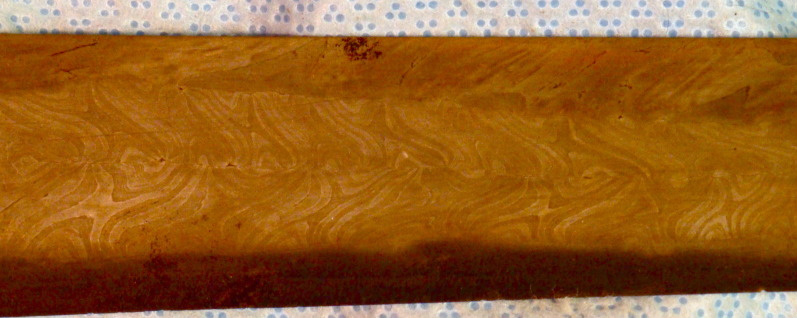

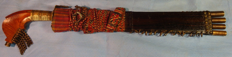

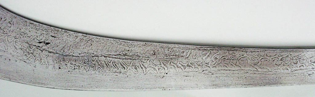

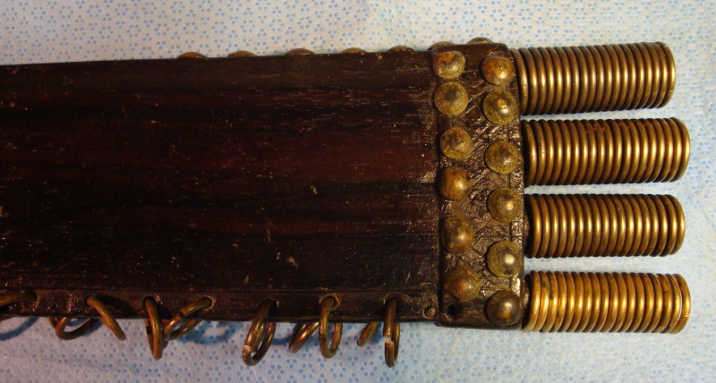

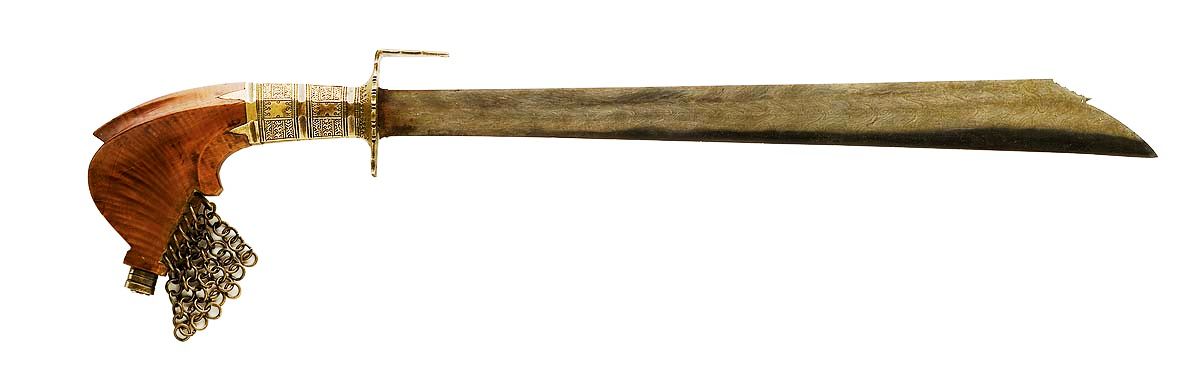

HI Kids. Below are pictures of my Bagobo with a double twist core blade. I later changed the chains on it. The scabbard is an old one that I obtained from Spunger. The cloth and tacks are original. I added the brass coils on the finials and replaced some of the missing brass links. It fits perfectly to the bolo. Again, maraming salamat Ron.
Enjoy.

Hello Jose,
As always you've done a beautiful restoration on the scabbard. This is a great match-up even though as you say it is not original to the blade. Could you please post a close-up of the hit as I would very much like to see the detailing of the guard casting. Thank you very much for sharing.

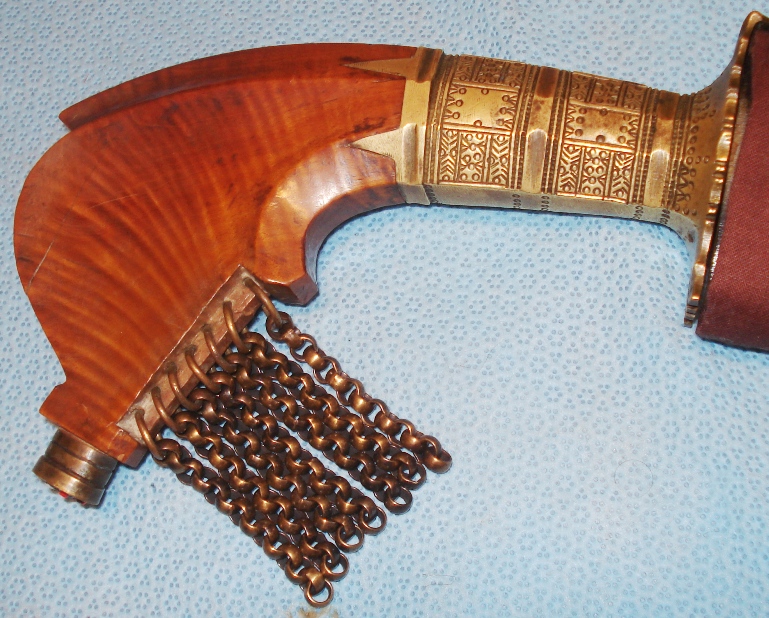

As per your request Robert, here is a close up of the hilt:

Would the colour difference between the edge region and the rest of the blade be due to differential heat treating?

Hello Jose and thank you for posting the picture of the hilt, it is an absolute beauty. I do not remember if I have ever ask before but are these done by the lost wax method or some other way and is the material used on this brass, bronze or something else? Again, thanks for sharing.

Yes Kisak, the color difference is in fact due to tempering.
Robert, they used a lost wax method and then stamped with tools.

Wow! Gorgeous piece! I'm sure fitting that brass guard piece to the burled wood hilt would have been a bear!
Small correction:
Color difference is due etch which reveals evidence of the microstructure which results from carbon content and cooling gradient upon quenching as a result of differences in cross sectional thickness.

Got a question: would the blade structure be considered "turkish ribbon?"
Old 15th December 2009, 11:51 PM   #16
Posts: 7,416
Just found out that according to Rsword turkish ribbon is the same as twist core.

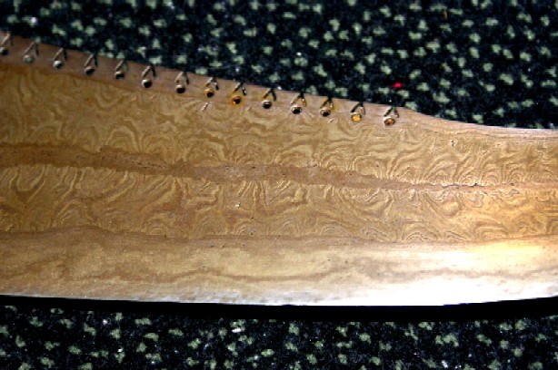

Nice Kampilan.

Nice panabas - I love twist core!

I saw the holes in the blade and this blade was a fighting blade. Each hole filled with brass indicated a kill in battle. There is great reference in the Pirate Wind on this noted by the English fighting fighting Raiders in the Philippine Sea.
The only difference in specific terms might be that a twist core has edge material (not neccesarily twisted) surrounding the,er, twisted core. In my understanding, the "turkish ribbon" part is the multiple rods of twisted material welded together to form a larger whole.
What's in a name...Construction and manufacture techniques would be pretty much the same thing.

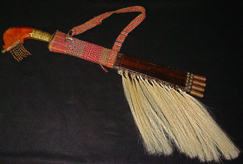

Well I finally finished unwrapping the cloth material and found a strap. I then restored the missing horse hair. Here is the picture of the finished work with a picture from Cole's The Wild Tribes of Davao District Mindanao for comparison.
Enjoy
I think that your sword looks fantastic. Great job
Also, on the subject of twistcores. I think the pattern you have (which has been used worldwide) can also be called Turkish Twist, Turkish starry night, Star pattern etc.
I think it depends on how well defined the 'stars' are, and I think of ribbon as being more....... 'loose'?
I wonder what the Celts or the Vikings called star pattern?
