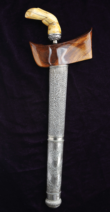

Good day guys.
This might be a rather foolish thing to ask.
But then again, I was neither good at IDing blade's origin, so here it is.
Could you guys ID whether this blade's a Sumatran or a Bugis?
It was in the posession of a German living in the Indonesia, who bought this 40 years ago there. Perhaps some of you guys have seen this blade...
Thanks in advance.

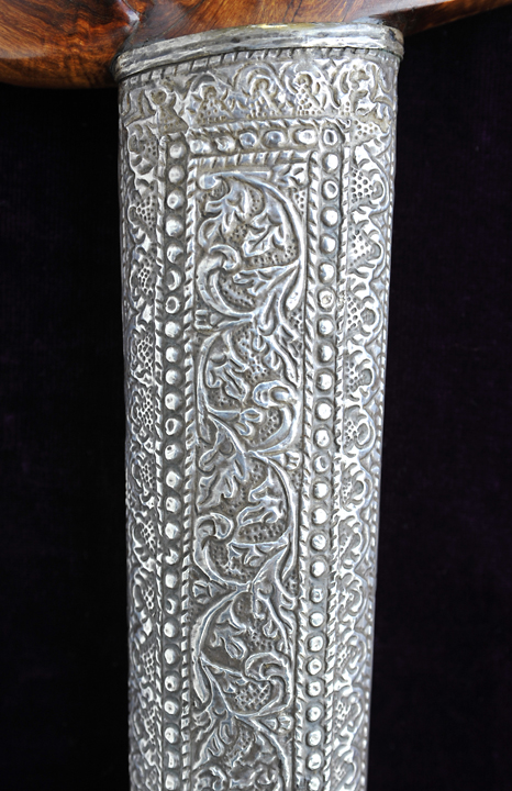

These two things are not exclusive. It is possible to have a Bugis blade that is also Sumatran.
I can certainly see the Bugis influence in this blade. Beautiful hilt as well. What does the sheath look like?

Can be from both origin.

Bugis Riau? Which material is the handle?

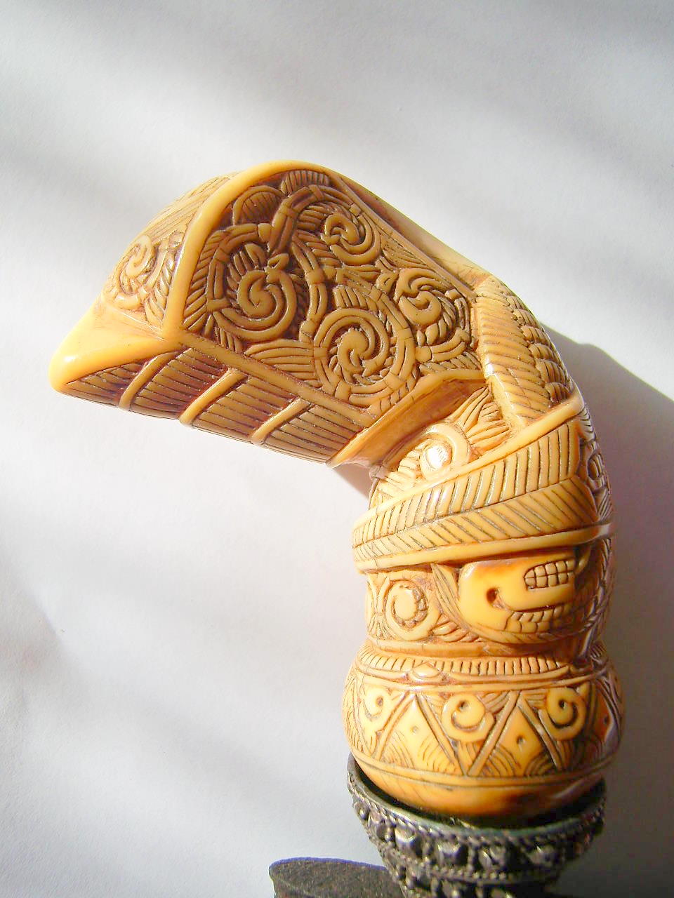

The hilt is sea ivory, I've been told. Looks like a Palembang hilt, wasn't it?
I don't know very much about Bugis keris, didn't see very much good example as well, but I feel that this piece was no Bugis.
Was the sogokan is familiar to bugis keris?
BTW, the hilt, close-up:

Wow, the hilt is really sweet!

Very nice hilt but don't need to be from Palembang, every other region of Sumatra is possible, my 2 cent opinion.

The carving work on this nice Jawa Demam is not typical for Palembang and does show some Bugis influence IMHO (carving details like the pattern on the throat).
Also, I wouldn't rule out a Sulawesi origin of the blade. Have been wrong before though...

However, the hilt's carving is something really new to me. And it looks like modernized motives being used. Pardon my knowledge, but that's what I see.
Is the carving only have Bugis' motives on the throat, instead of the whole carving works, Kai?

I still vote for Bugis Riau, the keris have Bugis and Sumatra influence. Warangka and pendokok looks Bugis and pendok looks sumatran while the hilt have influence from both and the blade seems to be sumatran. I think that it is a very nice old keris, so far you can see it by pictures.

If I was not mistaken, I can see that the blade has been warang / etched / stained. If it was a bugis-riau keris, do it still need the warangan? Didn't by undid the warangan, the pamor can't be seen clearly like this?
What pattern of pamor is that? I think I've seen such pamor in some sumatran kerises, but I dunno what name it goes...

Ok, it's a Sumatra keris (like I believe that's your's blade also) and I think that your blade have a very nice pamor and it don't will look nice like this without warangan. I don't know if Bugis blades have had originally a warangan but BluErf for example have a great knowledge about this and will be able to answer this question. I personally like it by keris from all region when they etched. Like you see in the link above the pamor is better visible.
The pamor on your keris seems to be some sort of Wengkon Untu Walang, but I am not very sure and I am not an expert.
Like I write before, it's a very nice keris in a good state and I would be happy when it belongs to my collection!

I think that it's an old one, but very difficult to say only by pictures.

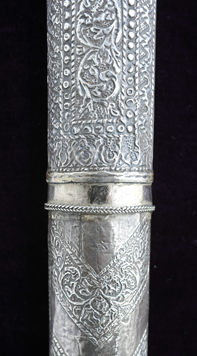

BTW, which material is the pendok?

I think it is silver, since there are blacky patch all over it. I could be mamas as well, but I have very limited knowledge on identifying one.

I just got some opinion regarding of this keris:
The hilt and wronko is Bugis. Sheath is Sumatran.
Blade is Javanese, of dhapur Menderang, pamor Unthu Walang.
Somebody of extensive knowledge of Javanese keris might can approve this theory or not.
As my knowledge are limited, I wouldn't say it's a Javanese blade because it doesn't look like one.

Here is a Sulawesi keris. The motifs on the pendok are extremely similar to yours.

It is not a Javanese blade. Having said that I will add that from the pic I don't know what it is. There are Eastern Island elements, Bugis elements, and Sumatra elements---even a touch of Bali. At the moment I wouldn't be prepared to back anything.
Silver is very easy to ID with test acid. If you do not have your own test acid, a jeweller can ID silver in two seconds flat.
The difference in value between silver of any grade and mamas, nickel silver, white brass, silver plate, and any other look-a-likes is immense. A bottle of test acid costs almost zilch. Fifty years ago I decided that self protection was the best policy and bought a little bottle of test acid, I've never been without one since.
Personally, I think this keris is a dealers melange---pieces from different places mated for purpose of sale.

Whoa, David, now that is surely a Sumatran sheath! It is really identical!

Not a Sumatra pendok, it is a Bugis like David want to show you!

My bad, Detlef. What I meant to say is that David has shown me an identical motives to the pendok of the keris that I am posting..
Hi Gustav. Thank you very much on your opinion. I can see that you have valid ground about that. The two kerises have quite similar kembang kacang / belalai gajah, and sogokan also bears resemblance...but why would you address is as "bugis-influenced culture" instead of a bugis?

Yes Moshah, and AFAIK this is a Sulawesi keris (mine), not Sumatran.

Pardon me mistakes, David. What I really meant is, when I see your pix it is clear that the pendoks are identical.
