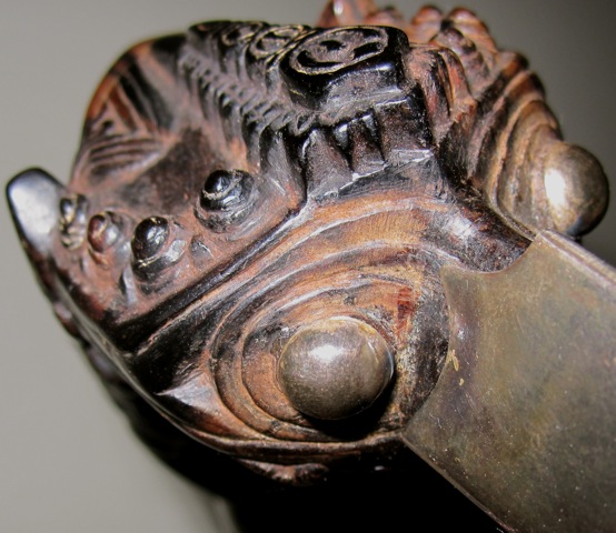

This Tajong is relatively short with total length of 52 cm. The hilt is made of Kenaong Merah with short blade Pandai Saras Luk 1. Appreciate what ever your kind comments are, TQ in advance. Mykeris.

Small sized, but every thing is in good proportion. The hilt is quite inspired, in my opinion. Adheres to the "rules" of what makes a tajong a tajong, but at the same time, bending them and reinterpreting in the carver's own style. A mark of a talented carver.
#4 |
Location: Singapore
Posts: 1,180
I believe the nose is a replacement.
#5 |
Location: Singapore
Posts: 1,180
Some of the surface of the tajong suggests that it may have been sanded down or polished to a certain extent. Too flat in some places. May have been an attempt to remove the old sapan.

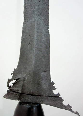

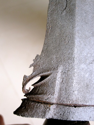

Join Date: Jan 2005
Posts: 278
More close-ups

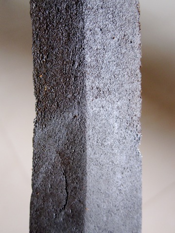

#7 |
Posts: 9,210
Nice hilt, I don't think that it is inspired.

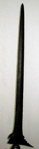

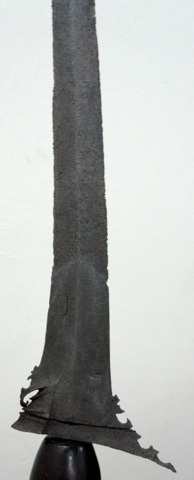

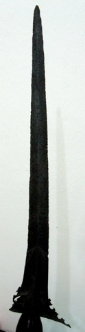

Can we see the complete blade please? sajen |

Blade Length: Ganja to blade tip 36 cm
#9 | |

Posts: 9,210
![]() Quote:
thank's for the pictures of the blade. The blade is curved but not one luk, my two cents worth estimation. ![]() Regards, sajen |

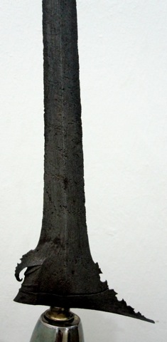

Thanks and sincerely noted. Another sample with blade 41 cm.
#12 | |
Posts: 9,210
![]() Quote:
Yes, I see why you call the first one "1 luk" but normally the lowest luk is three. Regards, sajen |

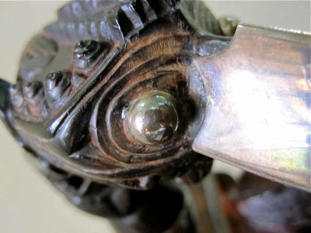

#13 |
Posts: 7,218
I don't know, from this last group of close-ups it looks like the grain and tone of the wood lines up pretty well. I would be seriously impressed if the nose on this tajong is a replacement.

#16 | |
Location: Singapore
Posts: 1,180
![]() Quote:
Notice the temper mark, which is a chevron shape. It has a name, which I cannot recall now. |
#17 | |
Posts: 7,218
![]() Quote:
![]() I'd love to know what you do call that chevron temper mark. I have a blade with a similar line. ![]() |

Perhaps this would help.
#20 |
Posts: 7,218
Well, in these last 2 pics it does look like a replacement.
What are your thoughts with the hilt in hand Mykeris? |
#21 | |
Posts: 9,210
![]() Quote:
Hello BluErf, you are correct, I know nearly nothing about Tajong keris. ![]() But I have learned and have been remembered from Mr. Maisey some time ago that it isn't possible to have "one luk" keris. We cannot have a one luk keris; lowest count must be three. You begin the count on the first luk above the gandik and finish the count on the same side of the blade, thus lowest number of luk can only be three. But maybe I am wrong by this and this "rule" isn't valid by Tajong keris? I know that you have a great experience by Tajong keris and I appreciate your knowledge very much, so please teach me by this. Sincerely, sajen |
#22 |
Posts: 7,015
Any person, or group of people, can decide how they wish to refer to anything.
If a person, or group of people, wish to refer to a keris with no luk, but with a blade that is clearly lurus as "luk satu", well, so be it. That is their decision. However, according to what I have been taught, there is no such thing as "luk satu". One luk does not exist, and logically cannot exist. But anybody at all is entitled to his own opinion. |
#23 |
Join Date: Jun 2007
Posts: 401
I agree.... there's no such thing as luk satu....... and i believe it's just a recently concocted terminology......

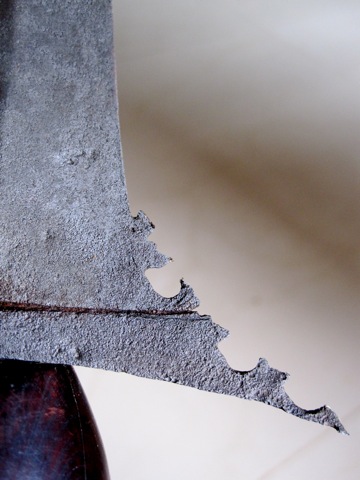

Alan, do you think that the keris had undergone reshaping works / besutan esp at the sorsoran, to be precise, reshaping the worn out blade to display perfect ri pandan and other fret works? |
#24 |
Posts: 7,015
I don't know.
The sorsoran does look a bit clumsy and rigid, but whether this is the maker's inadequacy, or whether it is evidence of somebody having a bit of a fiddle, I wouldn't like to say, especially from a photo. |

Thanks for uploading the clearer picture of the fret works, mykeris.
looking at the blade as whole, I think it is out of proportion, especially at the sorsoran..... it doesnt widen harmoniously as a keris blade (dapur pandai saras) should be...... since this blade is quite old and dressed in Tajong hulu and sheath, I dont think it's due to the empu's inadequacy - rather, my theory is, somebody may have fiddled the blade to look good (some times to fetch a higher price).... But of course, I am not too sure about this ![]() |

Thanks for all your comments. Through close magnifying, the hilt looks to me so natural to show that the nose is not a replacement. However, it looks so odd when the carving stops unfinished and thats raised many questions. Probably, its a trend or the carver's trade mark or etc...Bluerf, you raised strong points and you are so observant, keep it up friend, ...I always overlooked on details.

![]() Quote:
The tajong hilt's nose has a metal sleeve? It seems so from the last 2 pics you have posted. I can't tell whether the nose is a replacement for sure, but just do note that sometimes, some of these old repairs are so perfectly fitted, that one can hardly notice! But of course, I'm not doubting your observation, especially with the aid of a magnifying glass. ![]() |
#30 |
Location: Singapore
Posts: 1,180
Oh wait a minute, its a different tajong you're showing us. This one's rougher compared to the 1st one you showed us.
