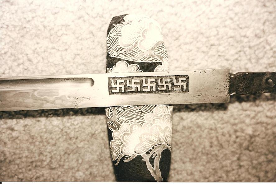

Default Chinese sabre blade believed of late Ming dynasty with svastika markings

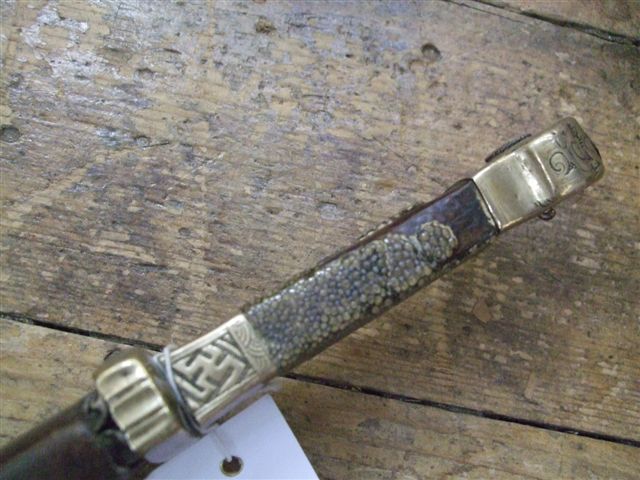

For some time I have been intrigued by the antiquity of the symbol of the svastika, and its appearance on weapons long before the obvious negative connotations from its purloined use before and during WWII.
It appears that the symbol likely derives from solar oriented symbolism that may be as early as the Neolithic period. It is known that the symbol was used in ancient Greece as seen in the image here from c.300 BC. In about this time in India, the Mauryan ruler Ashoka adopted Buddhism, and began construction of various temples and stupas as well as his well known pillars.
It is important to note the appearance of architectural elements as well as symbolism in the decoration on weaponry that often occurs. In the case of these monuments as well as other material culture associated with Buddhism, the svastika often appears as one of the first of the 64 auspicious symbols on Buddhas footprint.
The Sanskrit term svastika (sv=good, asti=to be) indicates the typical interpretation of the symbol, meaning good luck, success, good fortune.The Japanese 'manji' of the middle ages was the same symbol, which carried the Buddhist meaning protecting from evil forces.
In Greece, this symbol was the 'gammodian' , incorporating four 'gamma' letters into a wheel type arrangement.
The solar application as well as representation of the four cardinal directions seem universal in viewing the symbol.
In China, this symbol, termed the 'pinya wan' if I understand correctly, of course carried the auspicious Buddhist symbolism, and if memory serves, there was Buddhist motif on the mounts of this sword blade, which had a distinct yelman and as noted was believed of probably latter Ming dynasty.
I cannot recall more as this is a photo taken many years ago of a sword in private collection, with later mounts carrying Buddhist motif.
I would like to hear thoughts on the use of the svastika on Asian weapons, and hopefully see other examples. More on the use of the svastika would be interesting, but I beg to defer on attention to WWII
Another example , aside from the Asian use would be the American Indian use of these symbols, and how and when did they arrive in America?
All best regards,
Old 31st July 2009, 05:25 PM   #2
Posts: 10,851
Apparantly file was too large so here is the blade:
Old 31st July 2009, 06:18 PM   #3
Posts: 7,397
I agree with you Jim. Buddhist influence in China was strong and I believe also that this is a Buddhist derived talisman.

Old 31st July 2009, 10:55 PM   #6
Posts: 10,851
Thank you so much guys! I really appreciate the positive responses, and well placed notes. As most here know I have always been pretty much obsessed with the symbolism found on weapons, and admit that I often will stretch things a bit in theories and trying to find connections between cultures.
It would seem that in many cases, very simple designs have indeed developed divergently in various cultures, with the most amazing result being the evidence of man's inherent search for meaning in most everything.
It seems the design for the swastika derives quite likely from simple geometrics seen in crossing of material as in basket weaving. This may well explain the appearance of the design in American Indian cultures such as the Navajo and Hopi, where these materials were well known. As well stated in one article, this imagery would easily apply in most native cultures worldwide.
As I had noted earlier, the symbol was known in the ancient Greek world as the gammodion, and derives from certainly much earlier forms. The German archaeologist Heinrich Schliemann found these symbols in Troy and Mycenae in the 1870's, and suggested that it was an Aryan religious symbol. This perception of course took on its rather distorted course to the misperceptions of Aryan themed cults and into its unfortunate incarnation symbolically.
My interest in the symbol, as a Buddhist symbol, and in its application in the motif on weapons, would be why are these sequenced in the numeric five?
The three is of course well known symbolically in religions, and we have determined that the symbol itself is generally held as a symbol of good fortune, success and positive force.
This blade is early, and seems to date into the Ming era, and as is typically the case, refurbished at a later time with preponderance of Buddhist symbols in the mounts, which suggests it remained in its original orientation with its subsequent owners.
I wish I had images of the fully mounted sabre, or could show the entire blade, which as noted did have a yelman, as recorded in notes.
I never know what I'll find in these heaps of old files!!
All best regards, and thank you again guys!

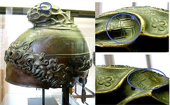

hi all,
here is an picture from an japanese armor from the 17.th.ct.
i saw these armour for some years by an german antique seller from japanese arms. it is an phantastic item from an very good iron work and the silver "koftgari" was also very magnificence! these armour shows also these budhistic svastica symbols and it is very pitty that the most people in the western world think by these symbol at first at nazi german symbol. the root from these svastica is sooo old and you cane find it not only in the bhudistic world also the in the german ore celtic mythologie can you find these symbol. i saw some very old celtic things decorated with the svastica.

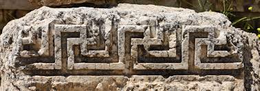

Old 3rd August 2009, 09:29 PM   #9
Tatyana Dianova
Posts: 784

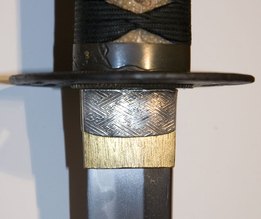

Another Japanese example: svastika theme on the 'habaki'
Old 3rd August 2009, 09:46 PM   #10
Jens Nordlunde
Jens Nordlunde's Avatar
Location: Europe
Posts: 2,718
Tatyana, your pictures are, as always, very good.
Like Battara writes - the svastica is ancient, very ancient, and it is likely that he is right about from where it origins.
Like always we have many questions, but very few answers.

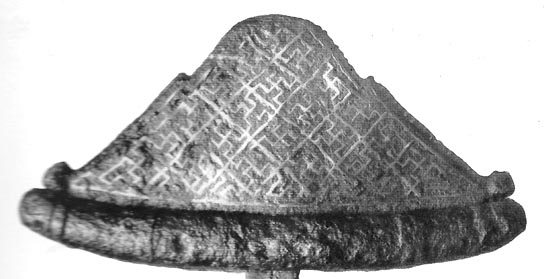

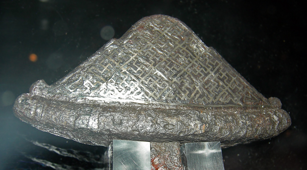

Detail of Plate LXI from Behmer’s “Das zweischneidige Schwert der germanischen Völkerwanderungszeit”
Jeff Pringle is offline   Reply With Quote
Old 3rd August 2009, 11:34 PM   #12
Posts: 10,851
Thanks again everybody for the ongoing and great responses!
It is truly interesting that the Greeks likely acquired this symbolism from India, and of course probably from thier incursions.
Great illustrations of the Japanese use of the symbol, which I had not been too familiar with, and these are really awe inspiring.....that habaki is unbelievable Tatyana! As Jens notes, your photos really are magnificent.
Jeff, the Behmer photo really is interesting. Does it note what period this element is from, and more about it? Thank you for posting that. As I had found earlier, these symbols seem to have early origins into the Neolithic period.

Posts: 189
That would be a 7th century sword, Behmer’s Type VIII; and since it was found in Sweden it is probably the previously mentioned one from the museum in Stockholm.

Definitely looks like the one I mentioned from the Historical Museum.

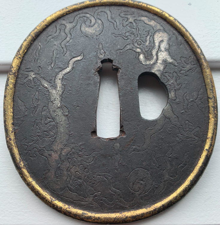

Default Svastika or Wan Character on Chinese and Korean fittings

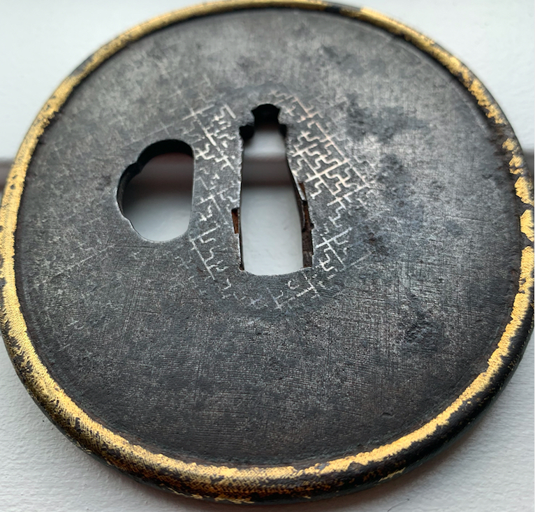

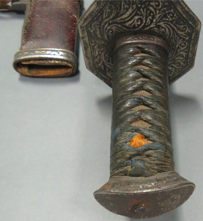

The twin dragon Chinese Ming dynasty HuShou (guard) has been imported/exported to Japan and modified with Kogai-hitsu-Ana (by-knife hole) to accomodate the custom of carrying a by-knife with the katana. The dragons are on the handle side, while the blade side shows the swastika/Wan (ten thousand character). If it weren't for the seppa/washer of the sword, all the swastika false-damascening would be rubbed off. (this is from my own collection)
The Korean Hwando has Chinese and Japanese elements. Close inspection of the pommel shows the swastika/Wan character pattern, also applied by false-damascening technique. (this was found on the internet)

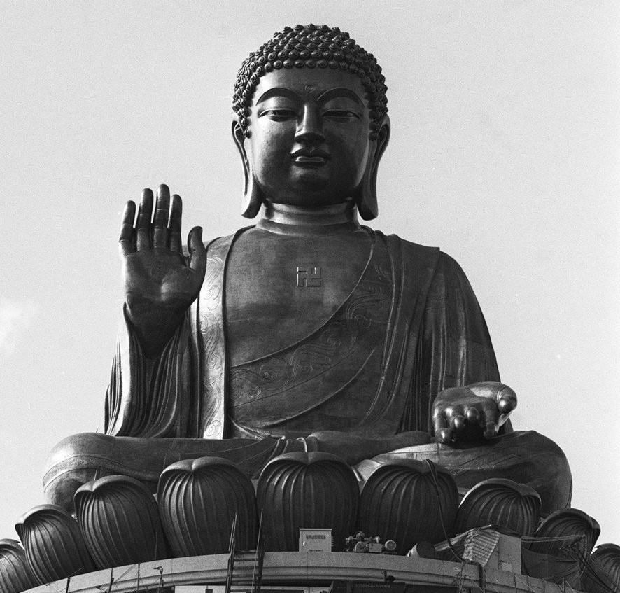

Old 30th November 2020, 06:22 PM   #22
Posts: 2,831
Yes this is a Buddhist Talisman.
The giant Buddha on Lantau Island Hong Kong has a "reversed" version on his chest.
Stu

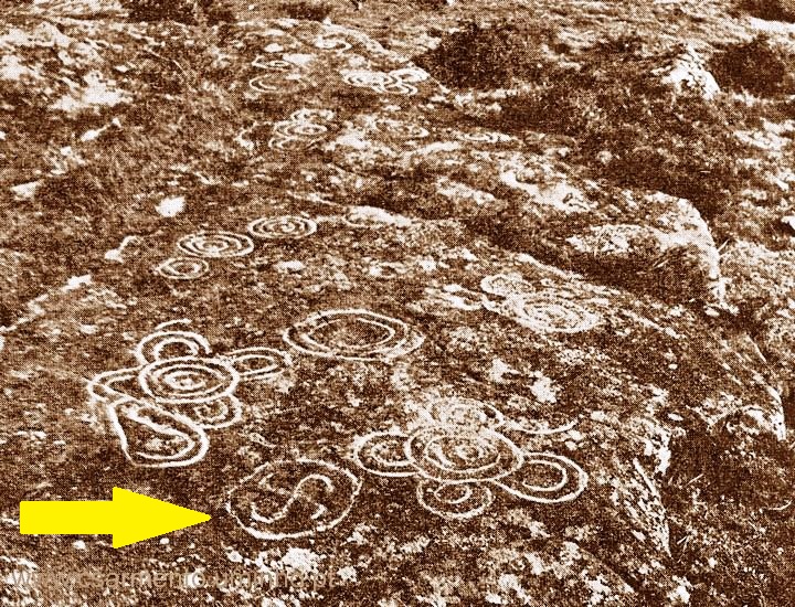

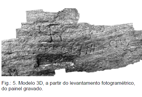

A bit older than Buddhism, Jainism has swastika for symbol.
I don't know if the Greeks or Romans brought it back in their "suitcases"...
As mentioned by David, Swastika is a very old symbol and a very simple geometric design, related to wheel, sun, life... and used by many cultures.
From America to Japan...
So I won't venture in explanations or influences...

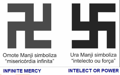

Default Swastica = Sanscrit for well being ...
Originally Posted by ariel
Interesting...
The right-sided version ( clockwise) in Hinduism is a symbol of Surya( sun) and of good luck, prosperity etc. In short , all the good stuff.
In contrast, left-sided ( counter clockwise) is associated with night, darkness and Kali.
Never thought deeply about this subject, but what is this left-sided one doing on Buddha’s chest? Unless, of course, the pic was reversed:-) This is impossible, because his right arm is raised...
Countless interpretations seem to appear, one more in favor of Lord Buddha, on what the Swastica version (counter clockwie) concerns.
... As also variants in form, found all over the world, in rock art, church doors, ceilings, etc. We find them often here, in Archeologic sites.

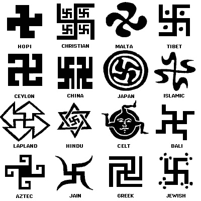

I would like to respond to Jim's earlier question.
"My interest in the symbol, as a Buddhist symbol, and in its application in the motif on weapons, would be why are these sequenced in the numeric five?
The three is of course well known symbolically in religions, and we have determined that the symbol itself is generally held as a symbol of good fortune, success and positive force."
Several posts have mentioned the swastika as a sun symbol, but the four quadrants represent thus sun in relation to the four seasons of the earth. The angled arms represent the sun going around the earth (it looked like that anyway). So it is a symbol of the sun and the earth, much like the Celtic cross (cross in a circle).
So why have five of them? In Chinese numerology, the number four is associated with the earth, but is considered unlucky because it is the earth without humans. The number five specifically represents our five pointed shape, and is considered the human number. There are of course many important "fives" in Chinese mythology, such as the five elements, but in my opinion, the maker of this sword wanted to avoid an unlucky association with the number four. Four is the number of death, and that is a bit intense on the side of a blade.
