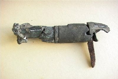

In the second half of 1396 the army of the Livonian Order sieged Otepää. They probably managed to set the castle on fire. The wooden parts of the castle evidently blazed so vigorously that even the brick walls of the buildings collapsed. Treasures were left under the ruins: the silverware of the Holy Communion from the chapel of the castle, books decorated with silver studs and pieces of rock crystals, grand suites of armour etc.

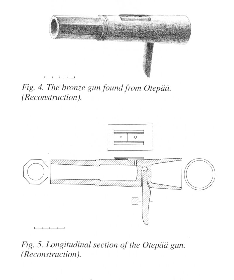

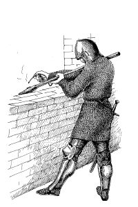

Next to those relatively rare findings the pieces of a bronze barrel that at first seems quite simple, deserves special attention. It was possible to fit the pieces together by their edges and so they reconstructed the gun that had been used more than 600 years ago ().
Originally the barrel of the gun was about 175 mm long and the caliber of its metal part was measured 18 mm, but the caliber of the gunpowder chamber was a bit bigger (). About a meter-long simple wooden stock was probably fastened to the back part of the barrel that was a bit wider at the time. The gun had another interesting addition. In casting it a cavity was left in the middle of the bottom side, it was for a special iron bar or the so-called hook. The extending tip of the latter was pressed against the wall in order to absorb recoil when firing the gun.
Gunpowder and the bullet were inserted in the breech of the barrel, then gunpowder was also sprinkled into the ignition channel on top and the handgun was ready to be used. At that time they still used a glowing iron bar or slowmatch to ignite it, although at times they already used a fuse as well. When firing the sparks, flames of fire and a good cloud of smoke flew out of the barrel and the ignition channel. Probably this is why the butt was probably rested above the shoulder (). Such a shooting position can also be seen in some pictures from the 15th century depicting gunmen.
