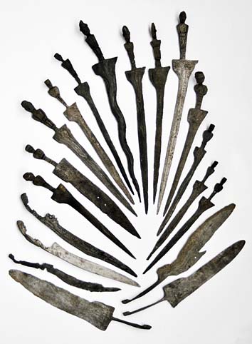

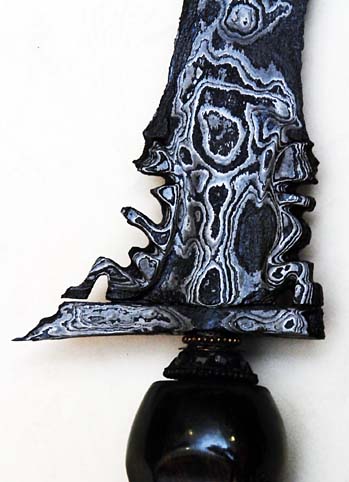

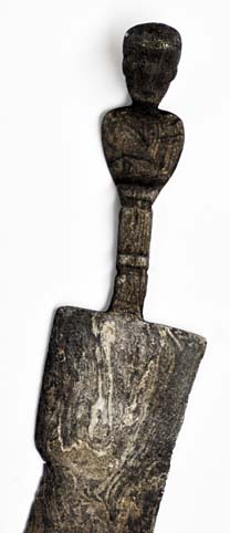

Dear All,
First of all, I apologize for disturbing you to deal with this "name game" again. These are some of my humble collection of what GB Gardner (1933) said as "keris majapahit". Although, the local name was probably "keris sajen" (keris for offering) or even colloquially named as "keris kepala besi" (or 'iron headed kerises' in Bahasa Indonesia).
My old question is, why did Gardner name such kerises as "keris majapahit"? Is there any relation with "keris from majapahit Kingdom"? Or maybe, "kerises usually used by people in Majapahit"?
I am waiting for your enlightment...

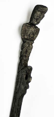

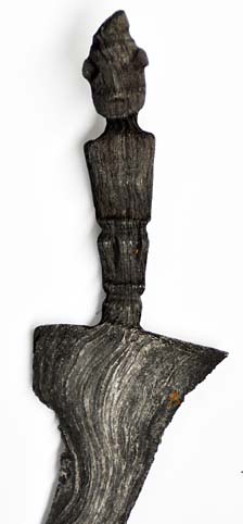

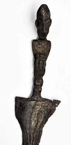

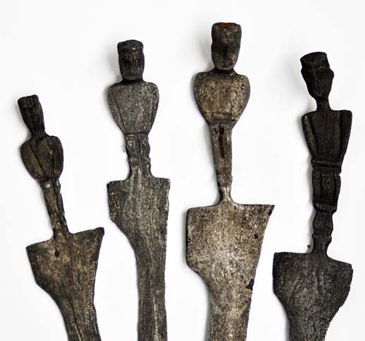

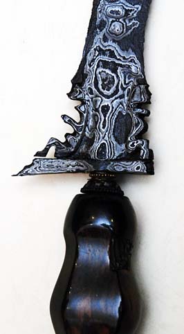

These are some more close ups...
Thx
GANJAWULUNG

Default MORE close ups

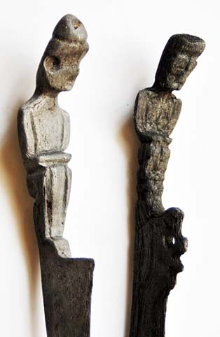

Some more close ups...

I believe Gardner thought this type of keris originated during the Mojopahit period. Perhaps it did, though i suppose the form could be older. It certainly is a form that existed back then. Of course the name gives the impression that this was the standard keris from that time and i think we will all agree that keris sajen is a more accurate name.
Nice collection BTW.

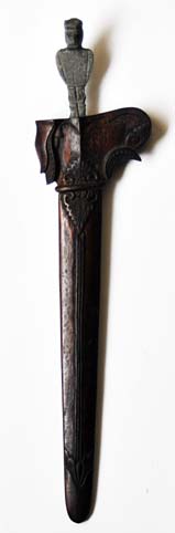

Default With Its Warangka

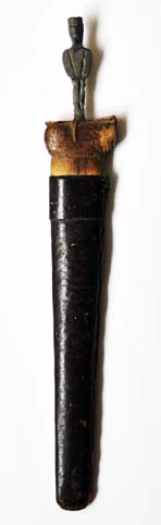

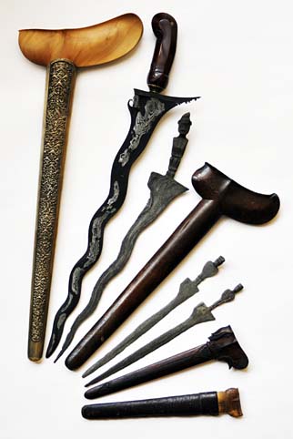

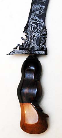

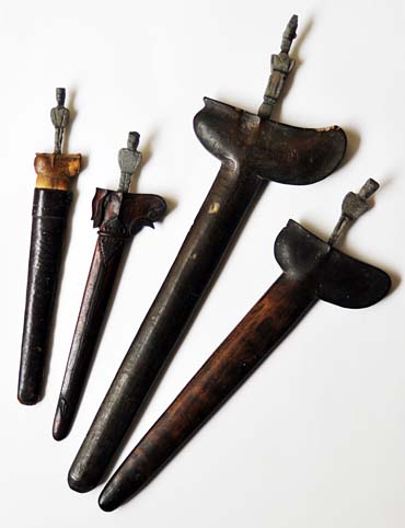

Thanks, David. And these are more pictures of the sajen kerises -- some of them are "pichit" (name in Malay version), with their warangkas....
GANJAWULUNG

Default Size Comparison
Size comparison between Yogyakartan keris, medium size and smaller size of "keris sajen"...

Default PUTHUT kembar
These are more pictures on hilt part of "keris sajen" or as Hifi mentioned, "keris puthut" and some shots of a keris with dhapur "puthut kembar" or twin hindhu-priest with East Javanese hilt...
GANJAWULUNG
