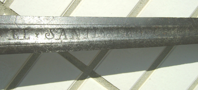

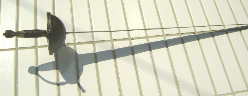

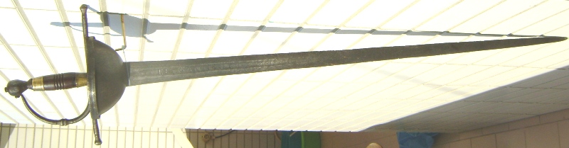

Default A cup hilted sword ... much better than the pictures
Old 18th October 2009, 07:04 PM
Posted by:
Lead Moderator European Armoury

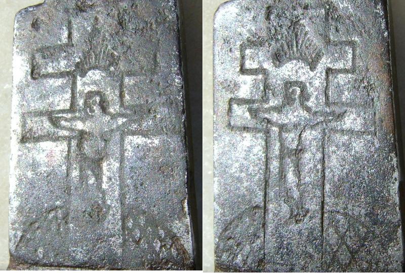

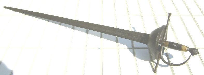

Definitely i don't reach full control of my new digital camera ... or perhaps is the camera that is no so good.
This sword is, i would say, from the XVII century. Judging by the width of its blade (4 cms) and fixation of the knuckle guard to the pommel, it would be a military weapon.
Its blade measures 80 cms. and is rather thin, which makes this a light handy sword, with 950 grams.
It bears along the fullers one of these traditional religious inscriptions 'MIN SINAL HES EL SANTISSIMO CRUCIFICIO' (my sign ((symbol)) is the holly crucifix).
In both sides of the ricasso it has a punction of its smith; although we can discern a crucified christ, the cross is not a plain one. Also its top seems to have some kind of efect, which is almost imossible to figure out, due to its position under the langets.
The crucifix was a mark practiced by various smiths, like the German Hannes Cleles and Heinrich Koel (known as Coll) and the Toledan Pedro Hernandez, but i suspect there were more variations on this mark theme.
The exact provenance of this type of swords is often undistinguished and so called Iberian or Peninsular but, due to the system of its cup fixation, welded instead of screwed, may well be Portuguese ... not taking into account that until the mid XVII century Portugal was under controll of the Spanish Philipes, and contemporary weaponry fashions were an assumed mix.
It was acquired in a Portuguese mannor house, anyway.
Fernando

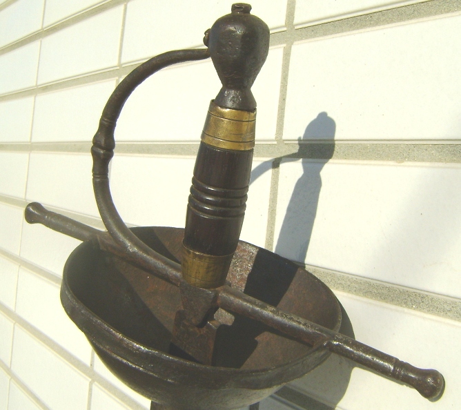

Old 19th October 2017, 11:47 AM   #156
Old 18th October 2009, 07:05 PM
Some more picures ...

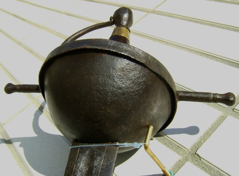

Fernando, this is a fantastic good solid arming cuphilt, and you know my weakness for these beauties!!!
Norman, excellent observations on that 'Apostolic cross' and very plausible thoughts on its application.
While these type markings were often associated with the blades of certain makers, it does seem, as thoroughly discussed over years, that they were applied in more of a talismanic sense in many cases. In the placing on this, it does seem that a device used by a specific group might be possible.
Clearly, the cuphilt rapier was well established in both Portugal and Spain at some time early in the 17th century, though many of these, were produced also in Spain's provinces in Italy. The thin, thrusting blade rapiers were used well into the 18th century in traditional application in Spain, but by the mid to latter 18th century the cuphilt had extended into the military sector, especially in Spain's colonies.
When I first saw this beautifully aged cuphilt, my first thought was that it was a colonial example, and though familiar with the 'Caribbean' or Spanish forms, its provenance to Portugal suggested possibly South America.
This seems to be one of the 'arming' type examples of probably third quarter 18th century, and the blade appears to be of the military type produced usually in Solingen in that time. The style of lettering in the inscription and the blade itself resembles the familiar Spanish 'dragoon' blades of 1770's with the 'Draw Me Not Without Reason' etc. inscription.
Interesting is the rolled edge of the cup, which vestigially represents the 'rompepuntas' of the early cuphilts which were intended ostensibly to catch the thin rapier blade of the opponent. These are not seen on colonially produced cuphilts of this period, and interesting to be seen in this application more as a finished appearance feature. The style of the grips are also a latter 18th-early 19th century affectation often seen on Spanish colonial swords with dual coloring. The lined elements on the quillons and knucklebow also resemble Spanish military swords of this period.
Thank you so much Fernando!! and good observations Norman.
I hope we can keep moving on this to see more on the interesting marking and what it might signify, and more on the inscription...would this be compared to any others particularly Portuguese?
All best regards,

Further research on the notes for this interesting crucifix marking.
Most of the markings attributed to the German smiths were actually cross and orb rather than crucifix, such as Heinrich Coll, and from I understand, these were affectations added with inscriptions, names or invocations. I am not sure about markings by Pedro Hernandez, nor the crucifix seen on the blade by Cleles.
The form of cross seen here is most interesting and it seems that the cross with the normal sized patibulum (main cross beam) as well as the smaller upper beam (titulus) is indeed an apostolic cross as used in Hungary. It is also known as the Patriarchal cross.
In this case, the cross in Patriarchal form, as crucifix, is known in Spain as the Caravaca Cross, and is associated with a miracle in the southeast Spanish town of Caravaca de la Cruz. The cross is most typically flanked by two angels, who in the miraculous event c.1231 carried a cross comprised of part of the True Cross. There were indeed associations with the Knights Templar during the 15th century when they occupied this town.
Apparantly, this cross is often employed in a talismanic or amuletic sense, and is noted as often seen in Central and South America as such, as a good luck device. It would seem that this would correspond with Portuguese colonial presence in these regions and the Portuguese provenance as well as the fact that this does seem a colonial America's weapon from latter 18th c.
It is well known of course that there are a number of fraternal societies and groups with profound associations to Masonic lineage, and often less clearly to the Knights Templar, so perhaps this weapon might have belonged to a military officer in the colonial regions with these associations.
I also found a note in "An Illustrated History of Arms and Armour" (Auguste Demmin, tranl. C.C.Black, 1901 ed. p.577) which illustrates a cross with two same sized patibulum (beams) and is noted as a mark supposed to have been on blades of Crusaders who had swords either made or stamped at Jerusalem. Demmin notes that he found a sword with such mark in the arsenal at Berlin, with hilt which suggested it was of 16th century. Perhaps the shape of the cross, if it does indeed correspond to the graphic without the vertical beam beyond the upper crossbeam, might be associated to this.
Hope this additional information might be useful, and adds to the outstanding mystique of this wonderful military cuphilt, which seems quite possibly of Portuguese provenance to probably South America.
All best regards,

Old 19th October 2017, 11:50 AM   #160
Old 20th October 2009, 01:20 PM
Posted by:
Dmitry
Join Date: Jul 2009
From what I've seen of these, they are described as the Caribbean rapiers. Dating to the second half of 18th century looks right, unless the mark proves otherwise.
Old 19th October 2017, 11:50 AM   #161
Old 20th October 2009, 04:39 PM
Posted by.
EAA Research Consultant
When I first saw this, I thought also of the 'Caribbean' versions of cup hilt rapier, as described by Peterson and Brickerhoff/Chamberlain, and are as previously noted, basically military 'arming' versions of the traditional cuphilt.
However, this example has more refined, though heavy, styling carrying the vestigial elements such as the rompepuntas.
The term 'Caribbean' seems to have become somewhat misaligned as these are actually 'colonial' as thier use and apparantly their production appear to have been widespread far beyond that sphere.
The dual colored grip is similar to those seen on Spanish colonial hilts on a number of edged weapons typically of latter 18th into early 19th. I have an example of court type sword of probably 1820's Mexico with this type of horn/ivory type grip. In style it is also with neoclassic style elements that are often seemingly incongruent, such as vestigial quillon arms placed reduntantly under a dish guard.
The mark truly is intriguing, and I think is likely associated in some way to an officer, probably with interest or membership in a group in league with the numerous fraternal or perhaps some Masonic presence. Also, it would seem that the use of the Caravaca Cross, with South American prevalence mentioned may have some bearing on its presumed colonial provenance.
Old 19th October 2017, 11:50 AM   #162
Old 20th October 2009, 06:36 PM
Posted :
celtan
Join Date: Sep 2008
Location: PR, USA
Hi Guys,
The central wide fuller makes the blade distinctly different to the "a dos mesas" type, so characteristic of iberian battle-swords in the 17-18th Cs.
I have seen such fullers in swedish, german and belgian blades.
The grip is a later replacement, its type was often seen in Spanish colonies from Filipinas to America.. Incidentally, the blade is too heavy for the pommel's size.
The motto is either galician or portuguese, most likely the latter.
Very good condition overall, congrats Ferd!
Old 19th October 2017, 11:52 AM   #163
Old 20th October 2009, 07:20 PM
Posted by:
Excellent observations Manolo!!!
Could you please say more on the term 'dos mesas' ? I am unfamiliar with that particular term and would like to know more. I agree with the cross section of the blade resembling the Solingen type productions of c.1760's with the 'Spanish motto' often found on 'dragoon' swords.
All the best,

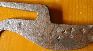

Old 19th October 2017, 11:53 AM   #165
Old 20th October 2009, 11:24 PM
Posted by:
Hi guys, thank you all

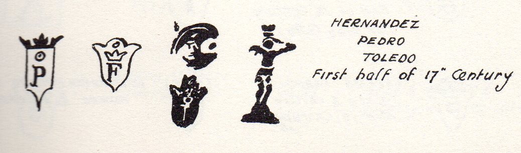

In face of so many coments, i decided to take off my cuff links and do a bit research myself, trying to instantly catch pace with those, like you, whom gathered a lot of luggage in this subject through long time.
I will in any case continue researching and try and join as most material as i can on this item, as i usually do.
Concerning Norman's sugestion about the crucifix; considering he is right ... or half way to it. We can even go as far as imagining that this mark is a composition made with the smith punction and the client's symbol. But i am not personaly inclined to it, until further evidence ... or until we find this mark in some book or picture.

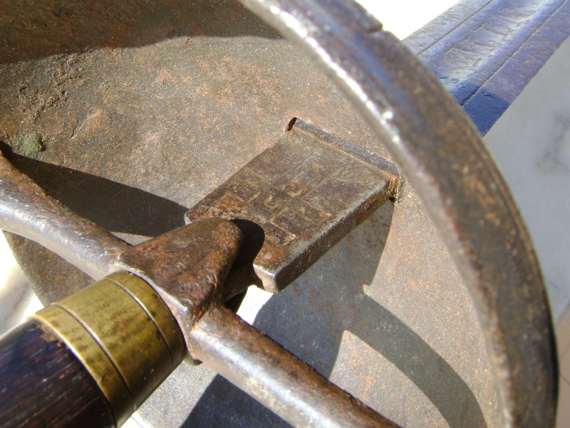

I went into the unusual (for me) adventure of dismounting the guard; fortunately the pommel is the screw type. Now the mark is as clear as possible. A real chalenge; besides the classic christ in a crucified position, as may be seen in Pedro Hernandez mark, there is a peripherical double beam cross, upon a sort of calvary and with an aureole on the top.
I wonder whether this is a Patriarchal or a Lorena Cross, or a 'modified' setup created by the smith.
I couldn't yet confirm if and what inscriptions Pedro Hernandez and other eventual crucifix mark smiths used to inscribe in their blades, but suddenly i realized that the phrase MIN SINAL HES EL SANTISSIMO CRUCIFICIO is not an abstract allusion but an objective one, that is, the signal (sign) they refer is the mark they punction on the blade recazo: the crucifix.
I don't think i assimilate the sugestion that this sword is Caribbean ... or Spanish colonial, or the like; much less a rapier .
I am totally convinced that this sword is Peninsular; either Spanish or Portuguese ... or both; like a XVII century Spanish blade with a XVIII century Portuguese hilt ... for instance .
I have just checked the digital copy of a catalogue published to cover the Ornamental Art Exhibition held in the Lisbon Academy of Fine Arts in 1882. There were four swords with the inscription MIN SINAL HES ... all (syntomaticaly) with the same spelling, and all dated by the catalogue author as being from the XVII century. And, two amazing things: one of them was a schiavona sword and another, a cup hilted one, had the marks of famous Alonso Sahagun on the blade forte.
Except for the schiavona, the other three were quoted to have a crucifix on both sides of the recazo.
I agree with Manolo that the blade shape of 'bulk' cup hilt battle swords was the dos mesas (two convex faces cross-section); i have one myself and also find one pictured and described in a book i have. But i guess this doesn't eliminate other shapes, does it? I eventually have a similarly fullered specimen in the same book, precisely with the MIN SINAL HES motto ... and in the same lettering as my example; and also dated XVII century, although i can't guarantee the author's rigour; it belongs to his own collection.
... And, Manolo, i don't think the blade is too heavy for the pommel size . Remember the blade is fullered and of short length; the point of balance is 8 cms away from the guard. What do you think?
Concerning the dimension of the rumpe puntas (quebra pontas) Jim, i see plenty like this one, as still being within the 'norm'; but here between us two, i think such implement was more on the fantasy side, rather than an operational device .
My best wishes to everyone ... and thanks a lot for your participation.
Fernando
(missing attachments)
Old 19th October 2017, 11:56 AM   #166
Old 21st October 2009, 01:48 PM
Posted by:
Meet the crucifix used by Pedro Hernandez.
Fernando

Old 19th October 2017, 11:57 AM   #168
Old 21st October 2009, 09:37 PM
Posted by:
Superb research work Fernando! and thank you for sharing the progression of your work with observations, thoughts and details. This is very much textbook in pursuing the identification of weapons and learning the history as well, and truly the joy of them as they tell us thier stories.
The fact that these have the cuphilt feature simply reflects the traditionalism inherent in Portuguese and Spanish swords, much favored by the brilliant swordsmen who wielded them. I agree that the rompepuntas feature is indeed vestigial, or reflecting the presumed purpose on the earlier cuphilts. I think it is simply a more finished appearance rather than practical purpose such as catching blade points.
With the cuphilt rapiers of the 17th century remaining in use for so long, and these arming or military versions coming into use in the early 18th, it does not seem surprising that ambitious assessments for 17th century are made for them. I am inclined to agree for the Peninsular identity for this 'copos de tigela' and it is interesting to see that, as you have noted, the inscription seems to correspond to this 'double beamed' crucifix cross. With that it seems that this seems to suggest a 'type' of blade imbued with this talismanic element. Interestingly blades made in Solingen seem to have spurious markings employed for appeal to certain markets, i.e. the well known ANDREA FERARA blades, primarily found on Scottish baskethilt type broadsword blades; the SAHAGUM (N) blades, which seem prevalent on the Continent; and even in degree the true rapier form blades marked with inscriptions presumed Aiala et al. (JESUS MARIA) which were produced it seems even into the 18th century (these are not as clearly determined).
We have generally held for some time that the hexagonal (dos mesas) military blades with the ' no me saques sin razon/ no me envaines sin honor' motto, are most likely Solingen produced and intended for colonial consumption, being sent to New Spain in huge volume. These blades seem to correspond somewhat concurrently in the placement and style of thier inscription.
As Manolo has noted, the grip style seems to favor remounts in the colonial sphere, throughout the 'Main' and to the Phillipines.
I think the use of the cross or crucifix, is much like that of the cross and orb, used with mottos, inscriptions and invocations as talismanic enhancement, with particular devices or forms often associated with certain makers as they appear along with marked work by that maker. They are not makers marks in themselves, as you have well surmised.

I don't know if I understood well, but on the contrary, the wide central fuller 'a dos mesas' in the first two thirds of the blade is common on the spanish military swords from the 18th Century, just see this:
http://www.catalogacionarmas.com/public/49-Conchas.pdf
The number of mesas is the number of 'facets' a blade has in one side of the blade, not counting the fuller. So, the flat diamond shaped blade has two (dos) mesas in one side, and a flat hexagon has tres (three) mesas. Usually, a rapier has a short fuller, and when it ends, you can count the number of mesas. There are flate hexagonal blades without fuller, and they are also tres mesas. But I personally believe this sword from Fernando is technically not a rapier under spanish terms, but a transition form, since it is not a civilian weapon, and the widht and form of the blade does not correspond to a rapier, since is too broad in the beginning (as a good military sword from the period) and very 'triangular' and pointy. I don't think those quillons were only vestigial. They were used also in cup hilted rapiers, and very large, due the needs imposed by the fencing techniques. In this case, the quillons are shorter but I don't think useless.
Gonzalo

Hi Gonzalo,
Its good to see you back, and much appreciated as I know the difficulty you experience in getting access at times. I think many of us take for granted the things we often regard as simple such as computer access, and just wanted to say thank you for always extending the effort.
Also thank you for the excellent observations on the 'mesas'. I had not heard nor understood the use of the term in the nomenclature, and appreciate the detail you have added.
I believe we pretty well ascertained that Fernando's sword was a military 'arming' type sword, and the rapier term here is used rather superficially, noting its similarity to the traditional cuphilt rapiers.
The 'vestigial' term here also was in reference to the 'rompepuntas', which we seem to agree was unlikely to be of use operationally as intended, in catching the point of a traditional rapier in the quite different use from combat with these heavy bladed swords.
The vestigial term used with regard to quillons was a reference I was making to a Mexican 'court' sword I have, which has the cross quillons mounted underneath the dish guard. While the sword is certainly made for fashion rather than actual use, the application of both type guards seemed redundant, and I considered the elements vestigial in representation.
The quillons on these military cuphilts, may have perhaps served a limited degree of purpose, but the style of fighting with them was certainly quite different than with the traditional thin bladed cuphilts.
All the best Gonzalo!

At least i could have the crucifix mark recognized, if still not (yet) identified.
A reputed Catalunian arms dealer has already sold two swords with this mark; both cup hilted and with the same blade inscription. He doesn't know however its origin, although his guess goes for the German provenance.
This is a reasonable guess; zillions of blades were imported from Germany into the peninsula, in a major scale to Spain, in the context. It is also more reasonable to think that blade inscriptions like the one in my example, would be made by German smiths; they were known to fancy writing such phrases in spanish, but couldn't avoid the wrong spellings. I guess there are three errors in the phrase " Min Sinal Hes el Santissimo Crucificio "; and i don't think the reason is that at the time, the orthography of these words was different.
Fernando

No problem at all Gonzalo In the text of my ramblings and sometimes my choice of words could be better.
Fernando, as we have found over time, and as you have noted, these blades seem likely Solingen produced products for Spain and Portugal during the 18th century. The broad lettering with these mottos, often misspelled, and the crosses or various marks suggest that much as many of the products, certain blades and markings were meant for certain markets. It seems that for some reason, the examples marked 'SAHAGUM' are often spelled 'SAHAGUN", and these from what I recall, often ended up in the Continent, although I have seen examples Spanish Colonial. I have seen blades with this name in broad lettering with different spellings on either side.
Clearly these are German commercial products as noted.
With this being the case, it would seem the use of this style crucifix cross was intended to appeal to the market(s) for these blades, rather than being associated with a specific unit or group using these swords.
With my personal affection for Spanish/Portuguese colonial weapons, and profound weakness for cuphilts, you gotta know I think this is a beauty!!

Originally Posted by Billman
... usually simple marks in the form of a punch the smith could make himself, e.g. cross, star, heart.. Marks were also used on tools such as scythes as a form of quality control so that the individual workers who made that particular blade could be recognised ... (Quote)
Like in this Portuguese example?

Join Date: Nov 2010
Yes, although in this case it seems to be decorative rather than for identification (of course it could be both).... Now for the $64,000 question - tool or weapon?? To me it is a very nice early example of a hedging bill - this type is common throughout Europe - I have examples from Wales and France, but they are also found in Spain, Italy and Croatia...
Known in Portugal as a foice, in Spain as a roçadora, in France as a croissant (also a coujard) and in Croatia as a rankun - the shape of the blade varies from region to region, but the back hook to push loose branches back into the hedge is common to all types...
A few illustrations....
