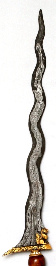

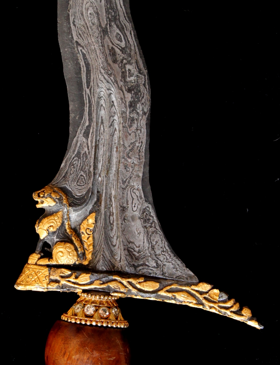

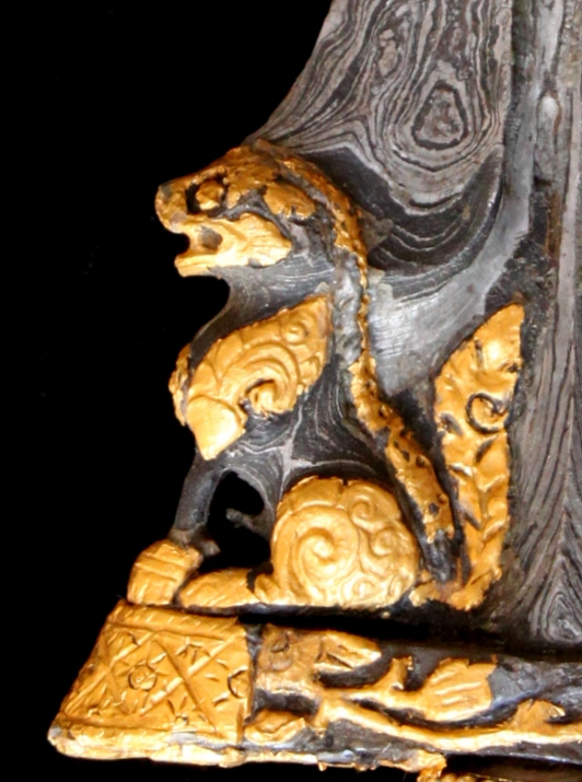

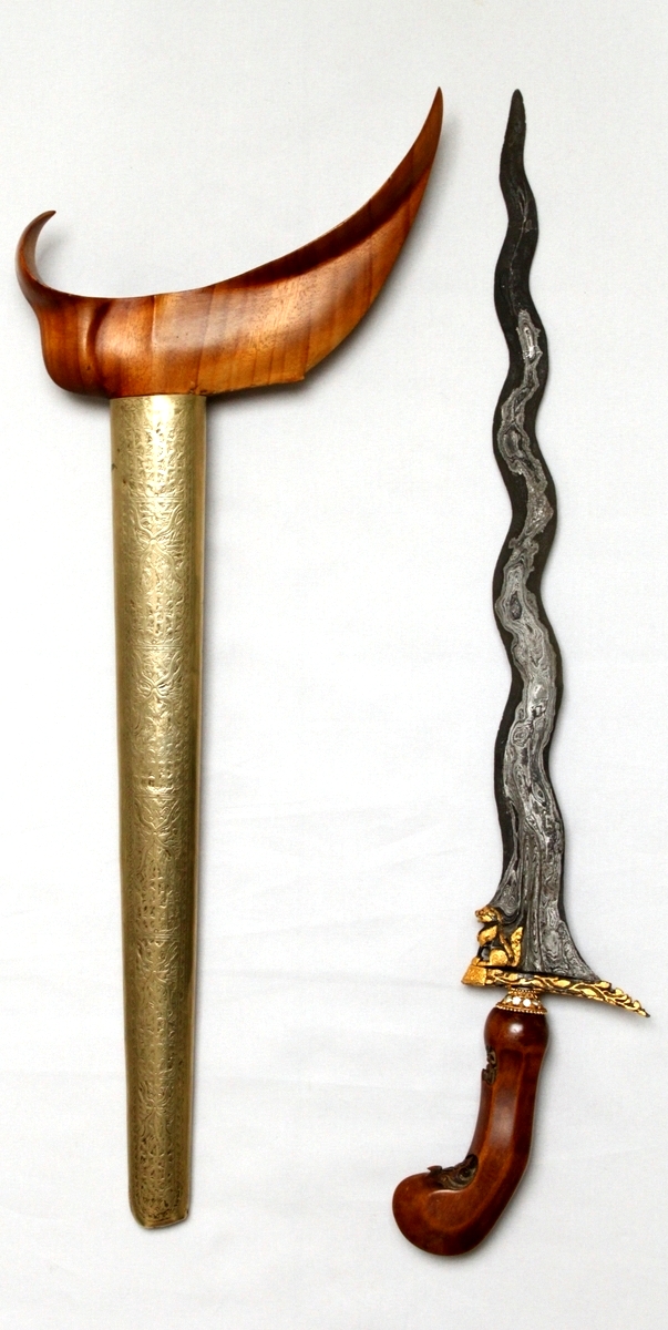

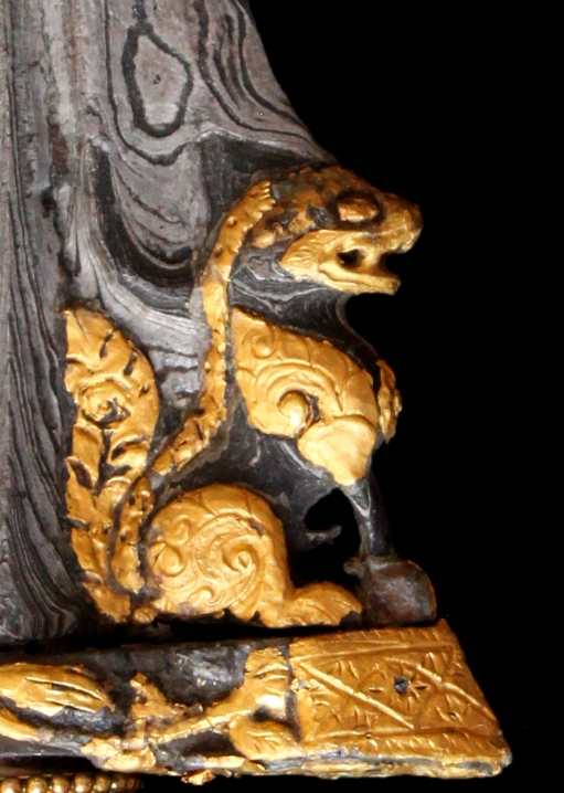

Yes, good work indeed. I attach the pictures of my own Singabarong kris, the kinatah work is not very fine and partly gone as seen on the detailed pictures and there is a welded patch on the paws.
The singa does not obviously seem to have been added later because the pamor lines appear quite continuous but I am not sure about it. Any comment?
