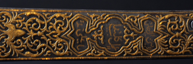

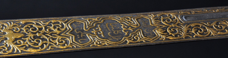

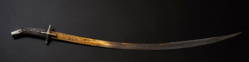

interesting sword with interesting blade ... maybe somebody can help with translation.... pls let me know your opinion on this piece!

the gold decoration on the blade is done in two ways, inlay and overlay, fittings silver, rayskin is probably later replacement, blade extremely light, laminated or kind of sham ...

priori, it seems that this is not written in Arabic
might be in old Turkish or Farsi
nevertheless
- 1st "cartouche" (up) a word unknown in Arabic, follow by
"ASLI AL" either "original"
- 2nd "cartouche" "TALY KEL AMEL" the 2 last words ... no meaning in Arabic
"AMEL" either "Made"
- 3rd "cartouche" interjection "ALI YA"
"YA ALI" either "Hi Ali"
pretty sure that "Zefir" could be the right person to translate those 3 cartouches

The 2nd Cartouche reads " Amal Kalbeali". "Made by Kalbeali". The supposed son of Assadollah.

interesting while the gold overlays do not remind me persian work? what do you think?

Although Dom in his kindness pointed me as the "right" person, I don't have much to add to his concrete translation. Some of these Caucasian-Tartar words and names are totally foreign to me

thank you ALL for comments , the sword is really nice and I think the best balanced among the swords I have had in my hands... Pity that it is hard translate the cartoushe, well I did not expect something outstanding but... it is always nice to discover those kinds of mysteries

As I am sure you and others who have posted know that you have in your posession a truely remarkable sword being what many do consider one of the rarest swords in the world.
Peronally, I would love to see more of it in larger & more detailed images here or privately. This fine example is obviously presentation/wealth/high standing grade and all are not likely to see anything similar for a very very long time if at all as I think it is most likely unique....I can only image what the scabbard looked like.
I'd also love to know more on the dimensions,(blade, hilt, guard, yelman, spine widths and taper), weight and points of balance.

As for the blade, perhaps it was originally Persian, and later decorated by those famour Armenian craftsmen from Lvov that got to enhance and assemble many of the imports to Poland from the East?

I think the first cartouche reads "La fata ella Ali" or "There is no brave man but Ali"
The last cartouche I think is "Ya Ali Madad" or "Oh Ali with your help".
With out better pictures I agree with Teodor observations.
