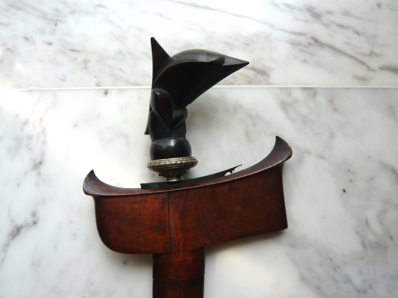

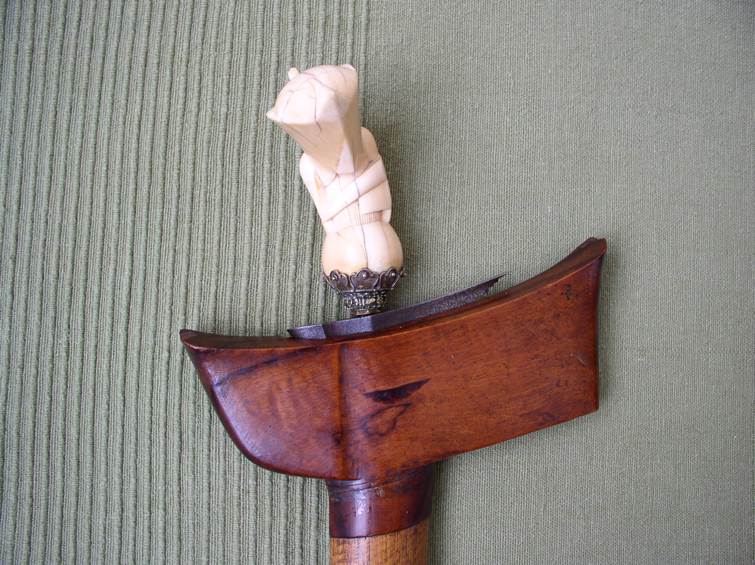

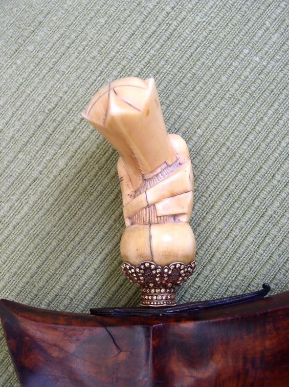

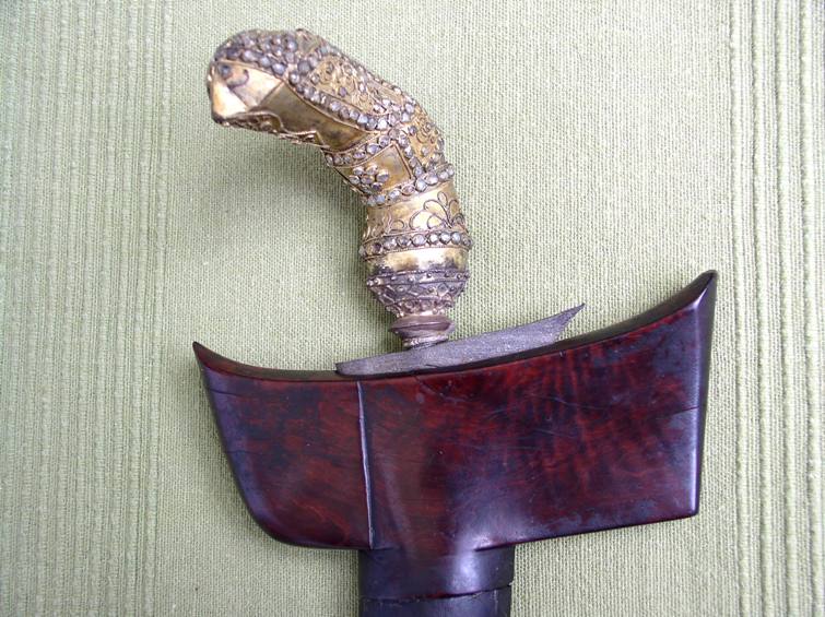

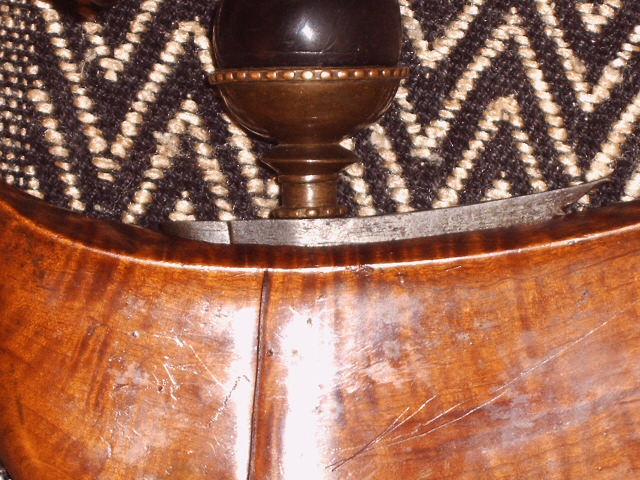

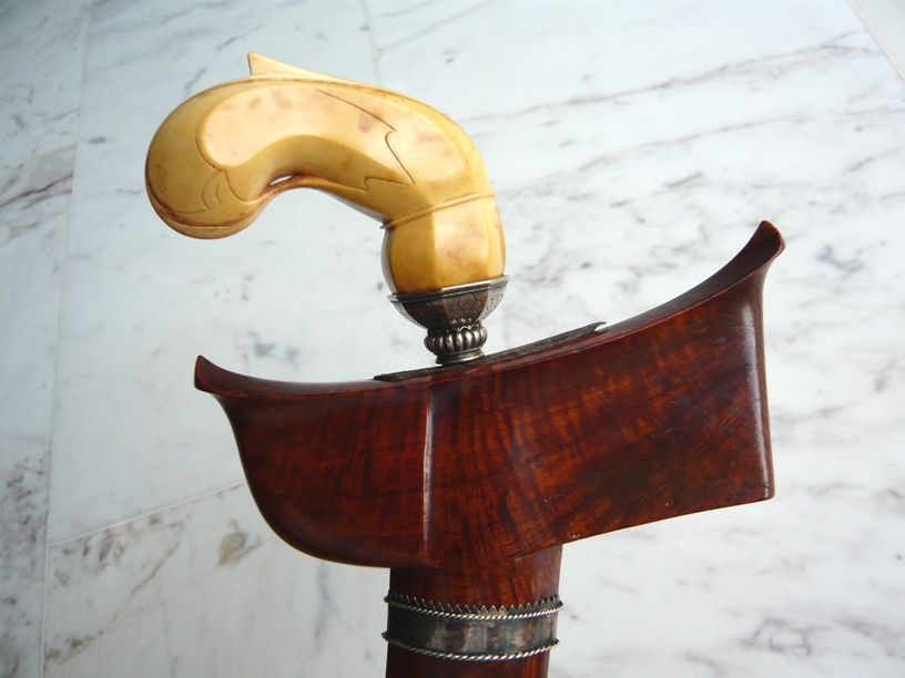

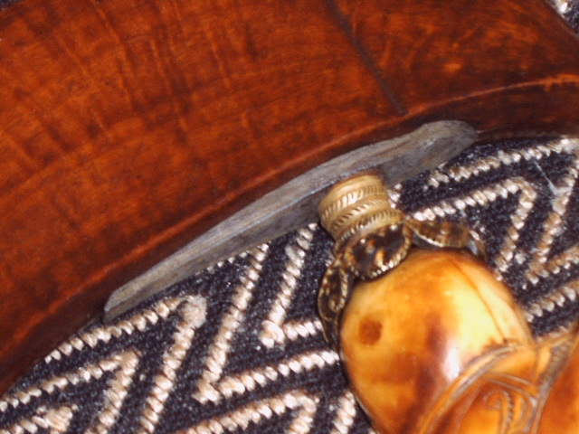

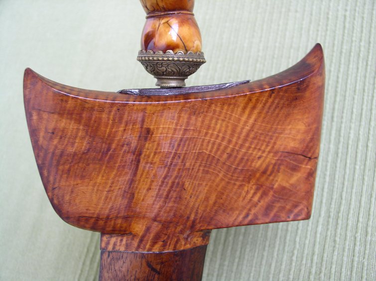

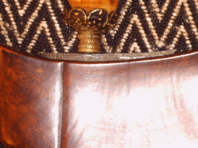

Dear All,
I have a couple of questions regarding the visible part of gonjo, "looking" out of the sheath (at Keris Bugis).
May I ask for some criteria (how much is allowed to be visible, how differs (if at all) this in different regions)?
I have two examples, for whom I am unsure: both fit not bad, but is the visible part not to big? Is the bottom-line of gonjo and the bottom line of sampir still with in the boundaries?
And now to something completely different
There is this old Photo of a Balinese. The Gonjo is "looking" out of the sheath. Do you have seen something similar on some of your balinese kerisses? (Of course there is the question if the sheath is original.)

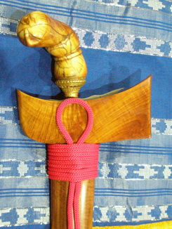

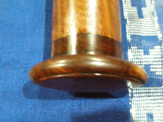

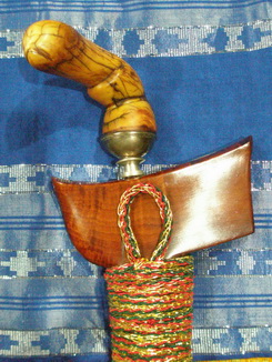

Hi,
In general, kerises, esp Malay kerises from the Peninsula, have more of the ganja sticking out. But in general, the line joining the ganja and the blade should not rise above the sheath. On the Sumatra side, there are also Malay kerises showing the ganja, but not as much.
For Bugis kerises, they tend to be flush, or rise a bit above the sheath. Your Sulawesi example (1st one) showing slightly more ganja than we usually see for a Sulawesi Bugis keris (I have a Buton keris, Buton is a small island South of main Sulawesi island, which has a ganja that sticks out even more than yours). However, from what I see, this keris is well-fitted to the sheath, and looks quite nice actually. I would not recommend refitting the keris. For the Sumatran example, I think it is well acceptable too.
Another factor to consider is also the age of the sheath. With repeated drawing and sheathing, the mouth of the sheath wears down, and the blade would gradually sit lower and lower into the sheath.

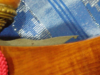

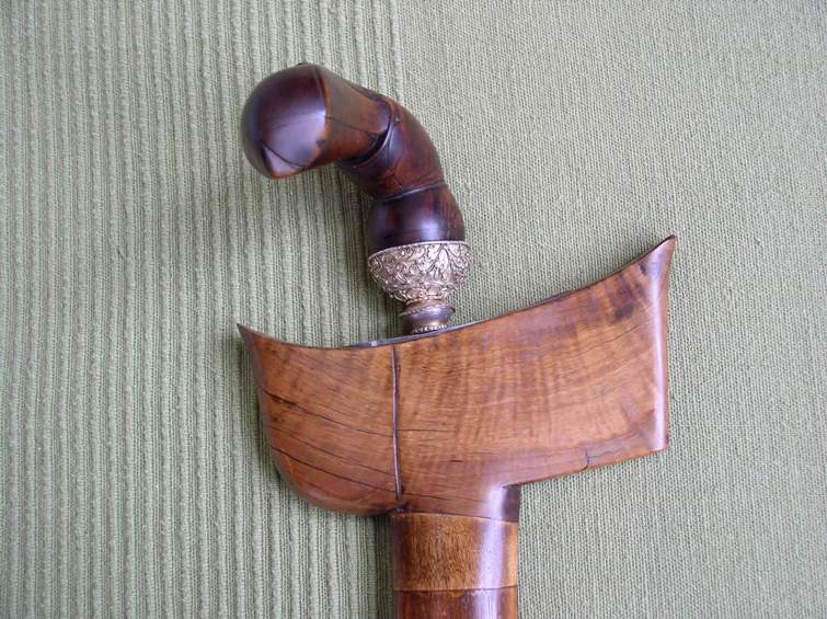

Malay Peninsula e.g.

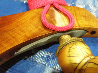

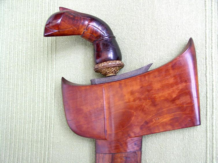

Sumatran e.g.

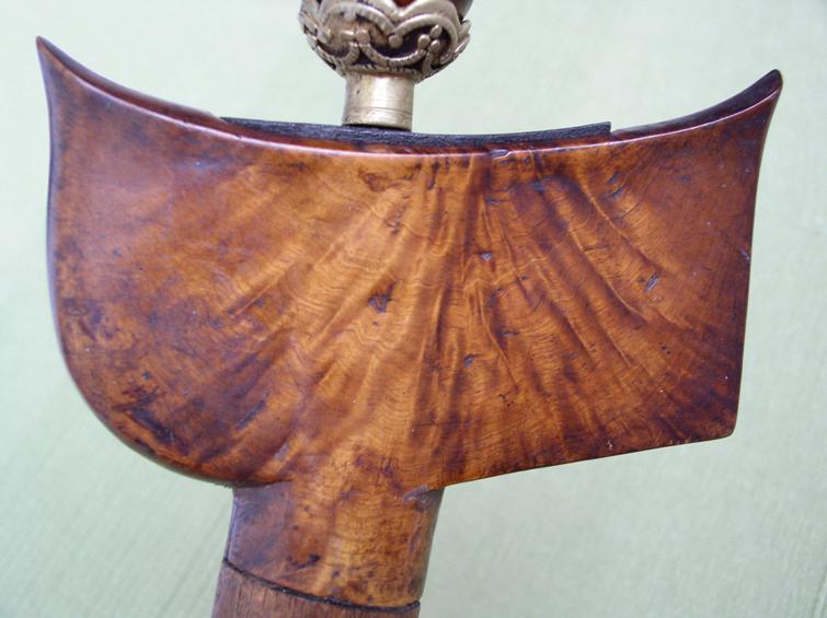

Sulawesi e.g.
Unusual Buton e.g. is at the bottom.

I could be wrong, bit AFAIK Gustav, the Bali keris you show an example of would be considered a bad fit. I believe that the Balinese tradition should have the gonjo flush to the top of the sheath.

I would certainly agree with David, the Bali keris shown as an example is indeed a bad fit.
The norm for Bali/Lombok is for the ganja to be flush to the top of the sheath.

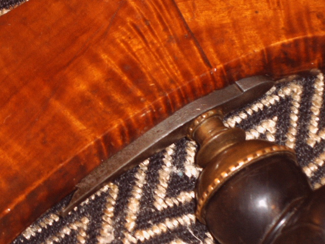

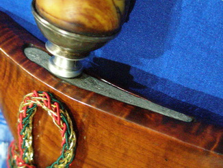

I have a Lombok keris pedang with a ganja that sticks just a little bit above the sheath. Looking at the sheath, I thought it was the original sheath.
The black and white photo here shows the ganja parallel with the top of the wrangka. Perhaps it was intentional? Perhaps some fellow collectors from Bali/Lombok can help clarify?

Yes, I also have a keris from Lombok, with an older carefully made sarung of not bad quality, which also sticks a little bit (like on the picture) out of the sheath.
I also hope, somebody can clarify this.

Although I am not from Bali/Lombok I checked Djelenga's book for this issue, by far the large majority of the pieces are flush with the top of the sheath.
Also of the 29 pieces from Bali/Lombok in my own collection currently, all but two are flush with the top of the sheath.
Wood shrinkage over time and or poor fitting of the blade into the sheath, this is most likely the cause of the blades gonjo sticking a little bit above the sheath.
As for the Black and White photo, this photo was staged so who knows what the intention were.
This Bali Keris sits proud of the scabbard and it is an original piece.
http://www.vikingsword.com/vb/showth...t=painted+bali
Thanks
Gav

Originally Posted by sipakatuo
Dear Gustav
This is my opnion and to the extend of my limited knowledge.

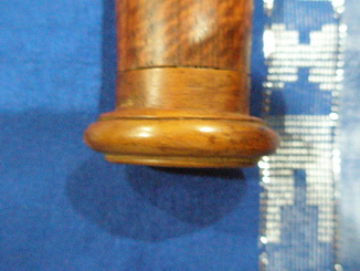

Speaking about setting of Ganja (Kancing in Bugis term) I saw many style of them in my home town Sulawesi. So it is difficult to say which one is the right setting. Plenty of them just flat, when I say flat means a level with the mouth of warangka, some even slightly sank into the warangka, few shown the upper level or buntut cicak. Through my research in Sulawesi I found no philosophy, reference, or whatsoever about this issue or the knowledge about it has been buried. So I believe it is just a matter of our own preference. The high setting of buntut cicak could be just to make it attractive.
However, I know that in Malaysia dan Singapore they have other opinion about this issue.
Speaking about the setting of gonjo, here I want to share my family's heirlooms and they are as originals as you can see.
Btw, I am just a collector not a dealer or runner. I am here to exchange opinion with you and the rest of members. No point of getting famous or to be acknowledge by everyone. I believe if you have brain and want to be someone then you need to make a book and let other people judge you, by then you can measure your knowledge!. Just read previous threads about the need to claim own identity. My full name is quite long so just call me Andi or Irvan and I live in Jakarta. Thanks and have a nice weekend to everyone.
Hi Sipakatuo,
Thanks for sharing your family heirlooms. Could I enquire if the toli-toli were attached in recent times? The reason for my asking is that the rope do look pretty modern, especially the pink one. What is the reason for attaching the toli-toli? Thanks!
Kai Wee
Old 6th February 2010, 11:23 AM   #27
sipakatuo
sipakatuo's Avatar
Join Date: Nov 2007
Posts: 59
Hai Kai Wee
It is not Toli-Toli, it is called Passiosumange or Passingkerrusumange. There is a difference between Toli-Toli and Passingkerrusumange. Toli-Toli in Bugis means Ear Ring and you can commonly find this object attached in Wanua (Warangka) of Badik or sometimes in Tappi (Keris) too. Passingkerrusumange is the loop itself. It means 'Pengikat Semangat' or knot of spirit. You are correct, the loop here is new because the old one was damaged and so I have to replace it. Passingkerrusumange is also representing a status, in the old days before they wrap this loop around the Wanua, they must spell a mantra. The purpose is to give this loop a spirit (semangat). So whenever we travel along with this Tappi it can give us a 'sign' before bad things happen at home. This is just a belief and culture of the Buginesse in the old days.
There is actually other purpose of it and maybe next time...

Hello Sipakatuo, thanks for sharing the information! Wow, this is interesting indeed. Look forward to part II. Thanks!

is it maybe possible you can you show us how make a properlyToli Toli /Passiosumange/Passingkerrusumange?
are there certain rules, or prescribed dimensions ?
I think it gives the keris a better appearance.
