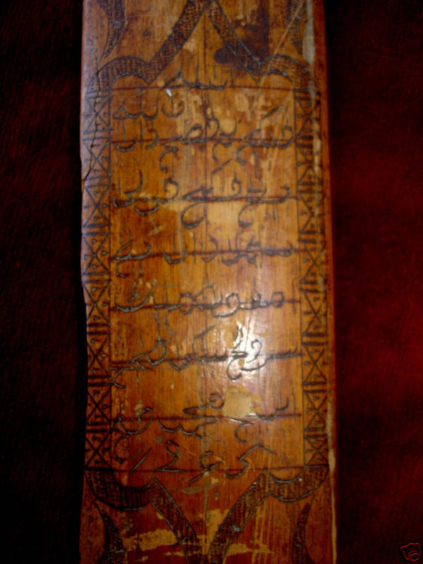

Appreciate if you friends could help identify this Klewang which has ended ebay listing yesterday under title: DATED OLD ANTIQUE KLEWANG Indonesian Malayan SWORD KRIS
1295 AH. OWNERS NAME SIGNED ISLAMIC SCRIPT
Be glad if you could focus on:
Origin
The Islamic Script written on the scabbard ( I am unable to identify)

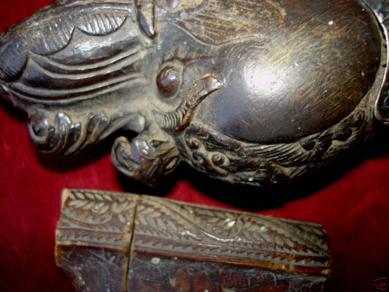

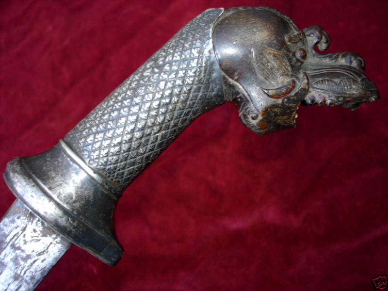

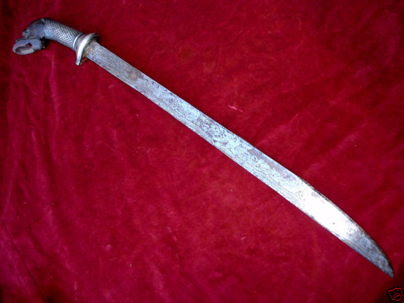

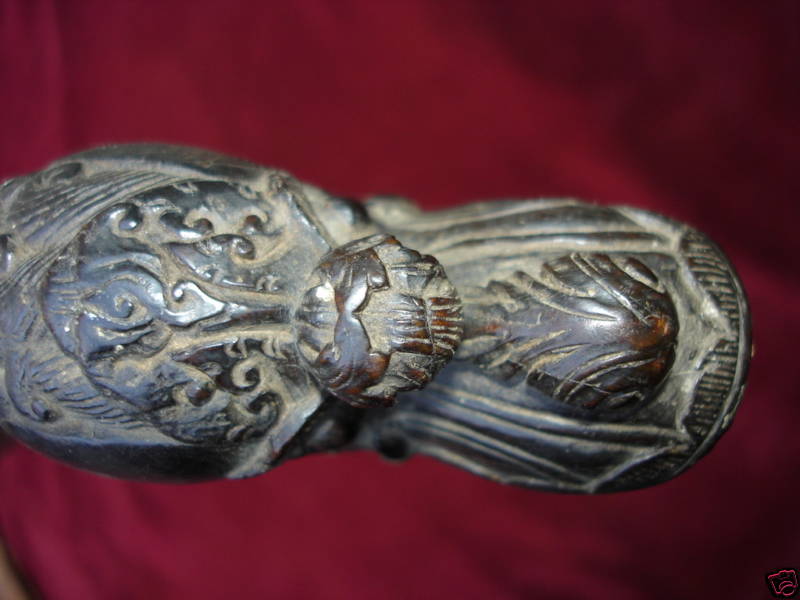

First some of the pictures from the seller.

Thanks Sajen, usually Minangkabau's hilt motif would not be of a Dragon but sometihing like horse shoe (tapak kuda). Agree with you, maybe from Acheh. If some of our Malay friends could read the Jawi writing (Islamic script) on the scabbard would be useful.It would solve the problem. I could read only a little. The word Pedang (sword) has been mentioned.

.. from Acheh. If some of our Malay friends could read the Jawi writing (Islamic script) on the scabbard would be useful.It would solve the problem. I could read only a little. The word Pedang (sword) has been mentioned.
The script on the sheath is Acehese works.. The sword type looks like a co jang, but the aesthetics and hilt type is different..

I think we definitly can say the scabbard is Aceh. The scabbard is not original to this klewang. The scabbard is a damaged scabbard from a sikin panjang.
The sword is a sumatran pedang with a pamor blade. Lovely pedang, but a bit to expensive. I'm happy for the seller but I feel very very sorry for the buyer

The scabbard is definately sikin panjang / Aceh and not original to the pedang.
This pedang would have a simple wooden scabbard that is oval, close to round in diameter. Maybe with some simple silver bands.
I also notice some traces of red paint on the hilt.
A scabbard could have also been painted red.
I believe the lower jaw of the creature/dragon is missing.
With a complete hilt it would have been worth the price. (imho)

The only sword hilt like that I have seen documented is in Leiden (499/25), where they say it's from Java.
It's in the catalogue but not in the picture archive?
