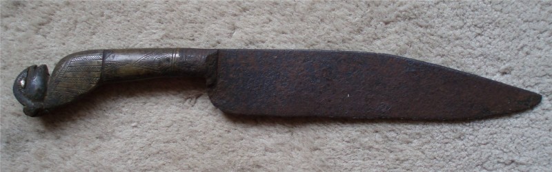

I recently acquired this Pihiya Kaetta style knife at ebay.
Or at least I think it is a kind of Pihiya.
The handle reminds me of the Serapendiya hilted Pihiyas altough the handle is made of cast brass.
It is looks like a working type of knife than the commonly found highly decorated Pihiyas.
Do You have any ideas if this could be a predecessor of or a working Pihiya contemporary to the highly decorated Pihiya Kaetta?
Here ist the link to the knife (ebay No.: 390058685768):
http://cgi.ebay.com/ws/eBayISAPI.dll...fvi%3D1&_rdc=1
Best regards, Helge

A nice old piece, I saw this pass through an auction house recently and it didn't take long to reach eBay.
I certainly is an old and nice piece.
The hilt is of Garuda, king of birds, ruler of the sky, and personification of power. I liked the piece and if I didn't have other commitments at this point in time I might have run it up a little higher.
If you have a copy of Hindu arms and ritual, page 38 shows one similar with an ivory hilt, Elgood notes the same style blade as being European.
A good buy.

Interesting old blade. I see why you think it might be related to the piha Kaetta, but i am not convinced it is one.
Gav, you seem pretty sure the hilt depicts Garuda. Why is that?

My first thoughts were a Sphinx like beast then I searched a little further with Hindu Dieties becasue I knew the collection that this piece came from(mostly Southern Indian and pieces from Sri Lanka), I then remembered Elgoods book with the same profiled Eurpean blade, referred to his text noting Garuda hilt (I had a hard time seeing Garuda in his image presented). Then back to the Ebay link and the wings nestled over its chest convinced me, then off to good old Google images and trawled through there and there are heaps to choose from that are consistant, follow the trail and let me know what you think ;-)
Gav

Well, i don't have Elgood's book, but i did look over a lot of Google images under "garuda" and didn't really find anything that looks like this. I see what you think are wings and i suppose they might well be, but i don't really see anything else that is bird-like about this figure.

The item in question, for future reference...

Hello and thank You all for Your comments.
Of course You are right, it is a Garuda hilt.
Seems as if I did not read Coomaraswamy's Medieval Sinhalese Art well enough.
Maskell, thank You for the link.
Actually this threat is one of the sources why I believe this knife to be related to the Piha Kaetta.
Here is another threat to this toppic depicting Pihas with Garuda hilts.
http://www.vikingsword.com/ubb/Forum1/HTML/001998.html
Best regards, Helge

Very nice piece of rarer form. Looking over Maskell's thread, I was reminded of Sri Lanka's other figural hilted weapon, the kastane. This garuda interpretation seems to resemble a cross between the more typical form and the dragonlike kastane hilt?
