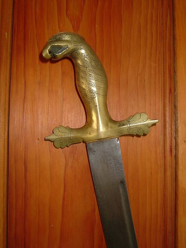

My example has an eagle head and no langets .
I wonder ..........
No scabbard but a nice non Euro blade identical to fig.433 pg. 110 in vZ's book .
I have only seen one other example of this hilt and it was broken and repaired .
Old 24th May 2009, 11:54 PM   #11

Posts: 2,235
Hmmm... pictures please

Old 25th May 2009, 12:15 AM   #12
Posts: 6,339
here it is .

Wow !
That is weird. Do you have picture of the complete weapon.
Could it be made after Indonesia became a republik and the eagle / Garuda becam a symbol for the whole republik ?
Old 25th May 2009, 12:41 AM   #14
Posts: 6,339
I think if it was a republik sword we would encounter them more often .
No full pic right now but the blade is the same as the example I referenced in vZ .
If you do a forum search for piso podang you might see a full pic of it .

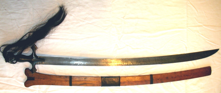

Old 26th May 2009, 10:51 AM   #15
VVV
VVV's Avatar
Posts: 1,637
As this sword didn't originate among the Bataks, but in India, and as it is found independently, without any Batak connection, in Peninsular Malaysia as well as Brunei, Sarawak and Sabah I think it's incorrect to label it a Piso Podang (the Portugese influenced Batak term).
As far as I have read from different sources the local Borneo name is Pedang.
The problem nowadays however is that among the tourist shops in Kuching Sumatran keris and swords are imported and sold as souvenirs also in Sarawak.
And I haven't been able to find a "for sure indicator" on the plain hilted, closed cup, versions of this sword to know if it was made in Malaysia, Brunei, Sumatra or Sarawak/Sabah. So I assume the provenance, and some local add-ons like this hair, is all we can make conclusions from?

Nice example Michael you have there.
Interesting is that the scabbard has no metal fittings.
Often to me that is one of the indicators for Borneo origins.

Posts: 1,637
Willem,
Yes, I also thought that the metal fittings could be a Borneo indicator.
And then I saw one from Sumatra with resembling fittings...
But I agree that it's a common trait even if it's not a certain indicator.
Like the closed vs open cup pommel.
