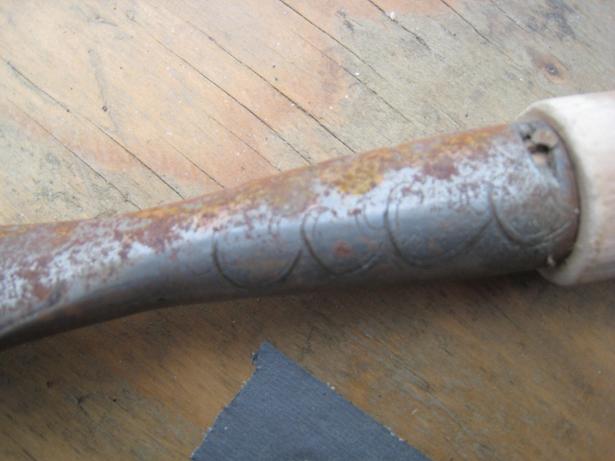

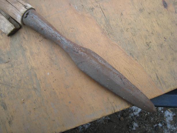

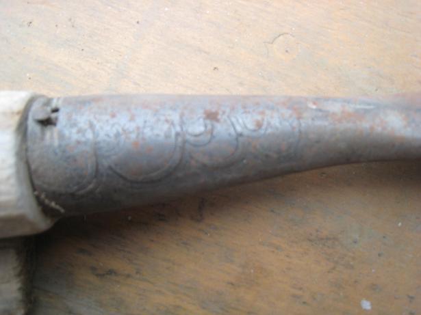

Gentlemen!Having but very recently joined in the forum,i'll go out on a limb here in the hopes that this object may in any way interest anyone.I apologize beforehand if the object lacks much of an interest in the context of your researches and collecting.Also for it's vague,at best,relationship to the "european"part of the forum discussion.
But,here goes...It was found buried in the sand on the beach on Bering strait,south of Nome,Alaska.Then re-handled,and used a few times here,further inland,for taking bear (out of the den,mostly).That was 50 years or so previous.
The spear is forgewelded out of fairly slaggy steel,the visible layer structure seems to be about .5mm thick.The socket is forgewelded very competently,and decorated with the alternating hot-inlay of copper and brass(the inlaying grooves are not dove-tailed).It's possible that the entire socket was coppered,much like many European,German,especially,tools.Since i've taken these(poor quality)photos,the new owner has dilligently "cleaned" it,obliterating the layering exposed by corrosion,and the surface remnants of the non-ferrous metals.The lengh O/A is about a foot.
My feeble inquiry as to it's possible origin i should,probably,keep to myself,so as not to muddle any possible discussion(I've no qualifications for an academic research into this,or much else,at that But,as a native Russian speaker,did briefly cast my gaze in that direction(the Russian Far East),albeit without much that is conclusive in any way).
Respectfully,Jake.

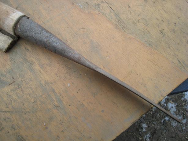

Here are the photos themselves,and thanks,Jake.

Hi Jake,
First of all, welcome to the Forum!!! Its great to have someone here from our far northern regions, and I'm glad you have joined us here. Our scope of discussion is intended to feature virtually all forms of arms and armour, and including items which often seem to fall in the gray areas. I believe our basic philosophy is one never knows where clues might be found.
Also, one does not need academic qualification to participate here, we are all here to learn together, so welcome aboard!!
It is very good news to have someone who speaks Russian also, as we often have markings, and references where we need help.
I would say this appears to be a socketed lance head of 19th century, but pending further research, cannot qualify that in more detail. Naturally, the long reach of trade routes extended heavily into your regions from far to the west, and European metalwork items were in great demand.
The engraving in what appears to be crescents is very interesting.
Please do share your thoughts, it tends to enhance discussion rather than inhibit it.

Hi Jake,
Welcome!
I agree with Jim on the age, and I'd add that we can't rule out Chinese manufacture either. It is, unfortunately, a fairly generic shape, and they're selling them even now for the martial arts community.
The interesting thing to me are the decorations. I'll admit I haven't seen them before, but if they are original to the piece, they're probably our best clue for figuring out who made it.

Hi Jake,
I cannot add anything to your spear head but consent with what Jim and Fearn stated - and Welcome from my part as well, of course!

I'll have to preface anything that i may say by bringing up the fact that the entire subject of "Fe in the Arctic and the Sub-Arctic"is terra incognita,or very nearly so,as far as the academic research goes.But if that wasn't enough,these will be the thoughts of an isolated,uninformed hick,with no access to data,and very poor research skills,electronic or otherwise.
Since the 1800's at least,the traders and the whalers could have brought an object from basically anywhere.Even before,the Dutch in Indonesia,the Portugese in Japan,and on,and on,the Japan Current curls to go back south around here,so that the possibilities are endless.
The only telling info can come from the technology of the manufacture(or some expensive metallography).
In my limited view,such a construction-homogenising steel by piling and welding,is (1)not commonly practiced in Indonesia or South-East Asia(at least for the inexpensive trade goods),(2)ditto,really,anywhere else where the bulk of the trade goods may've originated.It's simply too laborious.
I started looking to the native manufacturing processes across the Strait,in the parts of Siberia,for that trade route functioned,of course,always.
One of the possible sources is what is now called Saha republic,Yakutia of the Szarist and the soviet Russia.Skilled in ironwork since pre-Russian invasion of 1600's(arguably),their work has appeared here regularly.In the early 1700's travel notes of Lt.Zagoskin(the first european to ascend the Yukon),describing the gathering of the tribes at the mouth of the Nowitna R.(roughly 300 miles from the coast)he says:"...i have instantly recognised some knives of Yakut craftsmanship".But,that part of the world's metalworking is quite a (yet)unopened can of worms).
Closer to home,directly across the Strait,on the Kamchatka peninsula,there is also evidence of some similar forge practices.In the (now abandoned)village of Paren,on the Paren river,at least in the off season the hunters would forge tools and weapons for trade.Supplied with bar iron by the Szarist traders,and ditto by the Soviets(actually forging as a collective farm in the 1940's-'50's.What those folks were up to earlier remains a mystery.
In general,an unfortunate assumption often is made by the scientific community as to the manipulation of Fe in the circumpolar north.But a few that i've chanced to talk to,were even unaware of the cold-forging of the two meteorites,by the Inuit of Greenland(both m.confiscated by Adm.Peary,and are now in storage at the N.Y.MET).
So,here i've typed for a while,and all seems toward no discernable point...Sorry about the lack of focus,i'd be very interested in hearing from those more informed.Best regards,Jake

I agree about the lack of data on Arctic metallurgy. I'd read about the knives created from the Old Woman meteorite for years. Finding a picture of one of those knives has so far proved very difficult.
As for the forging technique, I'd put in several possibly contradictory thoughts.
One is that the spearhead may not have been a trade good at all, but it might instead have been scavenged from a wreck.
A second thought is that, while such forging is considered too tedious now, I'm not sure it would have been a century or more ago, when the spear was first forged.
A third thought is that I'm not convinced the spearhead was locally forged, because forming a socket is a little tricky, and I don't know of anyone north of Japan who was doing that type of forging on spearheads (this is probably my ignorance speaking). If the spearhead had a tang, I could easily believe it was of local manufacture.
This gets back to the question of the decorations. They're probably our best clue at the moment.

Curious is well placed here on this 'spear head', and I've been busy with searching in quite a few directions to add to the excellent observations already noted by Fearn.
As Jake has already noted, the Yakuts and natives in Siberia had metal working skills pre Russian invasion 16th c.
While this appears to be a lance head, and apparantly emplaced as a spear head, the whaling activity of natives in these regions is I think important to consider. I am not suggesting that this is a harpoon, but found some interesting notes concerning the use of iron in whaling by Native groups.
In "Ethnological Results of the Point Barrow Expedition" John Murdoch, Point Barrow Expedition (1892), on p.240 the superstitions of native whaling mention that of late, many of the natives had obtained ordinary 'whale irons' from the ships, and that in 1882, a very bad season had been considered due to this use of these foreign 'irons'. The tribal elders determined that this effect might be countered by the initial strike of the whale being with one of the ancient stone type harpoons used by the forefathers. Subsequent hits could use other means.
It is further noted that (1882) they found no signs of iron whale lances of native manufacture as made in Greenland and elsewhere.
The primary tribe associated with this whaling would be the Inupiat Eskimos who apparantly occupy extremely wide regions that include Greenland, Siberia, Canada and Alaska.
Murdoch (op.cit. p.242) also describes a form of lance which has a head somewhat similar to the one posted here, however the example he describes has a tang, although beveled edges on both faces are noted. The heads are not always iron, but of copper and brass as well.
These lances are known as 'deer lances' and are actually a spear which is called ka'pun' (= stabbing) in Point Barrow dialect, used by Eskimos in kaiak to hunt swimming deer.
The example of Jakes seems loosely similar in the shape of the head, but of course is socketed rather than tanged.
The term used is close to the weapon used in Greenland (kaput) used for long bladed spear used in dispatching harpooned seals.
There is a lance apparantly also used as a 'bear lance', of which we can assume the basic style is similiar.
It would seem that the wide range of habitat for the Inupiat which includes not only Greenland, Canada and Alaska, from regions near Nome, far to the north at Point Barrow but Siberia as well...perhaps the well known metal work of the Yakut, and others might have been widely diffused.
Siberian tribes such as Chuckchee and Koryak used lances, and to the west the lance was distinctly among Inuit weapons.
Another reference noted that iron and steel metalwork was used by Tlingit and Haida in making weapons during conflicts with Russia.
While these notes are of course inconclusive, they are meant simply to add to material being considered concerning this lance/spear head.
The markings or motif do seem to be likely to have considerable bearing for further research on this.

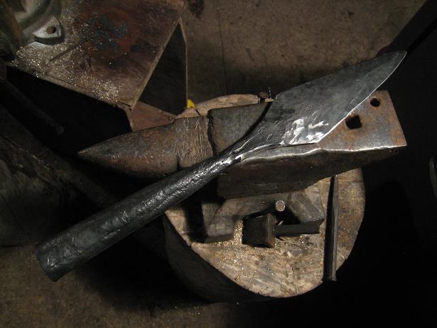

The author,LBA,was asked to forge a blade for an "art-knife" by one of the more noted members of the The Guild of Master Armourers,a Mr.Sushko,who lives and works in Kamchatka.The local color and lore have a large place in Mr.Sushko's work,and the project involved a knife along the lines of the mythical Paren knives,which led LBA to look into all the related stories,and that's how this short article came to be written.Here's a link to the original:http://www.arhangelskie.com/stat_9.html ,at the very bottom is a photo of the knife that the two cooperated on.
Here's the gist of the story:The myths abound of the superlative qualities of the "needle steel".The variations include anything from bunches of thin wire(in the 19th cent.Uzbekistan),to the similar construction in the Russian North West,Norse-related,to the mythical welding up of a load of Japanese steel needles by the Koryak,specifically in the village of Paren,Kamchatka peninsula.The myth variously involves composit of all sorts of "found"steel,ship plate scavanged from wrecks,and even a container weld,a pipe filled with assorted(by C content)chunks.
LBA poses a possibility that this sort of complex metalworking could have dispersed to the Koryaks from Yakutia(Saha Republic,now).

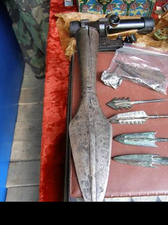

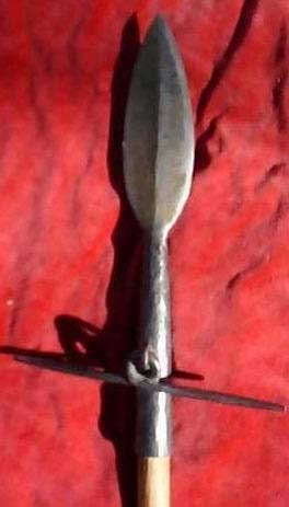

The piece does look like the head of a rogatina, minus the toggle. I'm guessing that the toggle is like the cross-bar on a boar spear, meant to keep the bear from charging up the spear staff? I'd also guess that's why the spear is was forked in the old days.
Just as a cross-reference, the Chinese used a tiger fork in hunting tigers, so I don't think it's unusual to use a large, sharp forked anything to hunt a large predator.

Fearn,you're quite correct,as far as i know,on all counts.Most hunting of large critters with a spear involves a toggle,lugs/wings,or the like.Around here(the forested interior of Alaska),the toggle was lashed on to the shaft with rawhide(it was very interesting to note the similarity with German boar spears,elsewhere on the forum).In some cases,like the den hunt,where the animal is provoked into an attack,the toggle serves as a fulcrum,around which the animal rotates in it's motion,the point of the lance describing an arc in it's chest(hopefully)severing the aorta.The placing distance of the toggle from the point is critical.
Many peoples in Siberia,Chukchi,Koryak,Evenk,many others,used a great number of different styles of spear.Sometimes some carried a very large one called(in Russian,but from some other language,not sure which),"pal'ma".It was used like an all-around camp tool,even for the trail hacking,it was heavy and sharp both.
Unfortunately i lack either the accurate description of one,or any images.However,I just had a chance to forge something of the sort,i'll post a photo although it's not quite done.Living here gives me a chance for an occasional commission such as this,for which i'm grateful.It's 19" overall.
