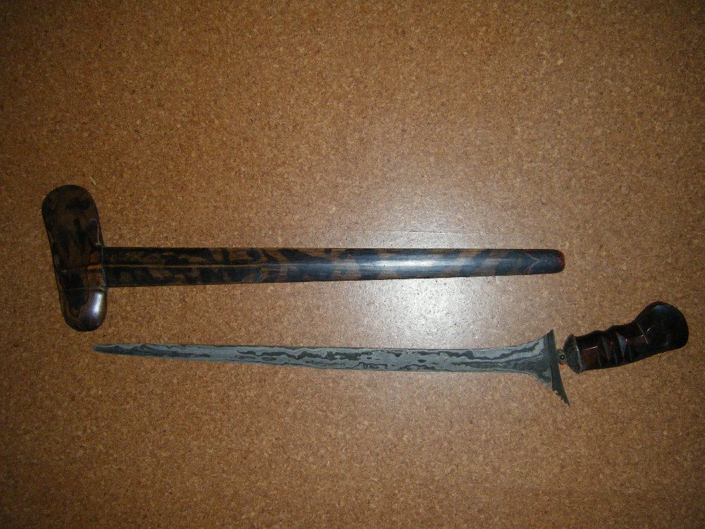

Any idea about the dapur? Please share any information about this one
thx
gwirya is offline   Reply With Quote
Old 16th April 2009, 08:36 PM   #2
Posts: 7,255
Unusual.
Never seen anything like this.
My guess --- and it is only a guess--- is Lombok.
There appears to be an overall Balinese feel + maybe a little Bugis input in this piece. Lombok has both, and they used to do some pretty peculiar things with keris in Lombok.

How long is the blade ?
If it is short then possibly a Keris Badek ?
Lombok has already produced examples of Keris Pedang .
Why not Keris Badek ?

The length of the blade is 31 cm (12.2 in") and the owner offering the keris is from Lombok.

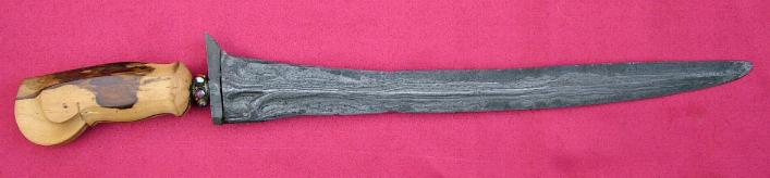

the dapur of this type of keris is keris pedang
regards semar

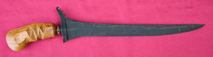

I know only the long version, this one is 57 cm, only the blade.
sajen

Sajen, that is the only form I am familiar with also ..
A blade that short seems to fall more in patrem territory than pedang .
Keris Pedang Patrem ... ?

Semar, the blade on your first picture seems to be very close to the one in my picture. How long is the blade of yours semar?
thank you guys for all the information, really appreciate it.

I tend to agree. AFAIK "pedang" literally means "sword" and from my perspective 12" is just a wee bit too short to qualify as a sword.
Would love to see you clean the little guy up. Does it seem to have pamor?

hello Gwirya
the lengte of my blad = 32 cm
and David when you don`t know this type of keris
that does not mean that the name is not correct
mabey its a other type of a keris pedang ???
because guppy`s you can find in the aquarium
regards semar

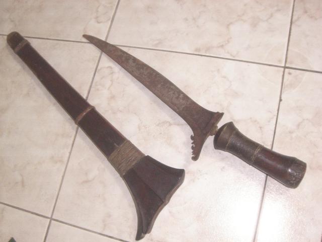

I think so that the correct name of the dapur from the long version is "Cundrik" (like Amuk already note), see Ensiklopedi Keris page 136-137, about dapur keris lurus. But I don't know if you can call the short version with the same name, but on the other hand dapur is dapur equal how long.
The name "pedang" is colloquial.
sajen

Have to accept the explanation from Mr. Maisey, I can't assigned dapur from Surakarta to Lombok.
I found another keris from Bali (?) with this dapur (long version / blade 48 cm) in the second book from Tammens (De Kris 2) on page 234/235, he write by dapur: cundrik-form.
sajen
Old 18th April 2009, 04:33 AM   #19

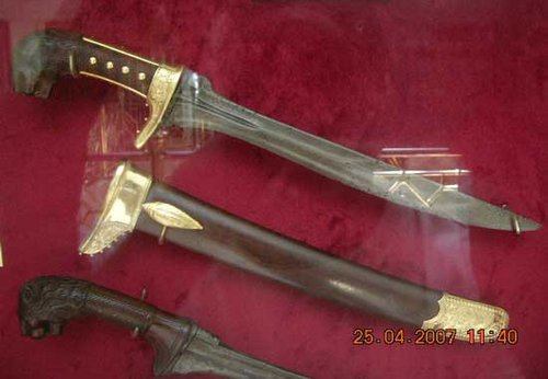

The keris shown on P. 234 of Tammens, Vol. 2 does not share the same characteristics as the keris posted by gwirya.
The Tammens example appears to be a ligan, or keris pedang; I say "appears to be", because all we can see is the outline of the blade.
One thing is certain:- it is most definitely not a keris of cundrik form.
